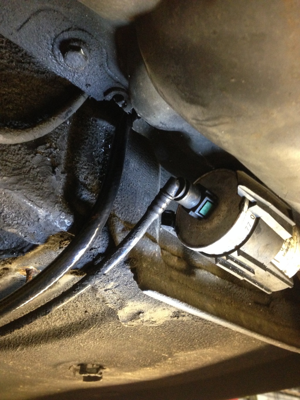

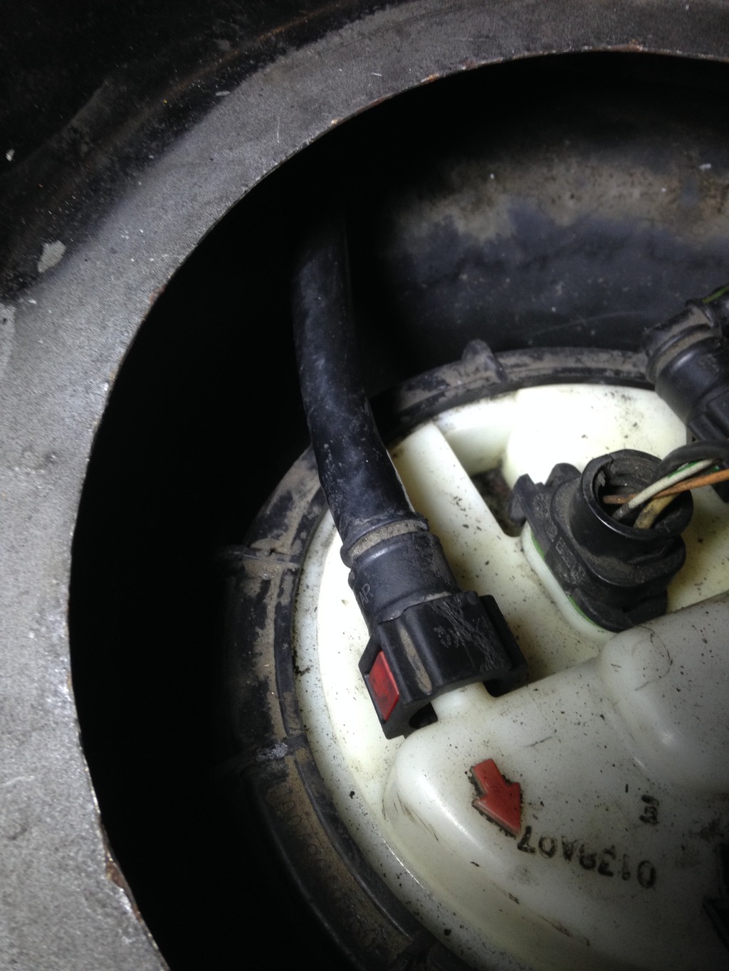

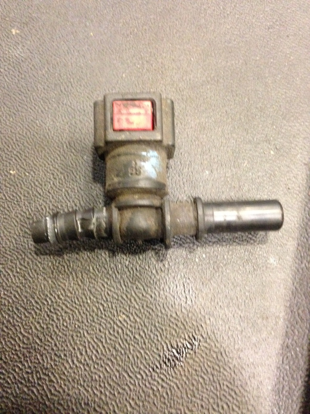

so sorted my fuel return today
and the binned t piece

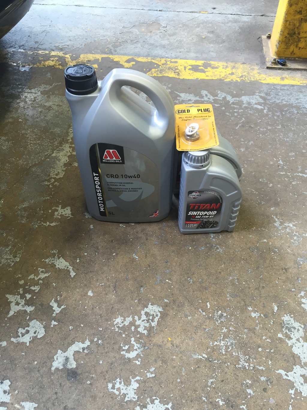

also fitted some plugs and leads, then painted the oil cooler lines as they were a bit shouty

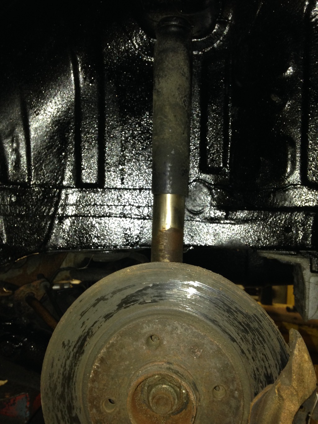

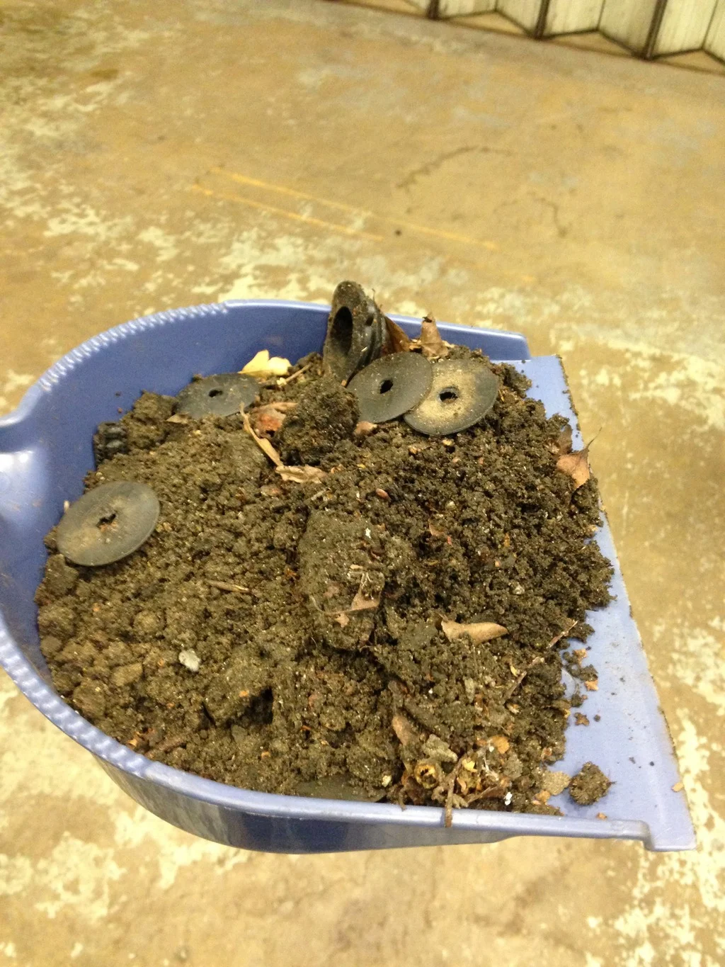

epic job today decided that being a 15 year old clio meant that it will suffer from rust at some point, spurred on by the rust i found inside the rear arch the other day i decider to re-seal the whole underside of the car ( near enough anyway )
hopefully i wont be needing a re-shell anytime soon well not to rust anyway
only pic i took as it was a messy job

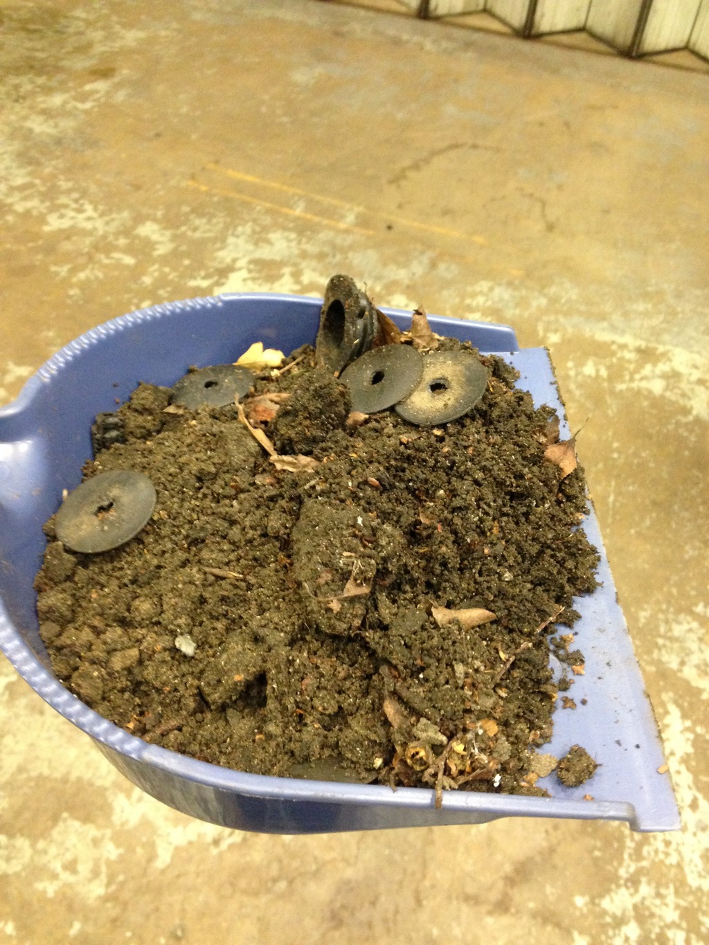

whilst doing the front arches i pulled some amount of mud out from the void where the skirts meet the arches must have been about 3kg lol ahh well 3kg lighter

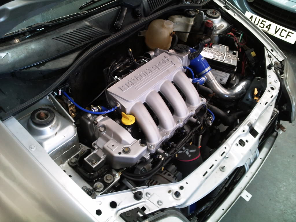

so more parts arrived this week

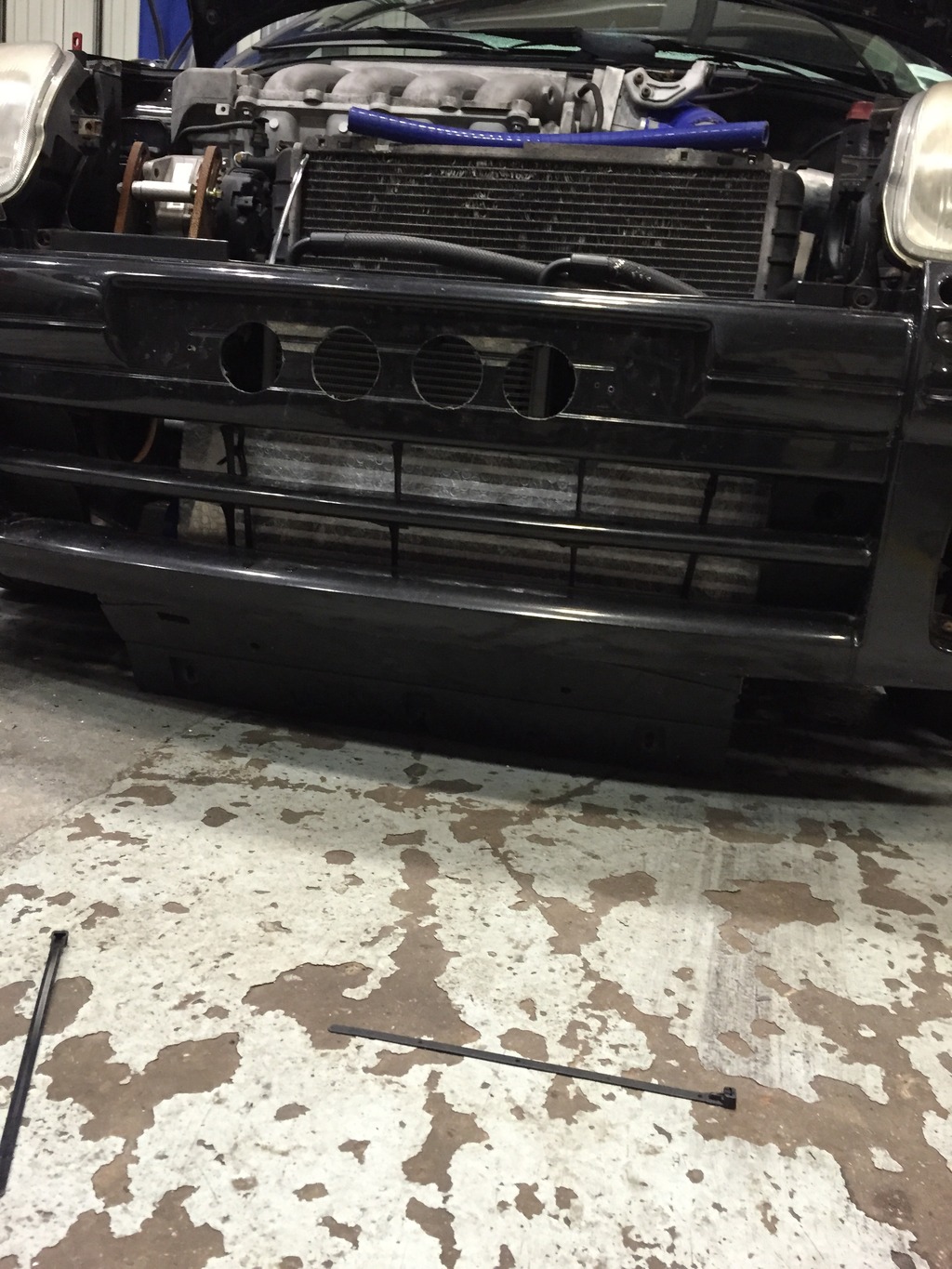

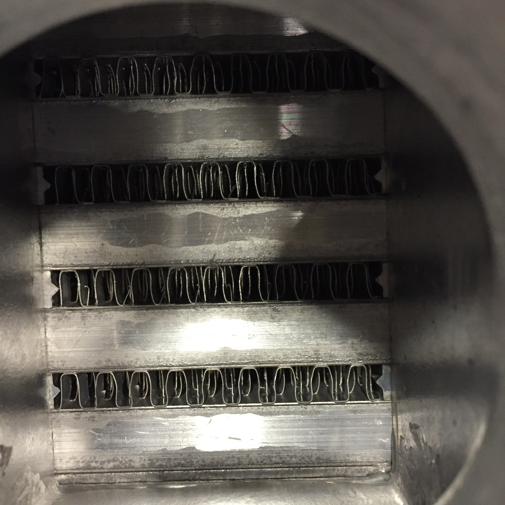

core actually looks ok tbf, was worried as toyosport are not overly known for quality

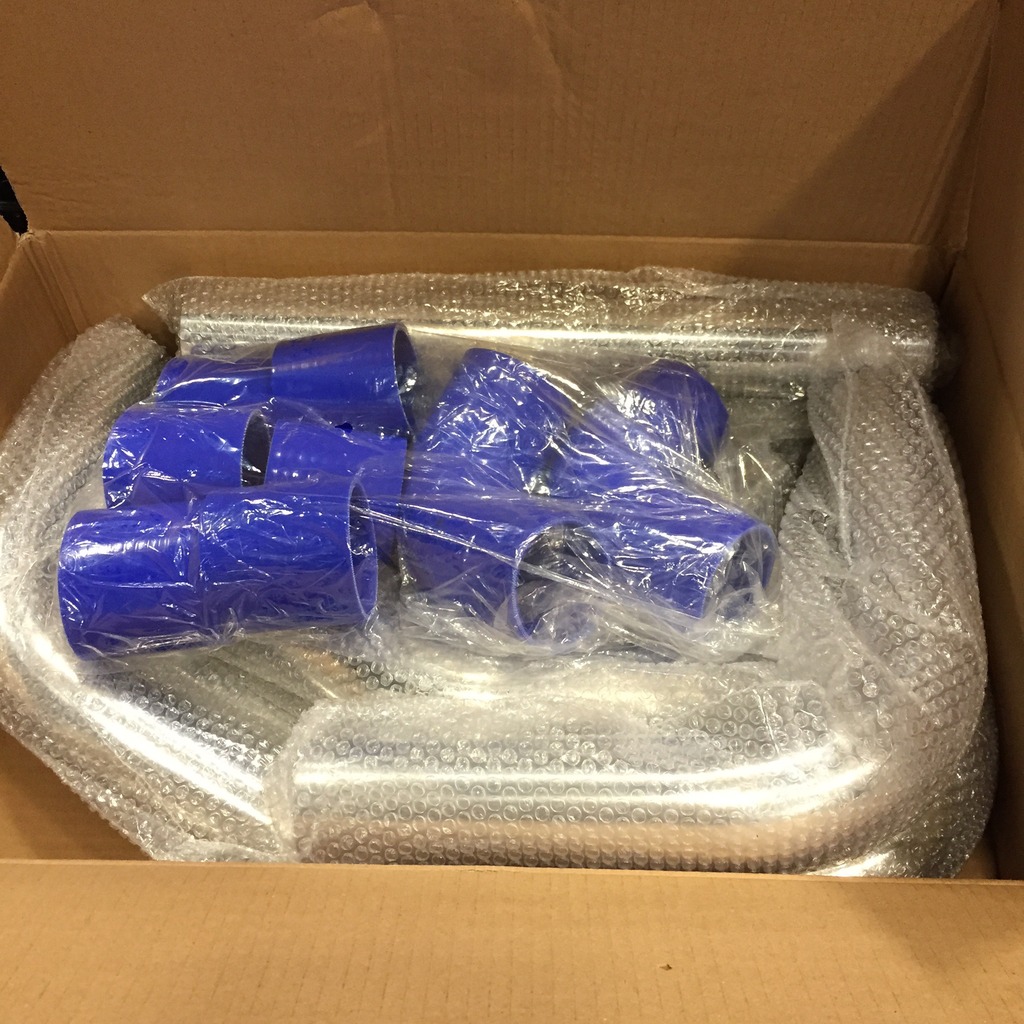

came with enough pipes and hoses to make a good set up and air intake maybe all in 2.5'' bore

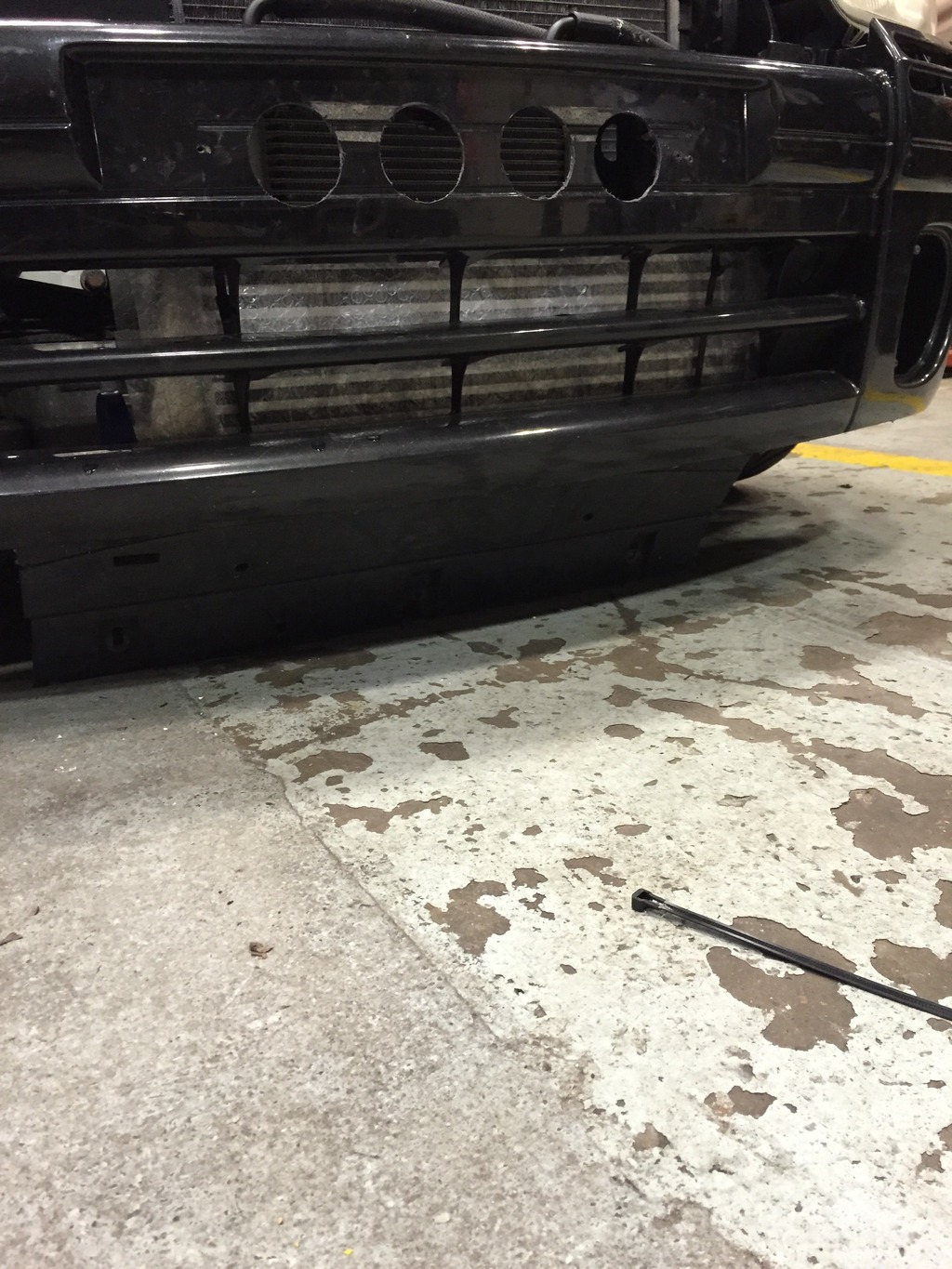

fitted up very well in the space with no gap top or bottom, also closed in with the tow eye bumper plastics, will make a guide to block off the other side too
hopefully creating max flow through the cooler
NorthloopCup
You need to completely shroud the intercooler mate for maximum efficiency. I did it on my Astra turbo intercooler and put a frame that followed the entire opening and contour of the bumper. Worked really well, hence why I've done something similar on the radiator for the cup.

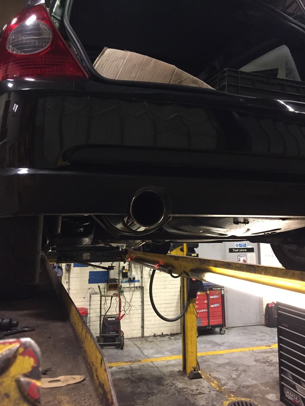

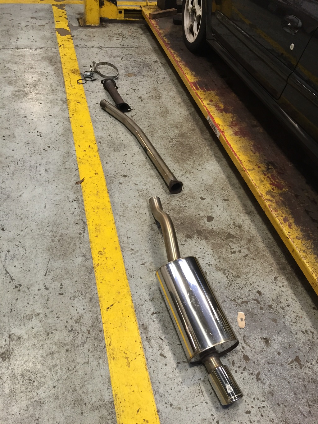

Managed to get my exhaust fitted today
Bought a k tec super sport from a local lad a while ago, so should sound rather nice
Far from perfect but will do for now

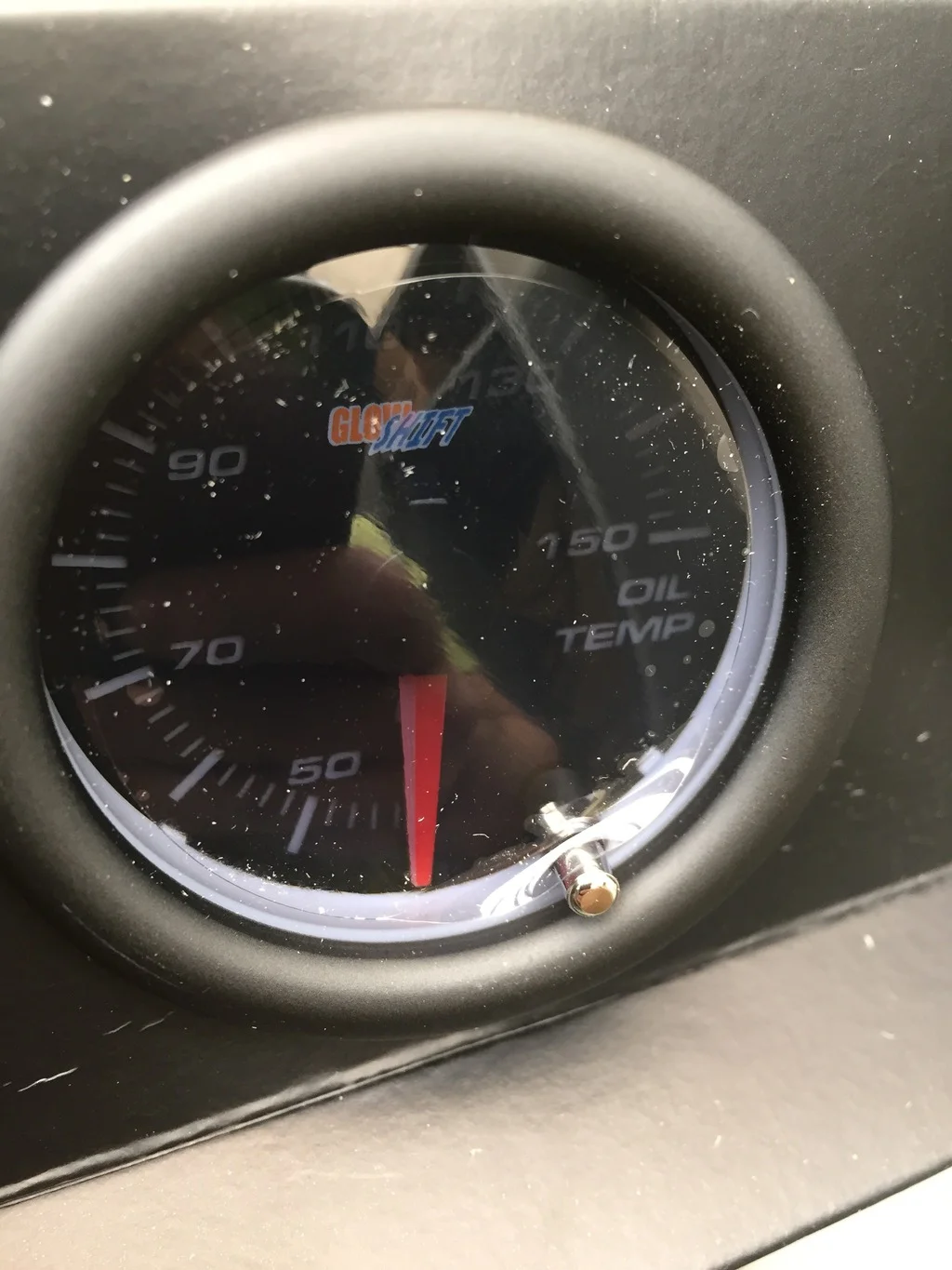

My s/c oil temp gauge turned up from the states
Quite hard to find the range required tbh. charger oil inlet temps can not exceed 80.C so needed one that reads very low temps as most start from 50-60.C and are not very graduated. Also did not want to spend a lot of money the stack one I looked at is £94 + vat fk that .

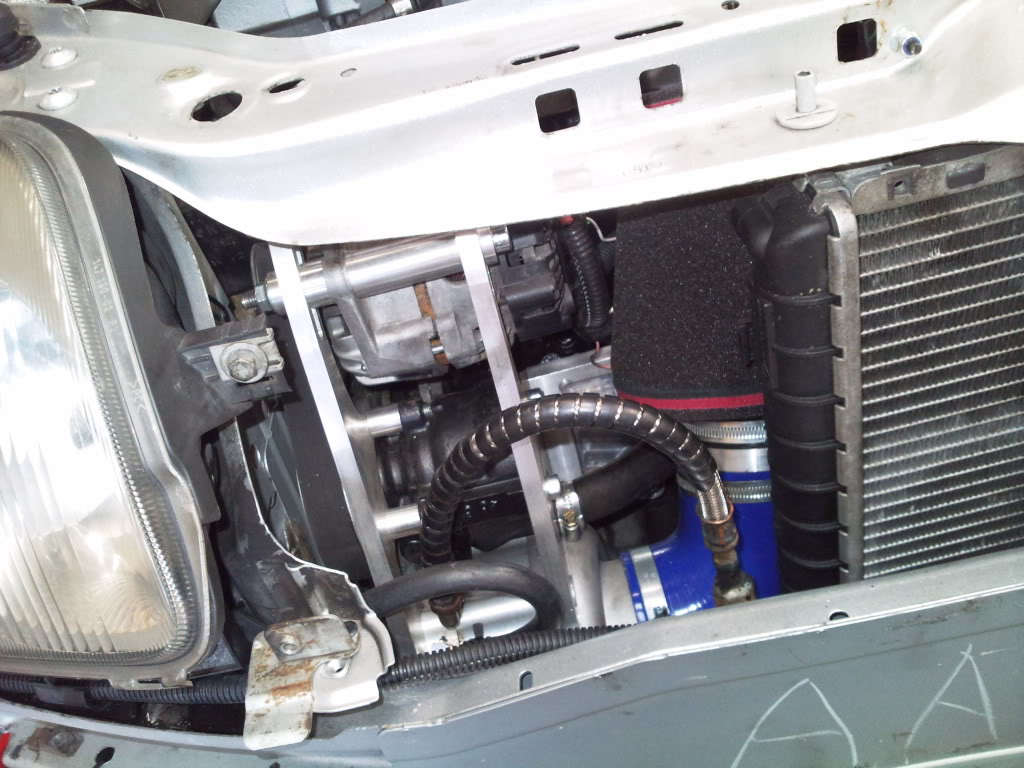

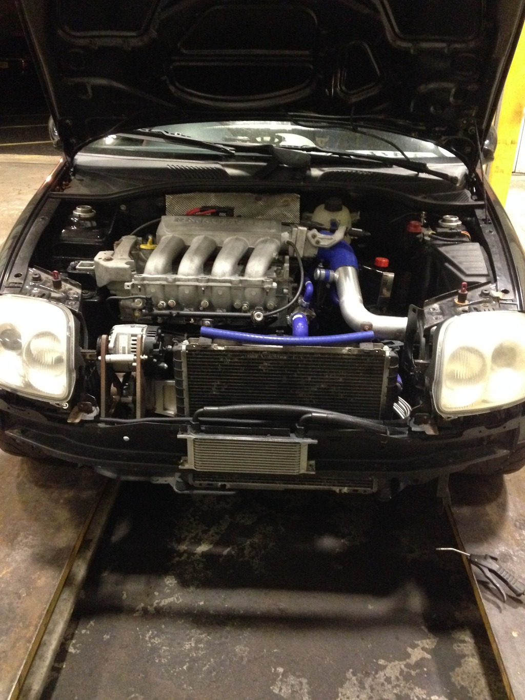

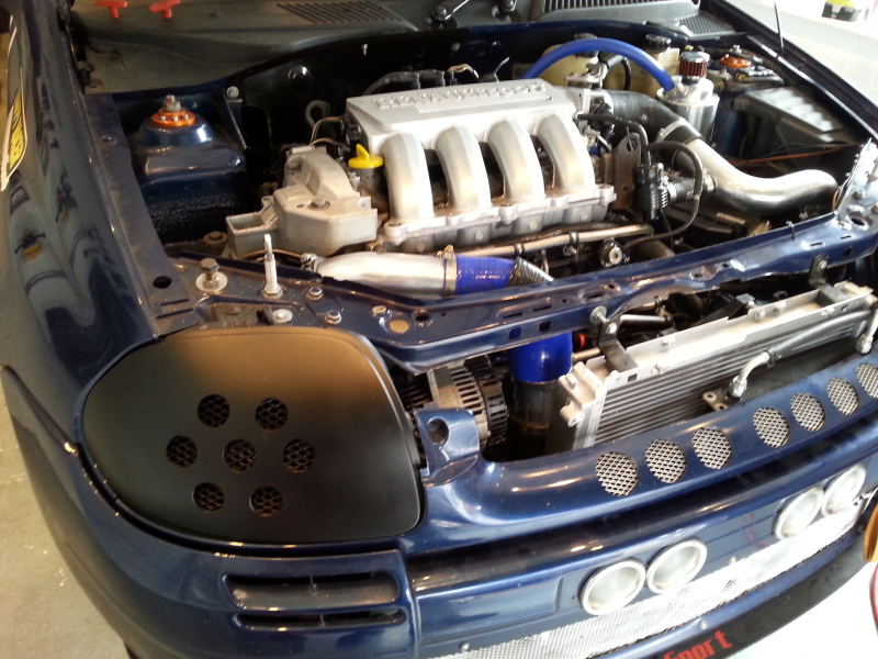

So turned my attention today on filtration and location, I am going to go short on the intake side of things instead on the massive pipe reaching all the way across the bay ( not that there is anything wrong with that, I just preferred this way )
So the main problem faced here is space, it's very tight and places the filter directly behind the radiator not good for intake temps
So my plan was to move the radiator over slightly, hopefully allowing me a bit more space to locate the filter and get a bit of heat protection in too

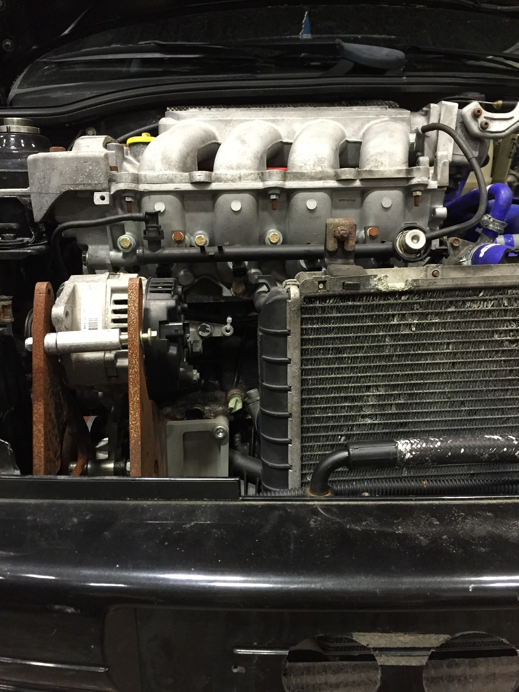

Before

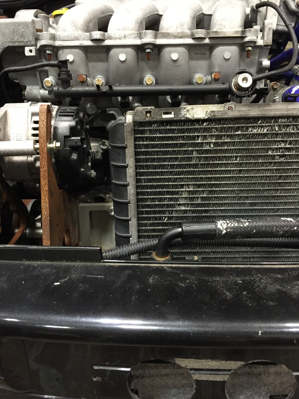

After
Not a massive amount of extra space, was about an extra 45mm of room but should allow for a decent size filter and hopefully a decent bit less heat soak from the outflow of the radiator
I could go smaller on the radiator but the standard one is rather good at its job ( will be a new one fitted as this one is scrap )
Imo I would be looking at other factors first, like filter location, you have your filter directly behind your radiator
Then maybe look at a more efficient / larger intercooler and a bit of shrouding to force air through it , your intercooler looks fairly narrow in your pics
May be worth looking at as the cheaper option
RMDavis
I will be definitely making up a new intake/air filter location and routing. It's currently sitting in a bloody hot area.
I'm pretty sure the intercooler is up to the job. Although some shrouding wouldn't be a bad idea!

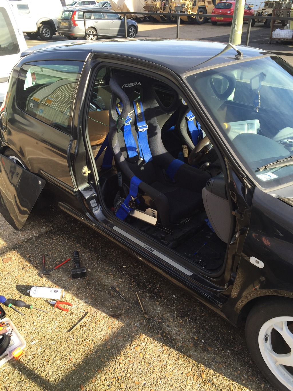

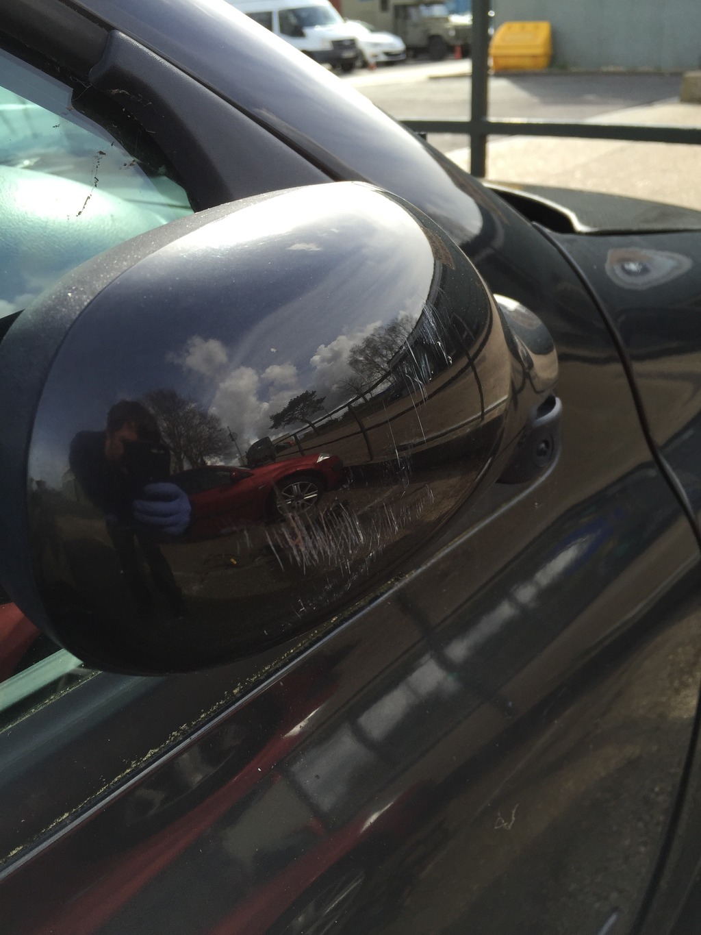

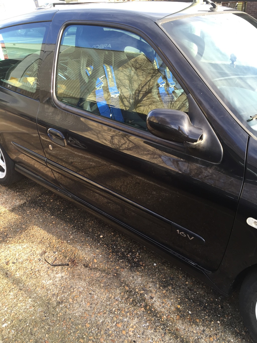

so had a bad week this week
storm Katie had my pants down
decided to run a bike shelter down my door and mirror
does anyone know if a ph 2 door will fit on a ph 1 ?

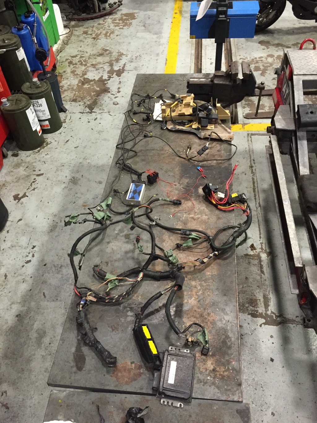

managed to get the looms and ecu's fitted, but would like to fit them in the glove box are if possible so will maybe look at making that happen, probably after my afghan trip now though
lots of wires
