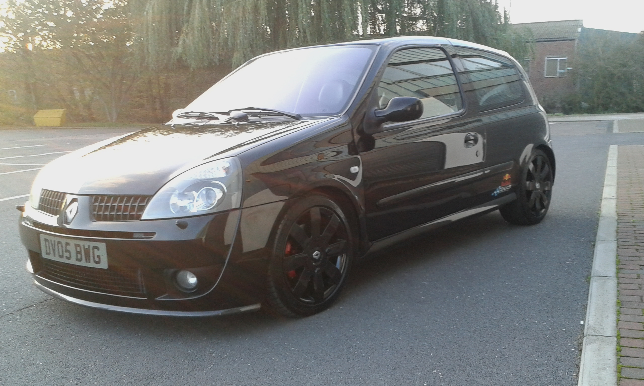

Hold on its guna get bumpy....
  clio 182
New lowering springs !!!!! and my old lights back on....
It sticks to the road like glue now.. but don't hit a bump....:weary:
  clio 182
i think the old ones look better, although wanted a tinted light that was subtle not chav..

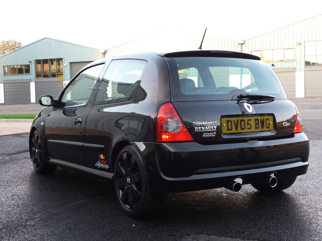

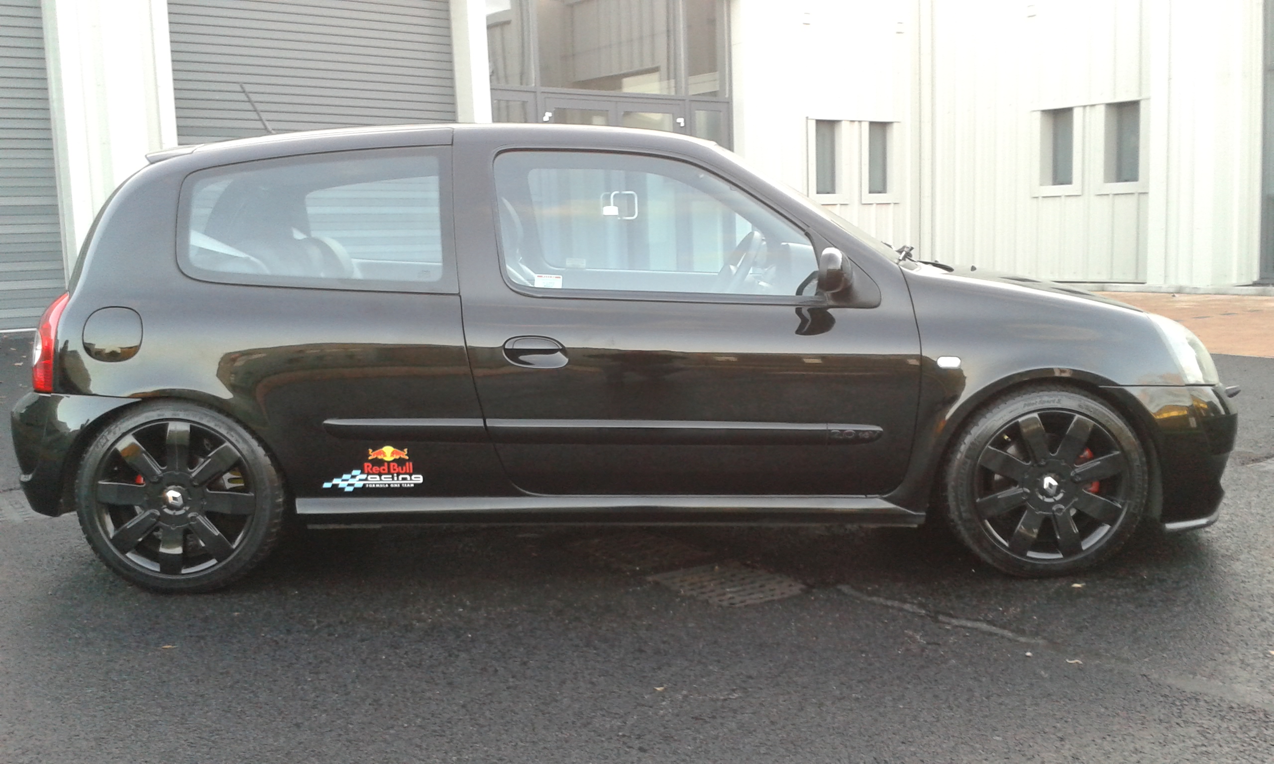

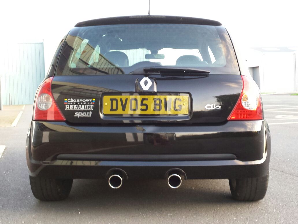

1) have you put a load of rake into your suspension? rear bumper looks high compared to the front. Not a bad thing, I dont think?
2) is that an aftermarket exhaust? Check your hangers fella, it looks low....but could be related to above.
  clio 182
it was a bit higher previously , but the springs have leveled it out its on a slope., its a sportex exhaust which is not the best but was on the car when i bought it.
to be honest i don't need an F1 lesson... as i said previously, i wanted it to look like the 200, personal preference..
if you look at the top picture its level...

The exhaust does look level - just seems to sit low. What system is it?

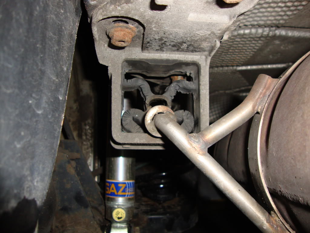

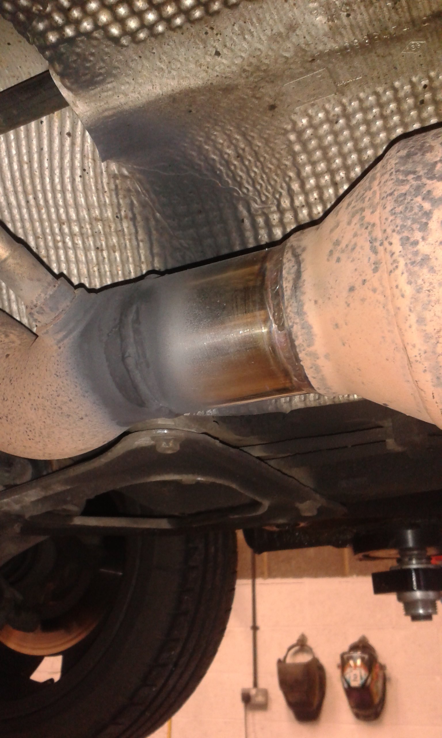

What condition is the rubber like on the two rear hangers? Whilst they might be level, it could mean the rubber on both is completely destroyed and its resting on the metal frame.
E.g.
  clio 182
just had a look and they are not great, will go and get some more... I do need to sort the exhaust though as the cat flange (sounds odd) is a bit passed it, been trying to get a second hand cat, but struggling... so was going to go for a whole new exhaust that way its all new and hopefully no problems.. thanks for advice tho.. that's what I came on here for friendly advise... Mark

Common mod on the exhaust is to get the cat & exhaust olive join cut off and a sleeve welded on. They tend to blow from the join or crack with age.
  clio 182
WAs just goinf to get a cat link pipe and see if that works.. still have to find a cat for next years mot through...
E.g.
Mine had this problem. it was fixed with making a new rubber bit out of Tiger Seal. Seems to have worked. Although I now have another exhasut rattle when carrying a passenger :-/

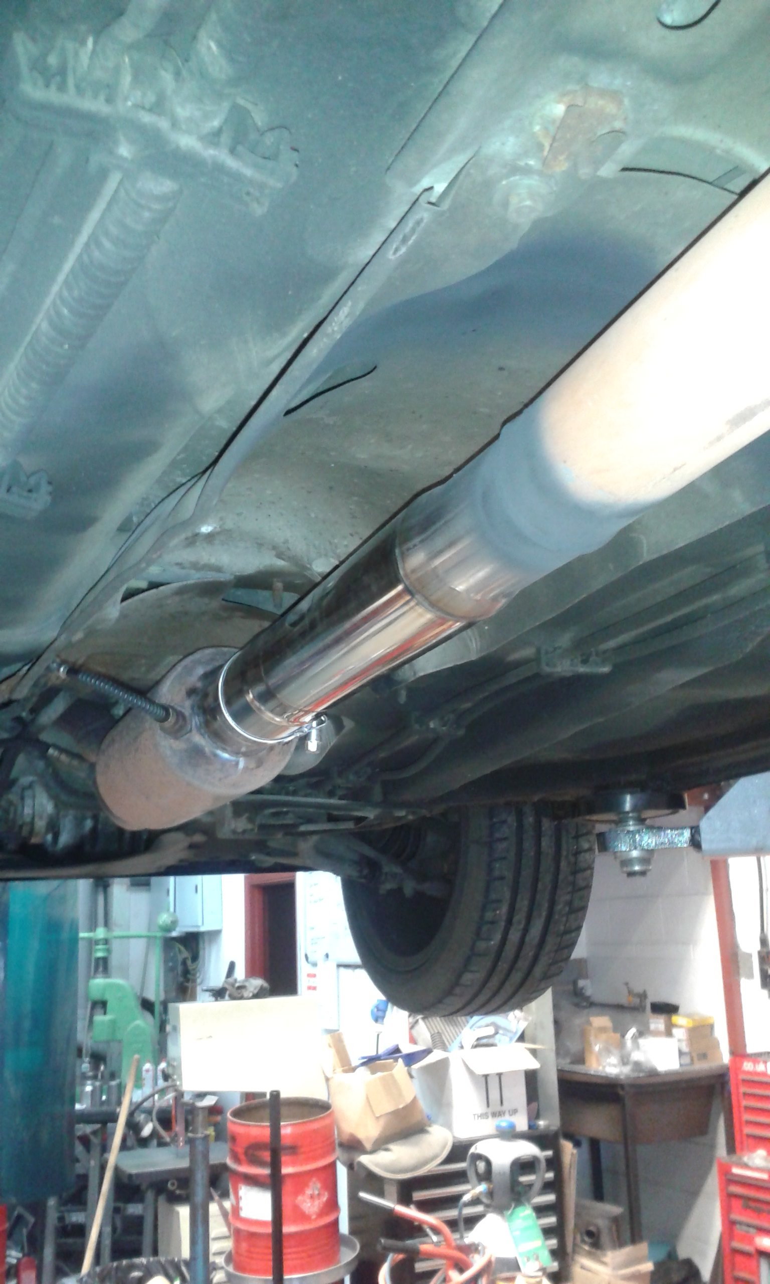

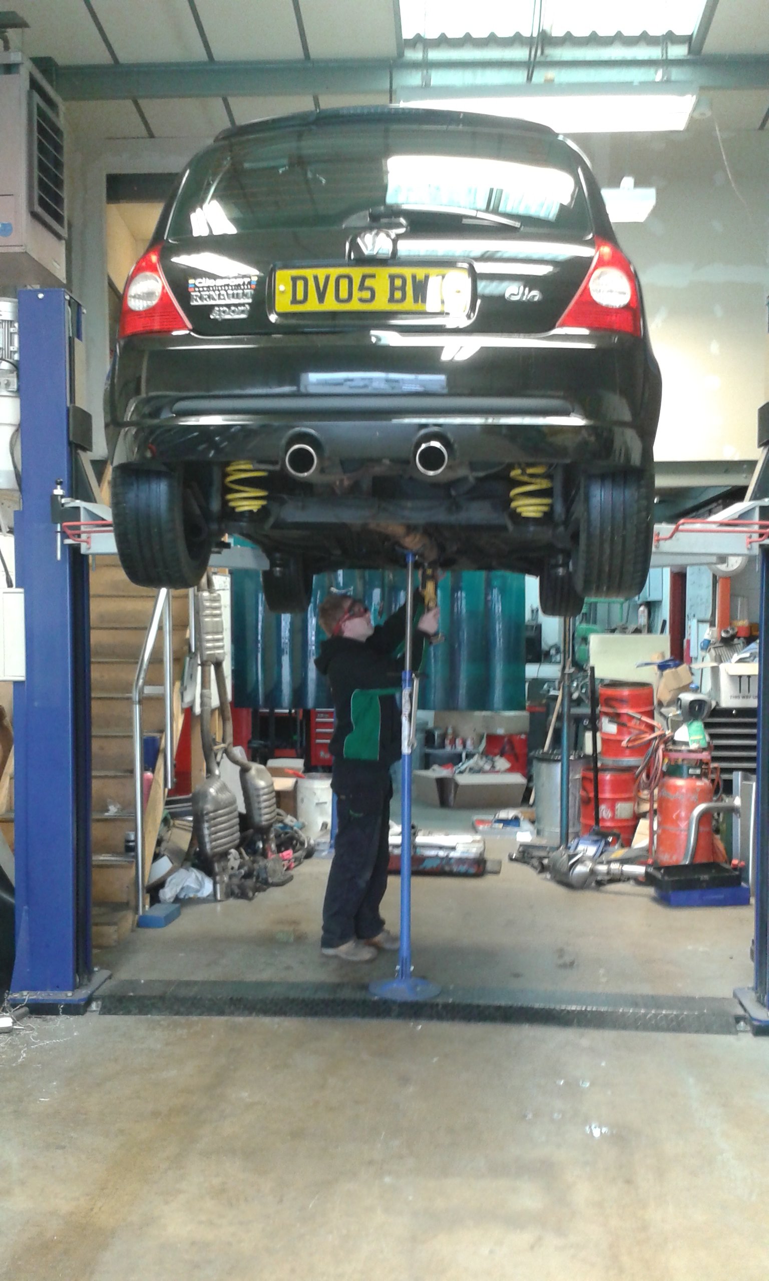

getting my car sorted at JC Weld tomorrow.. £60.00 Plus Vat.. will post pictures..
