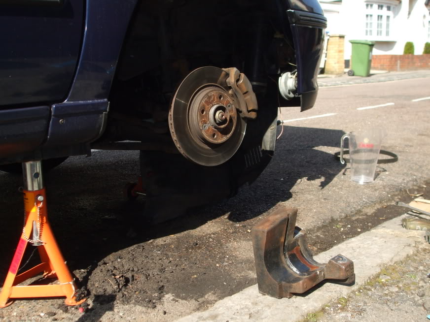

  CursedTitanium 182FF
Looks a bit like this.
Can get to it from inside os/f wheelarch.
Worth finding that and getting rid!
