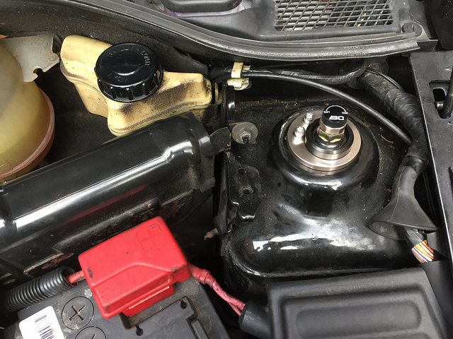

Here's mine when they were first fitted (ignore where they are camber/caster wise, since been changed).
BG 182
by Niall97, on Flickr

Definitely go BC Mounts. Can't see a reason why not, same as the AST and KAM ones. Only £66 as an option too.
BG 182 by Niall97, on Flickr
