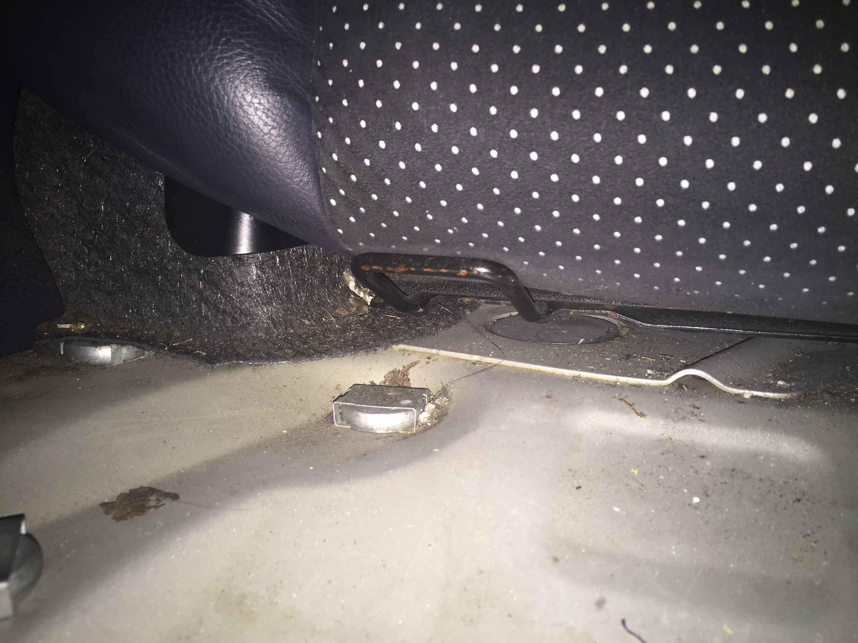

Wanting to fit a harness to my Clio, but want to keep the rear seats as i'm only having harness for the drivers seat.
Has anyone fitted harness to the ISOFIX
I'm going to get these harness to they have the clip in fittings

I used to have harnesses fitted to my old 182 with the rear seats fitted. I used the isofix bolt and fed the 3rd point harness underneath the bar and fixed both down with the bolt.

One bucket seat for the drivers side with harness and original seatbelt and original seat passenger side.
What's the best way to attach the harness keeping the rear seats in?
  Clio 182 FF
done a little research, if the ISOFIX is designed to secure a baby seat to the chassis of the car, surely it would be up to the job of holding harness?
I may see if I can get some slightly bulkier hooks on the ISOFIX welded on.
Opinions and knowledge please?

You can remove the isofix bar and fit harnesses whilst keeping the rear seats.

Sorry to bump an old thread, but just wondering if anyone's got pics of a three-point harness threading through the rear seats? I want to stick my back seats in while retaining the driver's side harness in the front, bolted to the Isofix bar hole in the boot (presently the rear of the interior is stripped but I've calculated that it's barely earned me 4hp per tonne improvement so I'm going back to a more OEM ish look).
Just wondering if the harness will thread through the back bench seats neatly to reach the Isofix hole or if there's a bend in the harness to reach it? In my mind it'll be fine but just checking nobody's had any issues before I dedicate my Fri morn to digging all the bits out of the shed!
