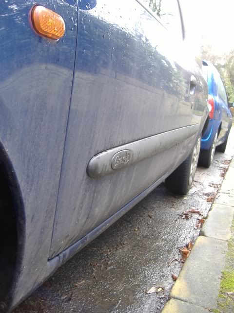

My subject was my little brothers Clio Grande. I think I can count on one hand the amount of times it has been washed in the last 4 years he has owned it.

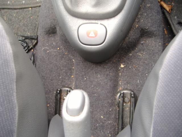

I then went to the interior... bit minging in here. Just a hoover out and a quick wipe down with a water and fairy liquid combo. I hate doing the interior...

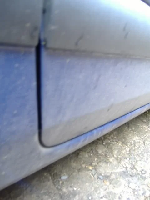

Before photos:
And what is this? Well apparently it is a scone which is at LEAST a year old. Alongside this I found a 5 pound note and a couple of quids worth of change under the front seat.

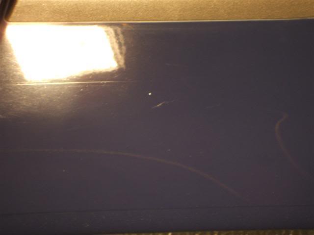

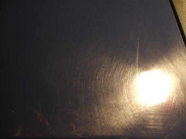

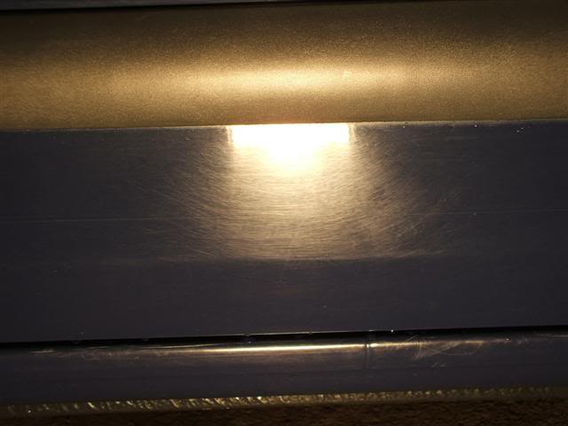

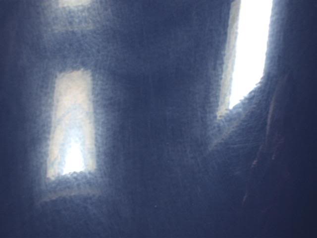

Before I post the afters this is the reason why I am disappointed with the end results.

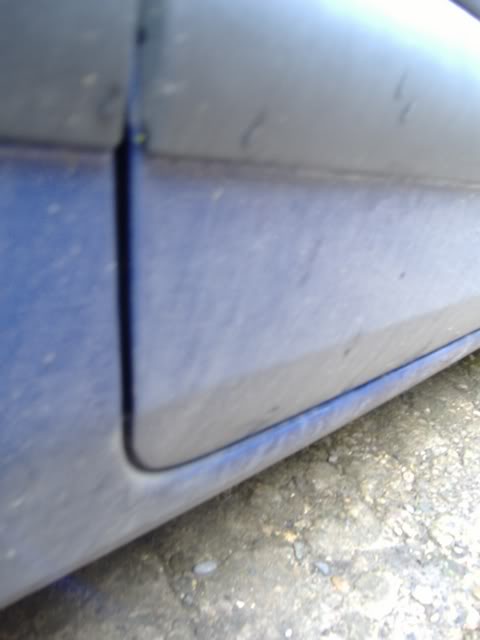

So before
And afters:

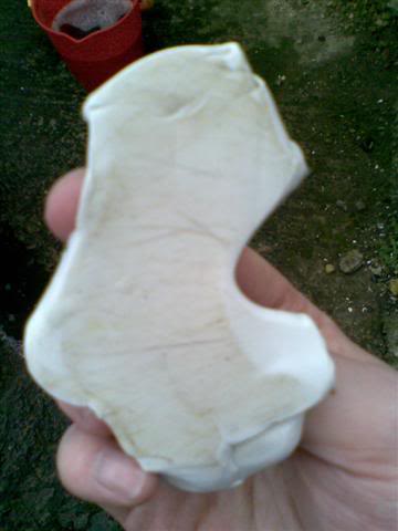

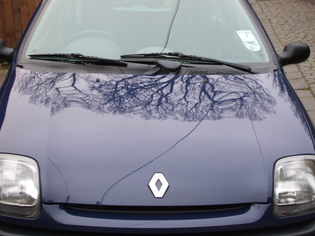

Clay from half the bonnet:
Yes photo quality on the after photo is rubbish BUT there is still some paint imperfections there. Still I reckon a good turnaround considering my knowledge and expertise.

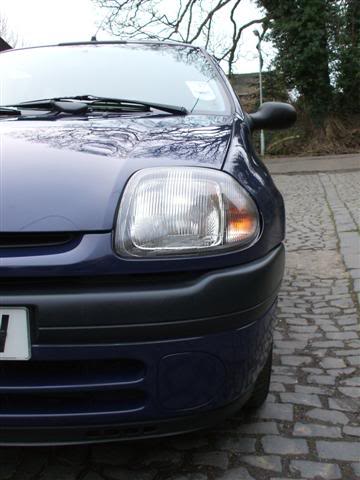

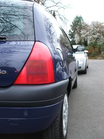

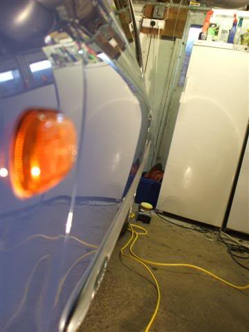

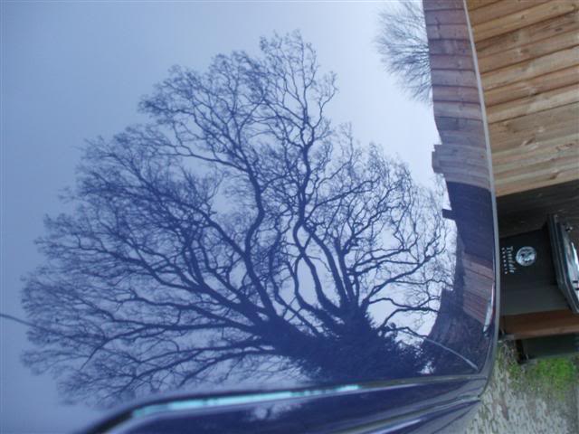

Now the afters:

Anyone got any suggestions how to nail the deeper scratches? Is that more of getting a better technique or getting a stronger polish?

Scratch X is quite mild far from Lethal IMO, akin to Megs 9 and 82, so more mild than the SSR 2.5 Eddie has used already.
Have you got any 4 inch pads, a light cut pad 4 inch pad with SSR 2.5 to give some more cut would be my first route.
If that does not cut it, then I would step up to something like Menzerna Intensive Polish
DrR

How can you be dissapointed? It's a car thats had no care paint wise at all and it came up that shiny.

To be honest I am a perfectionest... I was hoping to shift alot of the "deeper" scratches. But my bros happy with it so I guess thats what matters.
Practice makes perfect though... will pc my Cup in a couple of weeks.

Top work Eddie. Your not giving yourself enough credit for that. It's a great result you've got there, especially your first attempt.

Looks loads better... paintwork is soooo much better. Has so much more depth to it... I recon I've removed about 80% of the scratches and most of the swirls if not more.
Will crack on some more Collinite next weekend to finish it off properly and put some AIO on the doors.
