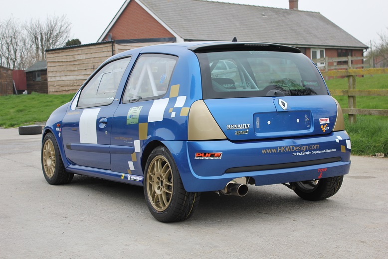

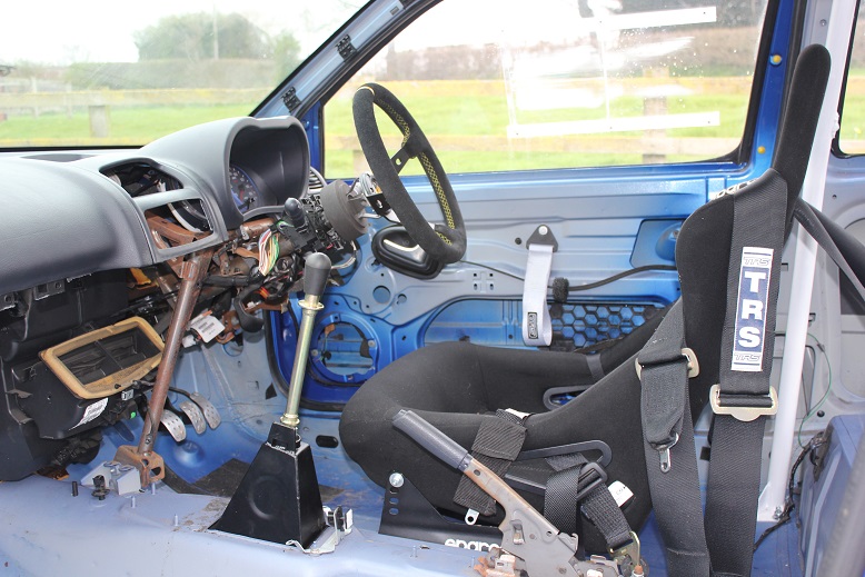

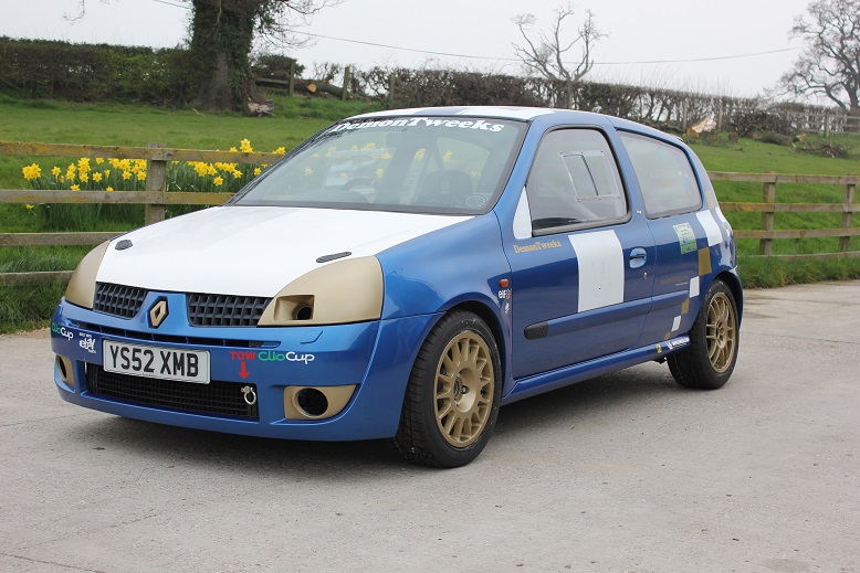

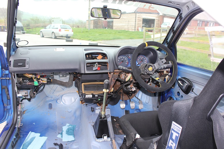

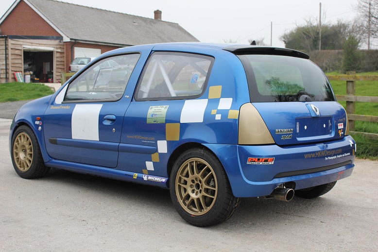

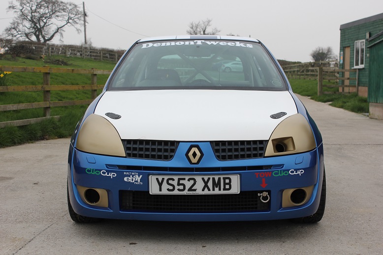

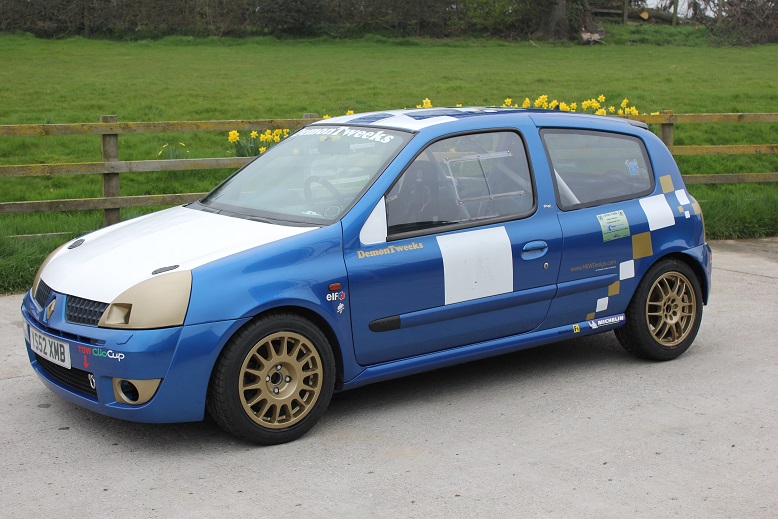

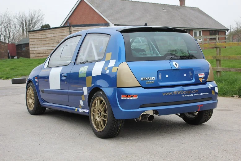

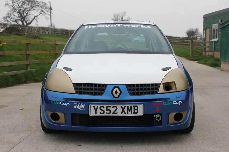

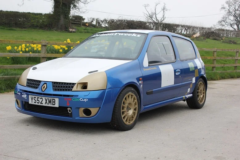

So after i decided to completely change alot of the car after last season here is what i have come up with
the spec is
JMS RS2 intake system
Magnecor HT leads
Custom oil catch tank
K-tec solid top mounts
K-tec Race spec red solid engine and gearbox mounts
Iridium Spark plugs
PMS linkage kit
KW V2 coilovers
Whiteline Arb
18mm fromt spacers
15mm Rear spacers with camber
Ktec recessed system
Custom half cage

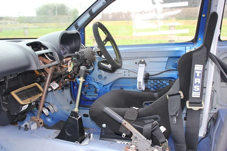

Sparco Sprint seat
Omp corsica dished wheel
Headlamp blanks
2118's in white with dunlop direzza
2118s/f1 with toyo R1R
Probably missed something but still have my Wilwood Calipers to fit :)

looks quality mate! look forward to competing against it!
should it be much faster than last year?
  Clio sport cup
Im hoping so! lol but its all trial and error will find out this weekend how it goes, the gear shift though is sweet

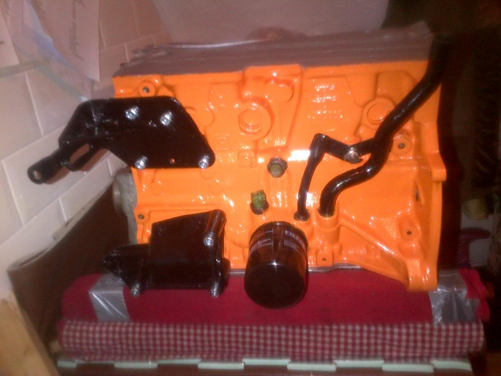

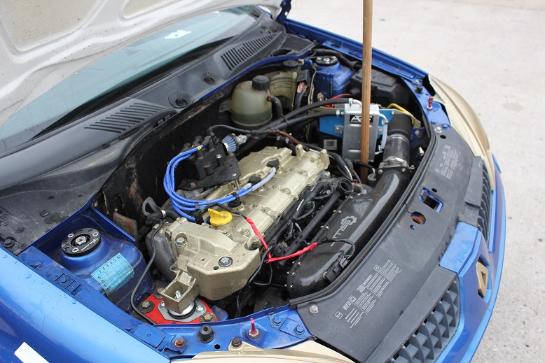

ive sold the 1.6 8v i was running last year and replaced it with a 1.6 16v that ive rebuilt in the kitchen haha.
the engine will be running jenvey throttle bodies, bigger injectors(from a clio 172 haha) ultimate fast road cat cam, all new valvetrain, plenty of head work, L&B flywheel and pullys, baffled sump, solid mounts all round and on omex 600 management. so should be fairly tasty compared to last years 108bhp haha

even with that spec i dont think ill have as much power as your clio im aiming for 170bhp but with good torque figures. and i already have a quaife diff in my current box, but this year ill be running super sticky avons so fingers crossed traction wont be a problem.

i think its 350mm cant remember though lol yeah ive gone a little mad, ive done alot more than planned one thing led to another, i love how the jms looks and sounds and the kws are mint, if you ever have a spare few £££ get the pms shifter! as for mounts ive only run the car on the hill with the engine and gearbox mounts and it felt alot smoother, well worth doing!

Well done a few changes including fitting the Wilwoods which i must say give a much smoother response though dont really get chance to get used to them only doing a mile each run!
After the first event the car appears to be running well just tweaking the setup now as im getting far to much spin up in 1st, 2nd and 3rd gear.
Next job is to have a new loom made so i can reduce the amount of redundant wires :)
