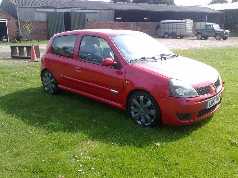

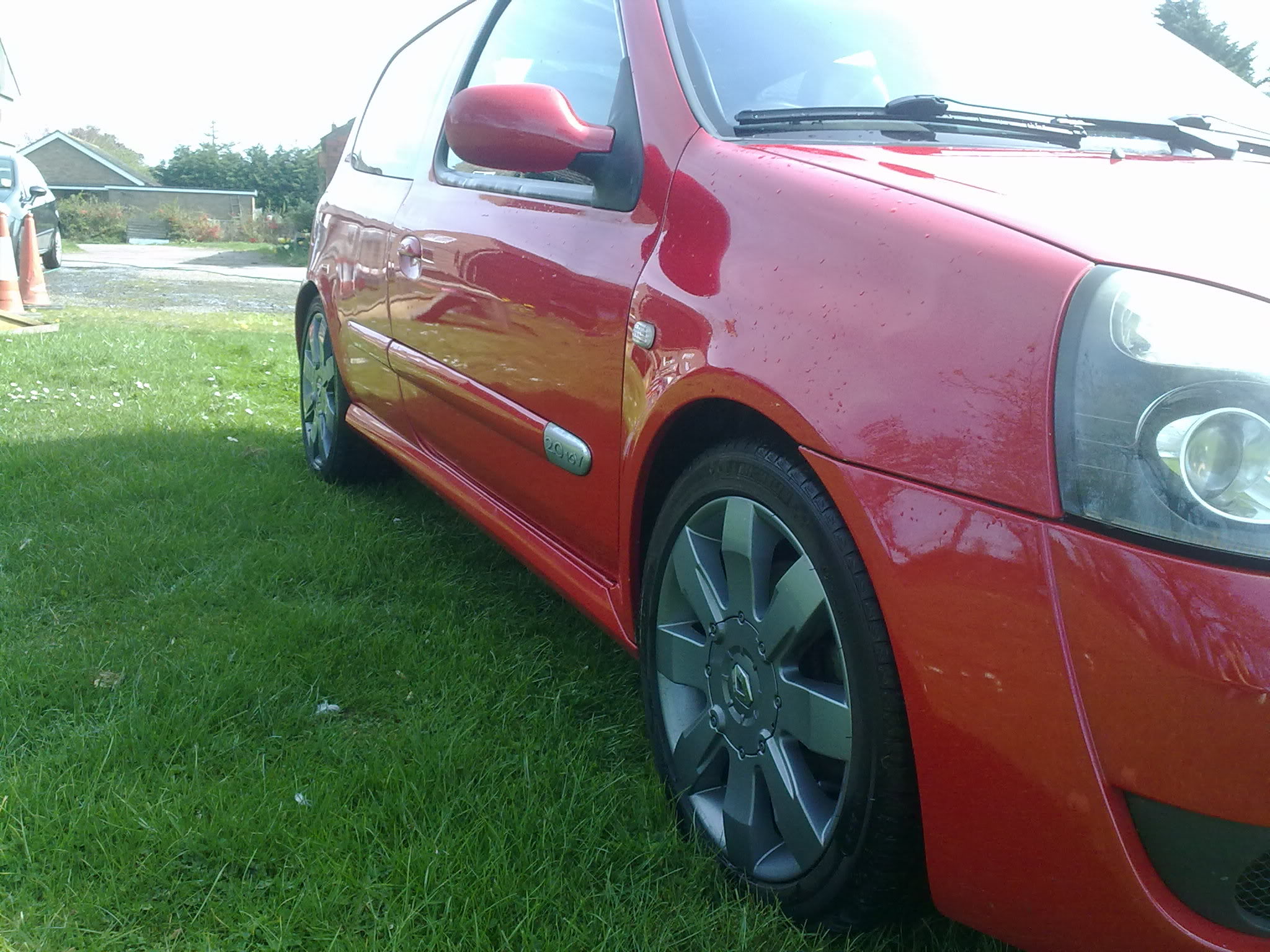

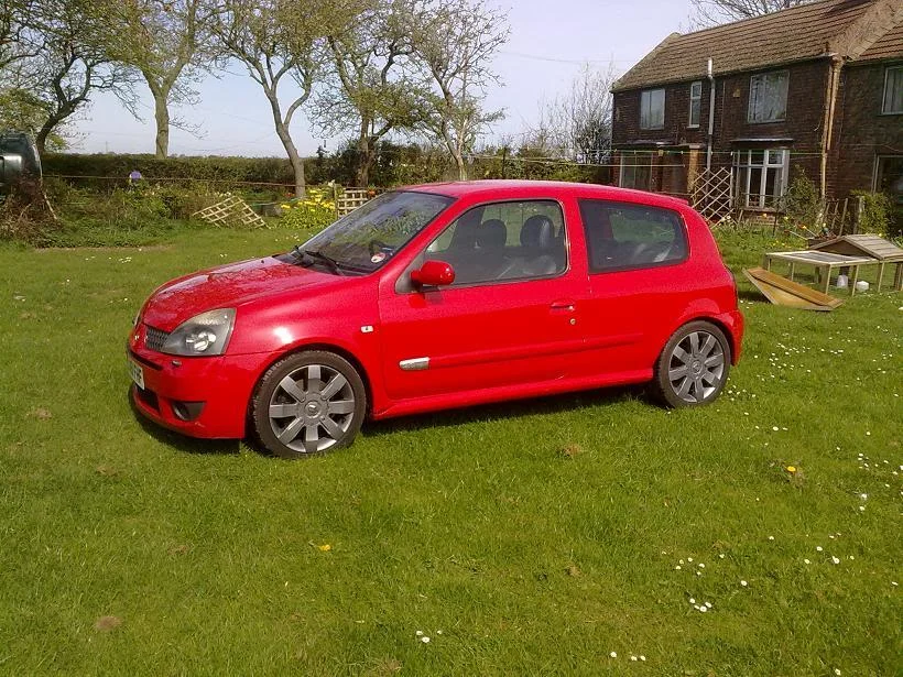

Prolines are the black springs which will lower it approx 15mm, sportlines are the red springs which lower it approx 30mm.
You can just change the springs and keep standard shocks if there in good condition. You'll have to get the tracking done after fitment though. I had the sportlines on my 182 with standard wheels and on a few days with 15" wherls and the came on my ph1. Better than Apex for comfort and ride quality but not for looks. I also agree thet they are better than cooksport springs too for the same reasons but that's my personal preference.
sburrell93
Scotland - South
In a nutshell, yes, you'll feel bumps slightly more, but the car will generally handle better. Its safe to just change the springs, unless going for a huge drop, and they're a lot better than apex springs.
What are you fitting these to though? Non-sport clio or a 172/182 or what?
  172
Yes proline are meant to lower 15mm but in reality they lower more!
New genuine 172 cup dampers and prolines....
