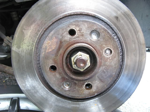

This is where im at:-

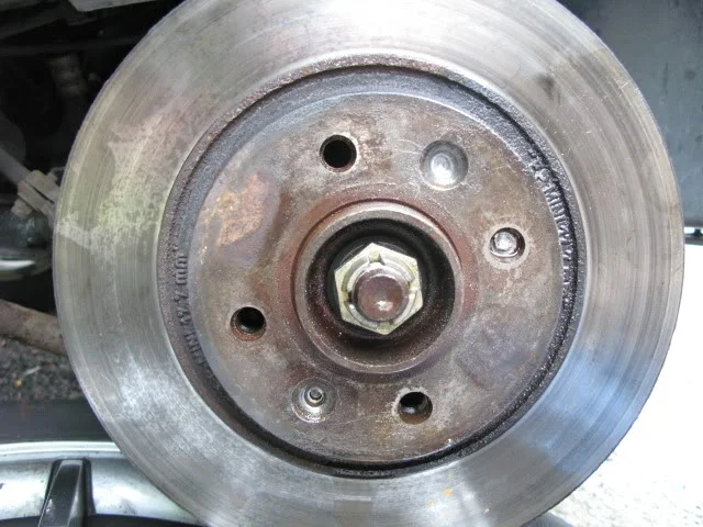

Should it just slide off now? Or does the hub nut also need to be off? Or do I need to drill the torx bolt right the way through? Ahhh help!
  Suzuki Ignis
The disk should just come off now mate!
Well it aint coming off. Ive been at it with a hammer too. To me it looks like the disc is held on by the hub nut. How else it it being held on?

I know how you felt mate!. Yea looks like it it should. If you are drilling them 10mm bit does it. Don't snap a tool off in it. The middle nut doesn not need to come off. It slides over the case around that nut. The disc may just be stuck on a bit. Give it a good slam..just trying to bleed the system now after the new lines...taking a while!

Hit it harder , with a bigger hammer till it comes off. Itll be corroded on to the hub, so tapping or gradual pressure wont shift it. Brute force and ignorance FTW!!
  RX8, Clio II 1.6 16v
I suggest bashing the back with a rubber mallet while rotating it round a bit at a time. Or grab both sides and pull back hard shaking it from side to side (making sure you dont pull the car on top of you).

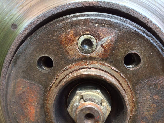

Bit of a bump here.
So I'm on with this job at the minute and have got a bit stuck.
I've drilled I assume as far as the threads in the bolt and now the drill just wont budge at all, seems to be doing nothing.
When can I start knocking the disc with a hammer? How long do we think I've got to go?
Attached a pic,
Any tips would be great cheers.

You've got about the same to go again before it'll come off.
Small sharp drill to do a pilot. Then up the size everytimw
You could hit the disc with a hammer without even attempting to remove/drill and it would just shear the head of the torx screw off - but I wouldn't recommend brute force where it isn't strictly neccesary.
I can't see your image on this PC but once the head is drilled off you can remove the disc and then continue to try and rescue the hole with greater visibility.
