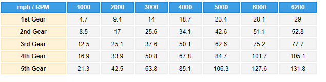

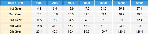

Twingo has a JH3169 and the clio a JH3186, here are the ratios vs each other. Twingo is listed with my higher rev limit of 100rpm though. Both based on running 195/50/15s
Twingo
Clio
  Clio III 1.2 Tce
