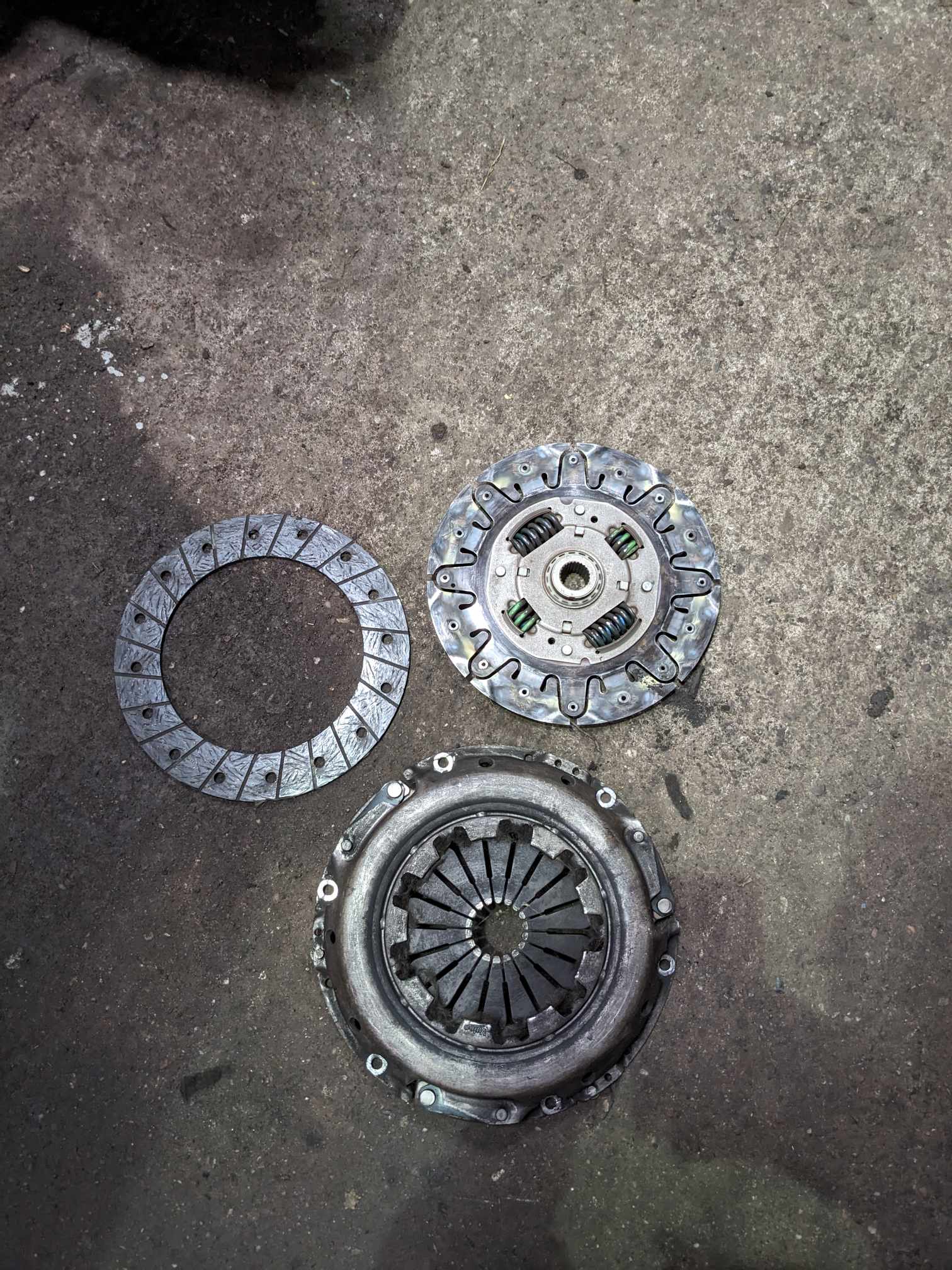

I killed my OEM one at Cadwell, replaced with a Sachs performance one.
