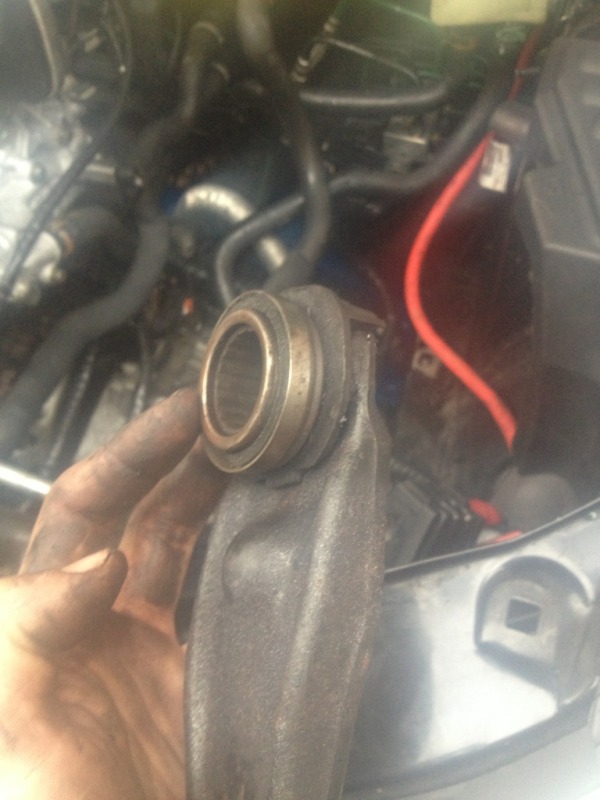

I think it's safe to say i have the bearing the wrong way round...
I moved the washer the other side of the lever in order to gain some kind of drivability. Anyway box is loose now, just need to wiggle it off tomorrow then put it all back together.
  Trafic 140dci
What a chore that was! much easier to do with engine out of car lol, box is now off, as i thought it all can only go one way round and i had it the right way!
This is how i had it, neither the bearing or arm can go any other way. New clutch cable on order, also replacing the bearing just incase that's a cheapy, i know the clutch is ok as it's off my ph1 and has only covered 2k.

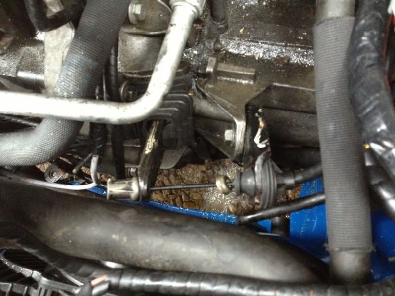

Me too tbh, just removed the old one an replaced with the new one, there just doesn't seem to be enough slack at the gearbox end. Yes it has 2 weights on it. Going to get some more pictures tomorrow.
did you clean/de-grease the clutch and flywheel, and de-glaze the flywheel face with coarse sandpaper before fitting?

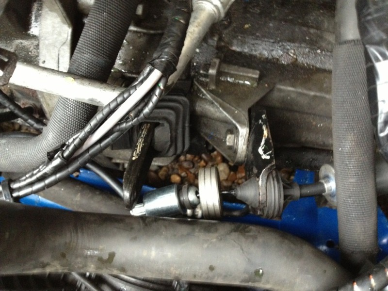

I don't think it's a problem with the clutch/flywheel. If you look in the photo below at the lever for the clutch on the gearbox, the new cable is that tight that it moves probably half way back once the cable is just in. (the picture has the old cable) I know that isn't right from my ph1 which i had the engine out of twice, i could put the clutch cable in and out with ease. I will get a photo with the new clutch cable on tomorrow.

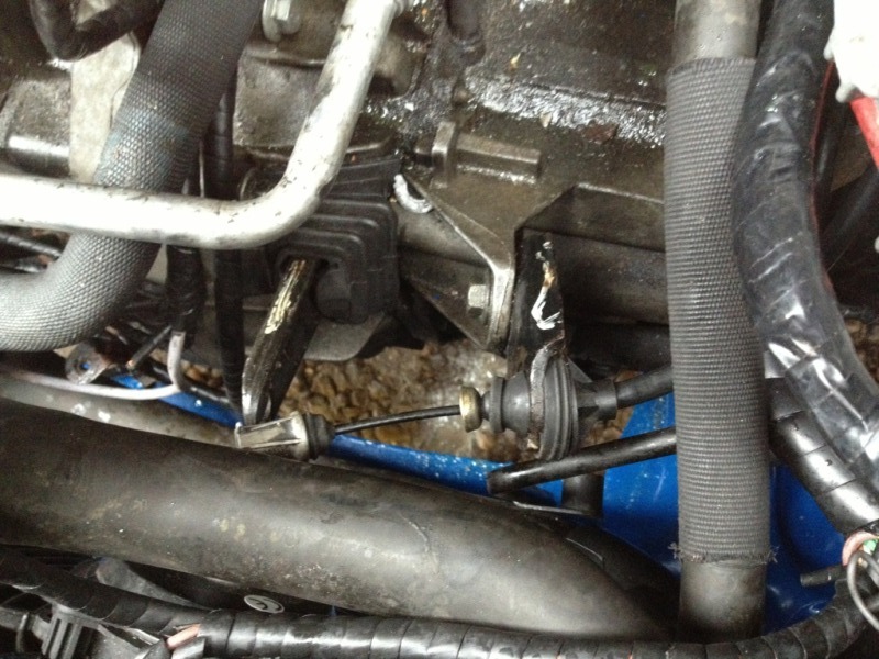

Anyway got a photo of the new cable against the box, where you see the lever for the clutch on the gearbox is where it is sitting when the clutch isn't engaged, the cable is almost out as far as it will go, probably another 10 20 mm top's more it can go, so you can imagaine when i put it on the clutch lever it pulls it in quite a bit.

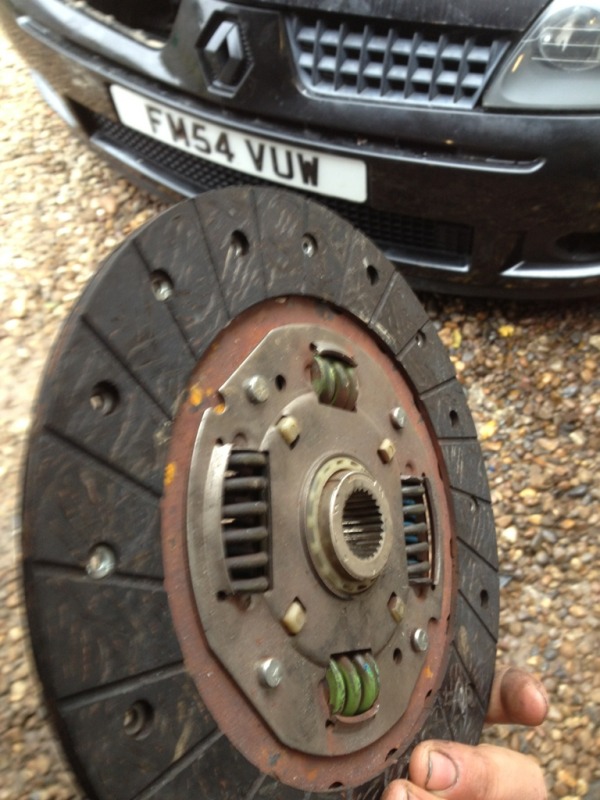

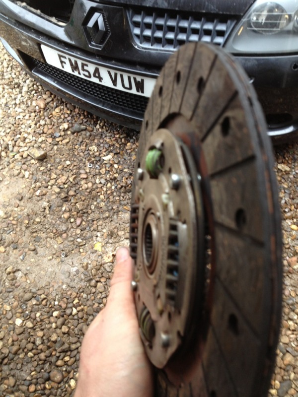

I'm now starting to think i may have put the clutch plate part of the clutch the wrong way round forcing that lever further away. So got a couple of pictures of an old clutch if someone could tell me what side faces the flywheel. I will get my engine out an investigate that next weekend.
Side A
Side B

first of all the new cable you have fitted looks completly diffrent to the one that has been on my car from new so maybe just check that its the correct part for your car!

New cable is 100% correct, revised part from Renault.
