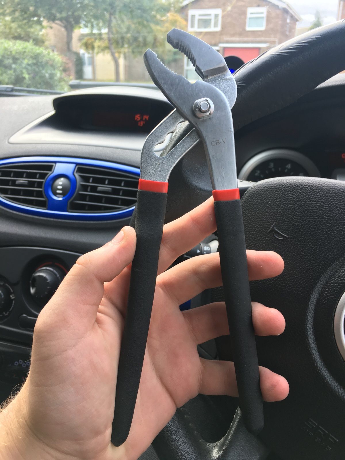

So first things first, take off the silver insert and get a pair of these bad boys

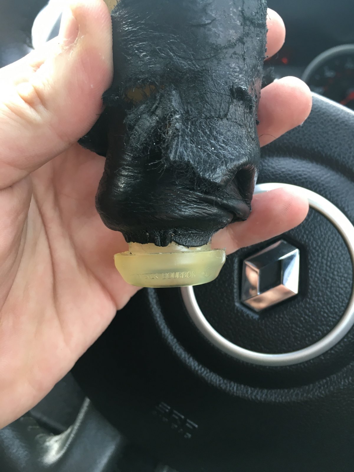

Or anything that'll grip onto the knob and twist until it spins freely, now pull the leather down until it comes off the the bottom of the gear knob

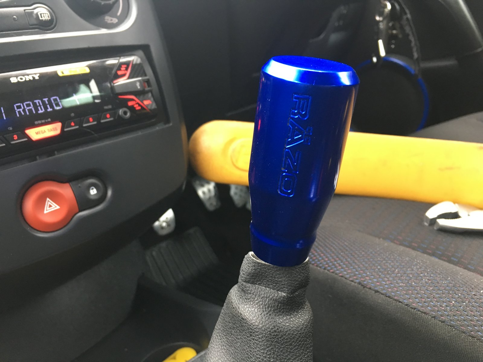

Now all you have to do is pull up, not very hard at all and it'll come off. I brought a universal blue knob off of eBay and it came with adapters, the biggest one worked for me and continue to screw down until it won't go any further and do the same with the new knob on the adapter. When you're finished it'll look something like this
Obviously the leather hangs down a little bit, I've used a very thin cable tie to tie it and I can't see it in the drivers seat so I'm fine with that

Why do you need to use pliers on it?
The original just pulls off eventually? Yes takes a bit to get off but they do come off and you don't destroy it.
mossyv6
  Trophy,V6,5GT,AG200
Looking by his avatar it's not a Clio sport and a 5 speed with no lift reverse.
Personally I couldn't get enough grip to do it, hence the pliers, if I need put the original back on I'll just buy one off of eBay

Hey, does that gear knob move at all when on? Wondering as the clio gear stick doesn't have any threads on it. Im looking to get the same one.
You said it used the largest size adaptor (is that a m12?).
