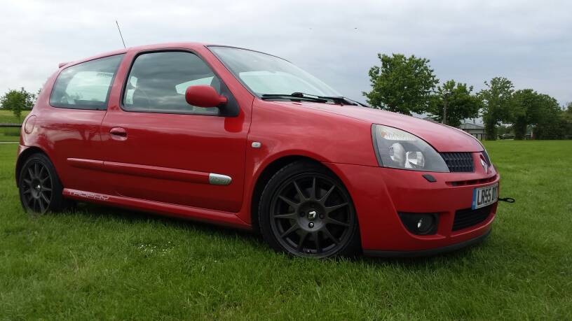

Clio 182 Trophy Turbo 322Bhp
  Trophy Turbo :)
Not had much time to do much of a Project thread on this but i thought id post a few little photos of the Trophy

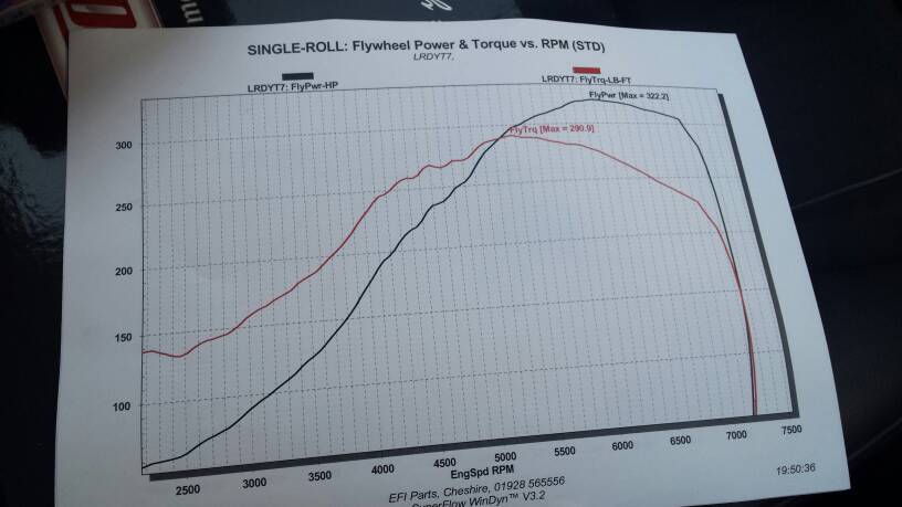

Gt2860RS
630cc Injectors
Mapped by Scoff at EFI and our selves. but all the mapping magic is thanks to Scoff.
We decided to keep it at 1.1Bar but i may get devilish and turn that up at some point to make more power :)

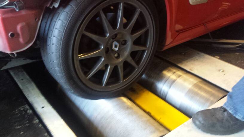

Even had to be upgraded to the big boy single roller :)

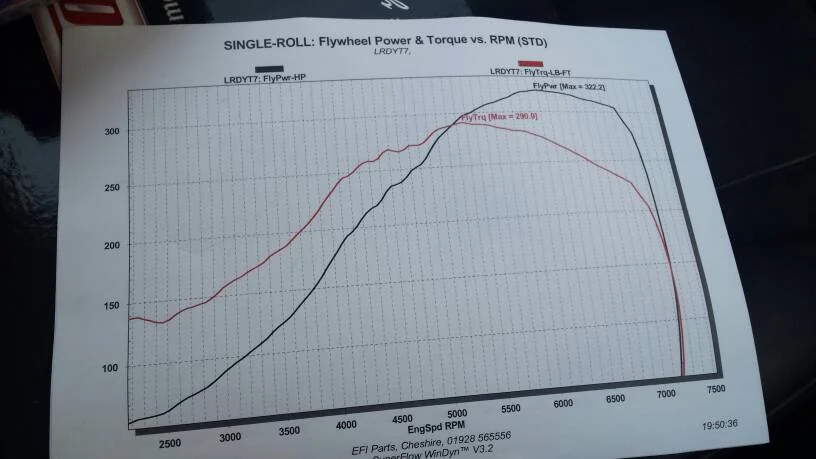

Its very well, as you can see from the Graph it pulls and pulls and doesnt stop, change gear and your back into the power band.
It delivers the power very very well and doesnt just wheel spin as you may expect, this is how we have set the boost controller up.
