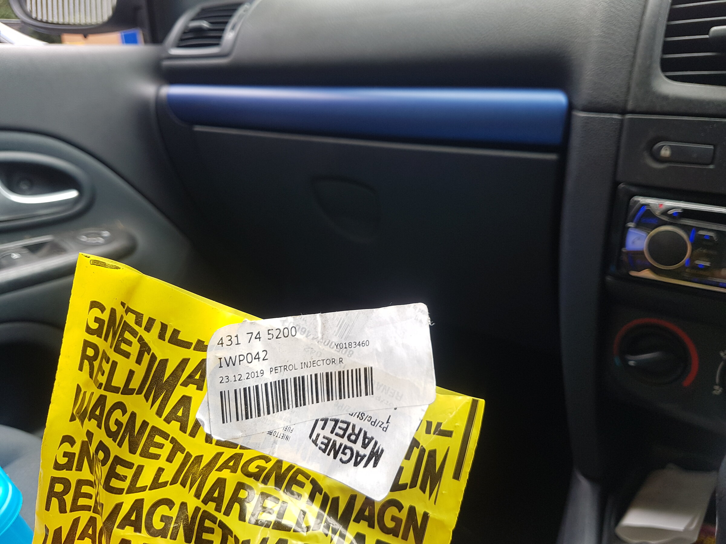

Awesome, Good deal on these if you've got honey installed. £47.35 with code. Car is sat on 102k and unknown of its past parts replaced and a trip to the rin in 2 weeks time, I'm thinking it's wise to have a spare in the glovebox

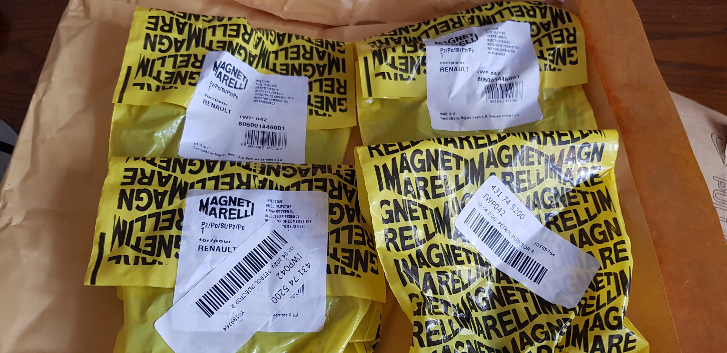

Just ordered four from Renparts. Don't currently need them but will be good to have spares. So many parts are difficult to get hold of now so trying to build up spares.

Ordered yesterday at 10:20 am and received today by 7:20 am, can't get much better service than that.
