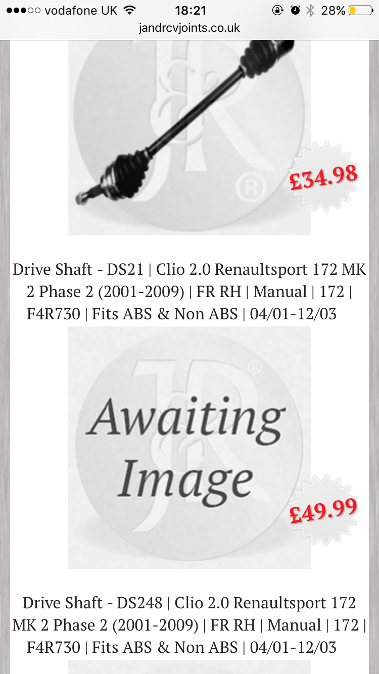

Found them, cheers. What's the difference between the £35 and £50 ones? Listed as the same apart from a little code on the description.

I need drivers side, so I assume FR RH is Front Right, Right hand drive. I'll bell them tomorrow. This is what I meant..
