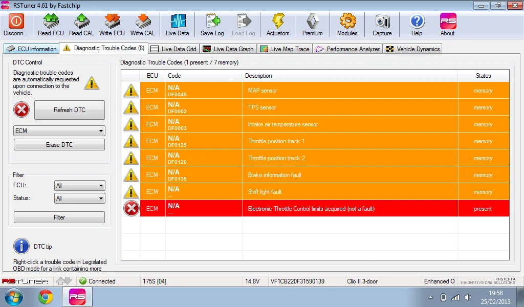

I connected the rstuner to the clio 182 and got the following.....
It also says unable to remove dtc codes?

Bloody hell that has/had some faults, do you have any lights on the dash? What ones if yes..
Has the inlet been taken off or something whilst the car was running?

The last code you have above (the red one throttle limits etc)everyone gets that one so don't worry about that.
May sound stupid but are you selecting ecm in the drop down menu, then erase dtc then refresh dtc??
Seems very odd you can't delete them unless you don't have the obd diagnostic module on the tuner?? I thought they all came with it but maybe wrong?

Yeah I doing it the correct way just once I click erase it comes up : can't erase dtc ? Do I need to update the vci or something ? And also how can I check if its got the obd2 diagnostics module on it ?

No but I even remove the code for some reason, surely I must be doing something wrong? If you look at the picture which faults there would be thorwing a eml on start up ?

There is no present errror code so why is the eml still on? This leads me to think that a ecu wire has been rubbed through?

I assume you are trying to delete the codes with the engine off and only ignition on?
I see battery voltage of 14.8 so that suggests it's running, if it is then you cant erase codes
Doh!
Yeah just try it with just the ignition on and the engine not running. I've always, when clearing faults, done it without the engine running as I thought you couldn't otherwise and it looks like that is indeed the case

Thanks but once ive removed the codes and clicked refresh there is only the 1 present fault which is the throttle limit one, so i then disconnect the Rstuner and then start the car up the EML is still on , even starting it up a few times the light is still on. So i plugged the Rstuner back in and all the historic faults are back again as if they haven't been erased (this is without driving the car). This all seems very weird.

The throttle limit one is present for every Clio so that is nothing to worry about. Since you live in Norwich I can come and see if I can work out why its happening if you get nowhere
