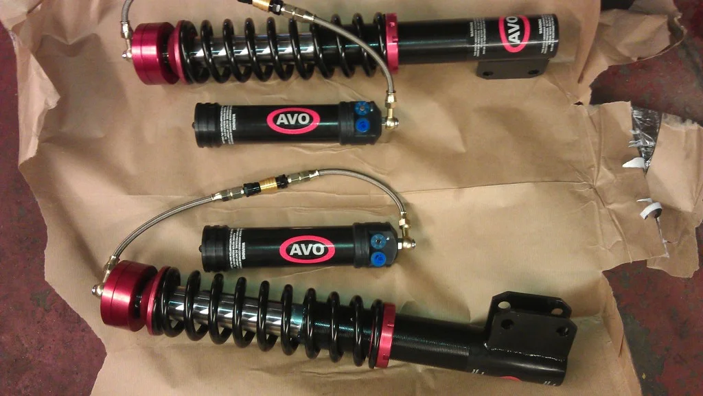

Are those Avo's in the same price bracket as the Bilsteins or Gaz's?
