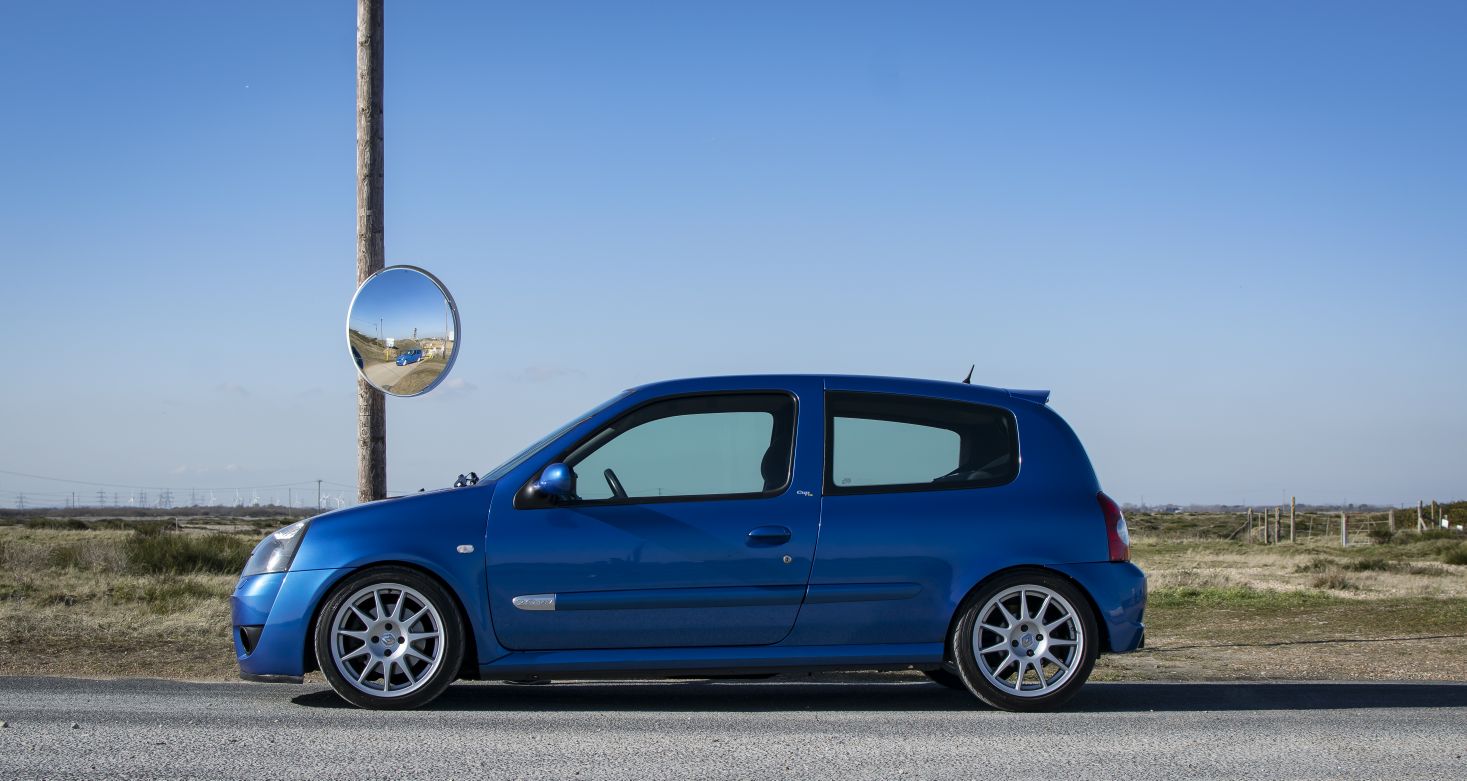

imprezaworks
  Mk5 Golf GTI :)
Not on b14’s, H&r springs. But this works well for me
sam55
  RB 182 FF

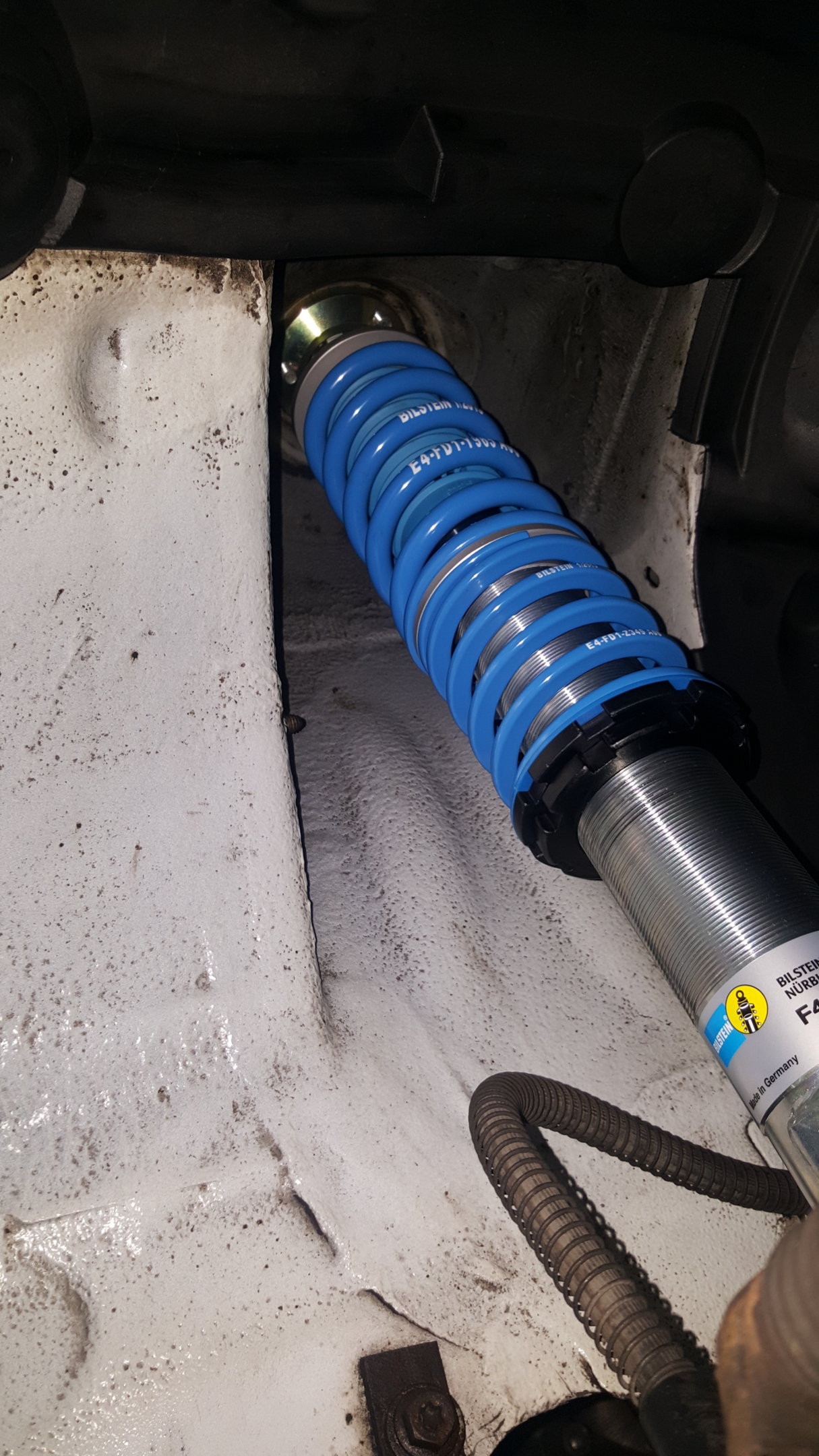

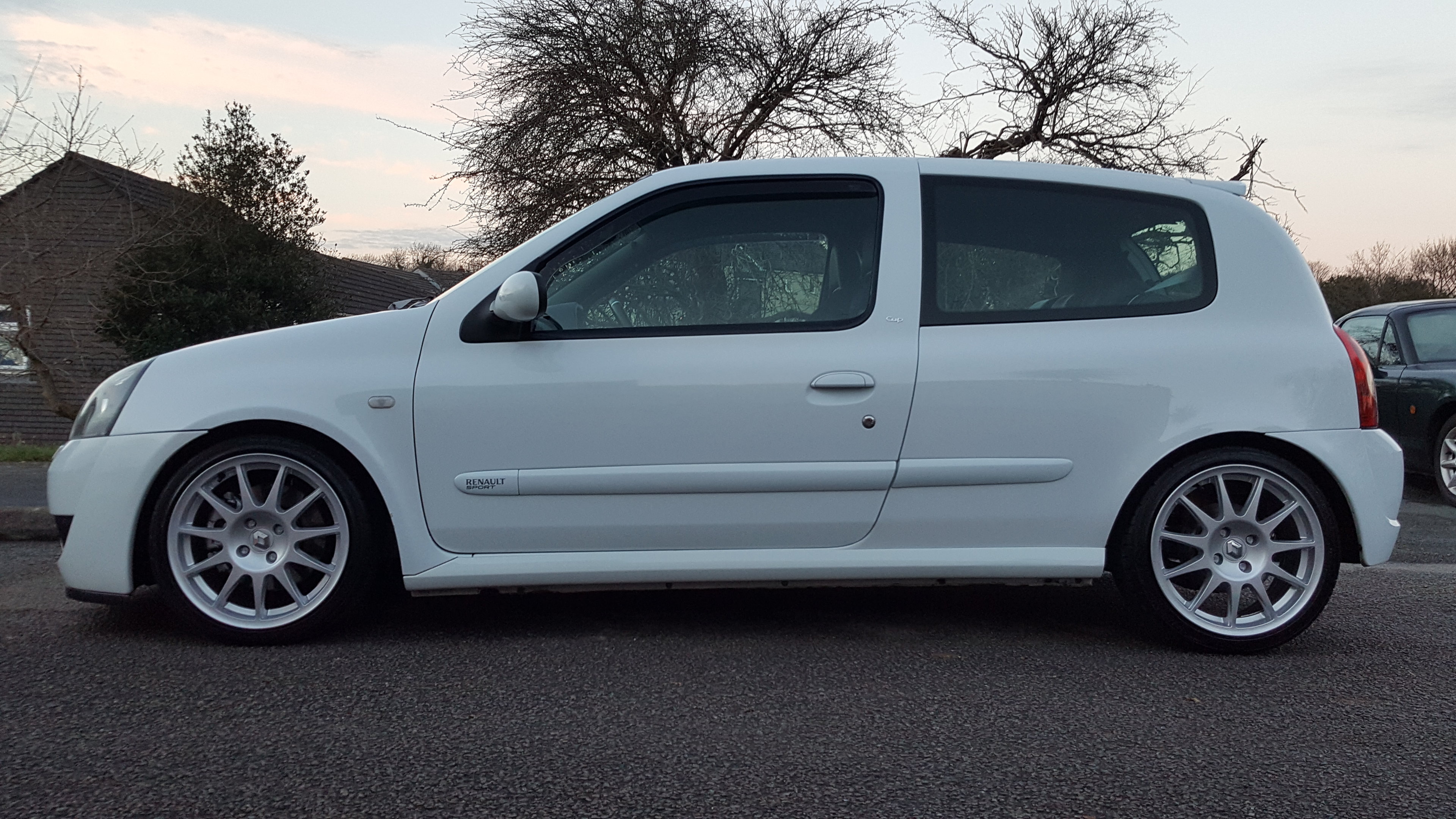

Thanks mate. Guessing you're running your car with rear shims to get the negative camber at the back?
  dan's cast offs.
Rear with the adjuster wound just about fully down and on the front 80mm of thread to the bottom of the lock ring.
Should get you just about sorted.

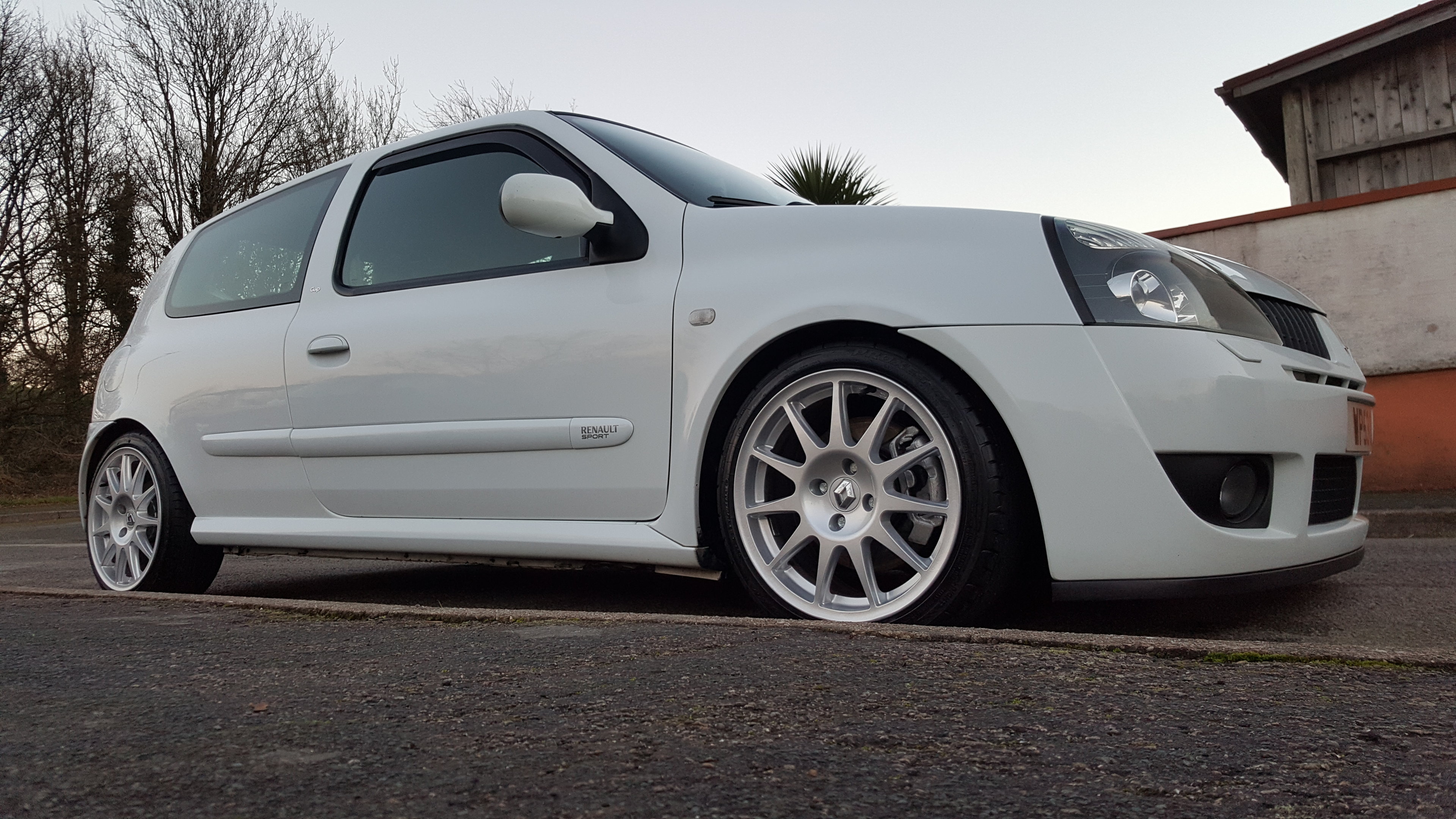

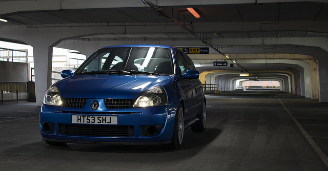

@MrBlonde Looks awesome. My B14s are on now and set slightly higher. I can't believe how good the ride is - all the crashiness of the standard setup has gone.
MrBlonde
I set mine up so it just sits level with the top of the tyres,maybe more once in the car and full tank of petrol.
I did have to do some mods to the front inner arches by the way.

I'm getting my b14s fitted next week and will showing the garage @MrBlonde pictures of his as a guide to how I want mine setup. Also I was thinking of getting pms top mounts fitted at the same time. Seems like an ideal time to do it. Is it worth getting the pms brace as well?

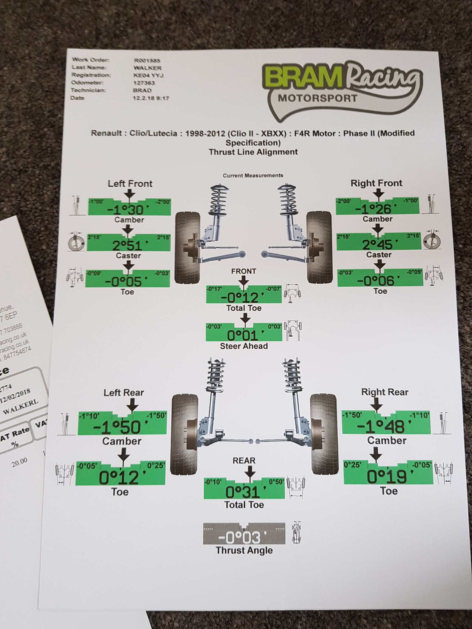

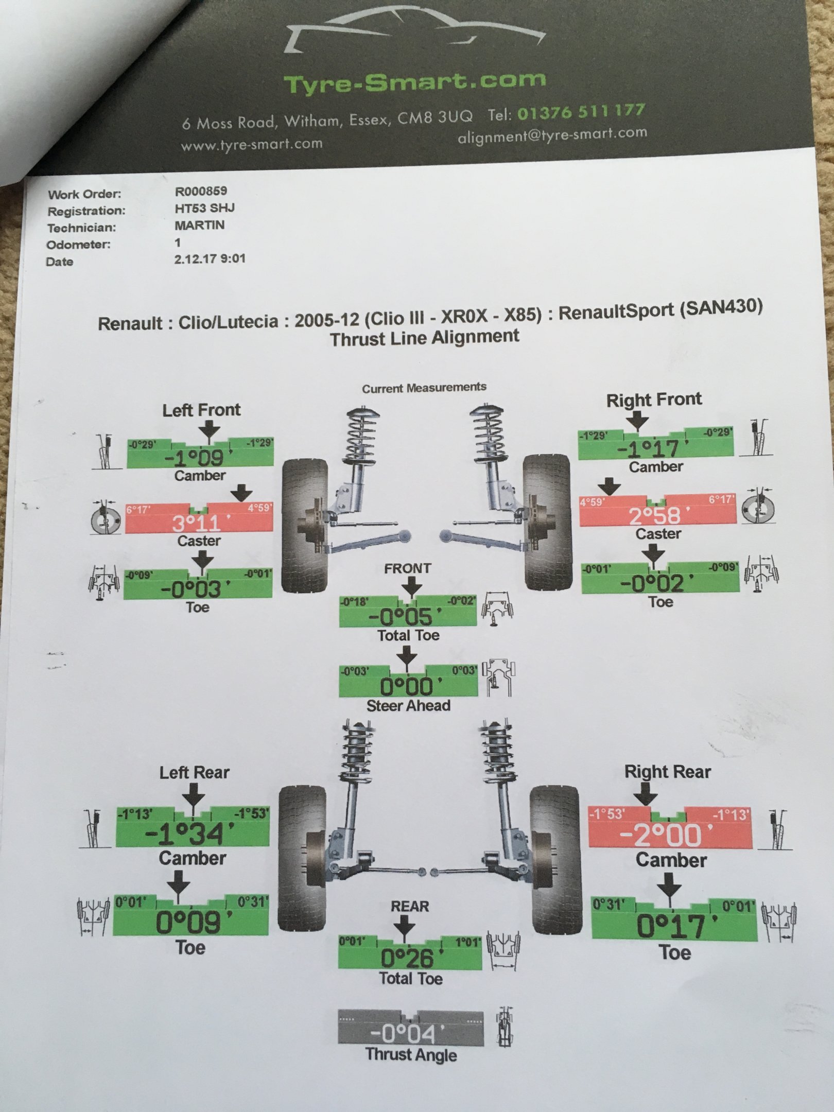

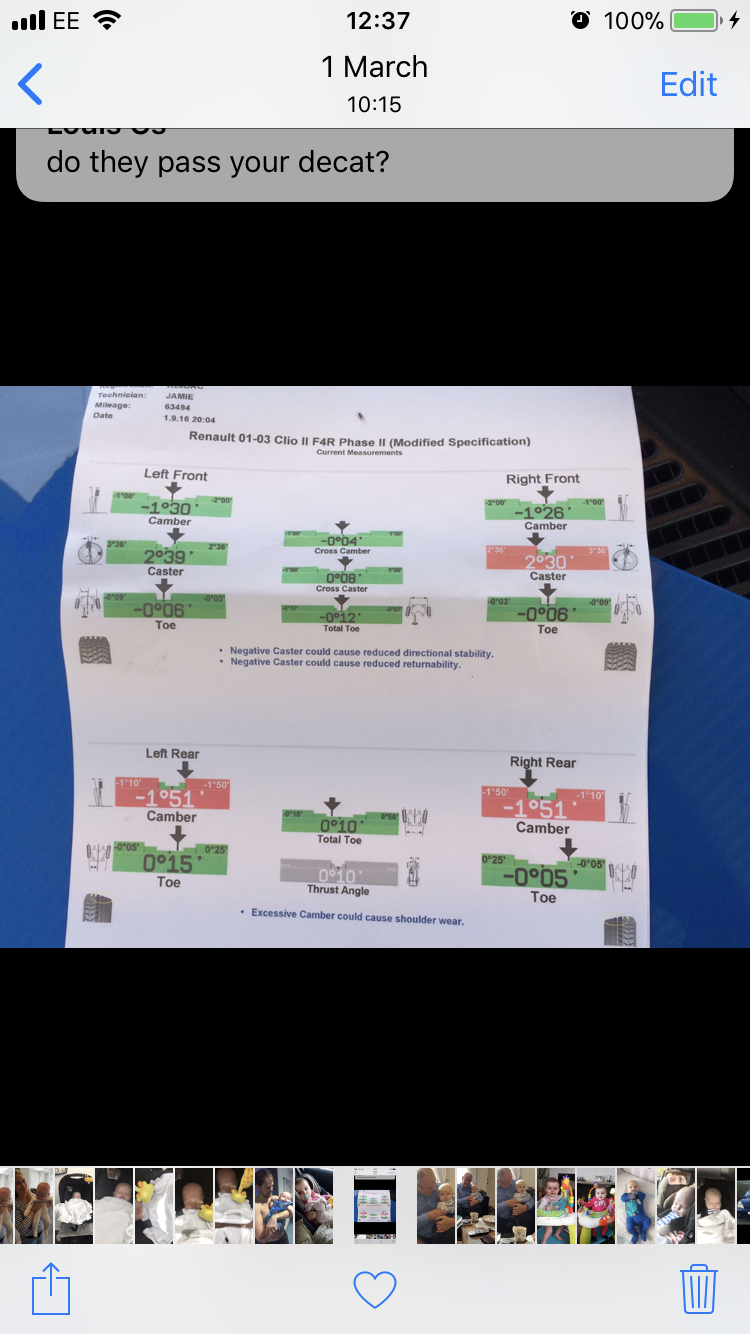

I didn't know that with the B14's you can adjust the camber slightly, so got this done when I had the alignment done.

They mentioned camber bolts are prone to moving when fitted with the b14s?

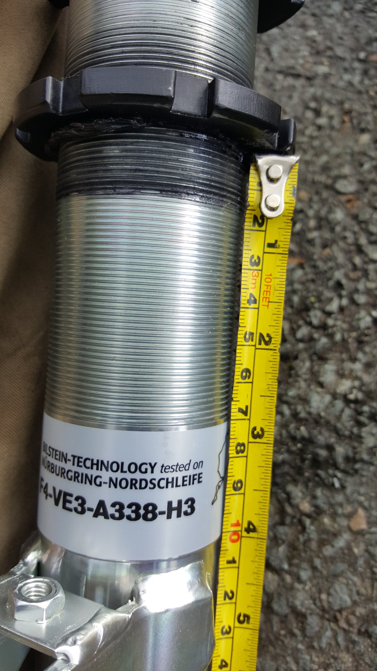

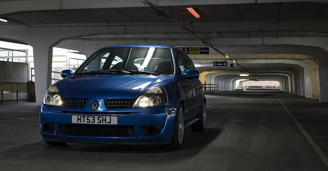

Here's mine.
With 70mm thread, and on 40 profile tyres, I was catching my old Skoda splitter too much and also the exhaust... I will be raising it a bit as it doesn't drive that well either.
The rear's have the adjusters all the way down, and still doesn't sit as low as it did with H&R Coilovers with adjusters all the way down. I think the Bilstein springs looked a little bigger. I may try removing the adjustment ring and see how it looks and bring the front up to 80mm thread.

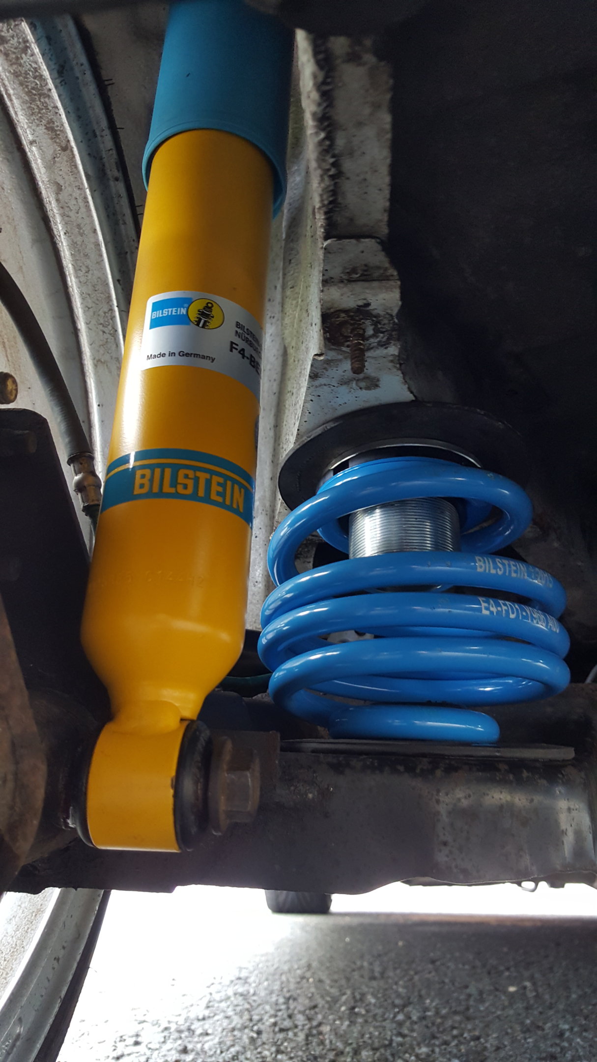

Hi, I'm about to fit a set of b14's and noticed that the rear spring adjustment collars have no lock in place screw. Don't they move out of position while driving?
Louis
I Park Like a C**t
Don't run the adjuster. The height is so much better without
ripp
  182 FFAT
It's a daily driven car, I'm not a fan of slammed cars especially on bad roads, oversized speed bumps etc. Plus if I run it that low on the rear I'll have to lower it on the front as well and it will scrub on the arches, hit the bump stops. Been there done that 10 years ago.
Louis
I Park Like a C**t
I drive mine daily and do not scrape, even with people in the back. Its definitely not slammed.
