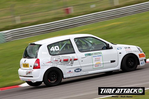

Danny, I now have the AST's from the time attack car. These were re-valved with super stiff rear springs. Did you have a chance to drive it on track? If so what did you think?
Fred if you fancy trying them in the dry, just gimme a shout in spring/summer. Will have them setup aswell as running r888s then
