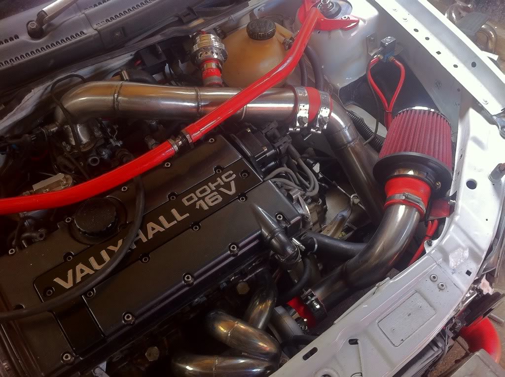

corsa b c20let, evo tdo5 turbo conversion stand alone mangement , custom suspension, fully rose jointed etc mapped to 350 bhp

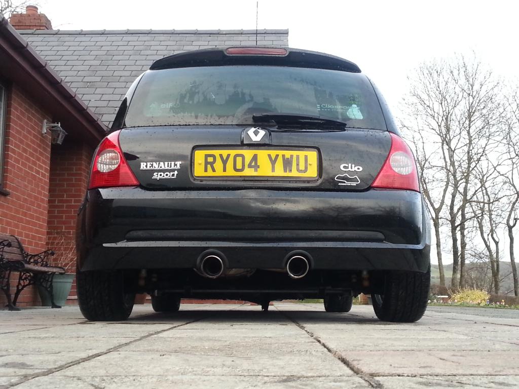

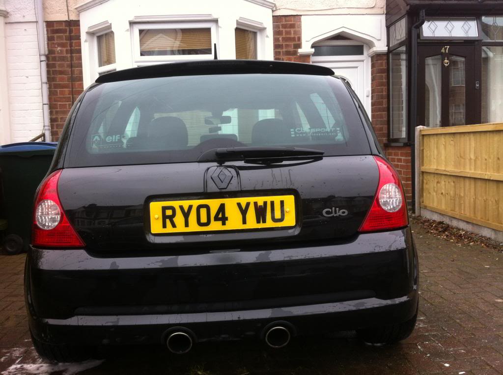

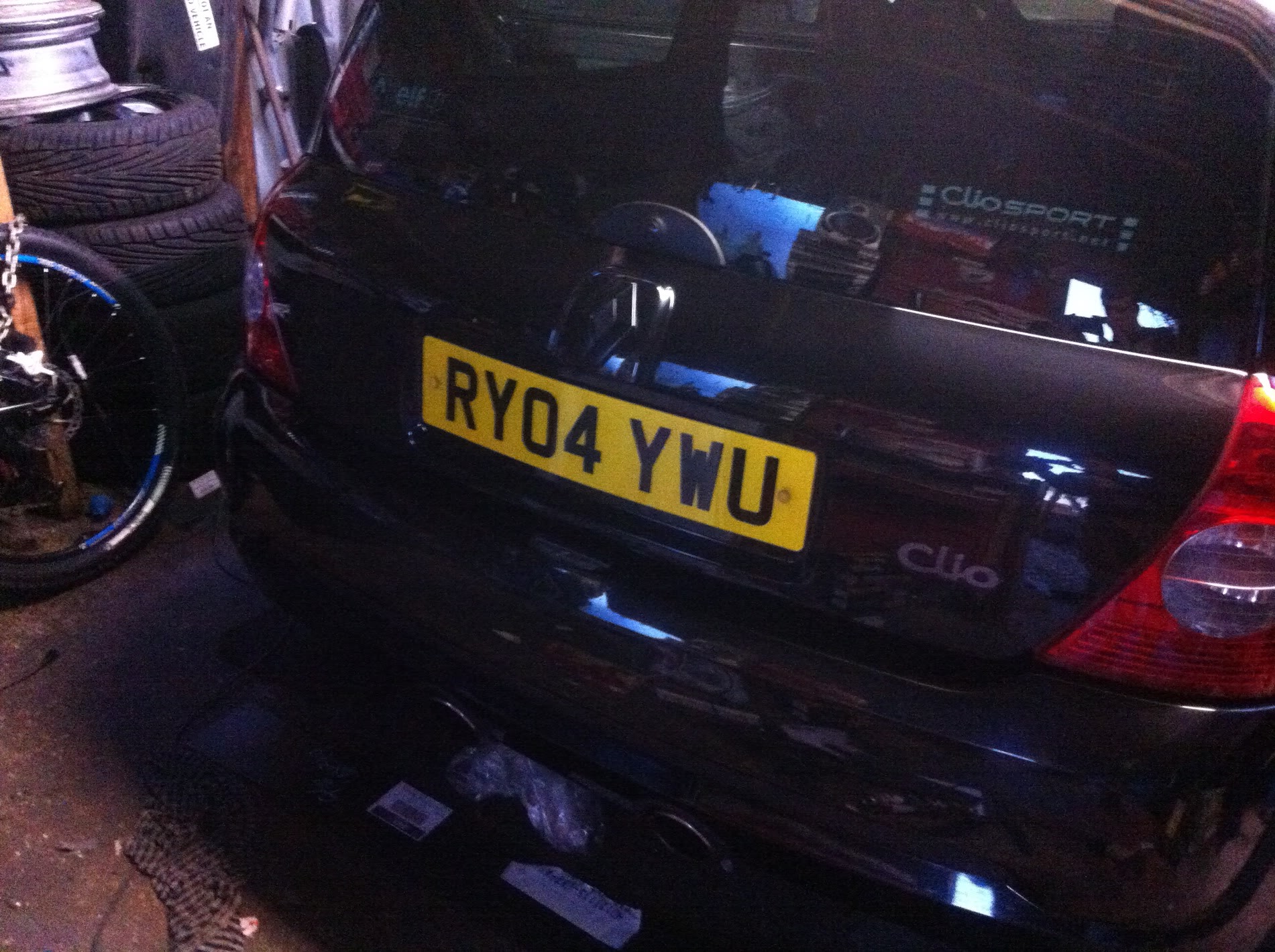

bought a few months ago off a member on here BG182 clio on a 04 plate , here she is as i got her
spec list of when i got it
93000 miles but does have fsh lots of recipts and just had service and cambelt, dephaser, water pump done by fred at btm
both cup packs
172 cup hubs
fk konigsport coilovers
ktec cat back exhaust
ktec discs all round with green stuff pads
white line rear arb
16" speedline turnini wheels

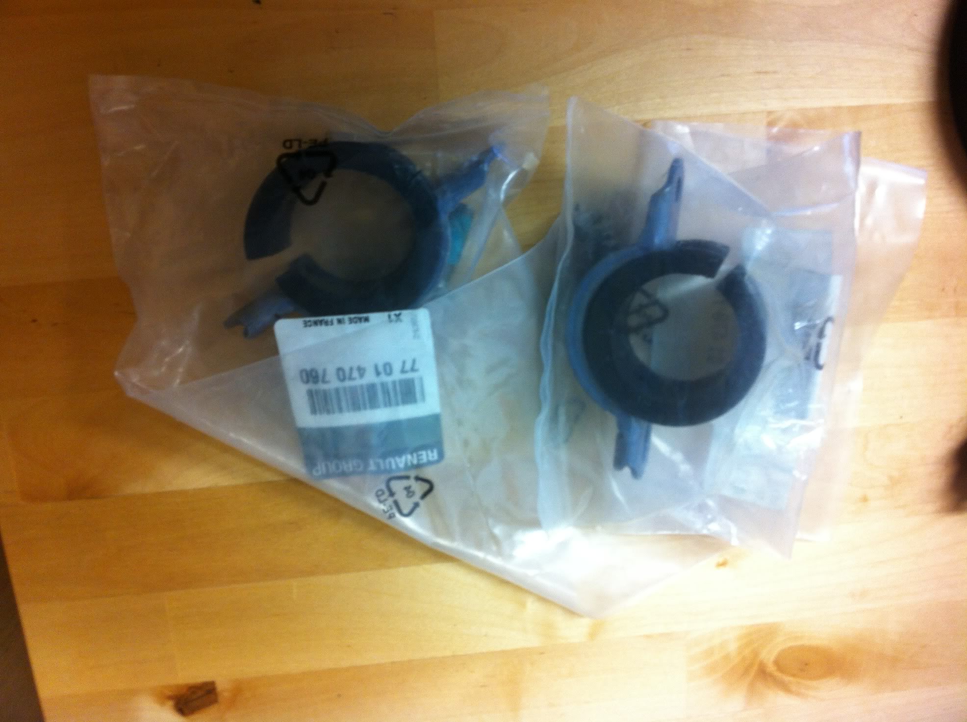

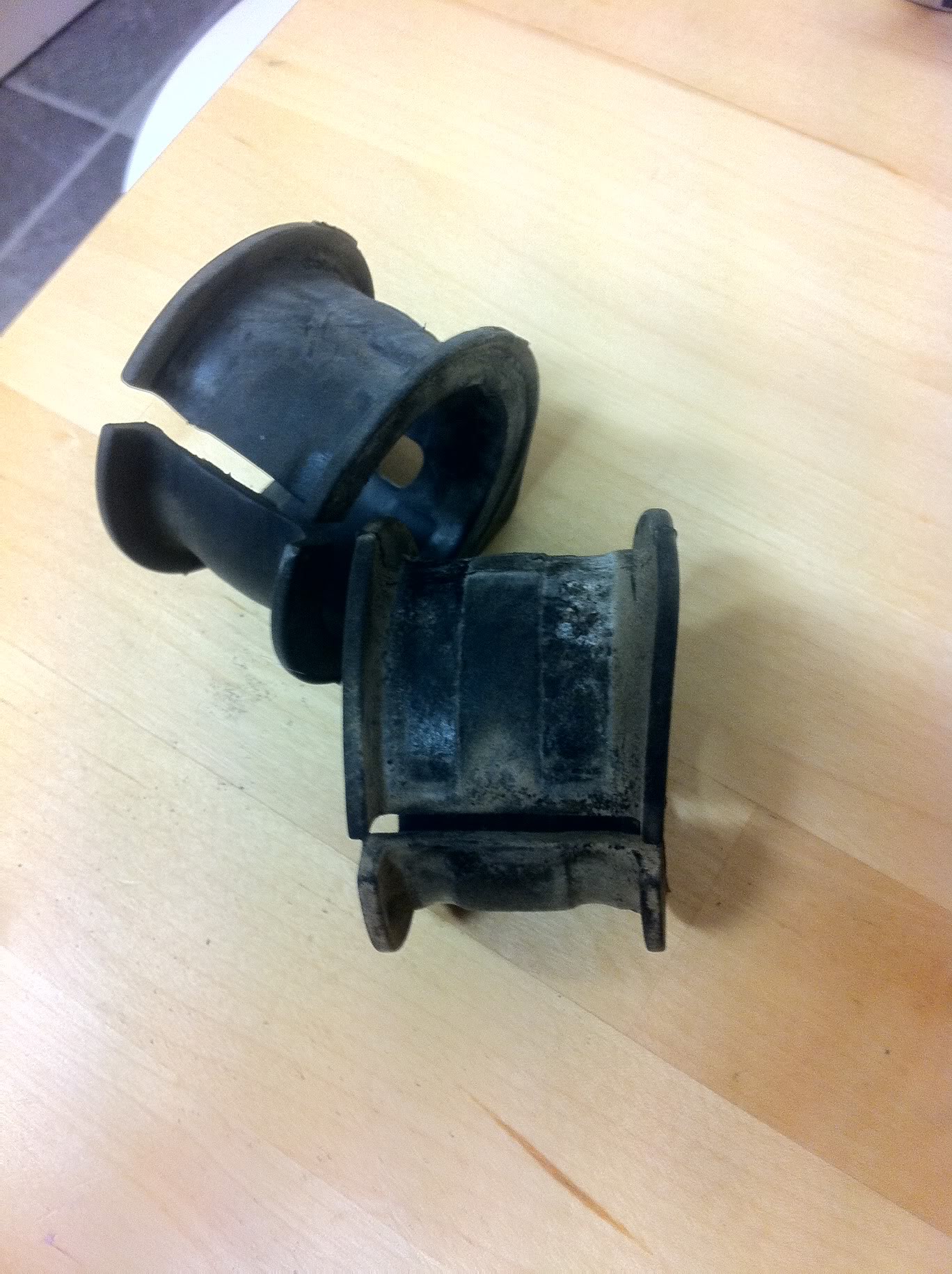

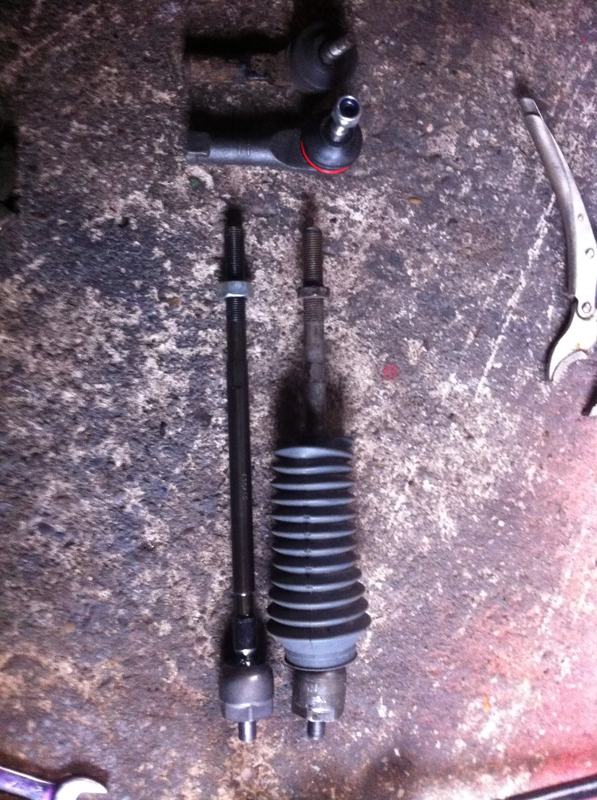

First up removed the awkward old steering rack bushes
Old
New

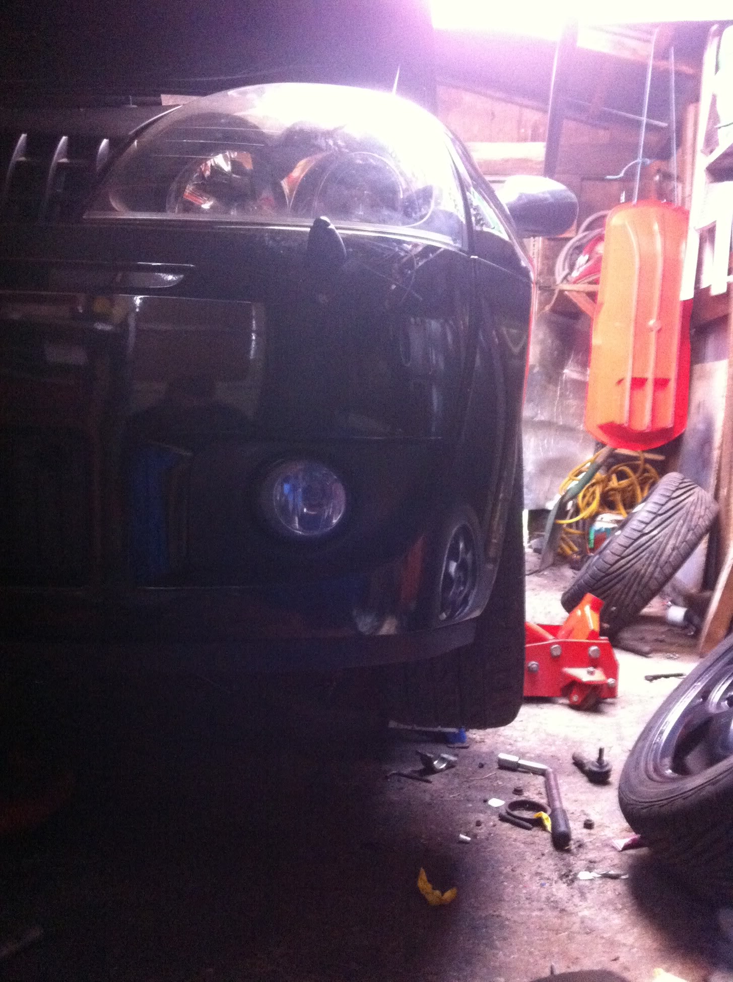

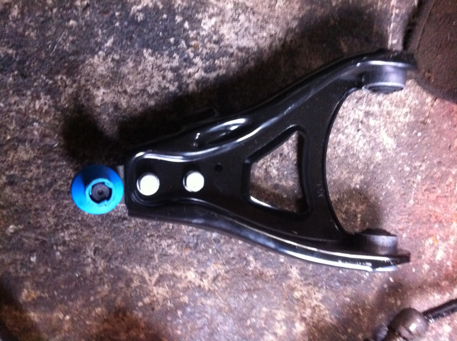

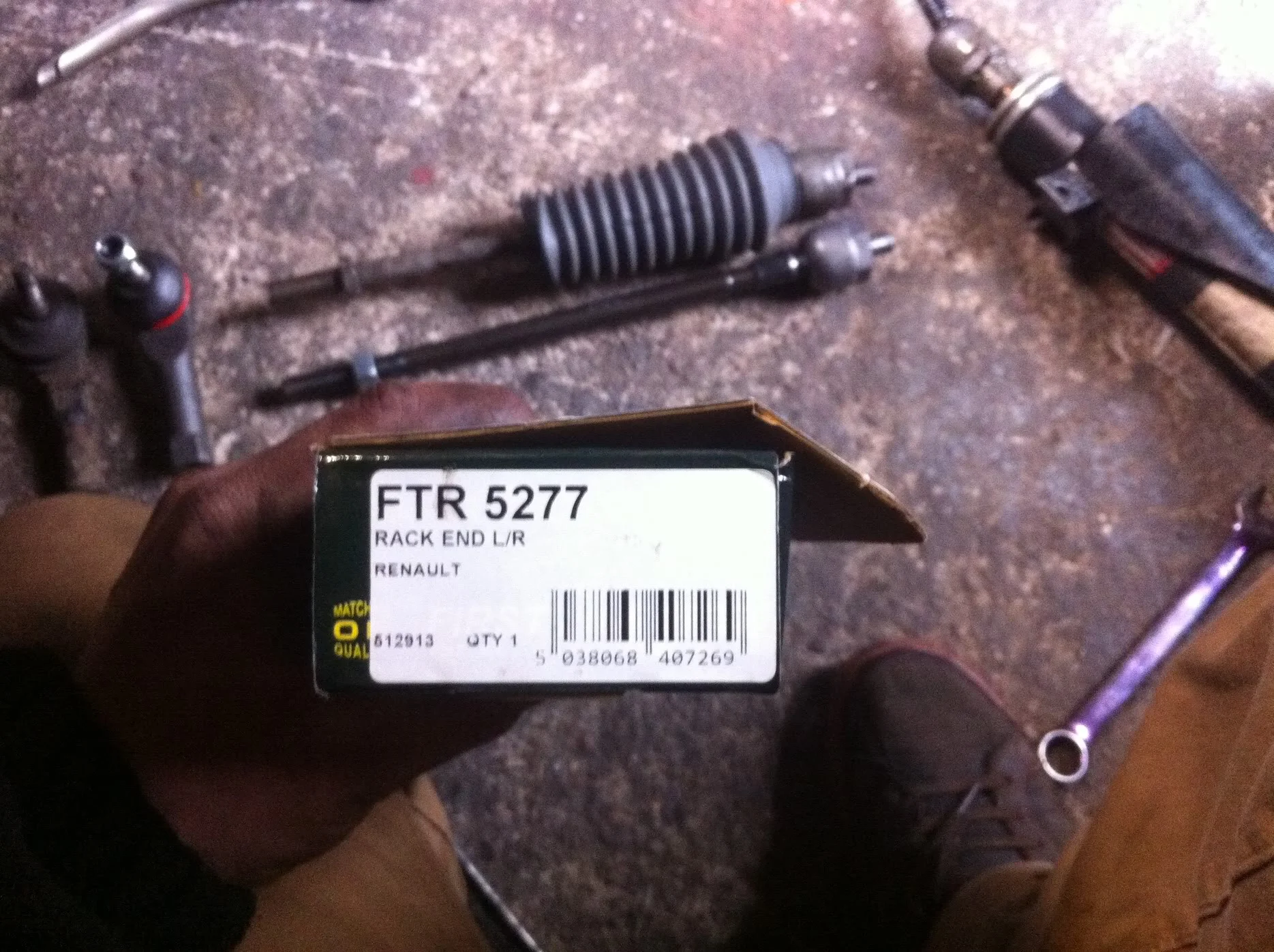

Next up was some new genuie cup wishbones from west renault
After some long chatting and with my mate at the motorfactors and looking at different tie rods tryin to find the correct length ones i got these
Listed as kangoo 4x4 exact same 335mm length , fitted these with the new track rod ends , nightmare job for access with mole grips but got there in a few hours

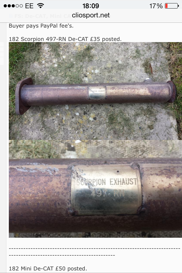

Gt a scorpion decat for £35 so got that fitted along with a new downpipe to decat gasket and fitting kit, sounds loads better nice and raspy on full load but quiet when you want it to be

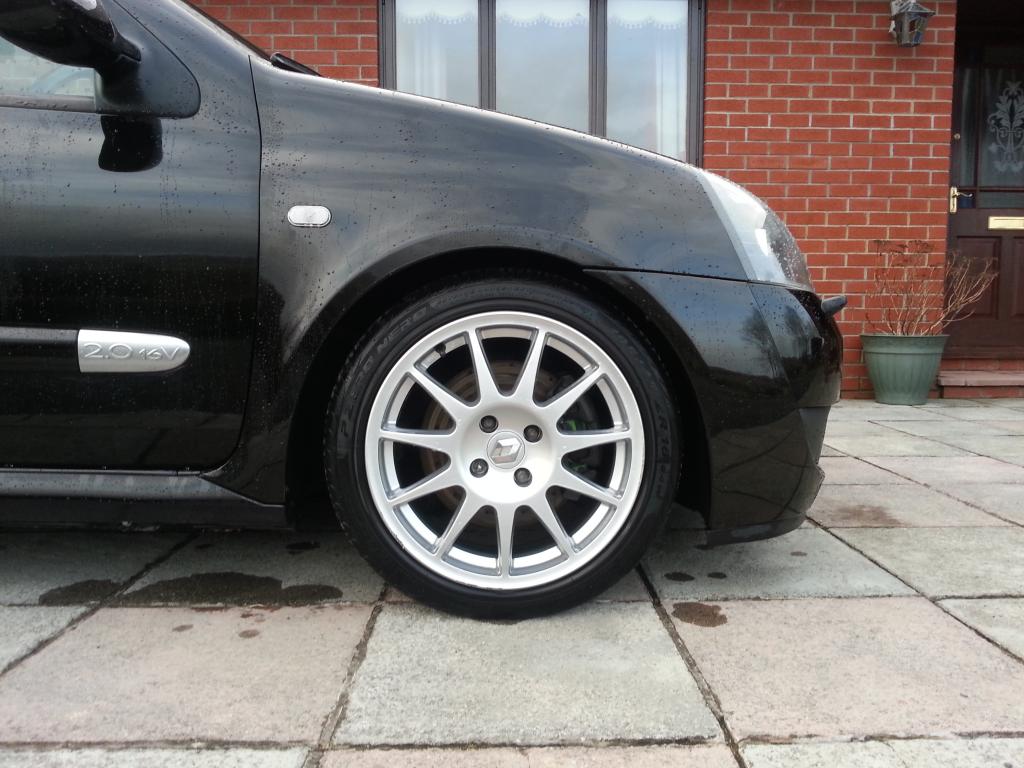

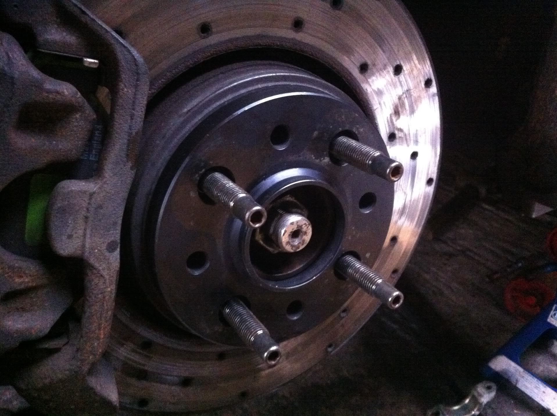

Bought a full pms stud kit and also some m.a.d 15mm ally hubcentric spacers, Got them fitted up
Also cleaned up the coilovers didnt realise the hole was slotted so can adjust camber, so set it to max , think i got enough lol

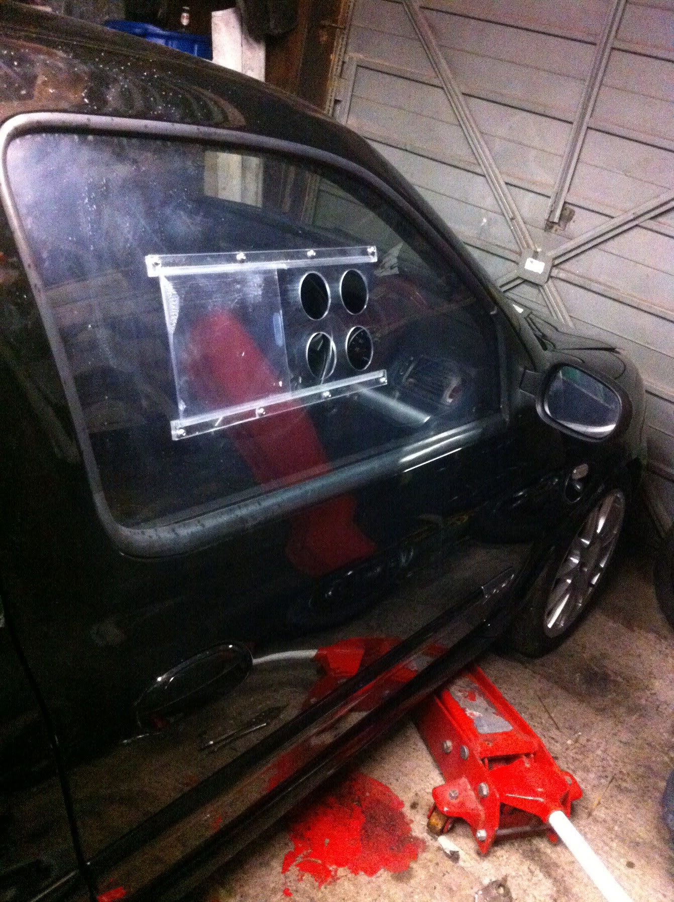

Just bought a set of polycarbs front an rear sides wih 2 sliders and ds2500 pads.

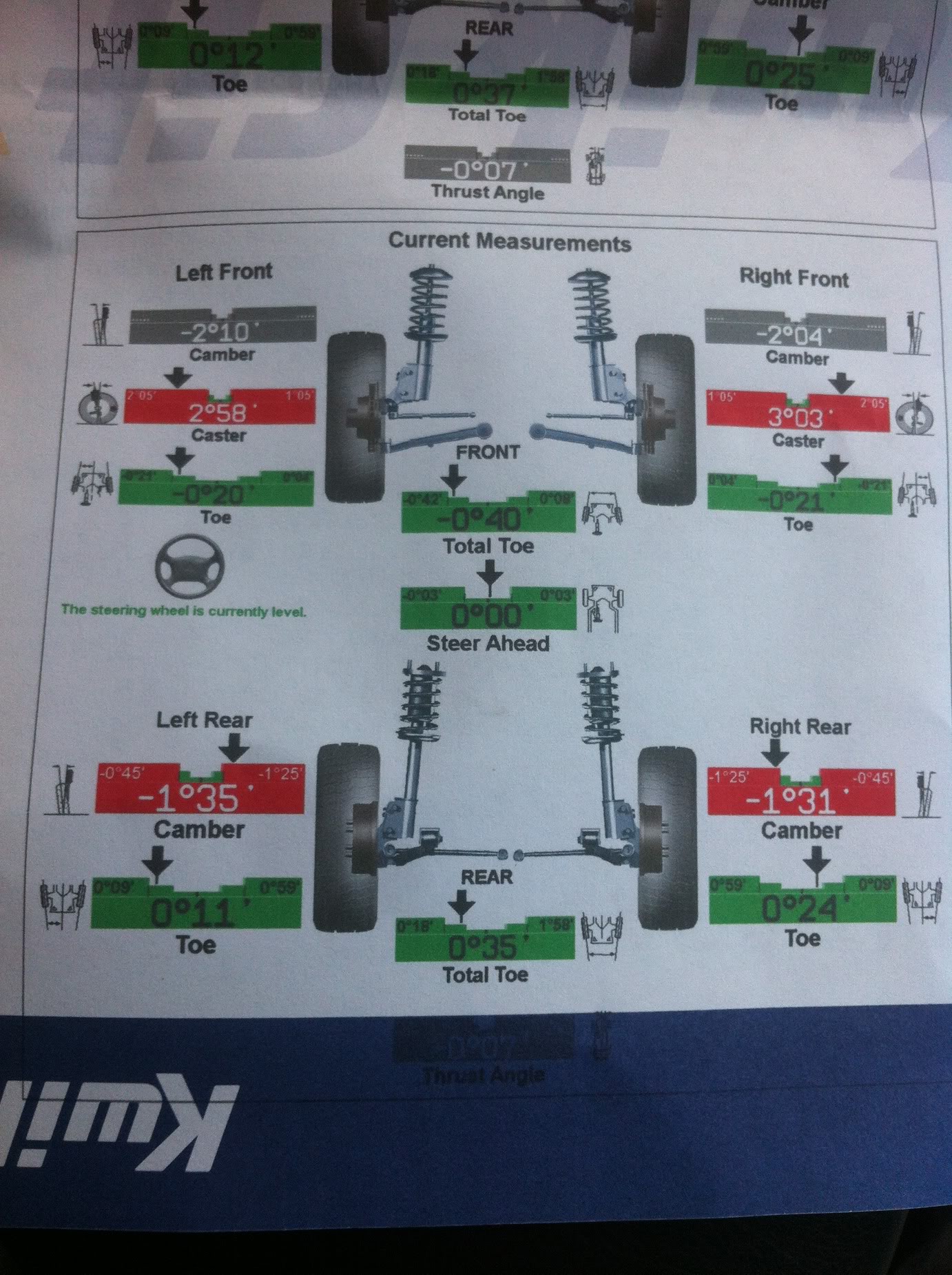

Well i had the alignment checked/adjusted to day, well happy with all the readings seems pretty even, ignore the toe in thats now set to about the same amount but toe out instead, camber is bang on lol what a guess and rear looks good ;) what yas think?

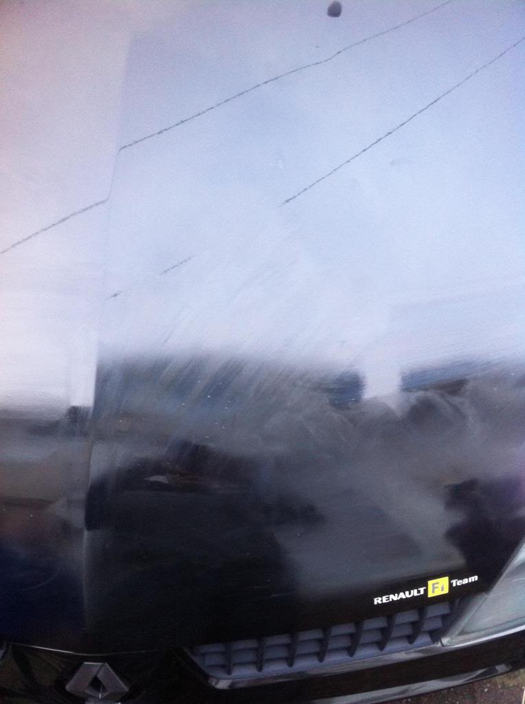

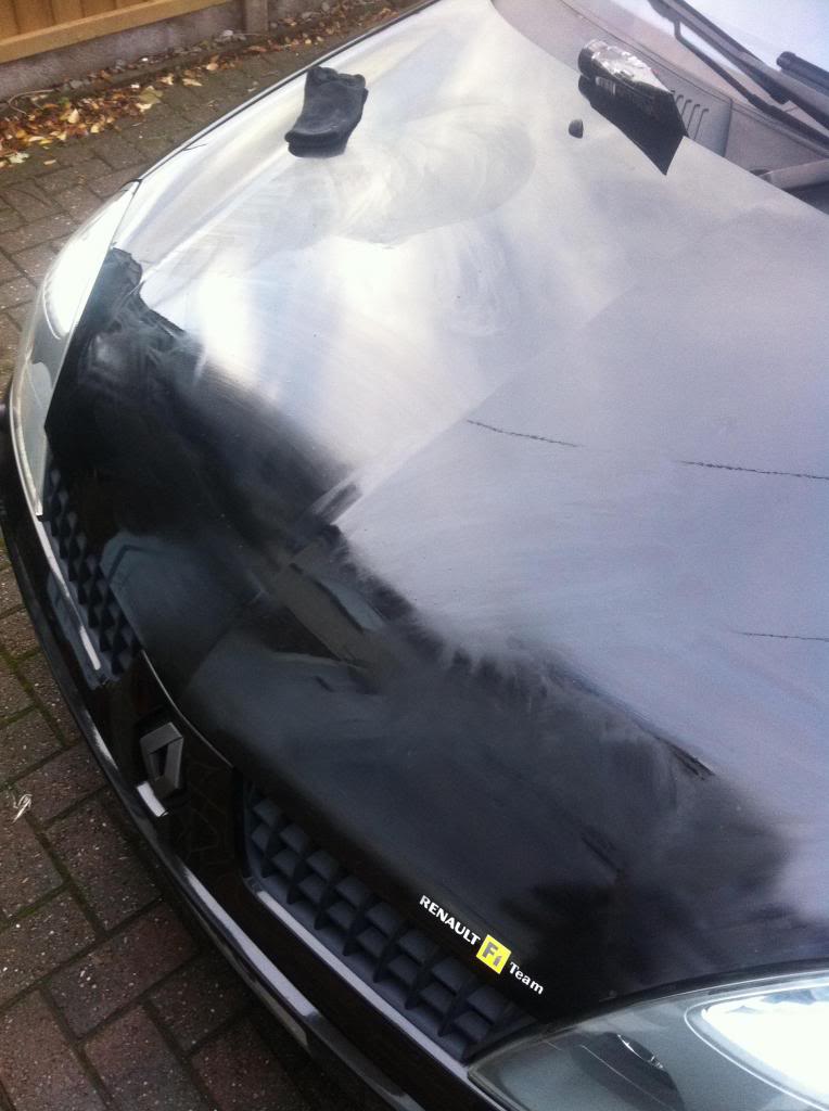

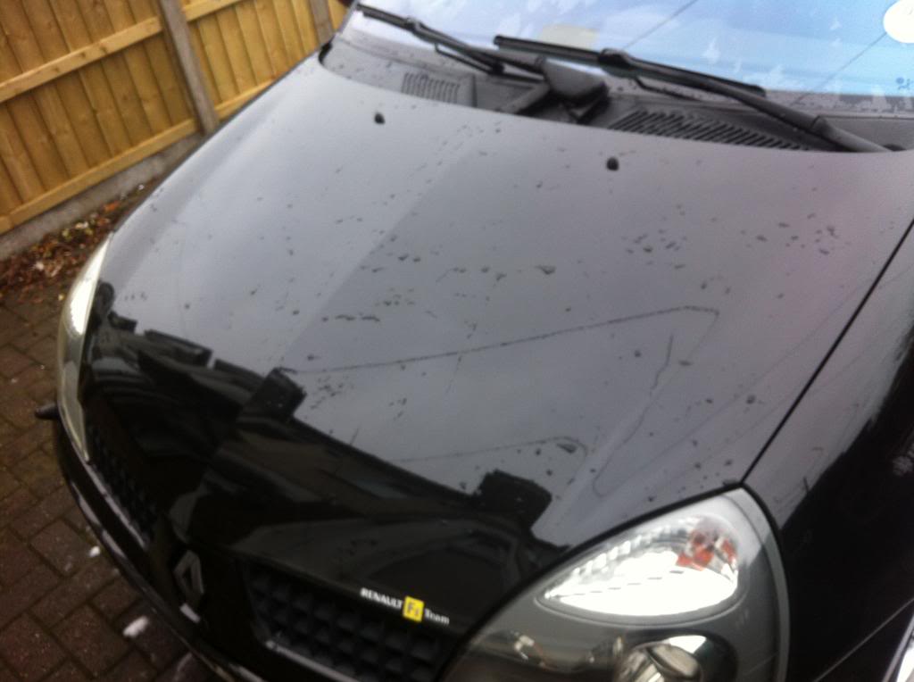

up the bonnet was anoying me as it had loads of stop chips and tiny lil ones all over it, so i filled the big ones, flatted back with 2000 grit paper and then used the wipe technique to smear paint over the entire bonnet with a cloth and then polish back with a cutting compound. very scary to say the least but it does work well, still has a lil dent id like removed.

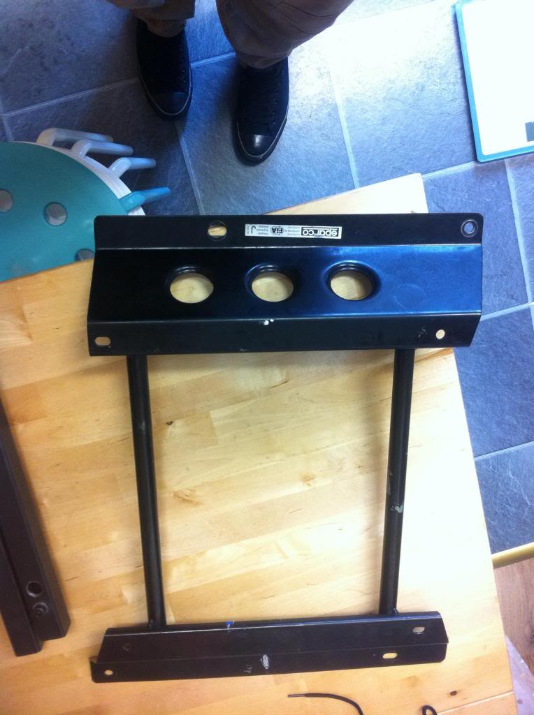

received me sparco sumframes this week and my 2 pairs of side mounts :) and drove down to bristol last weekend to pick this bad boy up ;) corbeau revolution just gone out of date from a unfinished project, it has literaly not been sat in,its mint, very tight but feels pretty awsome really grips you.

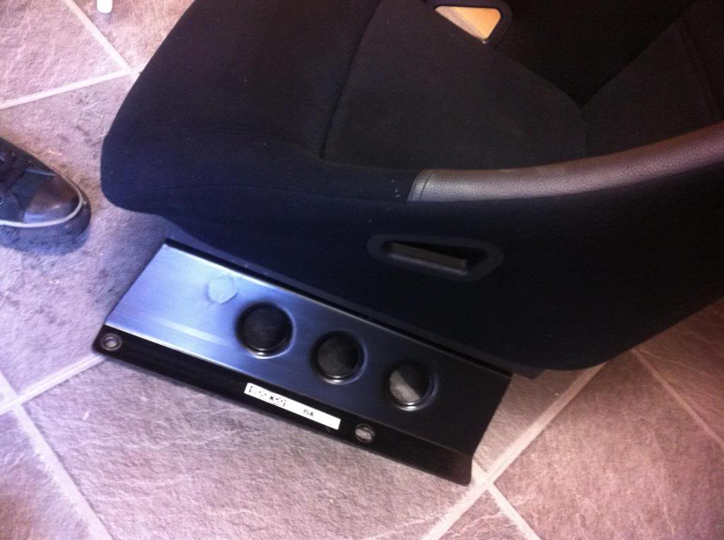

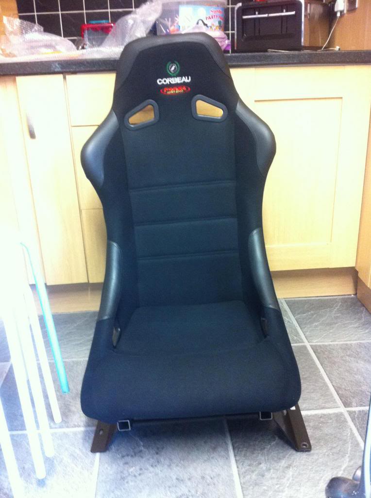

want to make use of the existing corbeau forza seats i already had from the corsa so will try to use that as a passanger seat.
cleaned it all up and also looks pretty new
the forza is a bottom mount seat opposed to the revolutions side mount so i took a few measurements and looks like is just have to make 2 box section rails to go between the seat and the subframe to get the hole spacings required, just need to see where about it sits in the car now and the height of it.

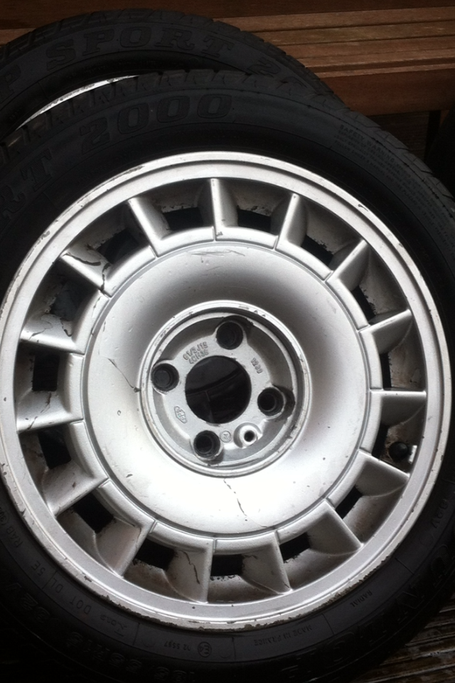

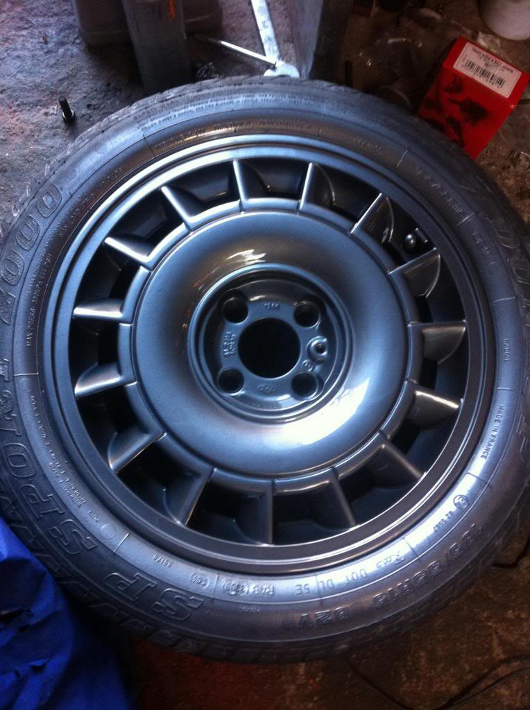

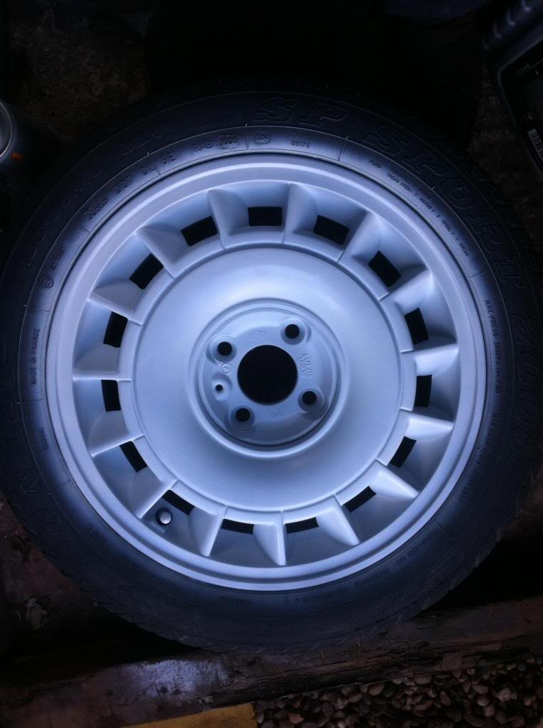

after a decision for the 15" wheels i wanted and a while of searching and missing a few sets i finally got my hands on a set of 15" 6.5j renault turbines in need of a refurb for £150 there et36 so should fill the arches nicely with my 15mm spacers on front and 10's on back.
heres what they were like when i got them
primered before flatting any bad bits with 800
fully painted and laquered, just painted the tyres are thre goin in the bin anyway in way for my yoko a048's, only done the one so far, will be doin the rest this week as they take a fair bit of effort well happy though they should look awsome on the car.

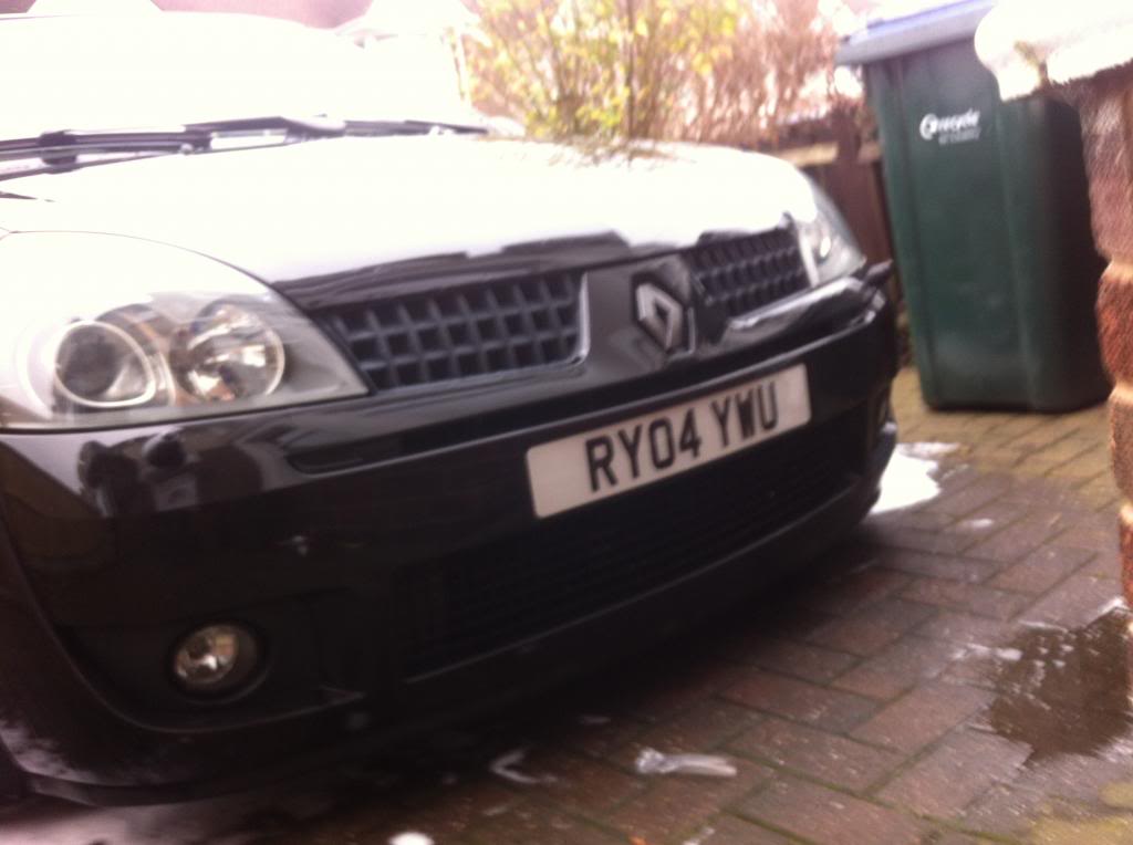

gave her a mini detail today and well happy few lil dents but she does look well, need to remeber its a track car lol.

Im looking to do the paint wipe repair for all the little chips that aren't worth individually filling on my bonnet, am I right in thinking you soak a cloth in solvent i.e. isopropyl alcohol, then add colour on top and wipe all over?
  BG182 Track car
With mine i bought the touch up paint dabbed it onto a sponge and wiped over the bonnet then cut back be easier with a rotary/da

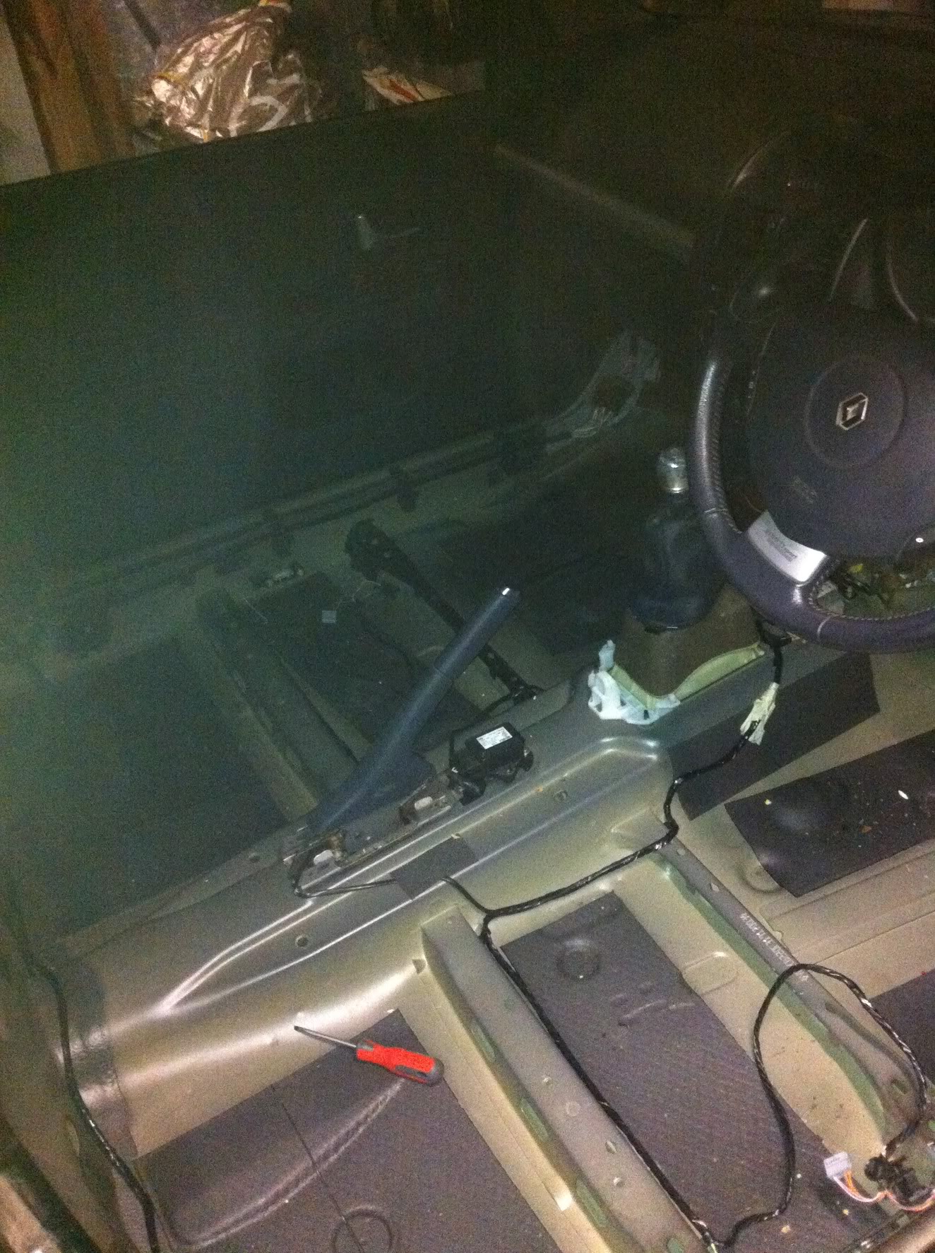

With the help of the kids we managed to strip out most of the interior in a few hours

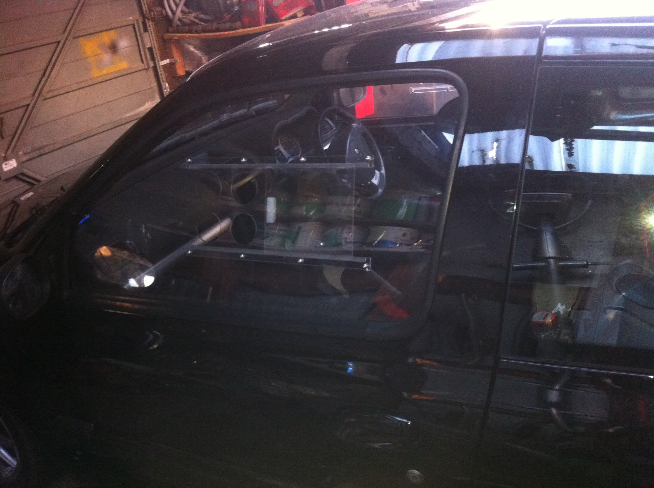

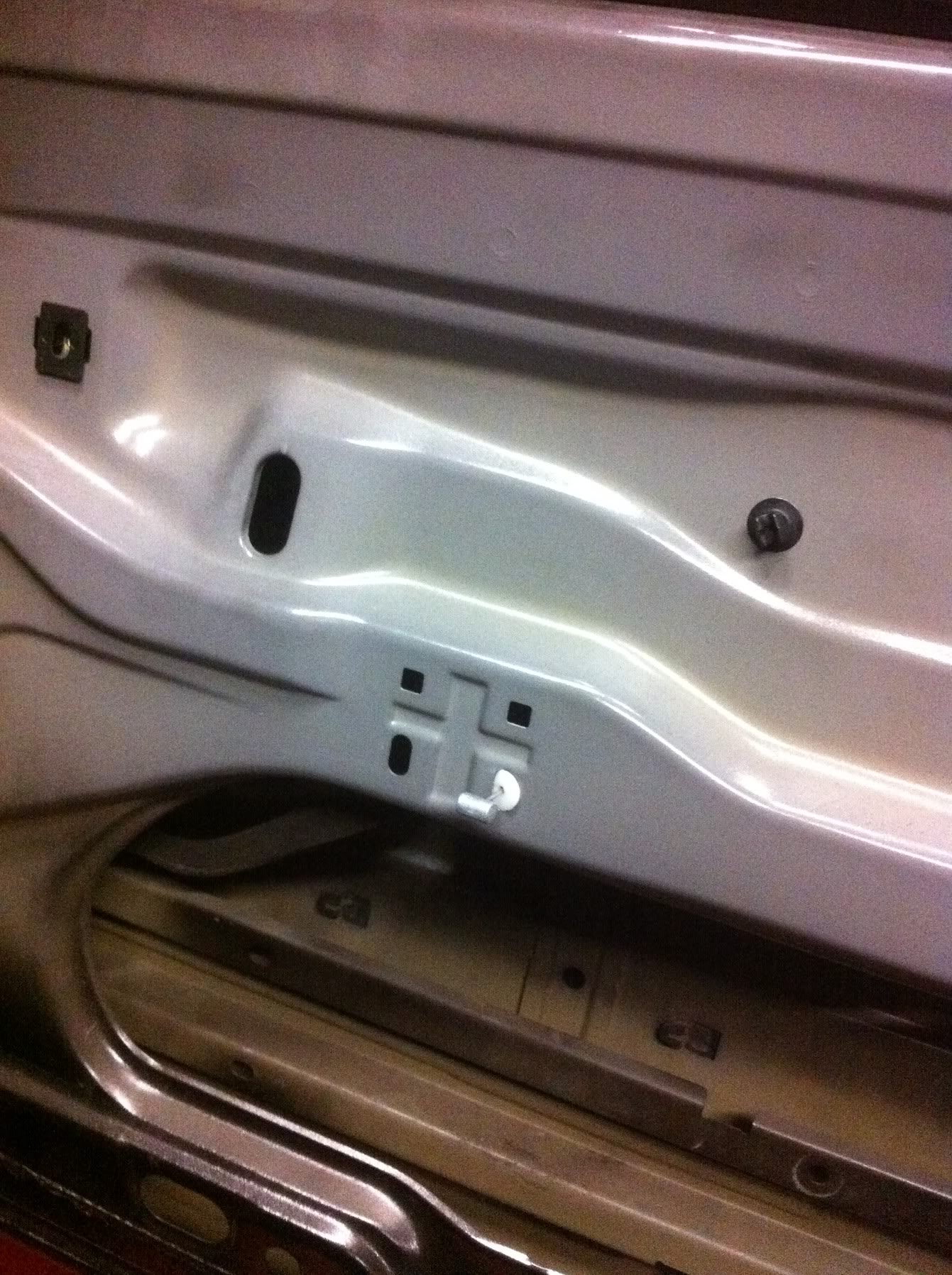

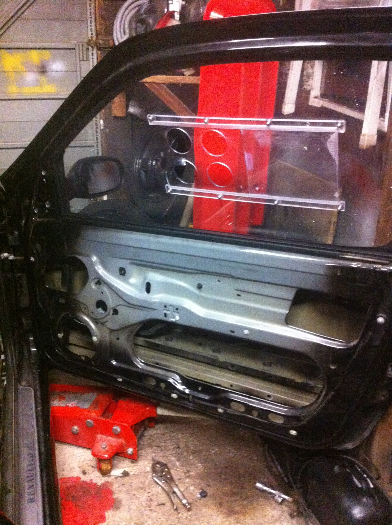

still got the rear to do and all the tar crap , made a start on the door any polycarb, didnt take long before the glass and gubbins was out and i had this
nice lil hole for the door opener cable lol
quick shot of outside, they just need a polish
need to just add 2 bolts under it to stop it falling but managed to push in some 6mm silicon hose between the window and inside dead to push the polycarb flush with the outside and its now pretty tight in there ;) all wires hissed inside door unit i make my cortex doorcards

Looks good, I have never seen that paint smear method before. Does it look good close up?

Your geo settings look good too, you might find you want some more camber up front depending on how hard you drive.

works really well you just gotta be brave mate can hardly tell now, door pulls maybe goin on tonight as ive got hold of some correx for maximum lightness sort cards ;)

removed all the rest of the interior, ive been weighing and writing down whats what as i remove it an im upto about 90kg saved at this point with the seat weight
differences fron standard and the poly carbs, theres still more weight to be saved aswell.

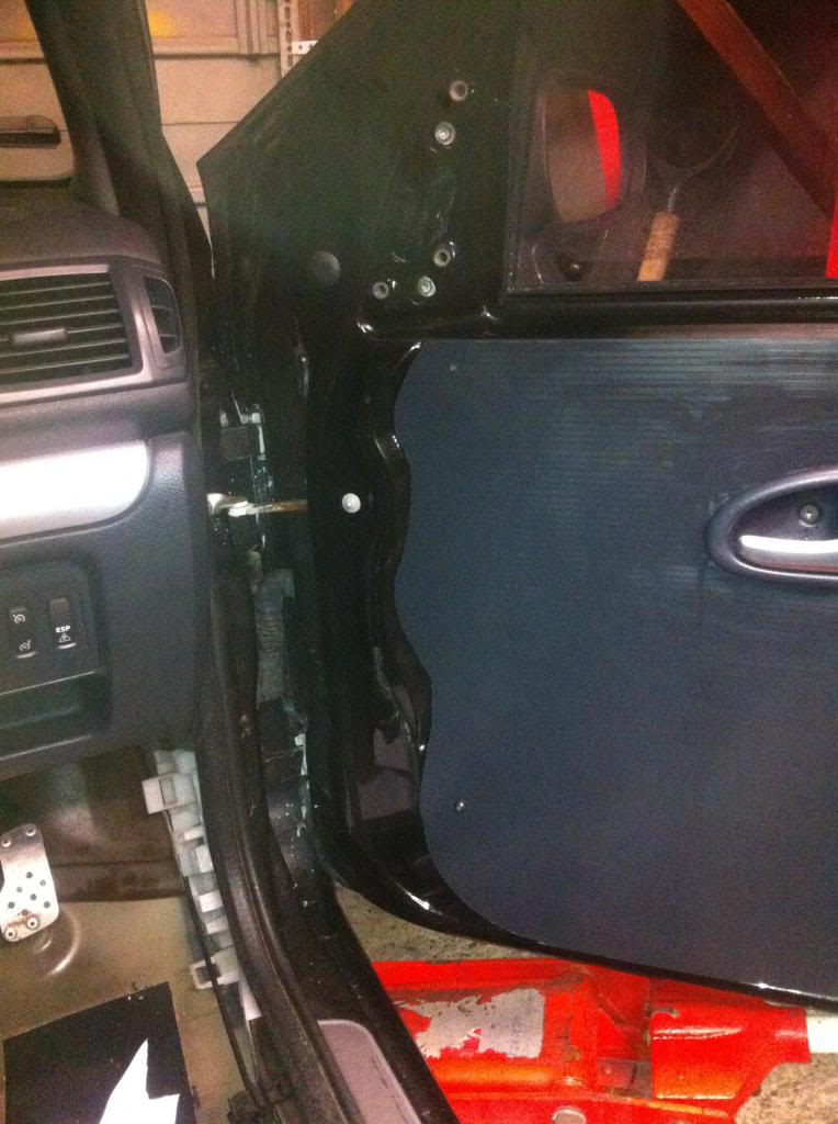

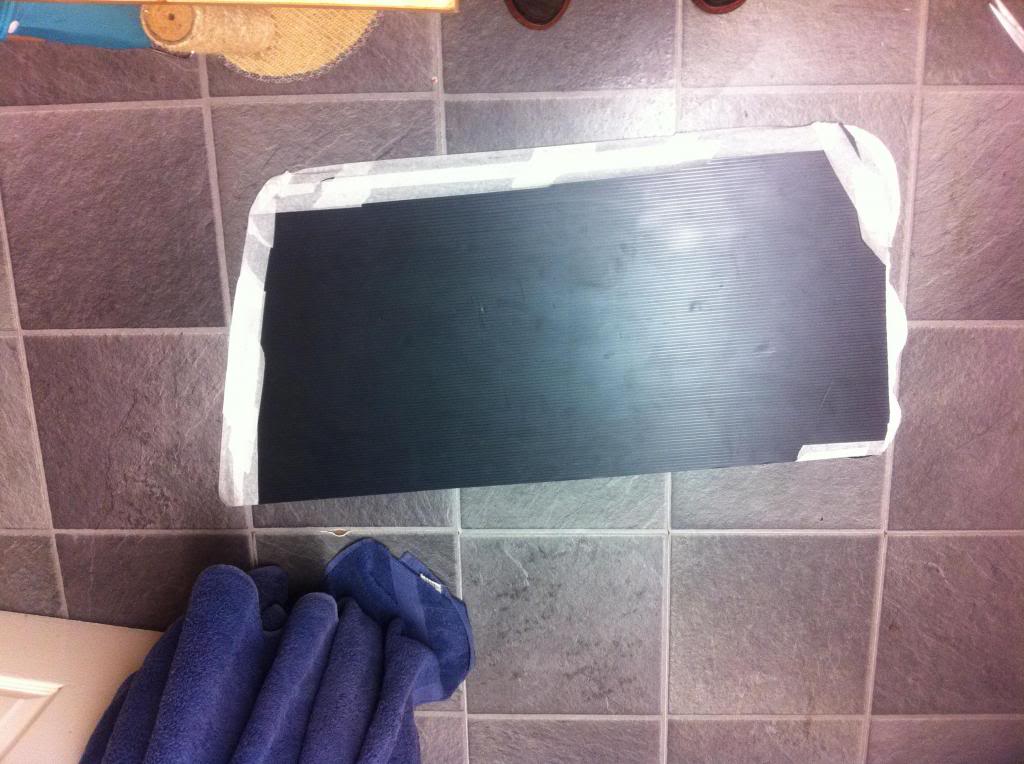

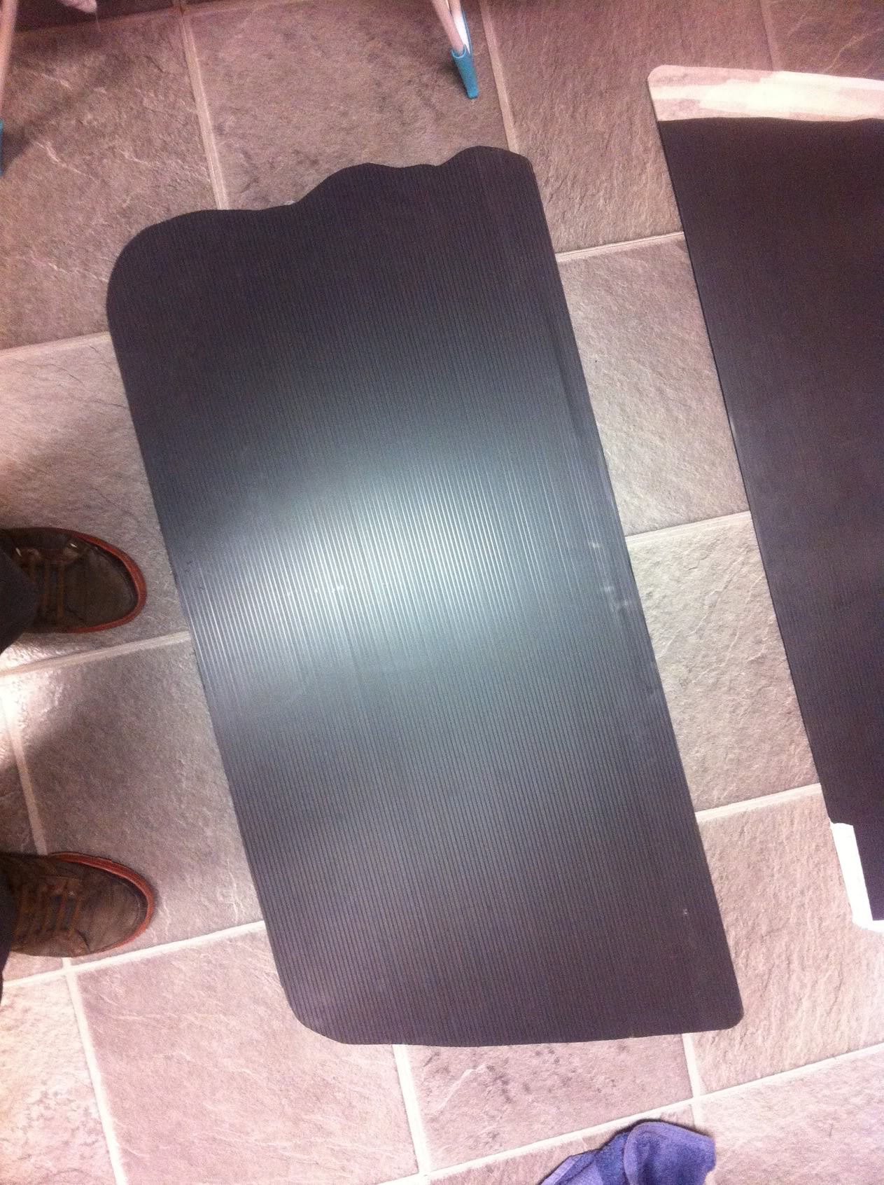

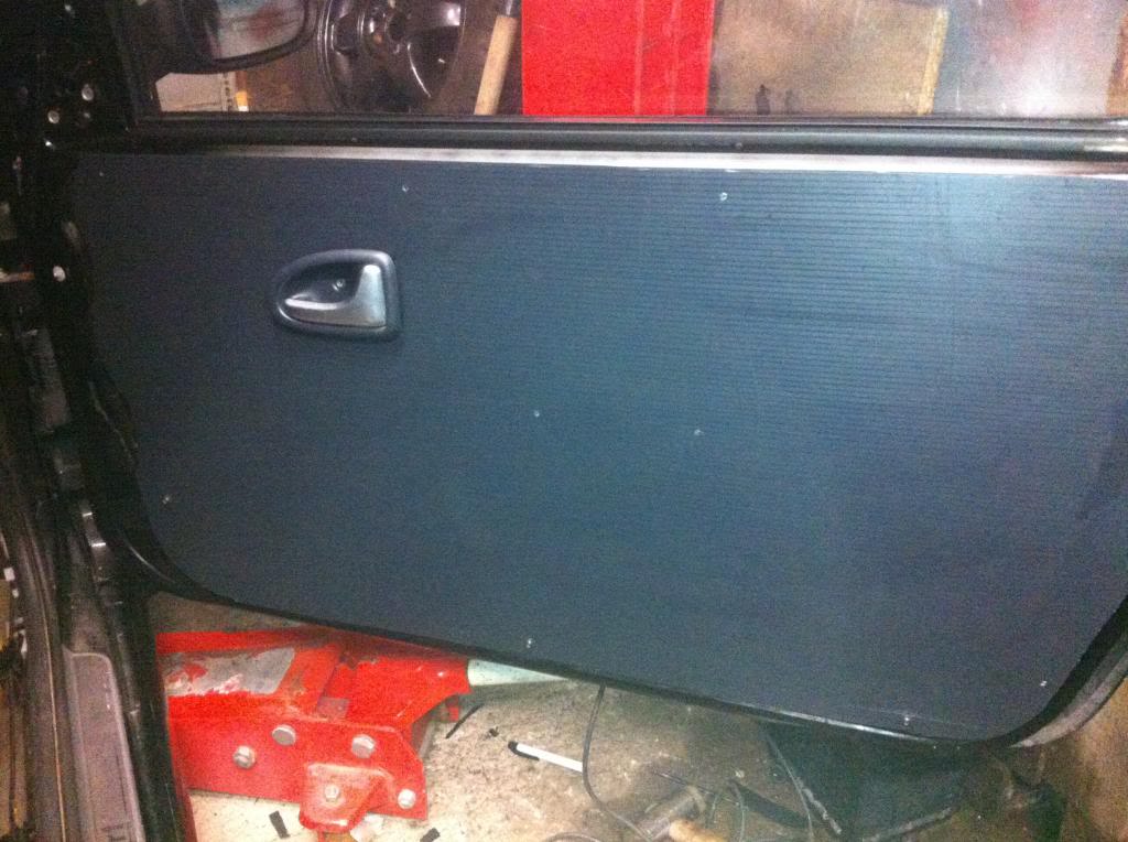

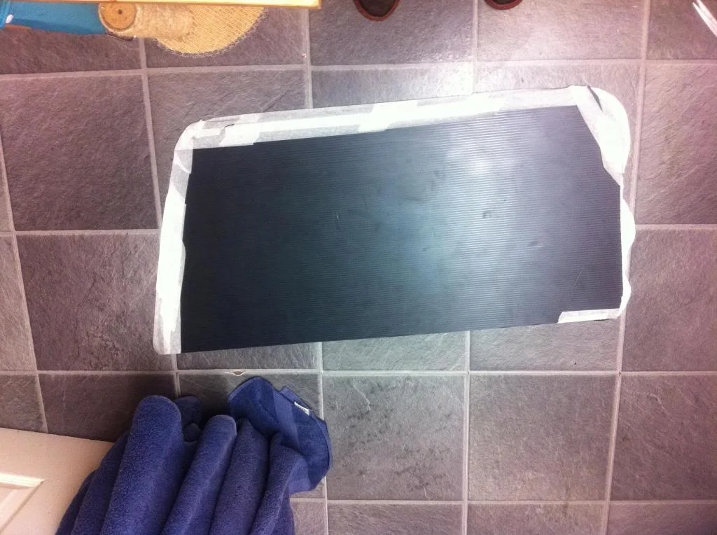

got some 3mm correx stuff from work for free so i thought i make up some door cards, doesnt look at neat as foamex i used on my last car, but it was free...
mocking up the template to fit inside the flatest area of the door
made the one side and then flipped it over to mark round and do the other side, then carefully work out where the existing holes in door were plus add some exta self tappers.
all fitted just need a few more screws, may paint them up satin black as the current black is a bit grey, not perfect but they serve a purpose and look sound with the door closed.
ive orderd some cup racer door handle spacers and will be fitting either a pull strap to open door or fit my lightweight metal handles i made at work

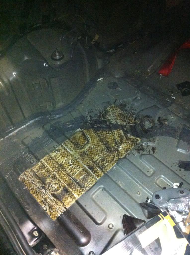

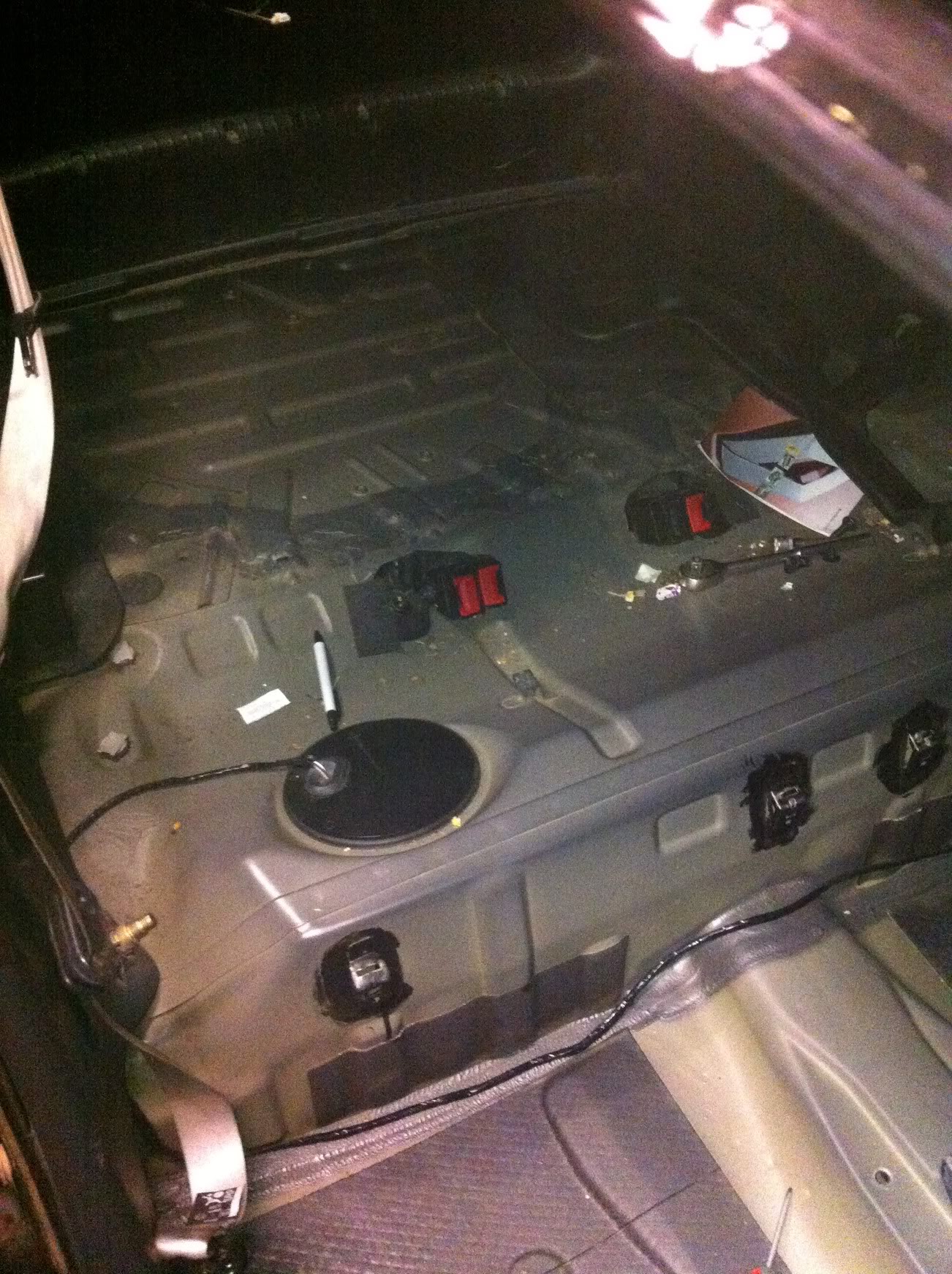

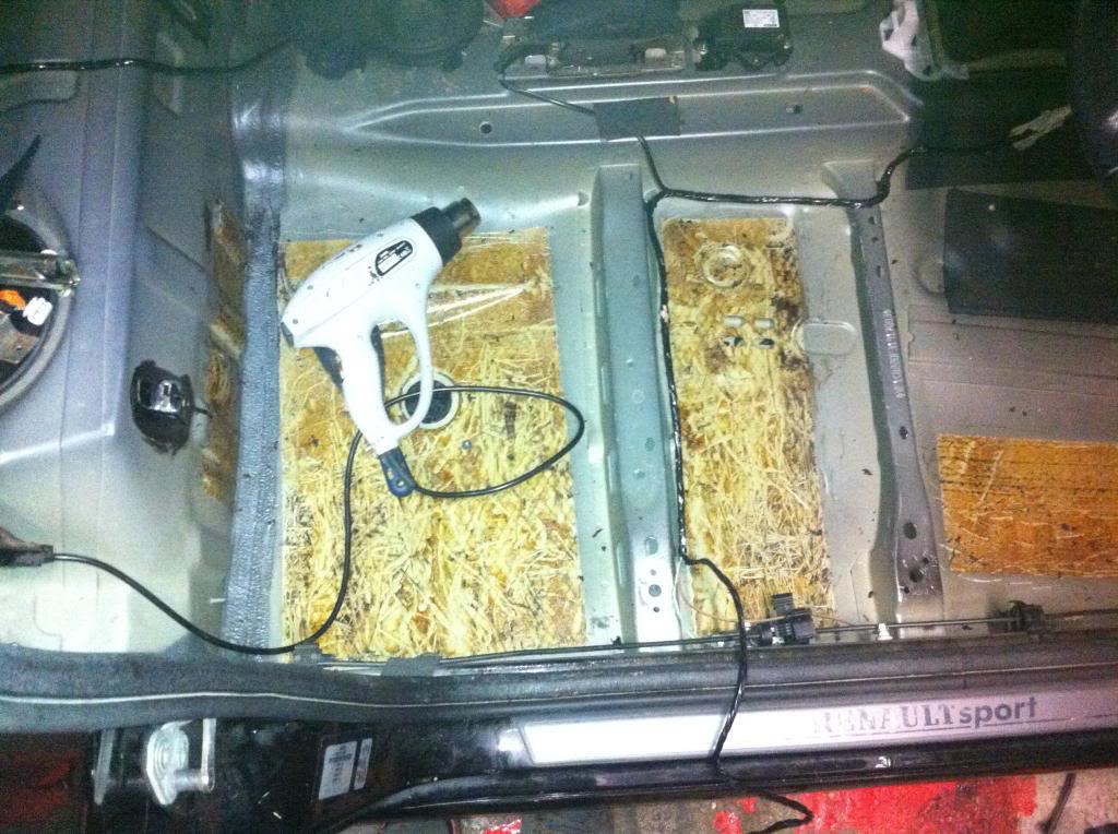

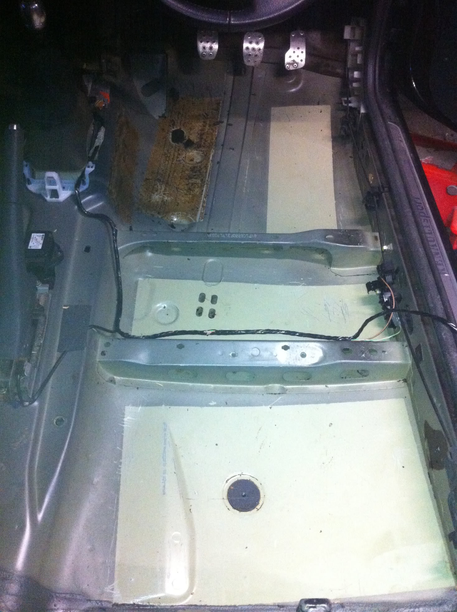

then was onto the not very exciting part of removing the sound deadening, somthing ive never normally bother with due to hassle but i bought a 2000w heat gun and its an absolute peice of piss.
so far ive done boot floor, 2 peices inside where the rear seat belts anchor, the bit behind the seat and half of the front on the driver side and already at 4kg, there must be 12kg of it plus the masaive peice in the roof!.
will use some petrol or somthing to get the excess glue off as the plan is to brush paint all the floor in black hamerite

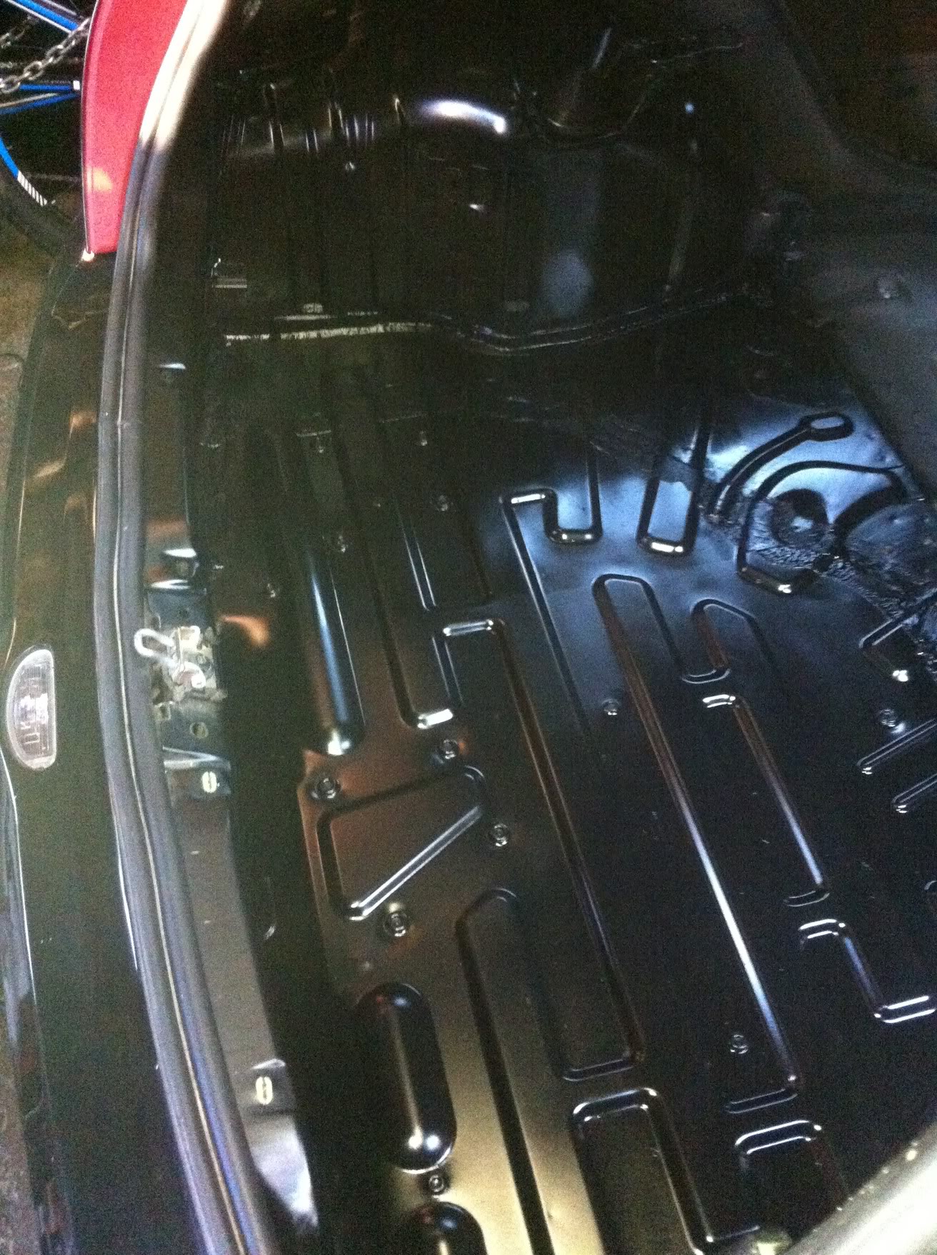

Quick shot of the floor section cleaned with jizzer degreaser

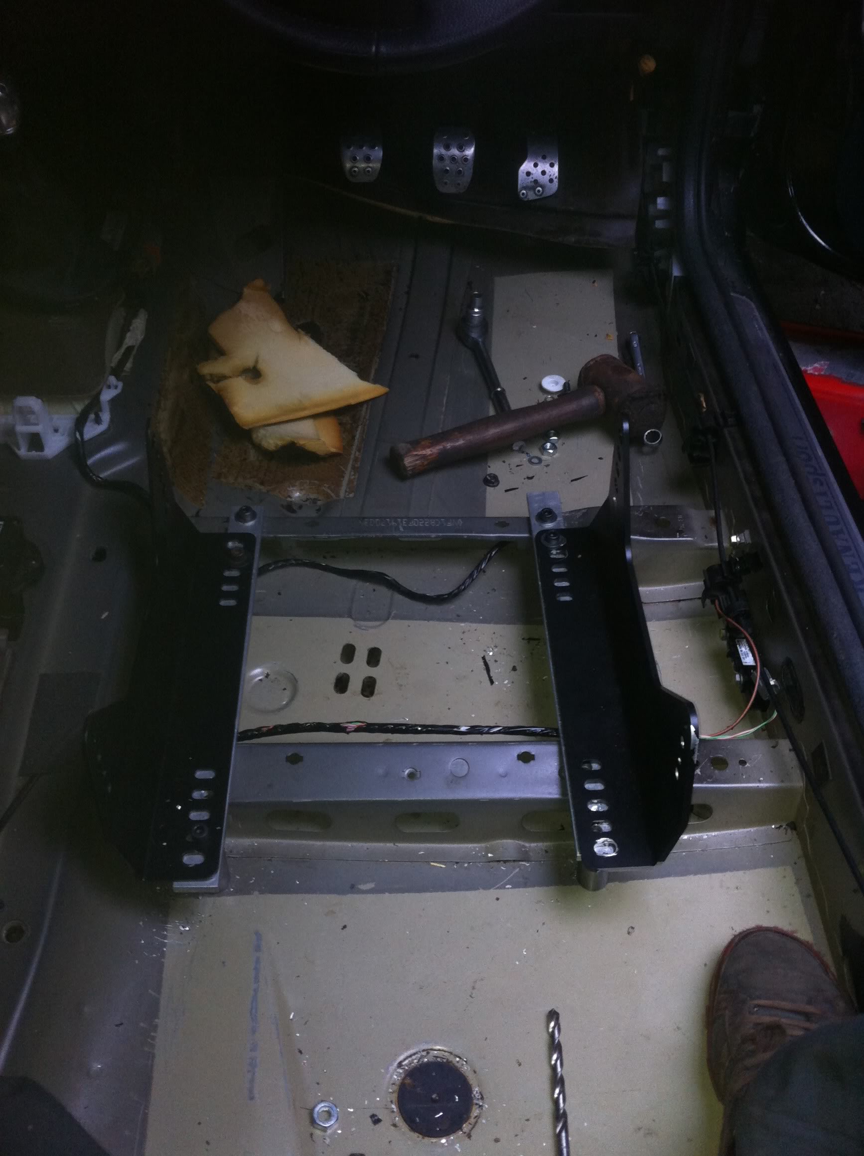

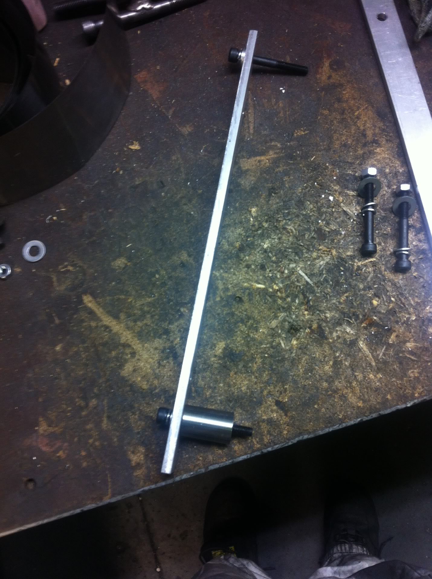

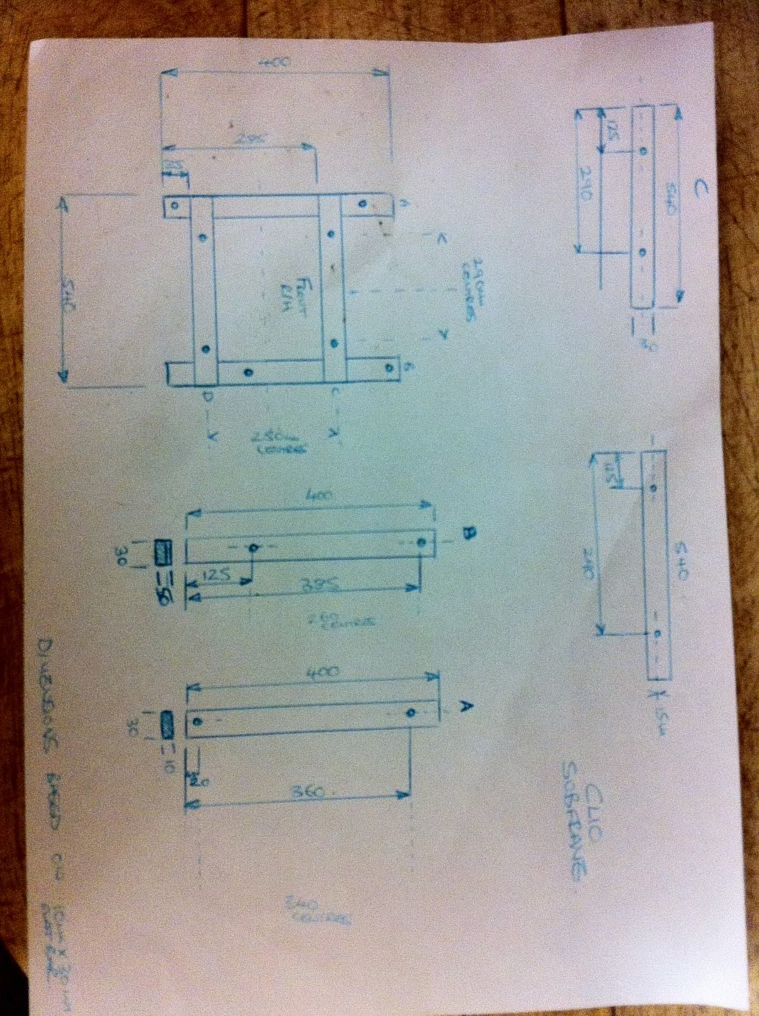

Want seats as low as possible so iv took a lot of measurements and made a drawing to make them
tomorow from 10mm ally flat stock,
should be nice and light to.
  BG182 Track car

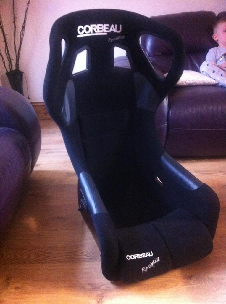

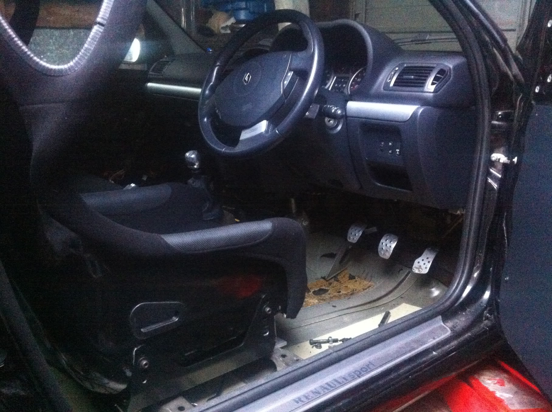

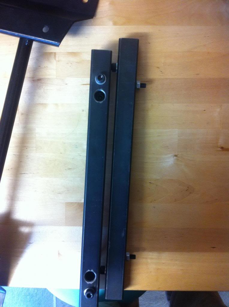

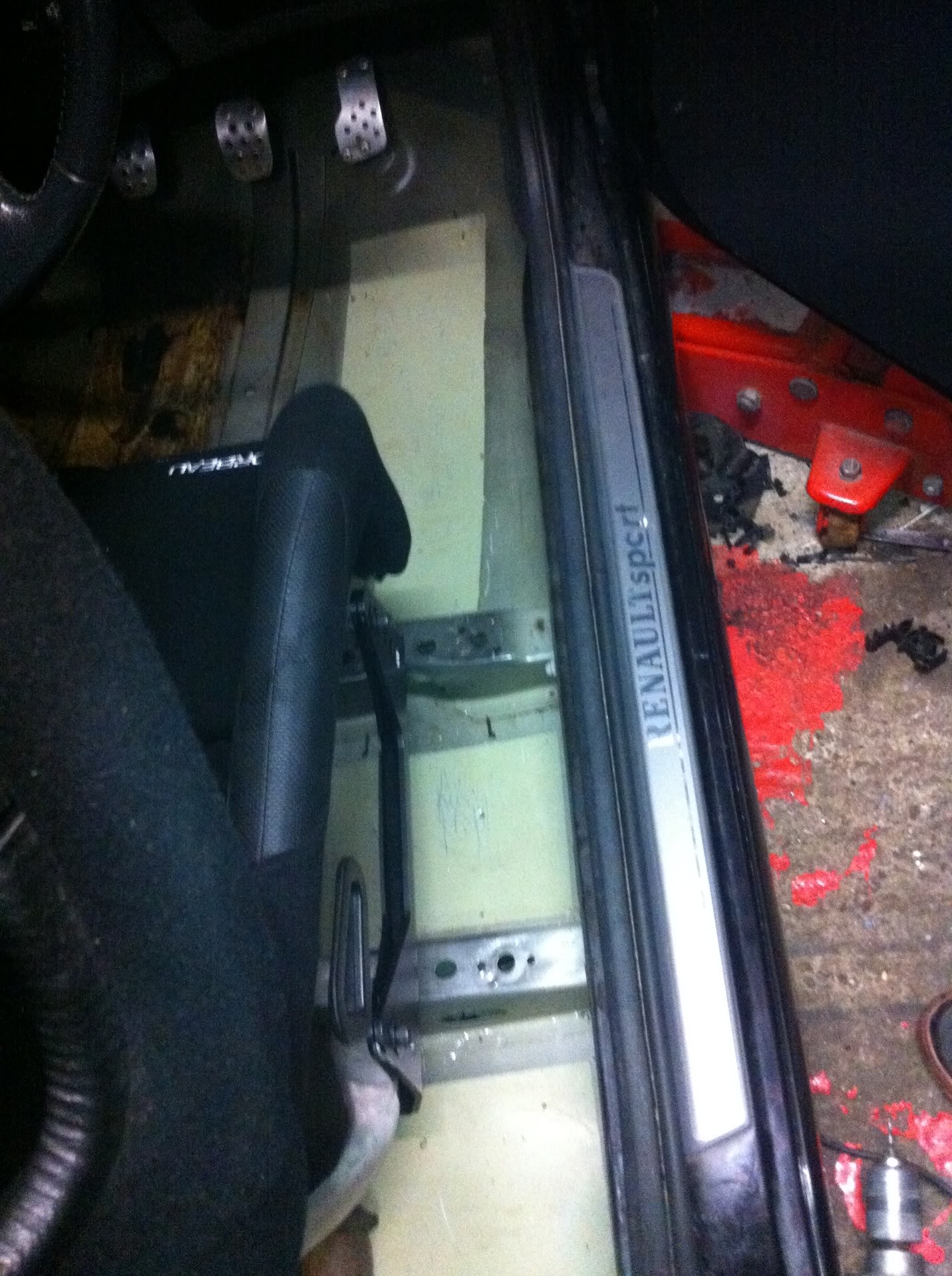

So over the weekend i cracked on and did a bit more, first up was the fitting of the corbeau revolution seat.
the original design of a subframe out if ally was scrapped and a much more simple design was used of 2 lengths of ally flat bar and a spacer at the back to support the very end of the rail, very light weight and saved another 3.5 kg. seat is 7.5kg brackets not even 0.5kg so thats a 14.5kg saving over std seat :)
the flat bar sits across the original raised sections of the floor so is fully supported, bolts to the front rail in the floor and the rear goes through the spacer into the floor and bolted underneath with a spreader plate and bolt.
Seat position feels mint nice and low with option to adjust if need be its a bit of a squeeze to get in but , nice reach for the gear stick, wheel is set in lowest position and doesn't feel like your on top of the wheel like it was on standard seats.

Gutted the passenger door and fitted the polycarb

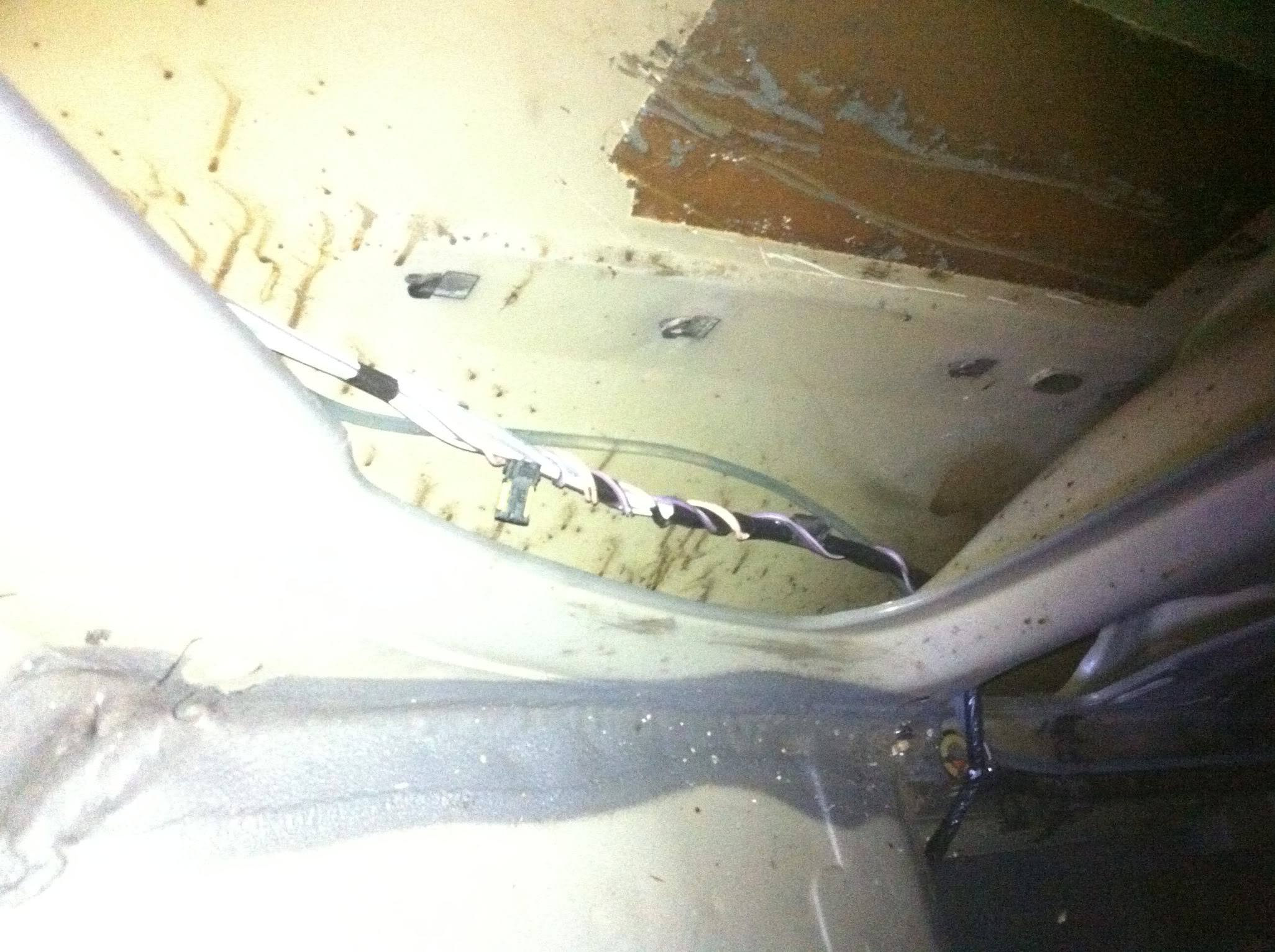

Then i decided i wanted the stripped inside as tidy as possible so set about re routing all the rear wiring inside gap between te internal and external skins, driver side very easy, passenger side i had to cut and rejoin the wires at the top of the boot as it would of been a nightmare trying to feed that back through as its very tight
Glue still needs cleaning etc but you get the idea, looks so much tidier now cant see any wires apart from the fuel pump one, the rear quarters holes will be covered with the correx like the front doors.

Picked the 2nd corbeau revolution up today off sonny172cup, nice to meet another member , nice one mate seats spot on ;)
Nice one buddy, good to have a chat this morning too. If the weather was better I would have showed you around the car.
Btw good project car looks good, you can relax knowing its had Freds hands on it at some point too.
I like what you have done with the seat frames, I was looking at doing something similar as the OMP subframes are a little heavy, also will lower the seat too. I take it its pretty rigid and no flex?
