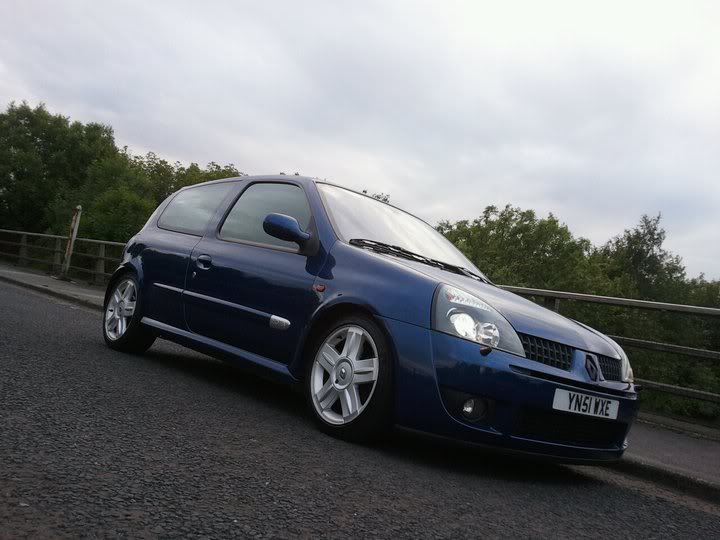

I was searching for some springs when I first got my clio every one told me eibachs sportslines are the best to go for but ain't that low so I decided to go for them which I was disappointed in not much of a drop soo took them off and now have Apex on had them on now for 4 months , seem fine when driving ain't crashy either as people make out and perfect height IMO

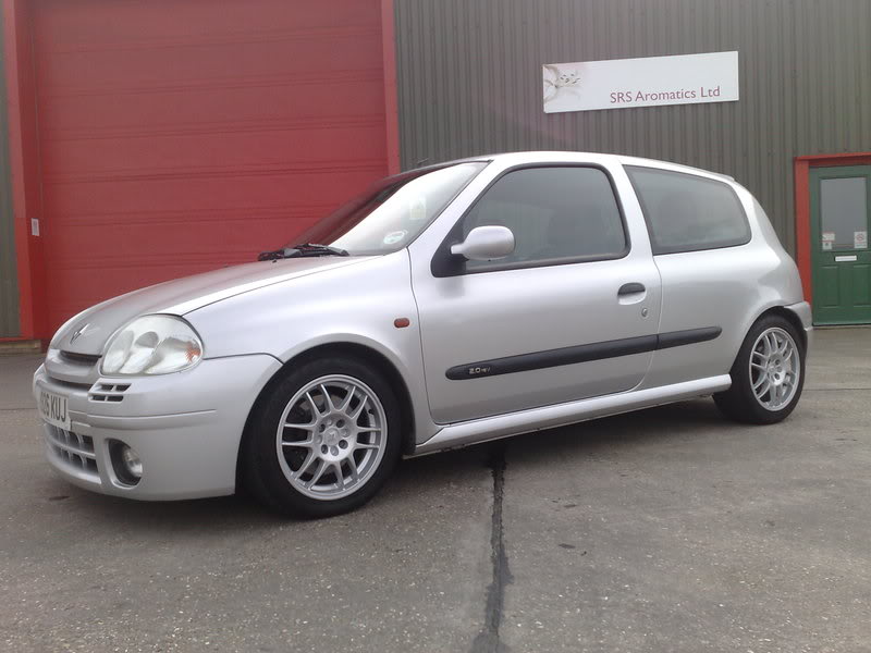

My old one sat perfectly on Apex and handled really well, killed rear shocks though.
(I miss seeing these cars in mint condition)
Then uprated to coilovers which were a lot better. I then owned another Ph1 and put Apex on and ride quality wasn't as good, possibly due to knackered shocks or slightly bigger wheels.
I'd say they're fine if your shocks are in good order!

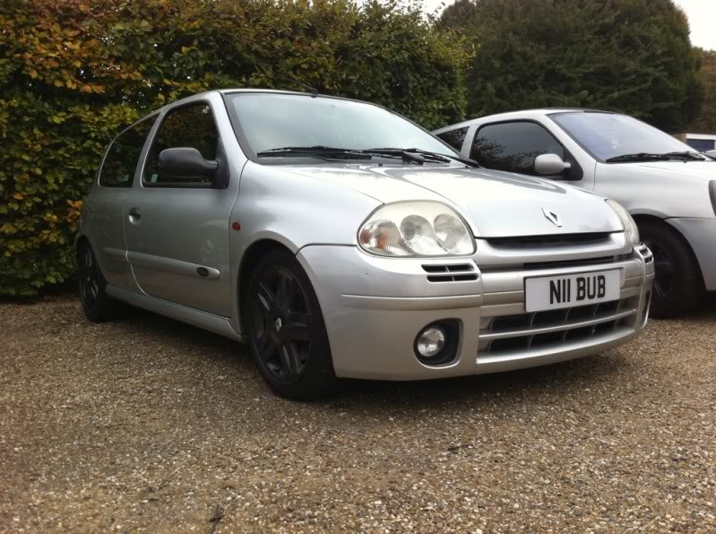

What you want to know? They're better suited to stock shocks (when the shocks are fresh) than Apex, and cheaper and lower than Eibachs. I've used them on loads of cars for years.
Here's a172 with PI springs
