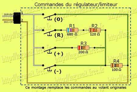

How odd! The system works using resistance in the wire like this
so I wonder what's happened. The 197 buttons are the same resistance as the 182 so I'd bet the laguna ones are okay. Believe the wire colours changed in the clios too

Cheers for that diagram, could come in very handy!
