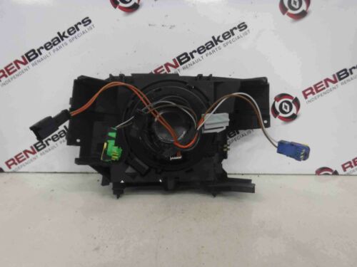

Also some people talk about the need for an "Airbag Ribbon wiring" I can't find info on that, do you know what it is?
Thank you so much
Matt Cup
  Leon Cupra
Thank you so much my friend, that's a huge help
Thank you so much
That’s what Rsrowe quoted above fella.
  Clio 3 1.5DCi 2011
Thank you Martin,
I thought the Ribbon, at least by written descriptions, would be a ribbon wiring with multiple wires, I don't see ribbon looking wiring in the Squib.
But thank you, I will probably order that part

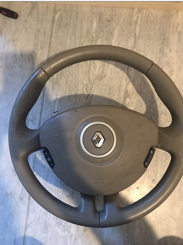

Does anyone know if I buy the Complete Steering wheel (the cruise control model) if it already comes with the Squib installed as part of the complete steering wheel?
This is the one:
This is the one:
Nope. You need the part I linked which attaches to the steering column itself.
