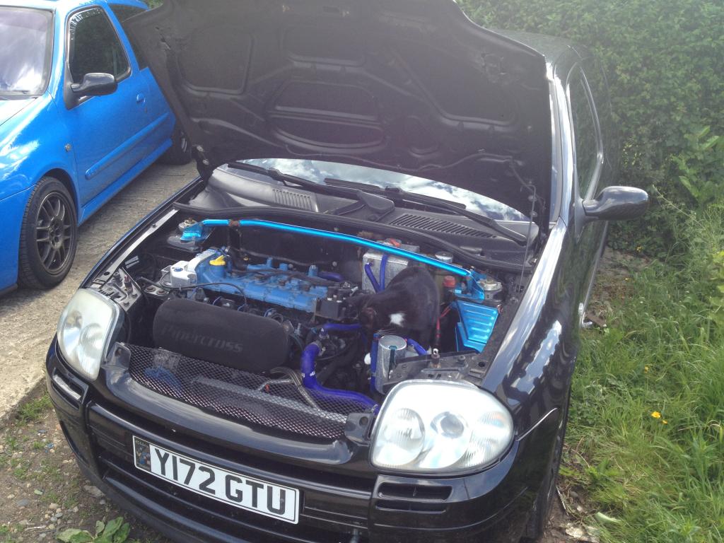

Left the bonnet up while I was busy doing some other stuff, turned around to see my neighbours cat sat in the engine bay, looking at me like I was the stupid one. Moved before I could get a decent pic though!

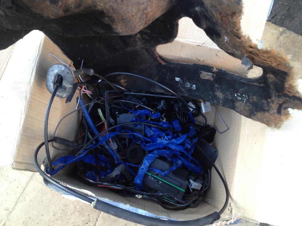

Heres the box of stuff I removed today, will weigh it all eventually.

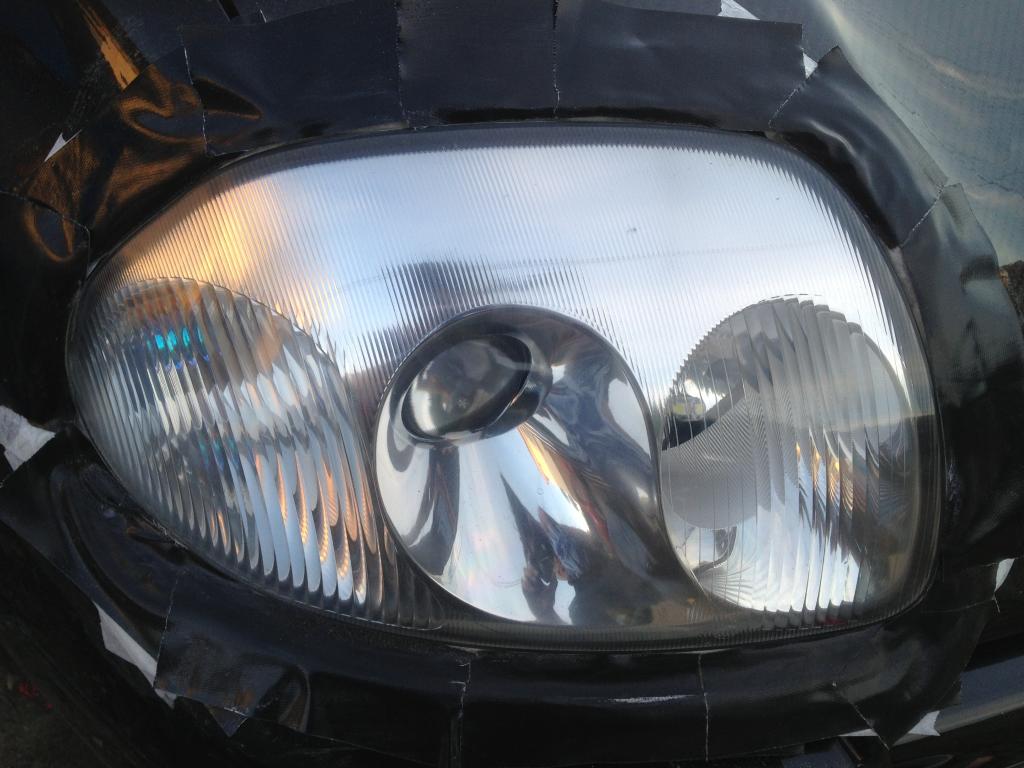

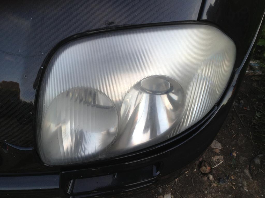

Then still had some energy... so restored one headlight, will do the other tomorrow.
Before...
After

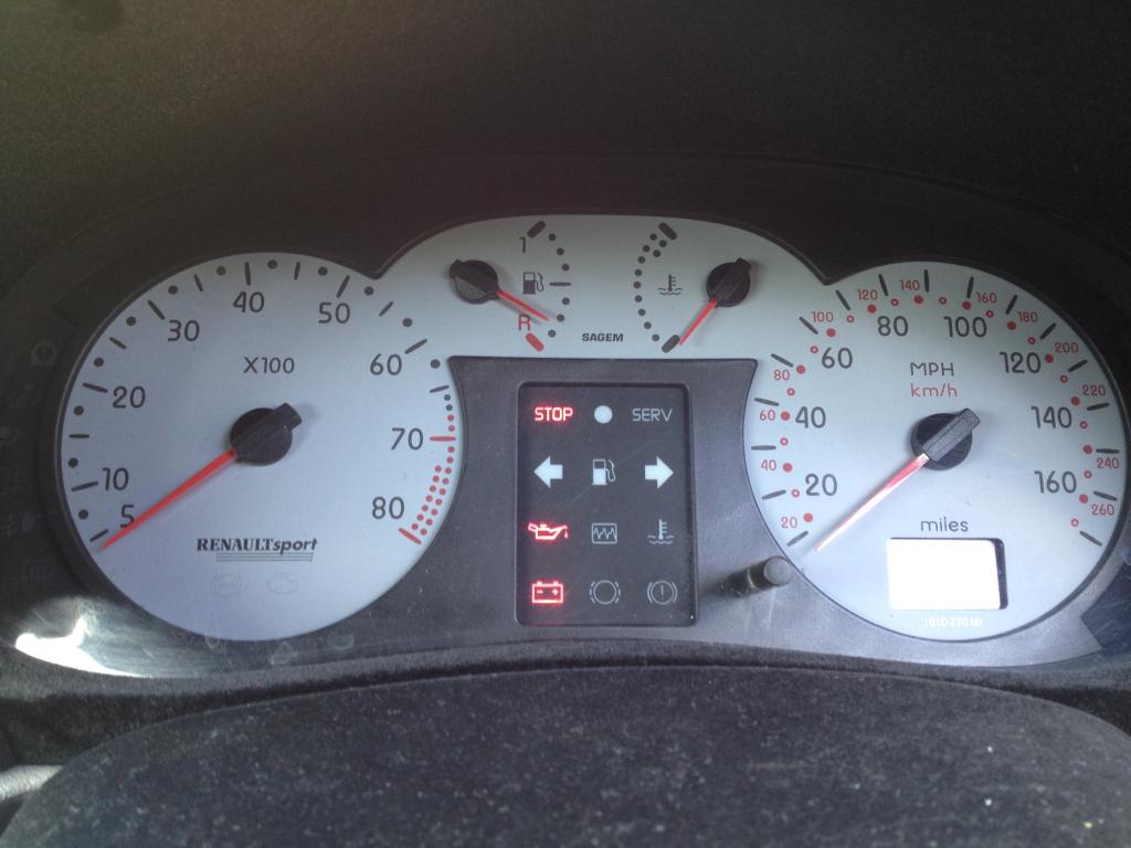

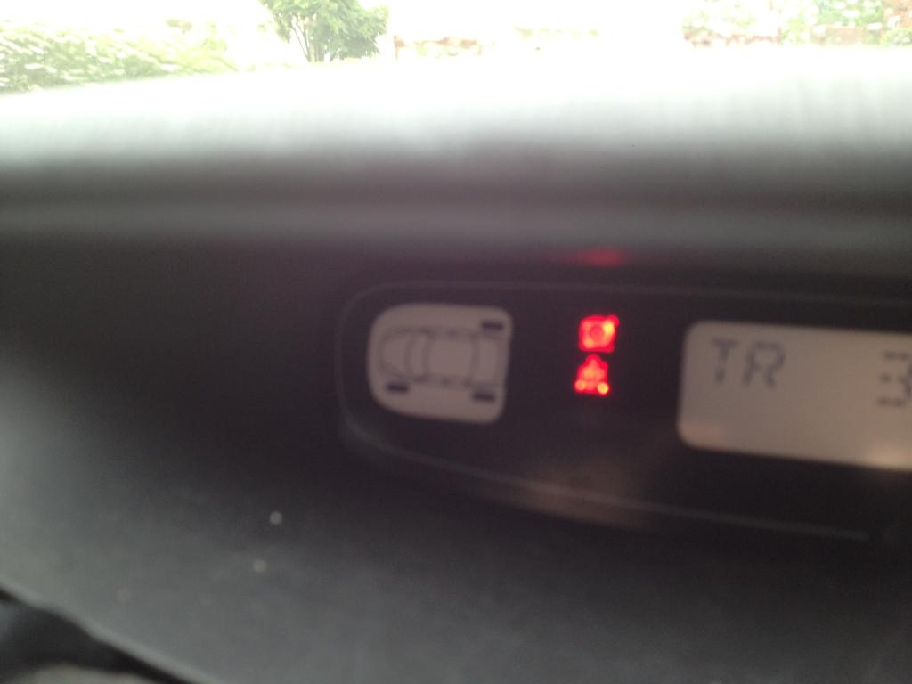

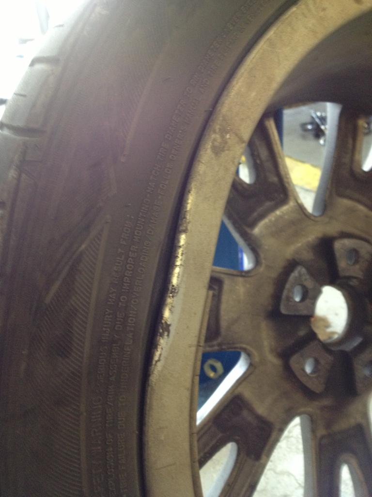

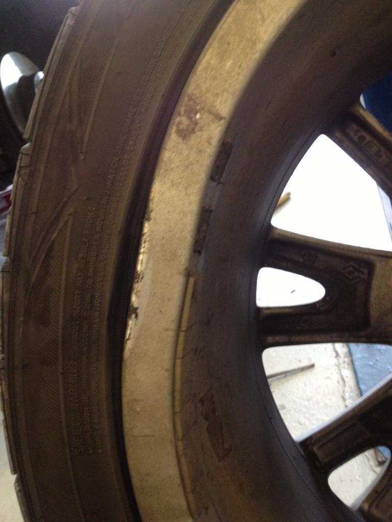

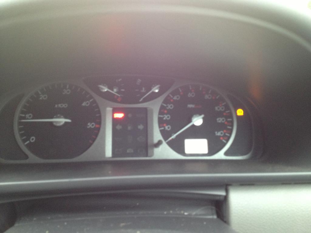

Firslty a lol @ the Laguna. Recently hit a pothole and since then I had noticed a slight vibration. Found out why a couple of mornings later, Dash goes mental when you have a flat tyre, all this flashes! lol I like it though.
Potato cam did good.
Good bend.
Smashed 7 bells out of it, Dr Jekyll will confirm, I was sweating, swearing and laughing by the time I'd given up. I improved it, but still leaks, Oh well!

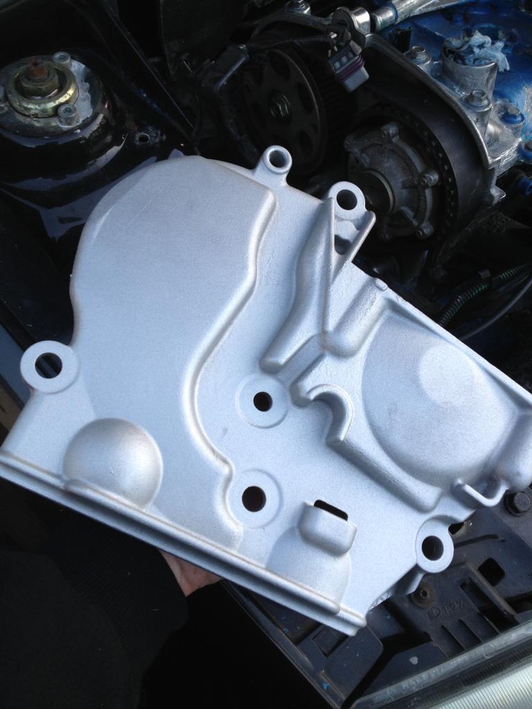

Mark (Dr Jekyll) very kindly shot blasted a fair few bits for me, You'll get the jist as I go through I think.
First up to go back on is Cambelt cover, looking much better now its been blasted and had a quick coat of paint

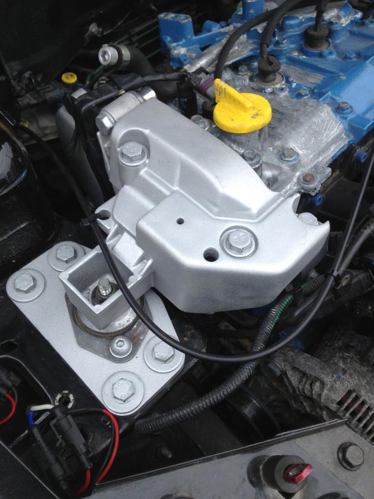

Followed by Engine mount, and the solid mount, Looking much better.
Note in the middle of getting rid of the horrible blue flakey paint on the rocker cover.

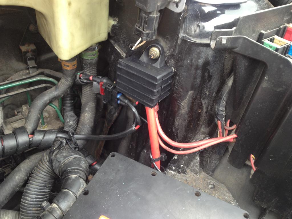

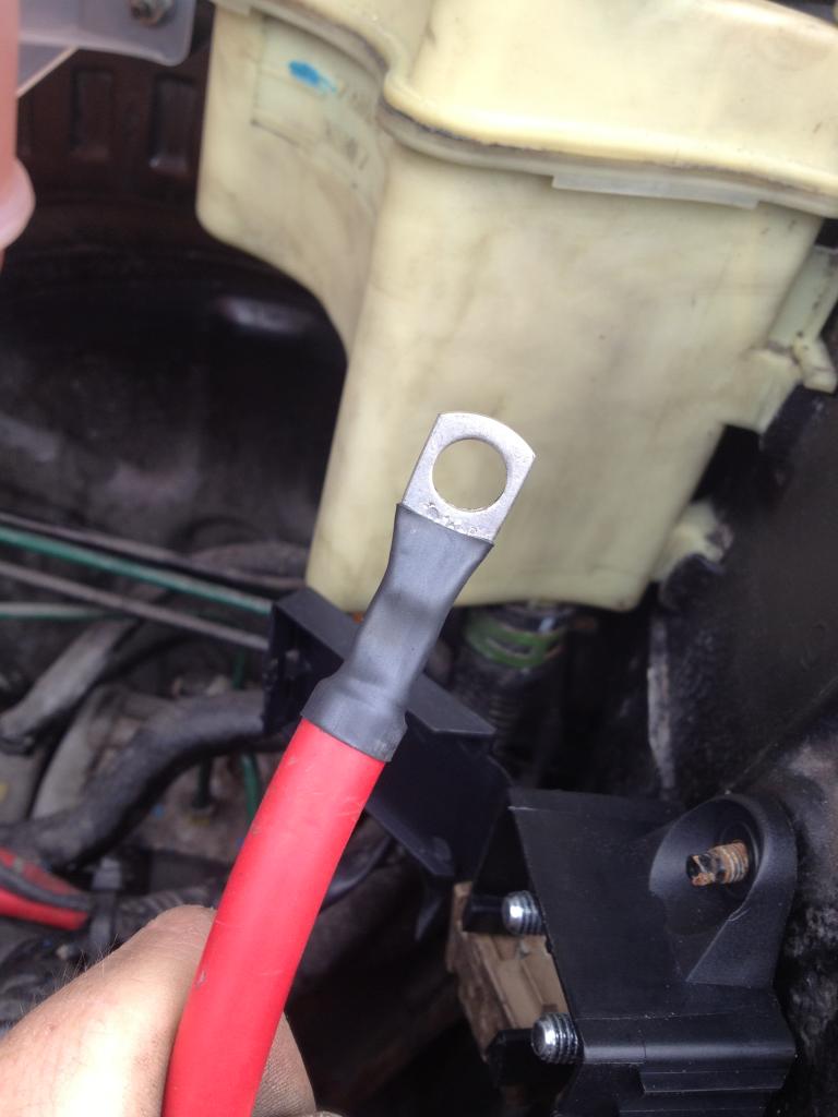

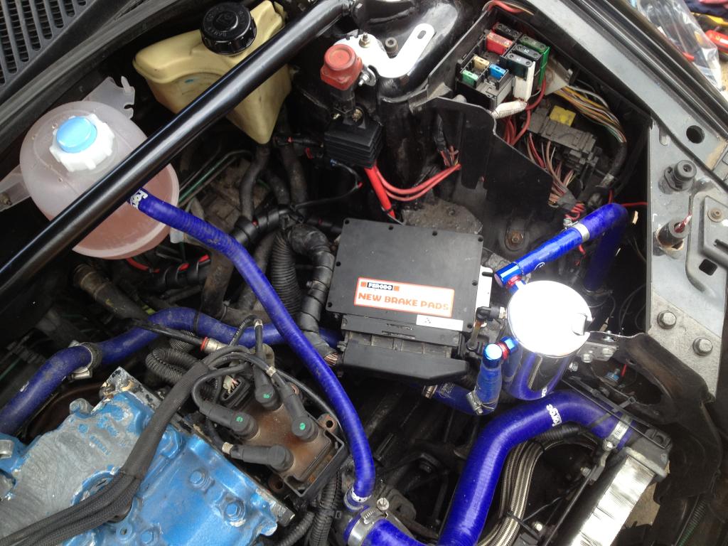

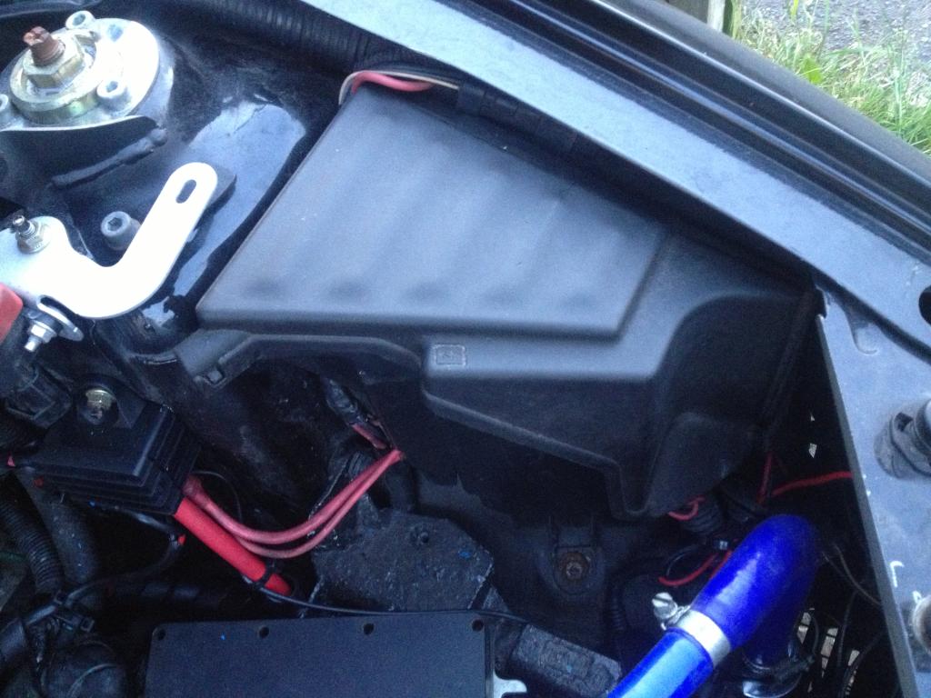

Next was the Battery relocation stuff, It had been done previously, and I wasn't much of a fan. Engine bay end had everything bolted together and then lashed in tape, Not exactly perfect, or up to my standards at all.
So a terminal box was bought, and I set to work fitting that today. First up was shortening the existing battery cable, so new terminal and heat shrunk properly.
All fitted up, inc replaced wiring for the secondary cooling fan. The wiring that was there is rated for 7.5 amps, the fan draws 11amps starting up, and when up to speed, 7amps. So not man enough wire, plus it had a 10amp fuse, so the wiring would burn and melt before the fuse popped! So thats all been replaced and sorted out properly, Plus the old wire had been crushed and nearly shorted out.

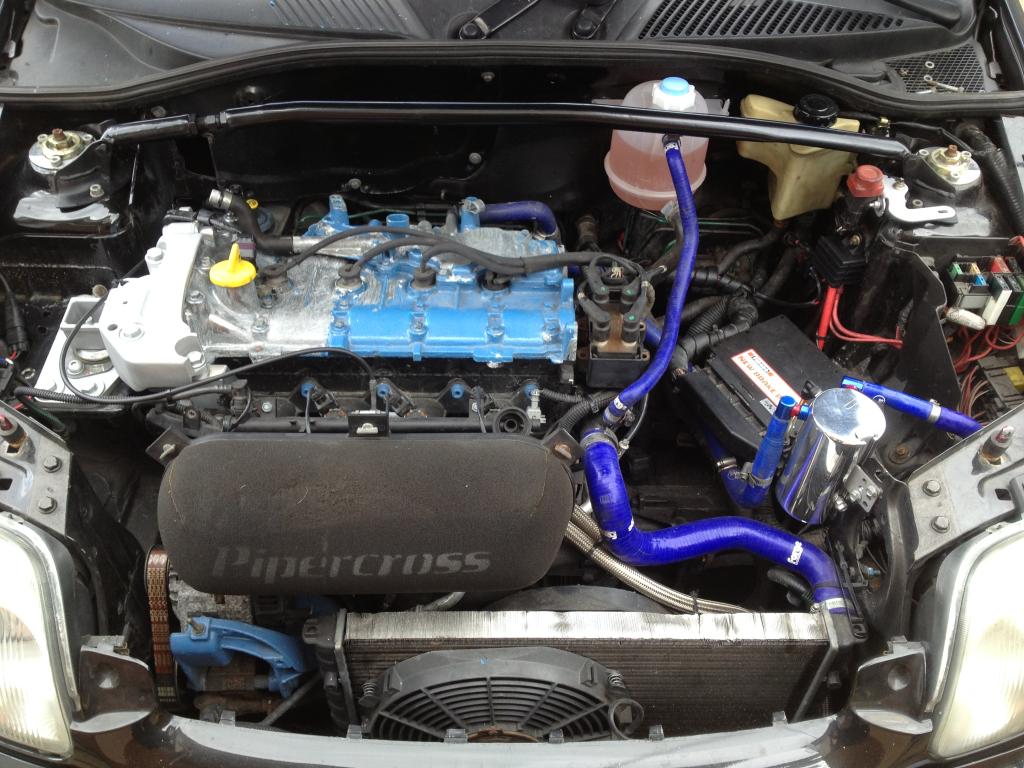

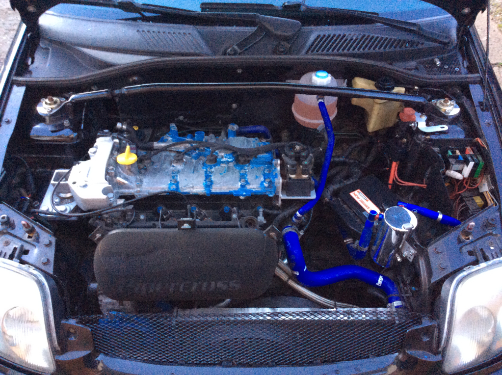

Corner is looking much better now. Note new header tank, Stop switch bracket blasted and painted, removed un-necessary earth lead and just general tiding. Fusebox cover is on its way!

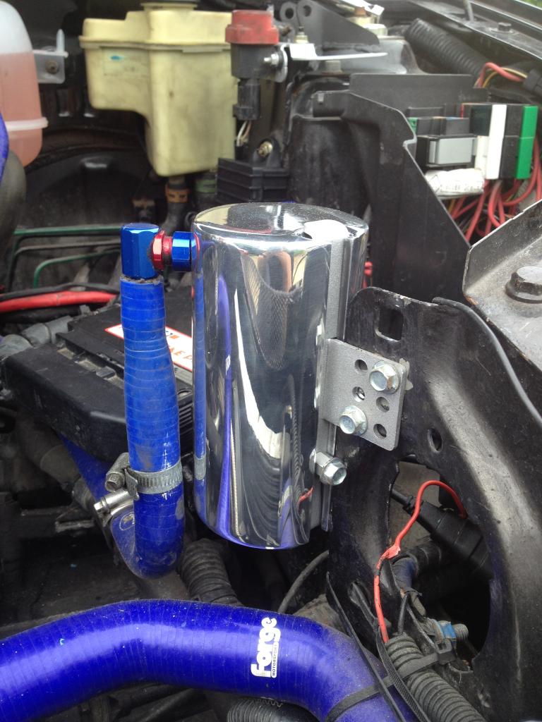

Mark also buffed up the catch tank, blasted and painted the brackets too.
Bay is looking much better already. Strut brace had the same treatment as everything else, now looking much better.

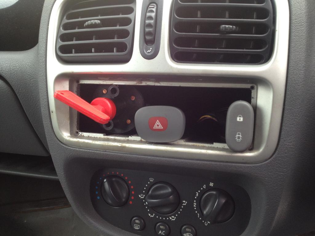

Next on the list is kill switch, which I'm thinking roughly like this is a good idea, just need to confirm with Rob. Will make up a nice blank obviously.

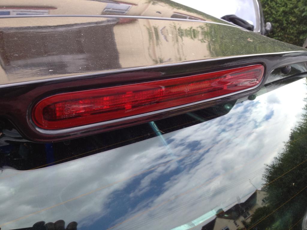

Also fitted a new Centre brake light, old one was cracked, didn't work and didn't fit right, this is much better!

Engine bay looks loads better already. Some of that blue was caked on! Looking forward to seeing a complete engine bay pic.

Its certainly looking a lot better all round really. I too am looking forward to seeing a completely blue-free engine bay, Some way off yet I reckon!

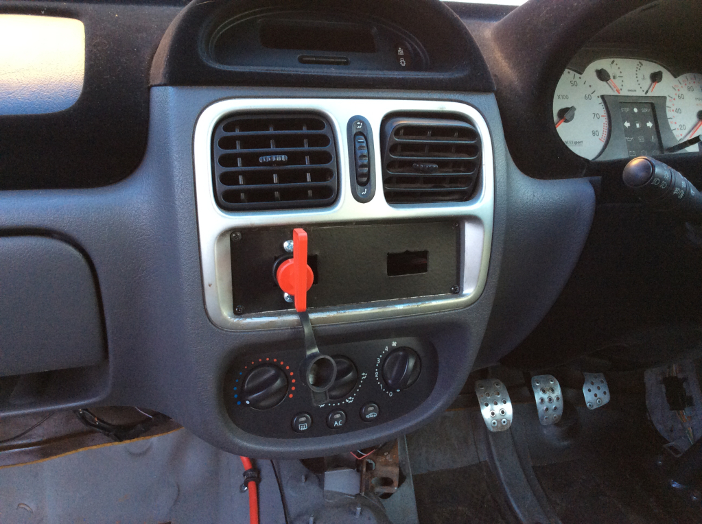

To test the location of the kill switch, I fitted it into the existing blank for the radio. I shall be replacing this with a peice of lightweight alloy.

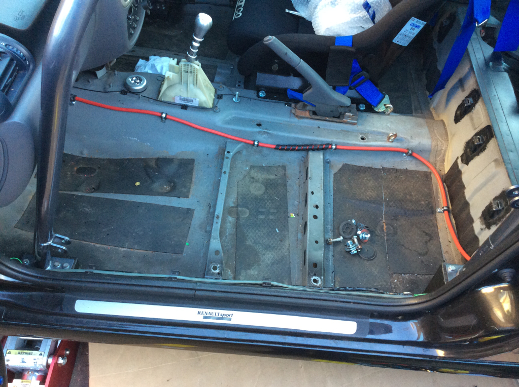

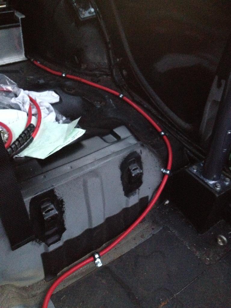

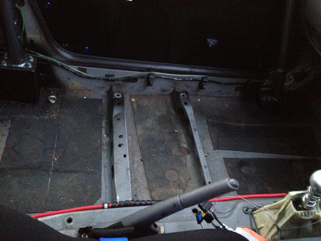

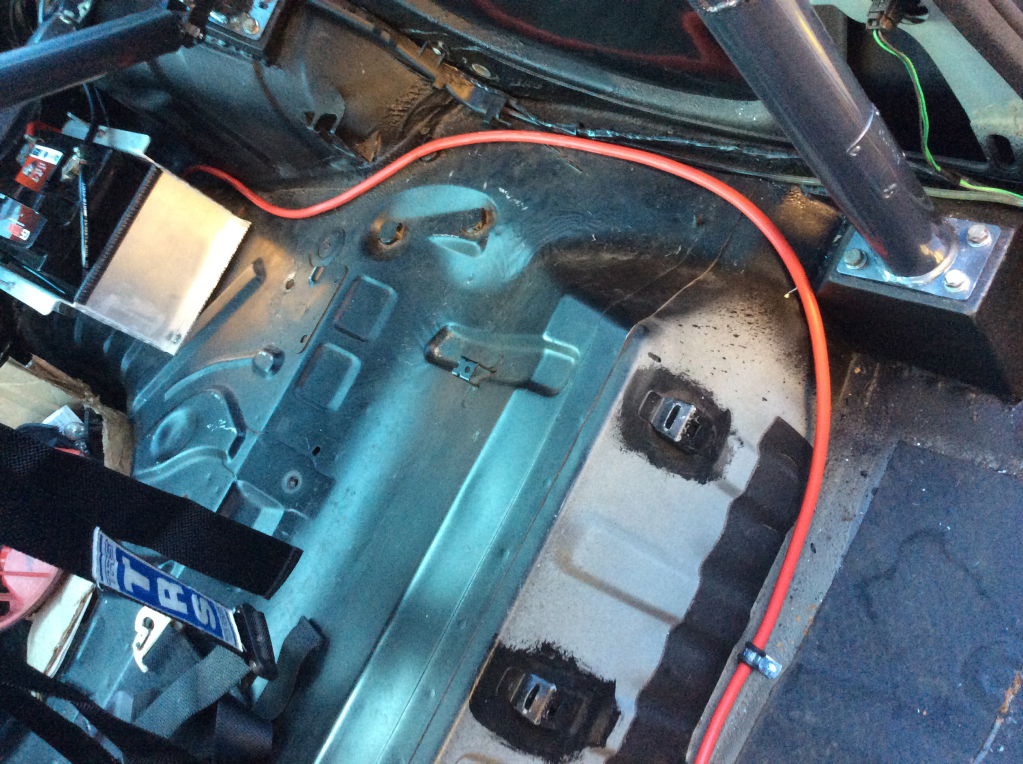

Got the door bar and passenger bucket out, to run the wire from the kill switch to the boot mounted battery. All this will be coming out soon to paint the floor black, remove some sound deadening and cover forward footwells with skateboard grip tape.
I ran out of cable clips, so I will finish the rear off tomorrow hopefully, heres the rough routing, I will also be fitting a fuse next to the battery at the back.

Finished off battery wiring too.. Also fitted fuse etc.

Also got a fusebox cover today, so bay is looking better too. Secured the airbag module out of sight, tidied up the wiring for it too. Just kill switch stuff to finish off, Inc alloy plate that Dr Jekyll sorted for me. Nearly there.

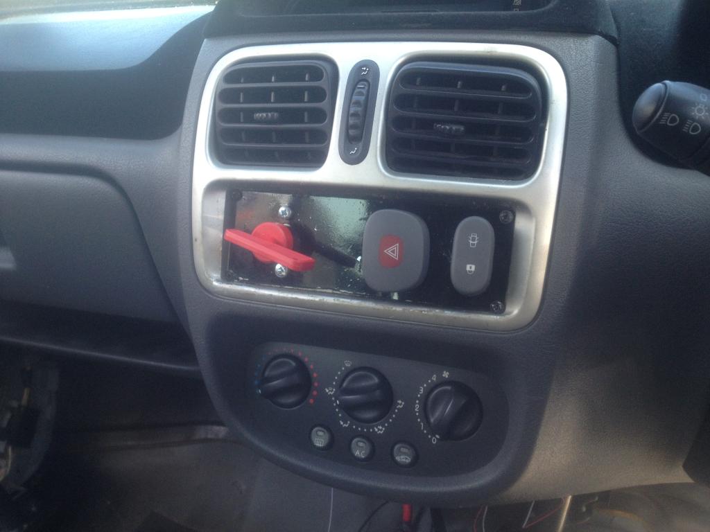

As I mentioned earlier, fusebox cover turned up... Much better!
Then sorted out the radio blank. This is just a template really, make sure it worked, as the finish is f**king terrible (my fault!), I'll get the lock switch up the right way too. Will keep the hazard switch (which I've now double fixed, no longer sticks and works with ign off!) up the same way it is now, keeps it tidier I feel.
I need to change the ign cut of the kill switch, but thats no big deal.
