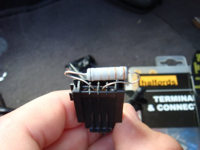

When you say join do you mean your linking the circuit closed? if so this may be your fault, needs 3.3ohm resistors put in there.. mine are still on after trying it, belive only a renault clip system will clear it, ie not the normal obd port readers right?

Your meant to do it like this mate, Stil hasent worked for me, belive the resitor is the wrong size so went to maplin & bought some 3.3 ohm - 15p each so will do them all again & see what happen's!
