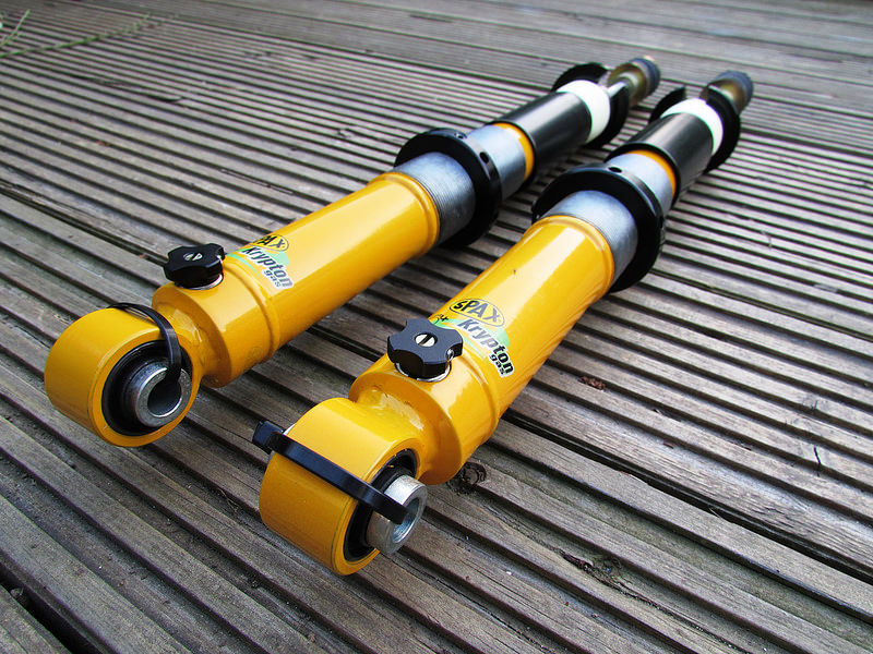

Copy and pasted from the K Tec website which is where my Spax kit came from
http://www.k-tecracing.com/show_product.asp?id=4510
Front 342lbs
Rear 228lbs
New rear units delivered to me this week
. by Ricard o1, on Flickr
Ricardos
  LY 200 EDC
I'll give them a call on Monday, if they do I'll get a price on 250lbs springs. Thanks again for the advice :)
