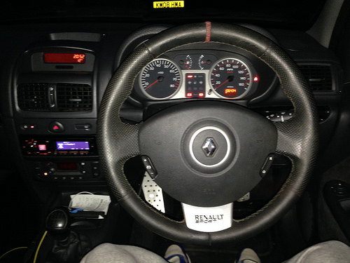

Saw a bit of a bargain on eBay and treat myself as it was my birthday this week.
So got on with fitting it tonight with the help of a friend, surprisingly straight forward :).

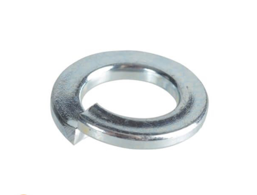

You have to sand out part of the inside of the wheel to fit the cruise plug and fit an m20 washer behind the wheel so it spaces out and doesn't snag the squib or the cowling
