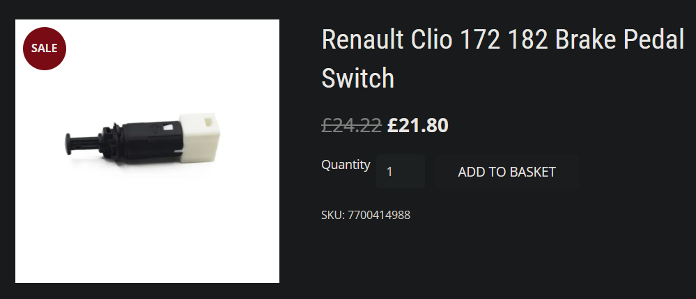

The Parts Cannon does sound like having a tempting reload - given the fact that they are relatively cheap.
Matt Cup
  Leon Cupra, 172 Cup
Hmmm - your issue might closely align with mine.
That brake switch was swapped a few months back in an attempt to investigate the cruise control issue. Since then, it can occasionally dip into the idling revs, almost to the point of stalling. It never has, but it does sound related as I never had a issue before.
Half the price here. I bought this one as my switch didn’t work at all.

Hmm, well I bought a Febi switch and that didn't solve it, the plunger is a bit longer on the new Febi switch, I wonder if that makes a difference, but with both the old and new switches the fault unfortunately remained.
