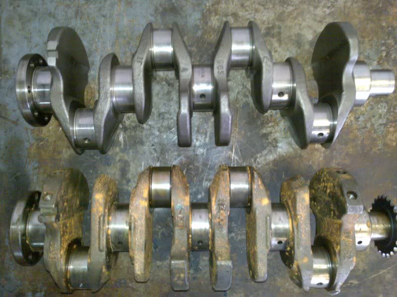

They aren't identical, i have seen a lot of 172 ph2. crankshafts and now i have one from a 182 and it's a little diferent. i will post pictures today.

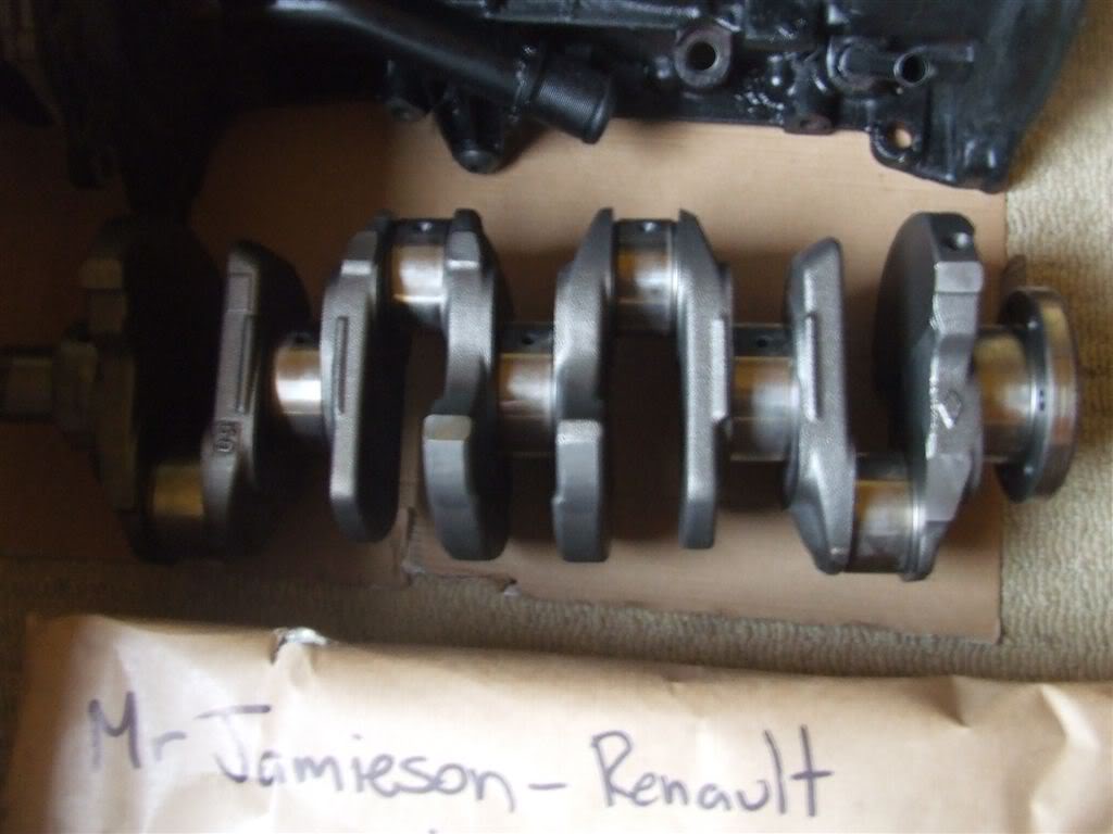

Here's the answer, 172 and 182 crankshafts
like i said before they aren't identical.

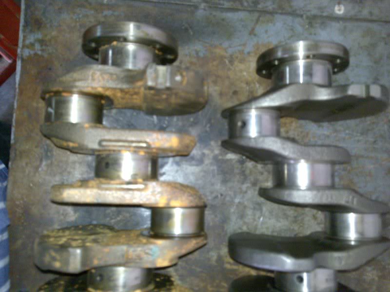

One is rusty, one isn't ;) seriously though if the journals are the same and its the same stroke then you should be able to use either, have you weighed them both ? the non rusty one looks as though its lighter ?

Cranksahft clean is from a 172 phII and the rusty one is from a 182.

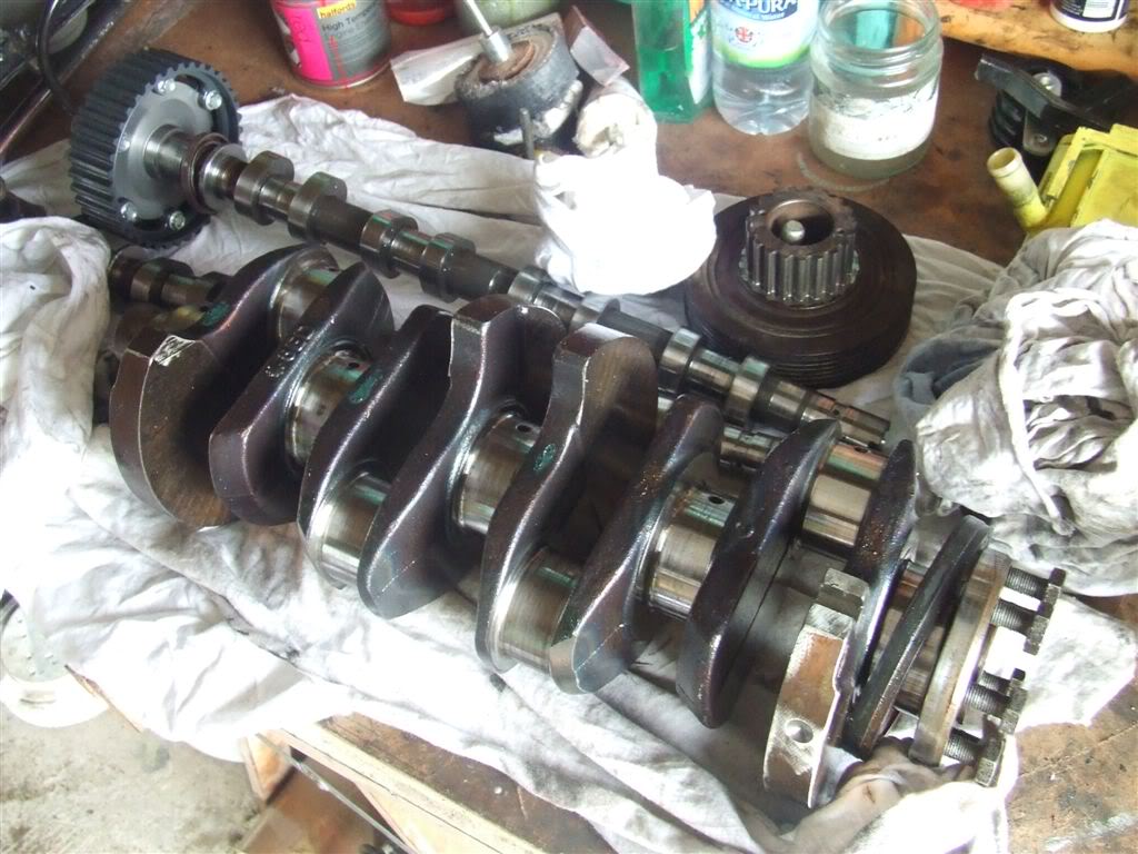

I always thought they were the same too, but after looking back at my photos, they are indeed different! (same fitment though)
172 ph1:
182
but to answer the question, i've got 182 bits in a 172 crankcase... seems ok!

as far as I can see from the pics, yep they are different. I am sure there is no difference in performance-wise comparison. Most probably, different suppliers, different molds or cheaper production techniques.

The part number for a replacement 172 and 182 crank is the same BUT there are eleven different part numbers that have all been superseded into the number 8200037836 - probably to make it easier to stock for replacement parts.
I believe the 182 has larger counterweights to make the engine quieter and with less vibration - I don't think Renault intended any difference performance wise purely passenger comfort!! BUT, a fully counterweighted crank should also improve reliability with less bearing loading due to less whip and flex but will give more engine inertia with slower throttle response and acceleration.
