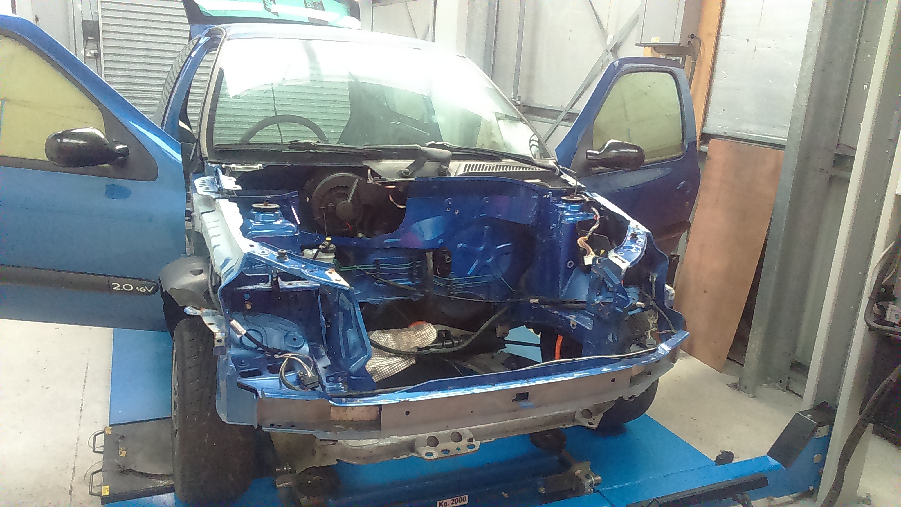

Last year I started to strip my Clio down and sold the suspension and other bits I didn't need to reshell into a black 172 clio that I had bought with a knackered engine. I also started to stock pile other parts and a better engine which led me to @Ph1 Tom house to buy his engine, but also ended up buying a load of other bits including the 172 Cup shell. This was just the time my neighbour binned his Cup at Oulton park so he ended up buying my original shell from me to reshell his car.
So for the last 6 months or more, I have had a shell, a cage which I bought in the group buy last year and a garage full of bits which require building together. Working away and family stuff when I was home meant a lack of time to do anything so I really have to pull my finger out now and get it sorted.
As @sam JFM was breaking his clio rally car, I also bought a load of bits off him too to save me some time and hassle.

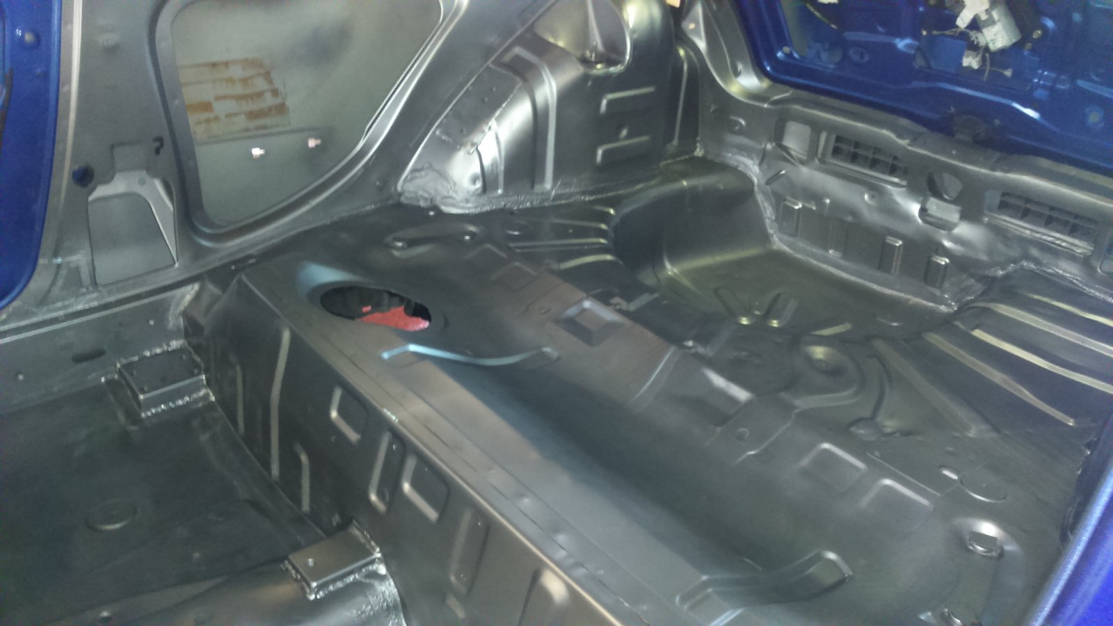

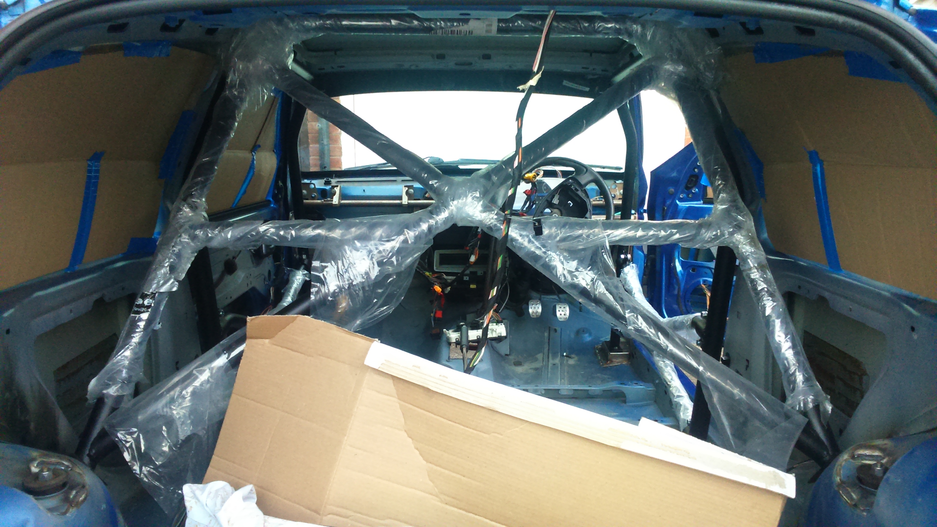

Over Christmas I took the cup shell to my mates unit and finally managed to get the cage in (worst cage I have ever fitted and ive done a fair few over the years) and get it back into the garage. I just need to finish welding the seat rails, mounting the extinguisher brackets etc before I chuck a bit of paint in there before refitting everything. I have also been cleaning up the engine parts etc and spraying them silver to tidy things up a bit. The engine and gearbox will hopefully get fitted in this weekend.

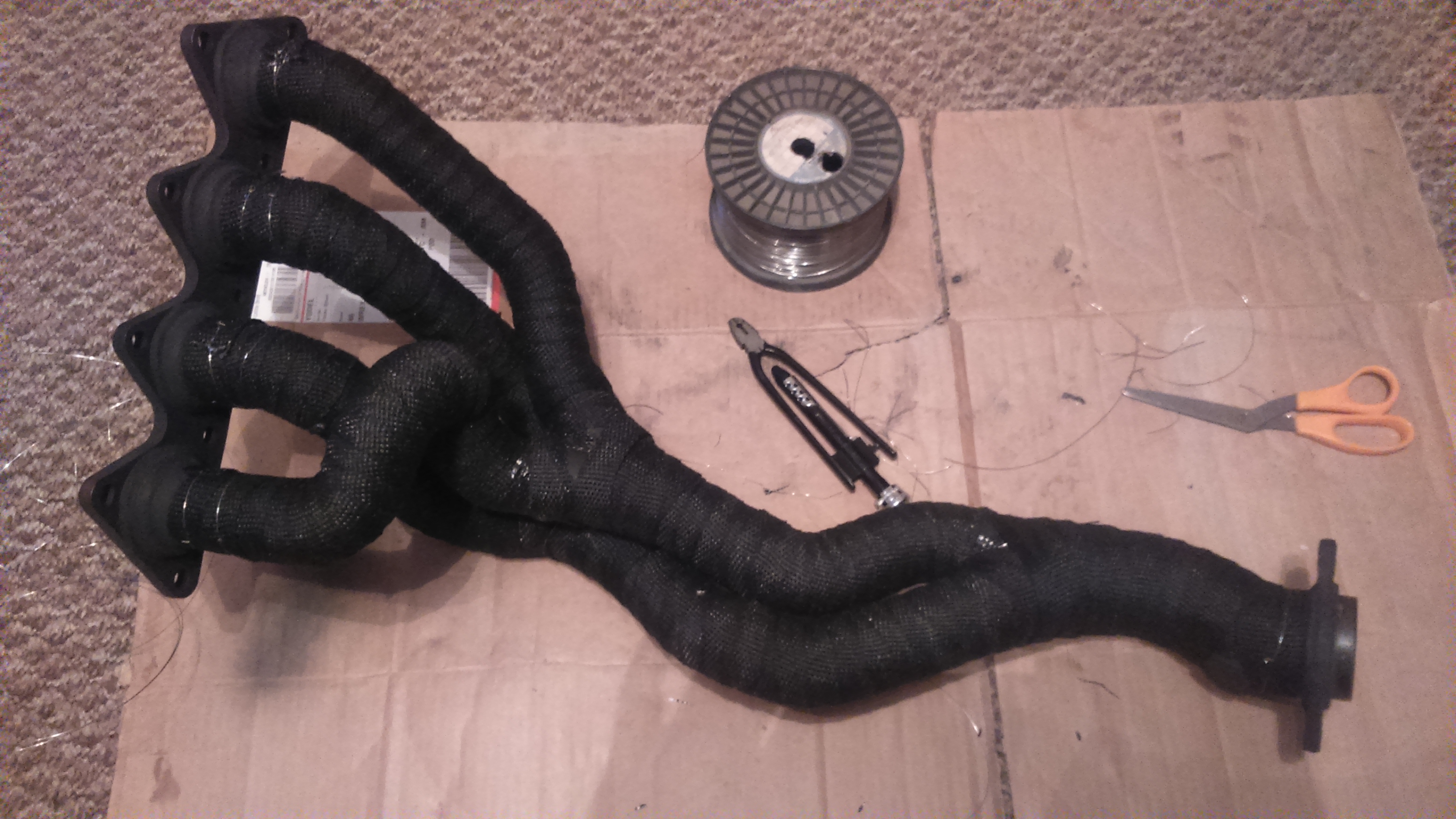

Tonight's job - finish wrapping the 182 manifold
100ft of 1" wide exhaust wrap and about 4 hours in total (whilst watching TV at the same time)
Crappy job but it's done now and should reduce a fair bit of heat from the engine bay.

Looks good, be interesting to see how it goes in that spec. Been thinking about doing something similar with mine as my Escort is a money pit.
Not sure on the brown cardboard windows though. You might be able to see better through white card?
Pauleds
  Merc Dueliner sport

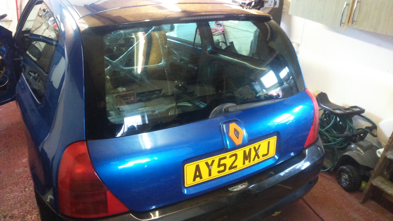

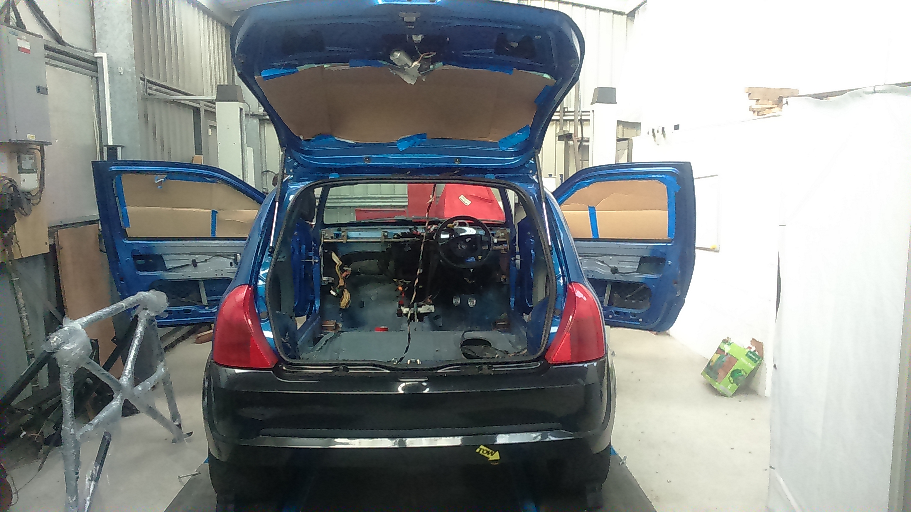

Card and tank tape is the new MSA ruling, bit of extra protection to go with the window film. I am finding the brown a bit dark so may switch to white to brighten it up

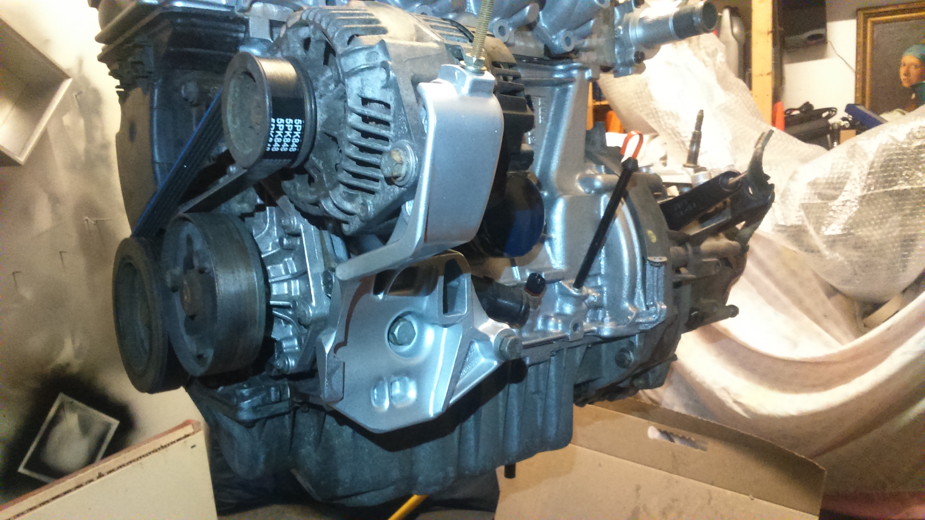

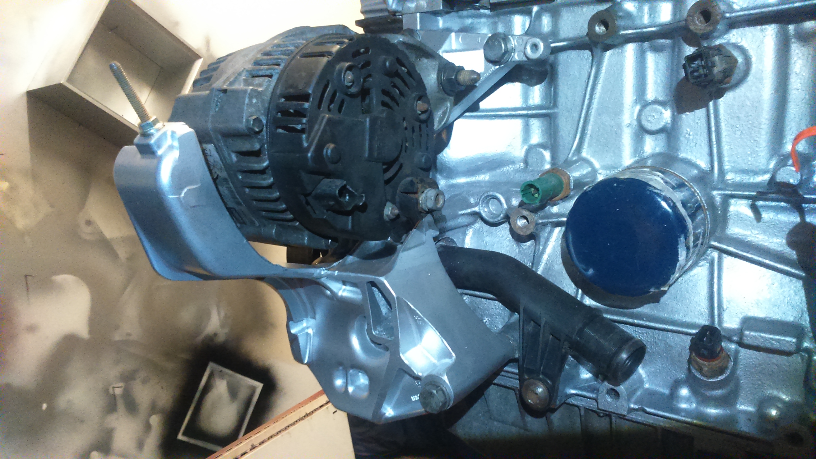

@Pauleds that alternator mount looks nice and tidy now, I need to do this to mine when I put my EPAS on, what belt have you used for it?
Cheers

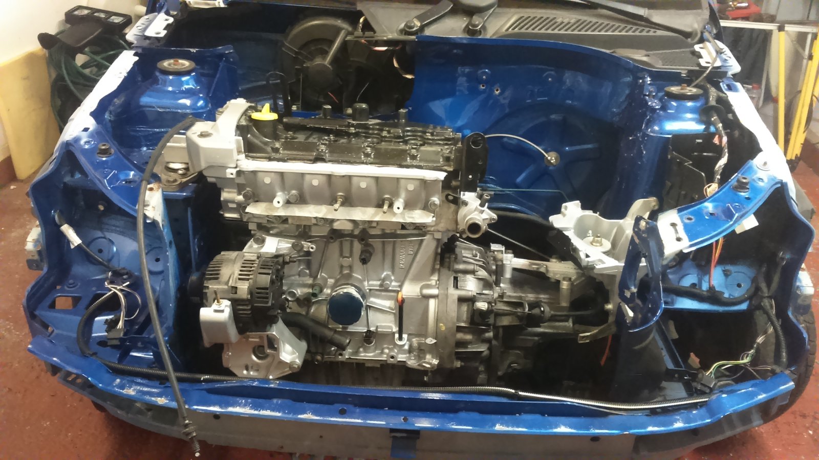

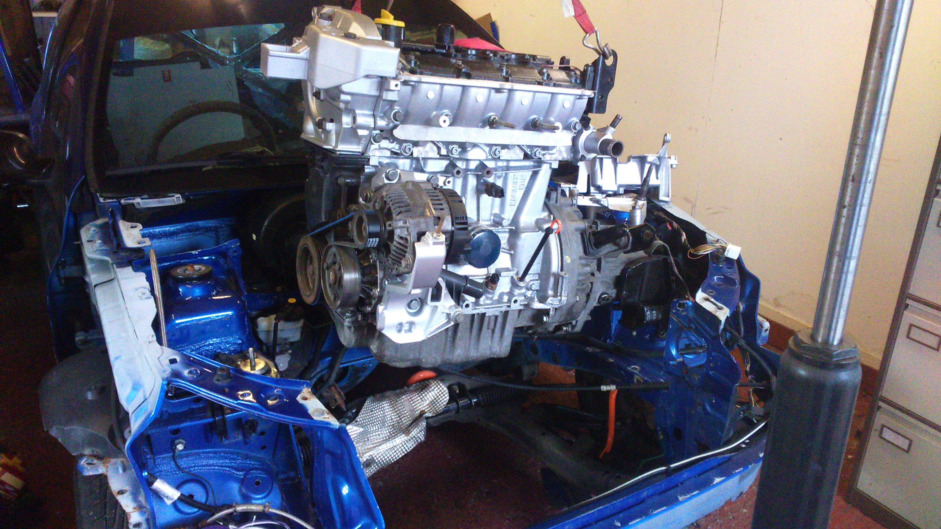

Had a sort out of a load of stuff and tidied up my garage so I can assemble some more bits in there and store my seats etc safely.
Also moved the engine and gearbox to the car so once I have swopped the pedal box to the one with cable throttle and fitted the new braided line from the m/c to the bulkhead I can finally get the engine in.

Had a couple of hours in the garage earlier and got a few jobs done.

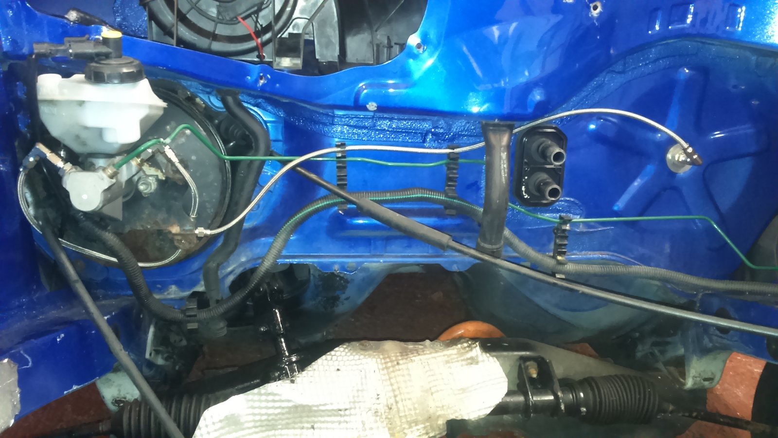

Did the rear brake lines from the master cylinder to the bulkhead fitting and fitted the throttle cable as it's a lot easier to do before fitting the engine
Then I have dropped the engine and gearbox back in as my brother needs the engine crane tomorrow
Getting there slowly!

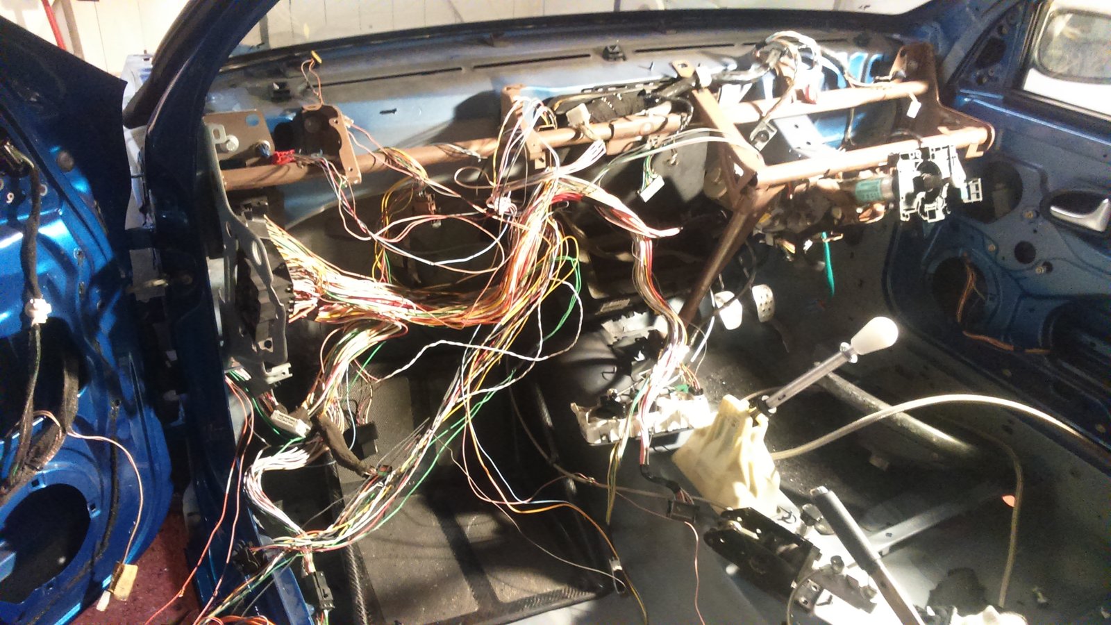

Had a few hours in the garage again today.
Engine wiring loom pretty much all in, exhaust manifold bolted up and alloy rad and slam panel trial fitted

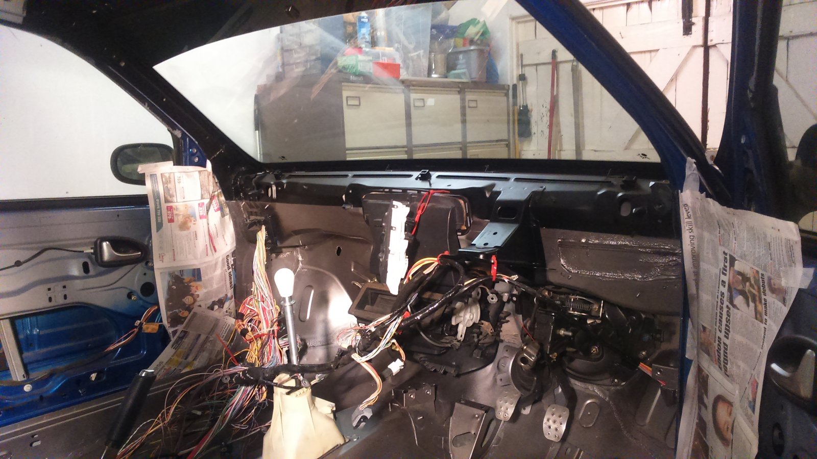

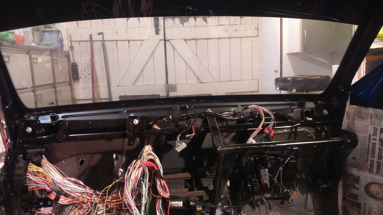

I then moved inside to see about trying to get rid of the airbag wiring crap.
That's not a lot of fun and any advice welcome!!
Getting there slowly!!!

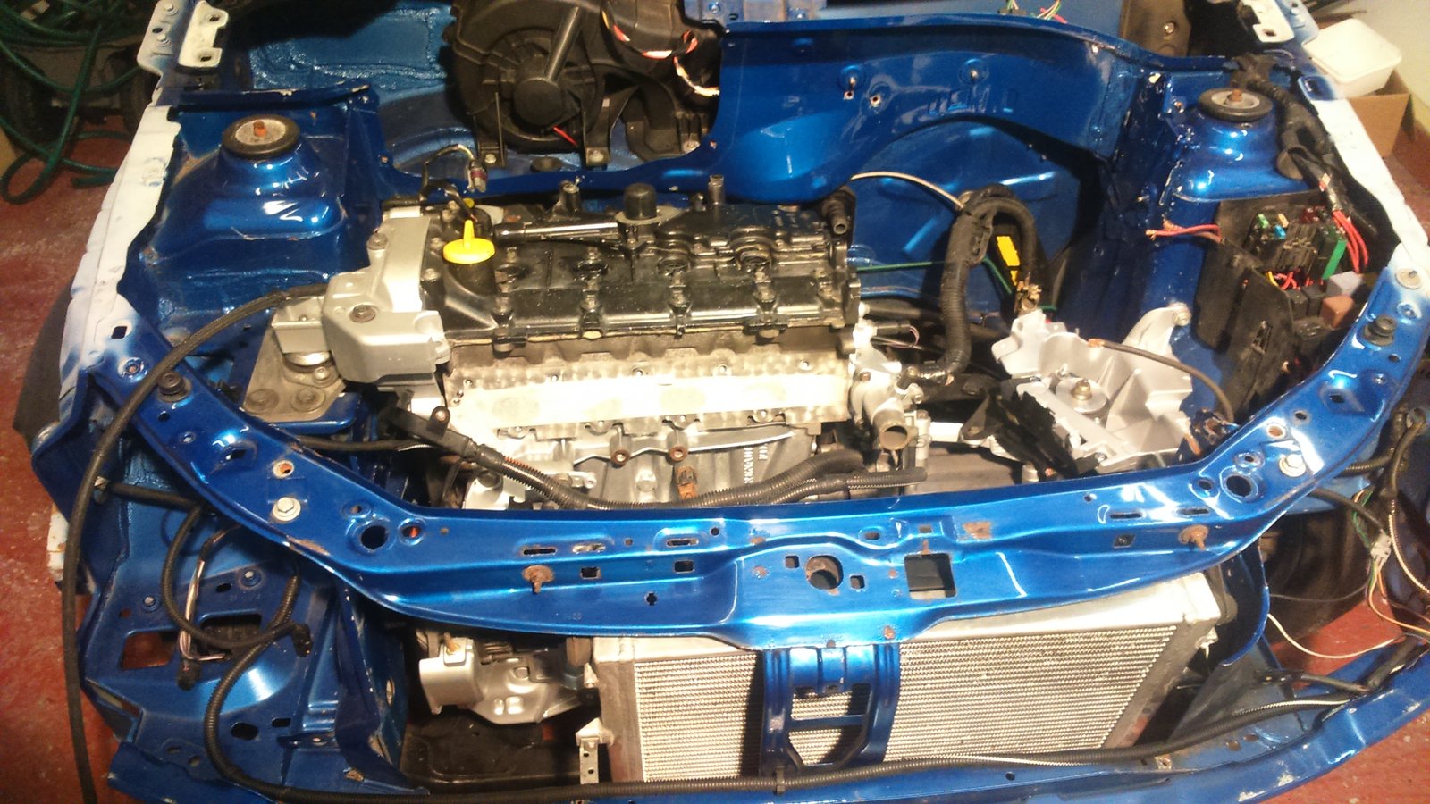

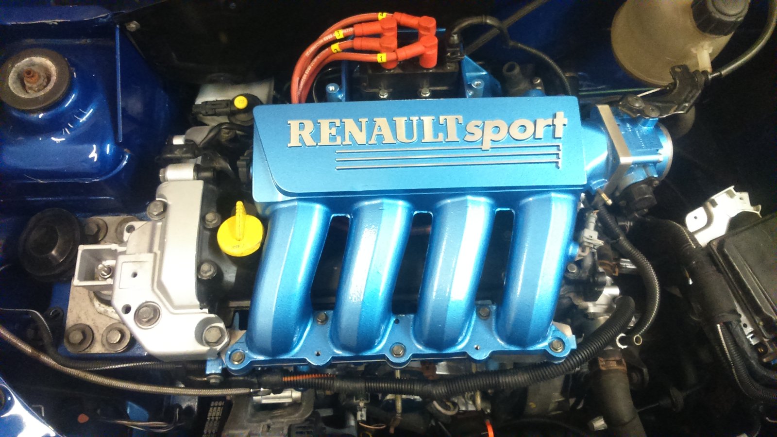

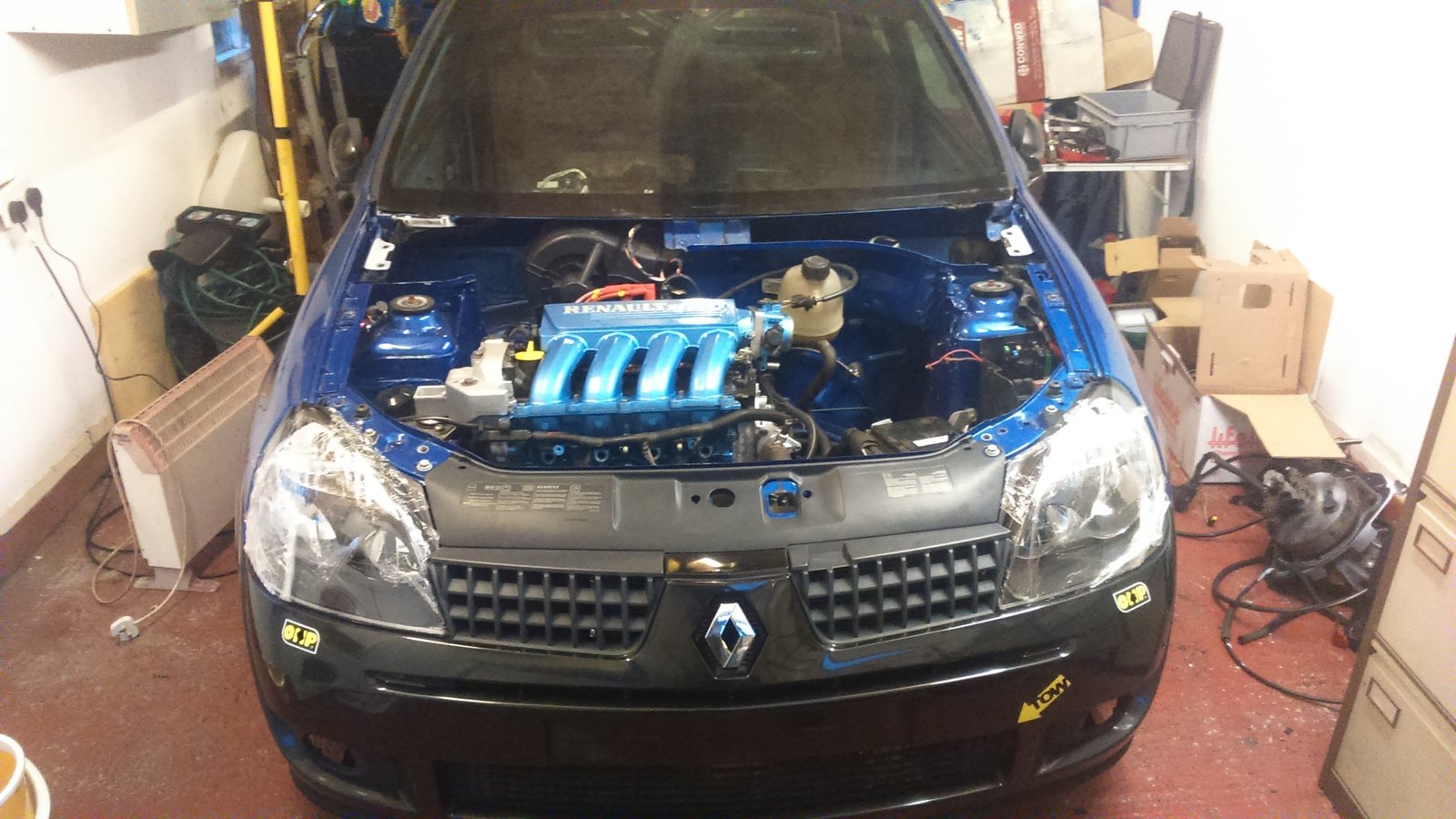

Been at it again today, alloy radiator, slam panel, lights, bumper and wings on now.
Plugs, coil pack and leads on.
New ph1 upper and lower inlet and throttle body now fitted, just need to work out the wiring. Just working out the positions for the extinguisher nozzles and fuel line route.

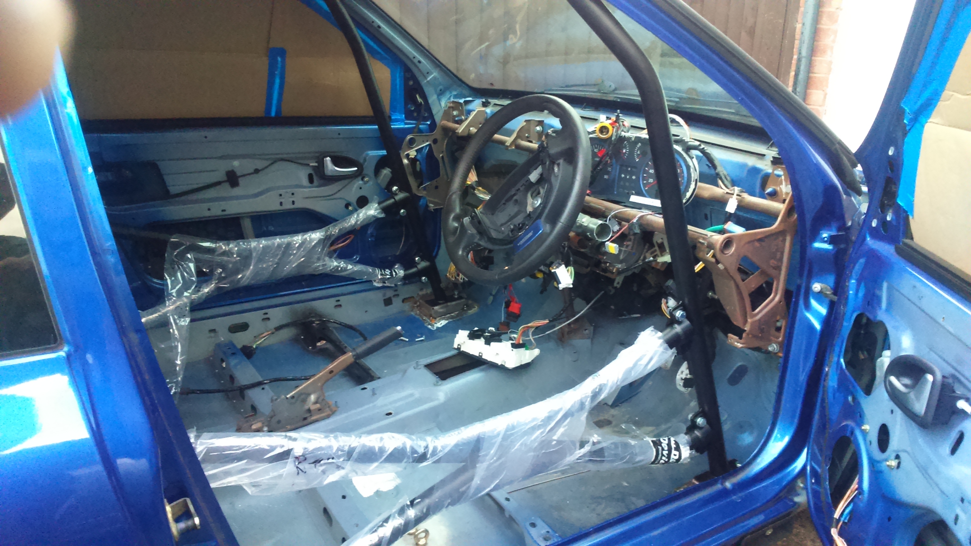

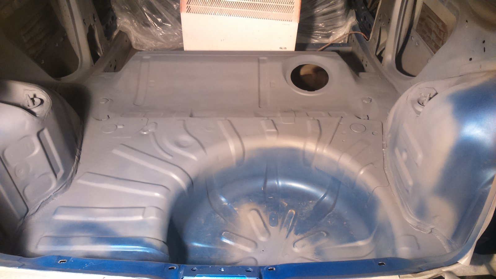

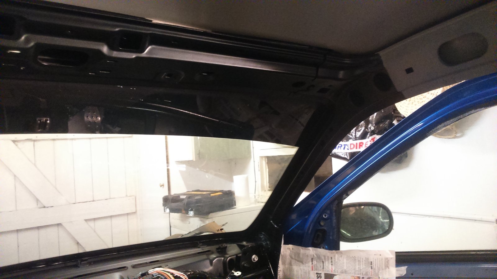

Spent the afternoon spraying a bit of the inside today so I can get the dash back in.
I have sprayed the metal dash bar thingy gloss black, the front pillars, front edge of the roof and upper front bulkhead in satin black, and the front footwells are now anthracite (the rest of the interior will eventually be anthracite too)
Pics are a bit crap. Sorry.

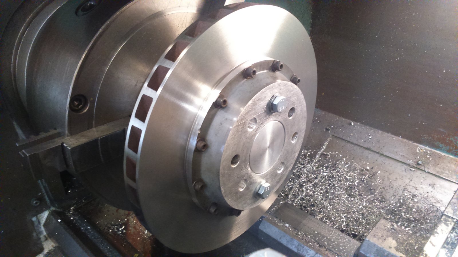

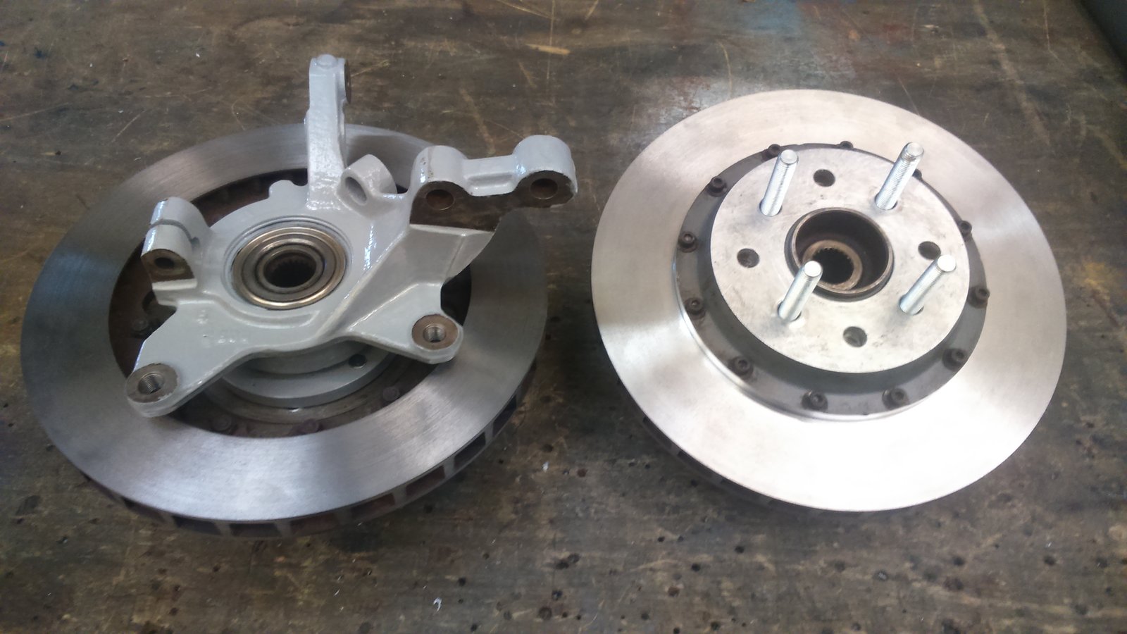

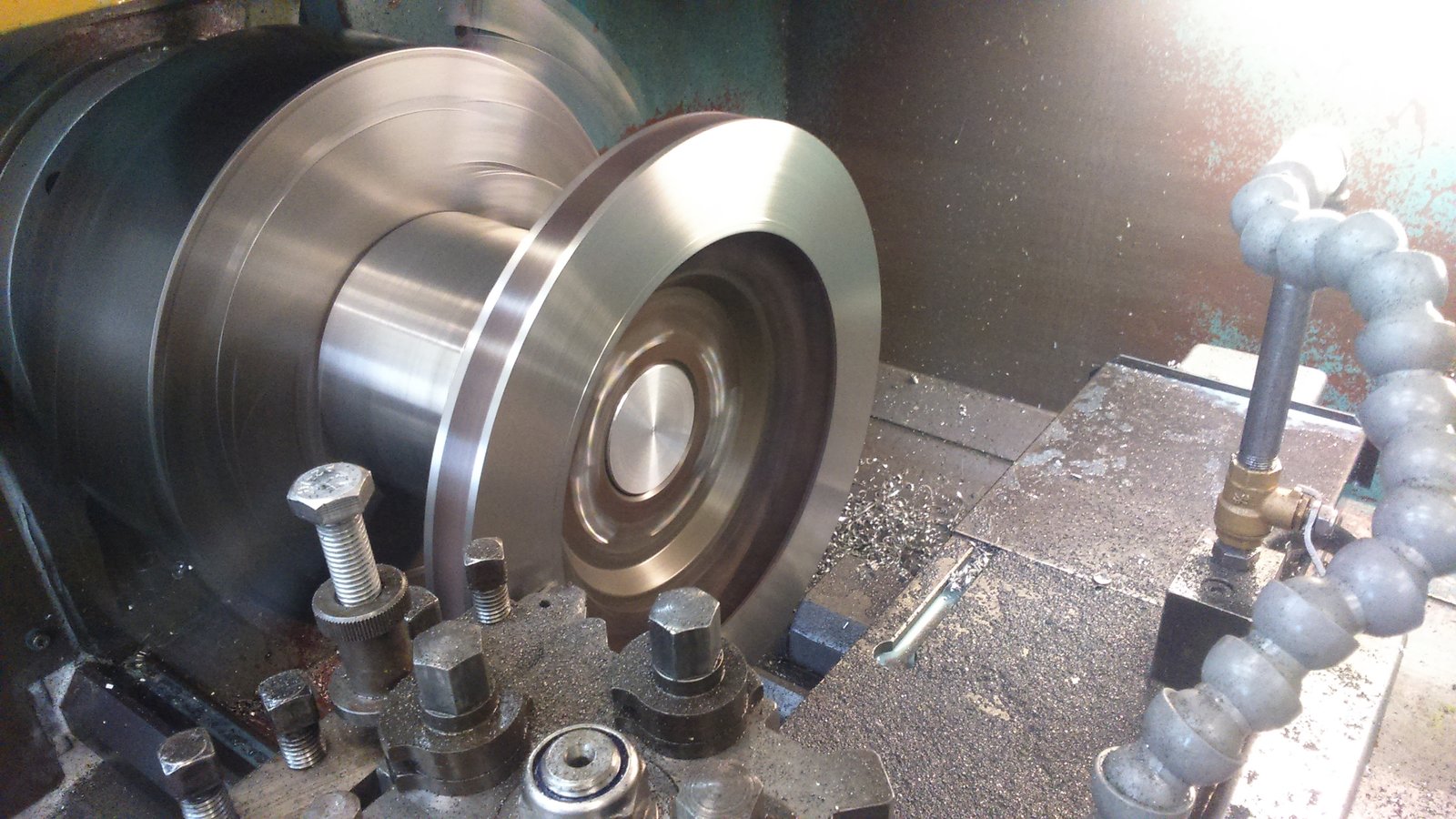

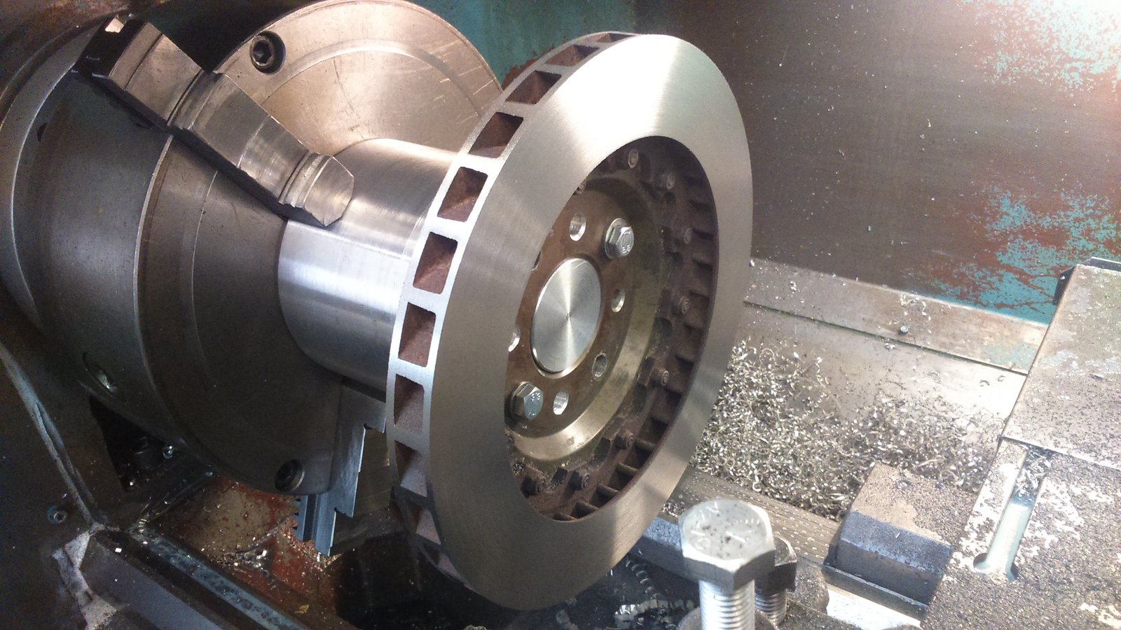

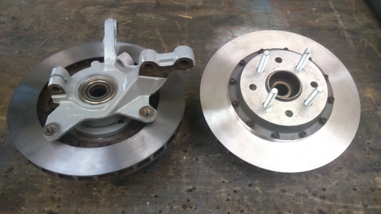

Having to work all weekend so not getting to the garage to work on the car but I have managed to skim my rotors in my dinner hour. Will hopefully do my spigot rings, sort the hubs and fit the longer studs tomorrow.
Can't rebuild my AP calipers yet as I'm still waiting for the correct size seals and link pipe from AP.

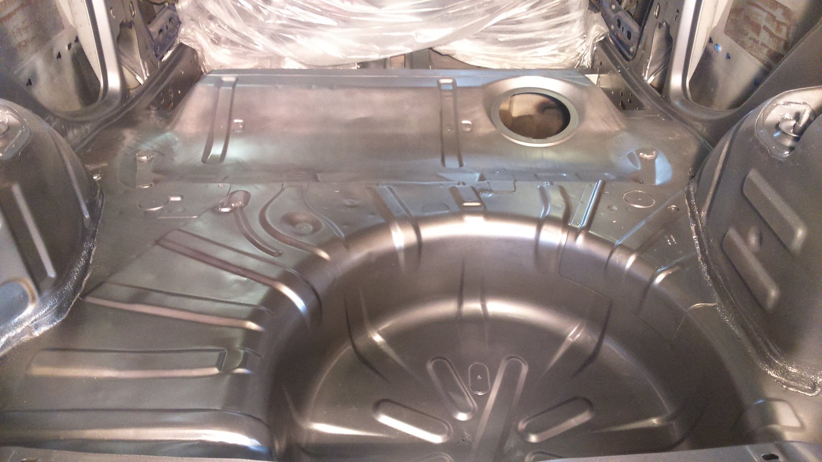

Finally managed to get the rest of the interior painted, should have finished it yesterday but ran out of paint. Not a perfect job but looks a lot better than blue and primer.
Before
After

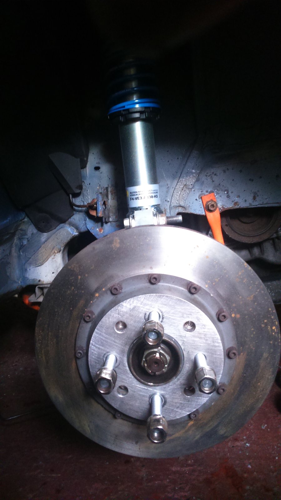

Whilst that was drying I fitted the driveshafts, hubs and new bilstein suspension.
Still no brakes though as I am still waiting for new seal kits and link pipe from AP.

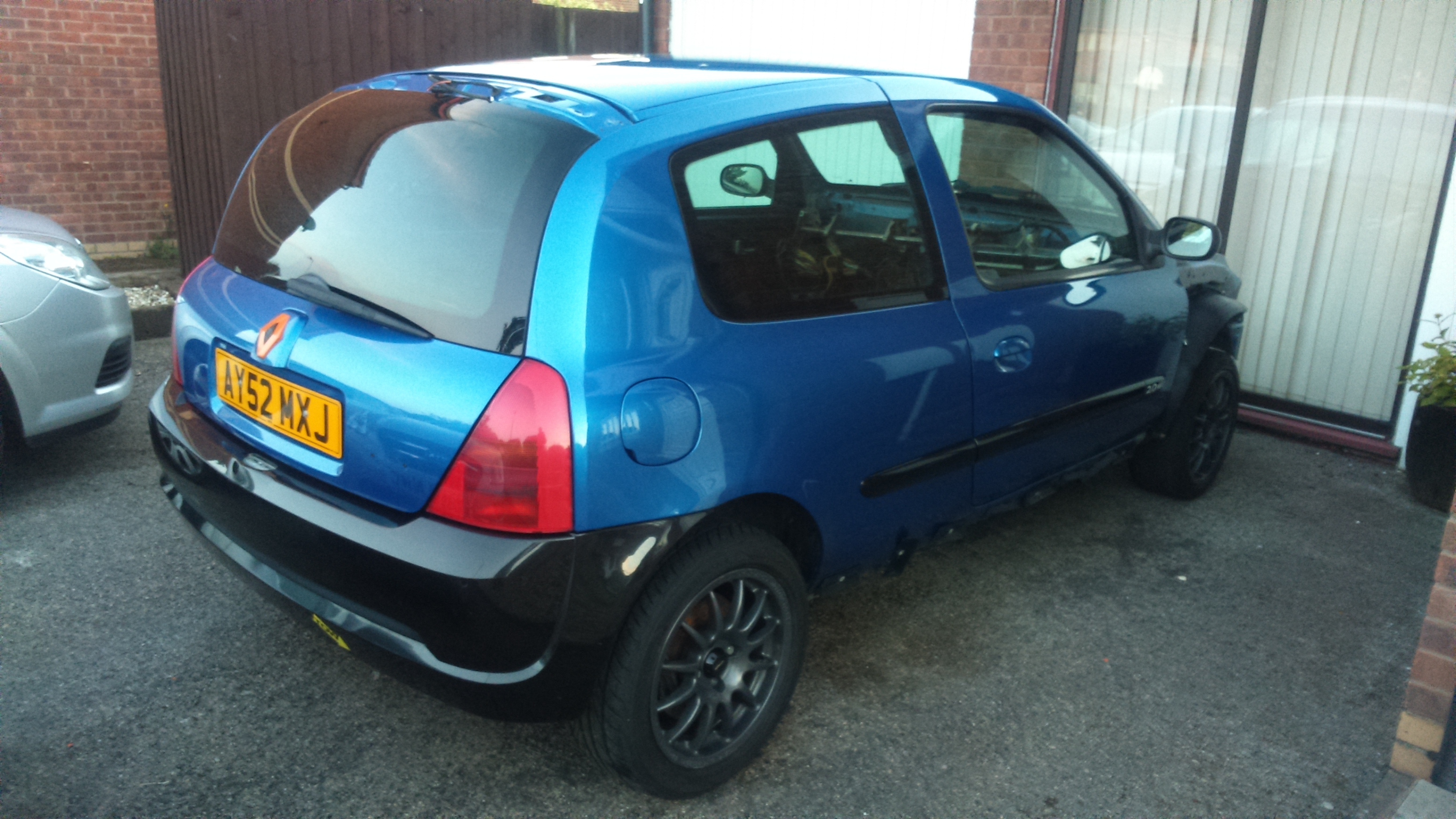

Rear bilsteins are fitted, as are the rear lights, boot catch, boot seal, black spoiler (not a cup one but doubt I will ever notice any difference). Positioned the wiring to the rear lights, just need to sort some clips or something. Started to position and mount the hydraulic handbrake so tweaked that a bit then gave it a lick of paint as well as the handbrake. Hopefully get back in there again tomorrow.
Also tried to put the window film on the rear windows but it was a nightmare and I saw my arse and ripped it off.
Anyone near Wrexham good at fitting msa window film??!!!
