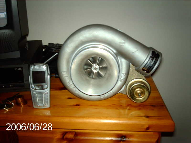

With regards to Turbo's for the 172 engine what does everyone go for T25 / T28 or should I be looking @ T3's??

looks a lovely car. The manifolds available for the 172 engine use a t2 flange so a t28 is your best option IMO. They work really well. That's going to be an animal with 260+bhp

With regards to T25 / T28 Turbo's looks like I will be trying to ge hold of some cossie turbo where can you get hold of turbo ex manifolds for the 172 engine??

As Danny says most of the manifolds available off the shelf have a T2 flange so the biggest you can hope for would be a Big T28, Nissan Pulsar type which IMO would be too small.
Best bet is to use a T3 sized flange then you will have a future proof yourself as you'll want to upgrade.
  ITB'd MK1
heard of a GT2876 ?
