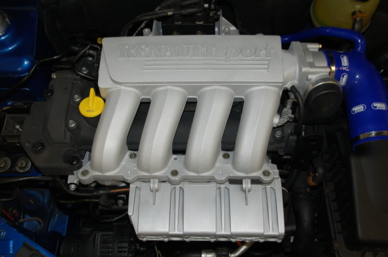

stock airbox on this old girl
and she still did 192.8bhp and 160lbs/ft (428's)
Had a Viper(closed induction kit) on mine for a short while and the car felt strangled and restricted, reverted back to the standard airbox with an ITG panel filter and it felt alot better. Ph-1 airbox with an ITG panel filter seems to be a popular choice.
