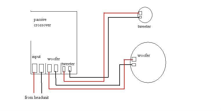

Currently wiring JBL components into car, however after a good search on here, cant find what I'm looking for.
I know it's possible to splice into the current wiring, however better to do my own which may end up doing back to the amp. But is it simply splicing the stock tweeter wires into new-crossover-to-new-tweeter and splice woofer wires to new woofer?
With that I cant determine how to get a current wire from the new crossover to woofer? Or am I missing something silly :dead:
Also any good places to actually mount this darn crossover?
  1.2 Dynamique billabong
i did mine a slightly different way, i left the stock tweeters in and added the new tweeters to the door card. remove the original woofer and cut off the connector and extend this cable and have it going into the main input of the crossover then run cables out of the crossover back to the woofer and the tweeter. i managed to find a space on the back of the door card to accomidate the crossover
  Mk2 172
Yep best way. Just disconnect dash tweeters.

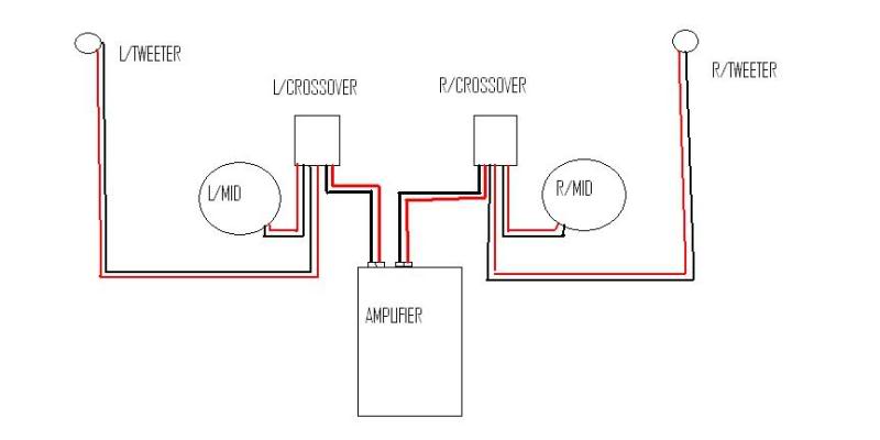

You can either splice into the original loom inside the car just before it goes through into the door itself or if you wish to preserve your cars loom you can actually wire the amplifier speaker feeds right back to the head unit and connect to original loom using an ISO speaker block purchased from Halfords....
