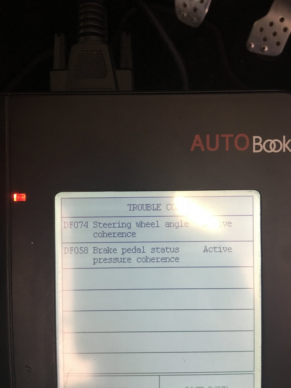

So managed to get to a mechanic, this is what came out.

Mine are so bad I can't even have the windows down cause they hurt my ears? Are yours that bad? Also any idea what those error codes refer to?
Seems its your steering angle sensor behind your steering wheel and brake pedal sensor which activates the brake lights. Search for them both on here mate
