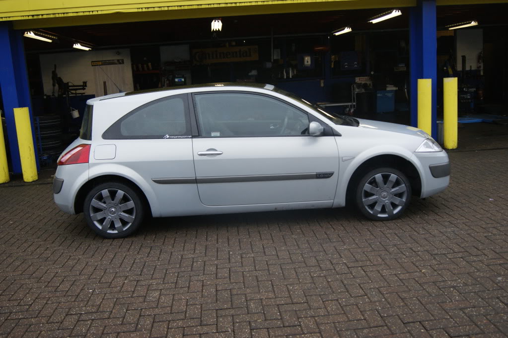

Also be aware that 182 wheels may end up looking like this...
