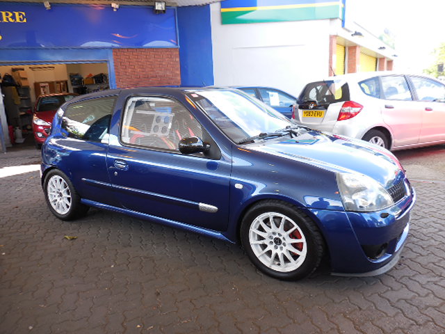

I have and if I had another I wouldn't do it again. I say again but the car came with them. Me personally would just have standard Windows. Oh and I also wouldn't remove the heating If that was another consideration?. Pic below is a quick one i found mate. The tape is holding the window up due to it popping out doing speed at Oulton lol

Looks smart with the 4 holes what's it like for getting air into the car would it keep you cool on a warmish day ?
Haha the joys of track days :)
imprezaworks
  Mk5 Golf GTI :)
Nope imo, was an arse tbh. I'm sure others say they are great but it was like a green house in the summer. They look good but for me that's where the story ends. Oh and for security I reckon my cat who never goes outside would be able to break in.

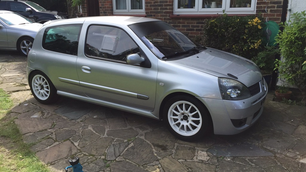

I have them on mine. I also have this air scoop on them. So get plenty of air into the car, it properly sucks it in.
But the main reason I have these is for security. It means no one can open the slider or put their hands in.

Are these lockable ones ?
Where did you buy them from mate ?
