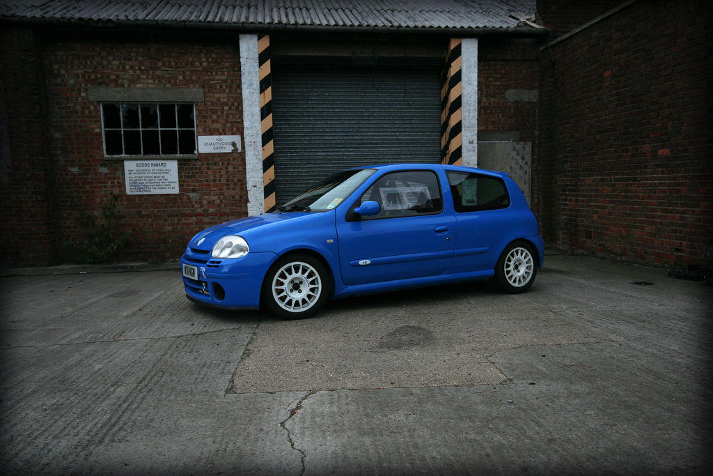

me and bazzon use a Ph1 172 on track.
get a ph1 rather than a ph2. Cable throttle is so much better and with the prices of ph1's currently there is only one choice.
Ours is great on the track, keeps up fine with most and on the corners its nimble. Only thing we found was that there was plenty of bodyroll which upset of balance of the car. We have since upgraded to coilovers but yet to test them.

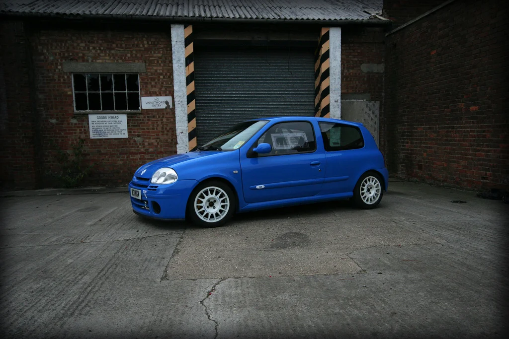

that is a verynice looking 172 that. the only reason i was thinking of ph2 is its abit newer for everyday use aswell as track. you do many track days or wer do you go as i see your not that far from me? + im trying to convice a freind of mine to get 1 aswell.

ph1 is the only way to go. We have done 2 since summer, both being at croft. Was supposed to do mallory in nov but that got cancelled. Its currently parked in our garage as were doing some work to it but once its out (hopefully next week) you can have a look at it if you want :)

cool. croft is were i was wanting to go as i must admit it will be my 1st track day car. is your 172 kept road legal or is it purley track use? what work have you done to improve as what id be thinking to my future is just coilovers & decent tyres tbh

Engine
Cat Cams
Matched Inlets
SS exhaust
Decat
Custom Remap (RStuning)
Battery in the boot so induction kit relocated behind headlight.
Brakes + suspension + wheels
AST Fully adjustable coilovers
Solid strut tops
Ferodo DS2500 pads
Brembo HC discs
Braided lines
Magnesium Speedline Corse
Yokohama parada spec 2's
Other
Racing blue body
Polycarb windows (3mm thick)
Cup spec alternator i.e removed aircon.
Rear Cage
Fully stripped (proven 920kg)
Battery in boot
Kill switch + isolator
Aluminium Doorcards
Aluminium Footrest
Cup spoiler
Tow eyes
PH2 Rear bumper + lights
Recondition Gearbox + strengthen bearings
Uprated Clutch
Corbeau Bucket seats
Sabelt 3 point harness
RenaultSport Sabelt Cup Racer steering wheel
as bazzon said, its fully road legal
