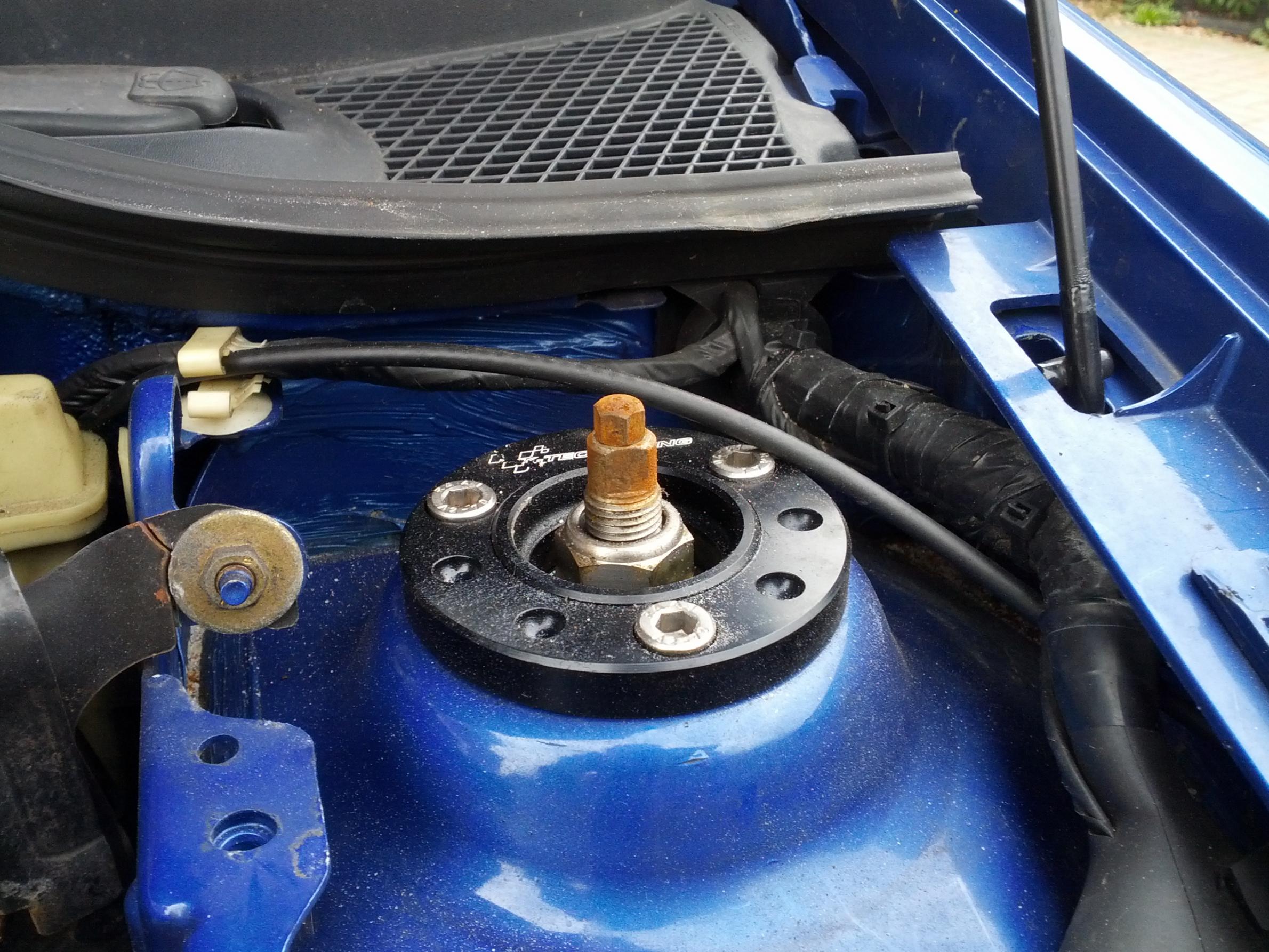

Then I guess mine aren't GHA's then? My GAZ have both the heigh adjustable and the dampening. Dampening is done via an 8mm spanner on the top of the suspension struts. Will get a pic if you're interested

See pic below, bit of surface rust but the top most part of the strut is for dampening adjustments. I was under the impression these were GHA's, maybe I'm mistaken. They are definitely GAZ though.

Arse. Mine are fixed rate with just a small allen screw in the top of the rod and look different to that pic. Gaz say fixed trackday ones were available. Spoke to them again today, a bit more helpfull this time, they suggested maybe trying stiffer rear springs, something like 750 lb instead of the 350 or so I maybe have now. 750 seems pretty stiff! I do drive to the trackdays!
