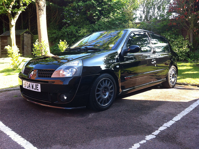

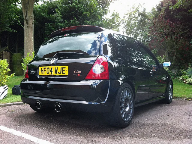

I had 2118s (et43) on my old BG with 5mm spacers (M.A.D ones) and they looked fine. Ill see if i can find pics to show how they sit in the arches.

These are the best pics i could find at an angle to show how wide they sit out on et43 and 5mm spacers.
