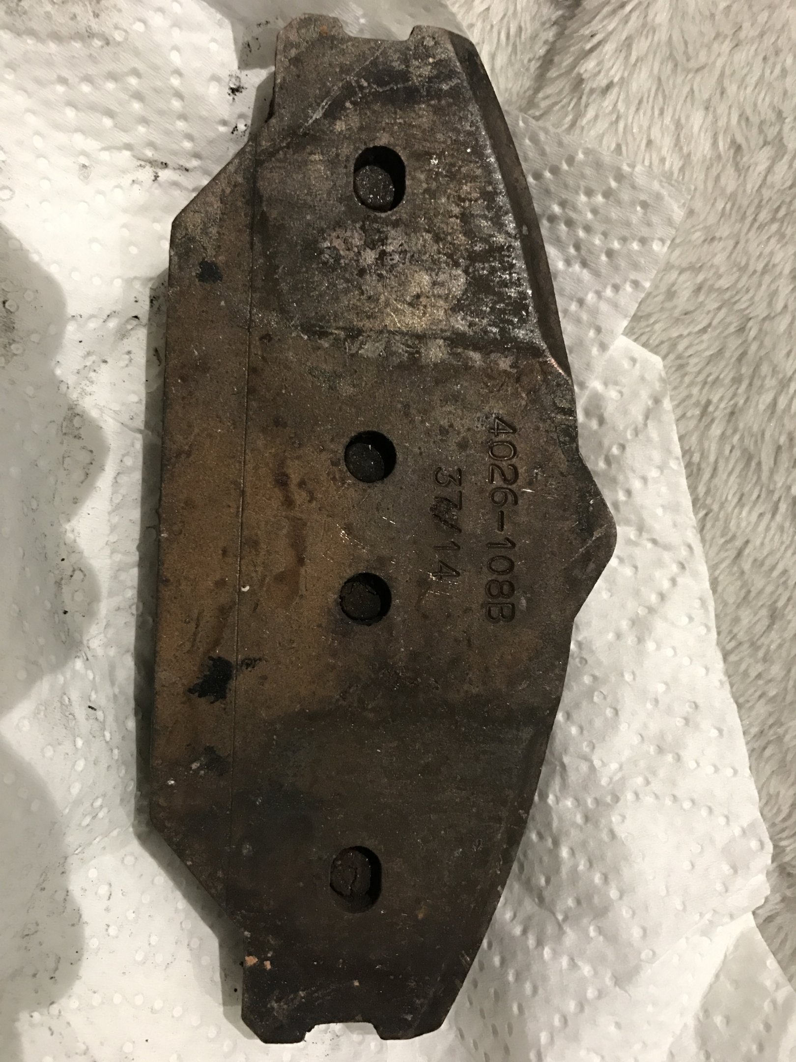

What pads are these?
Anyone have an idea as to what make these pads could be?

Yeah had them mate, also got CL5 which are 105a if i remember correctly.
The 4026 is Clio sport and Pug 306 Gti6 fitment and the 8 is the compound, and think the 'a' is road legal and 'b' race so not road legal.
Also i found them way to aggressive even with hot track rubber.
Shite, way to aggressive as they lock up far to easily. Ferodo DS1.11 is by far the best pad I've tried in every way, really strong but linear coefficient, last ages, kind on discs, low dust etc.
Yea there the ones I was looking to get but had these sitting here so wanted to know if there worth putting in, think I will try and sell them and go for the ds 1.11, heard good things about them from various people

And @bob the builder rated them a lot.
I just think the rc8s will be poor on 1*2s with ABS. Bob the builder will no doubt have no ABS and probably a bias valve with more going to the rear so will make them less grabby at the front.
