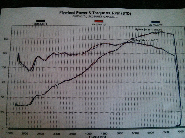

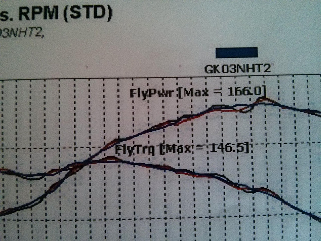

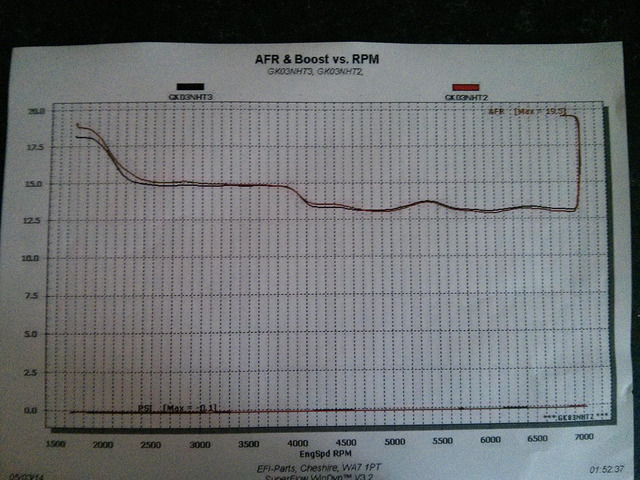

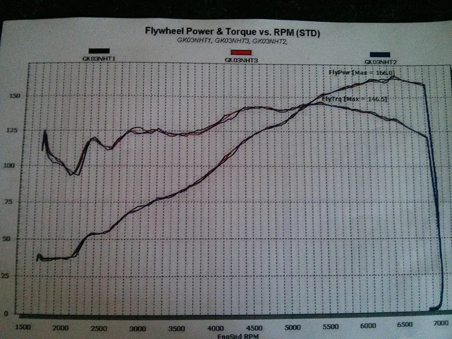

So...EFI. When I got the car I did all the belts myself as they were nearly due and the receipt for the last time was a little dubious so even though I checked the timing and retimed it etc there was still a little bit of doubt being the first one I've done.
Jonff told me last week or earlier this week (can't remember which) that he was heading to EFI today to do a rolling road run since he'd plumbed the boost solenoid back in and asked if I was going to pop along. Saw this as a perfect opportunity to see how healthy my engine was and put my mind at ease that the timing was all spot on.
And the results:
172 Rolling Road Results by welshname, on Flickr
172 Rolling Road Graph by welshname, on Flickr
172 AFR graph by welshname, on Flickr
Very happy. Nice healthy engine and not a bad figure for a basically standard car (has the K-Tec Stealth but still retains the standard cat.)

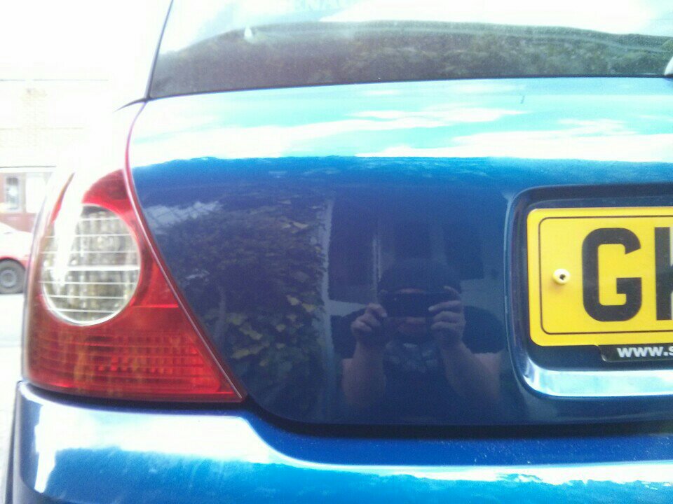

Spent the afternoon cleaning the car today. Just gave it a quick wash as I did the whole decon etc a week ago. @Eddie. leant me his Zymol Glasur to give the clio a go with. You need virtually nothing to apply to the car and it smells incredible, I was told it has a habit of gassing after it's been left for a while but I finished the car at about 2:30 and it's still looking good now so touch wood all is well.
Got back from the pub a few minutes ago and thought I'd get some pictures. 2 out of 9 of them are even remotely worth looking at and overprocessed to hell. I'll get some sober eventually!
Monaco Reflection by welshname, on Flickr
Cleaned Monaco by welshname, on Flickr

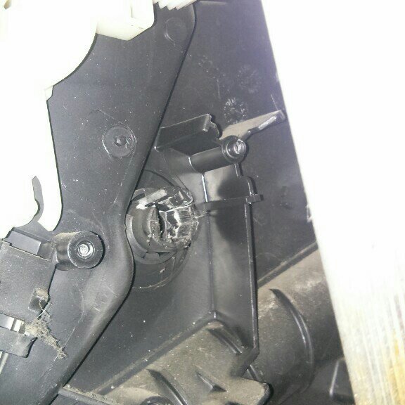

So my aircon has been a bit faulty recently. When it worked it was ice cold so I knew it wasn't the aircon itself. Basically if it was working it would continue to work until you turned the temp up. Then it would not come back down again.
My initial idea was heater control valve sticking open but it looks like they don't have one. Had a search on here and saw scary prices being quoted for repair (around £6-700). Then I stumbled upon a cheap fix.
Basically instead of a valve there is a motor which rotates a flap to either pass air over the heater matrix or bypass it, the motor sits into a hole that looks like Lisa Simpsons head. Turns out the holes split open over time and splay out.
Took the gearstick surround out and removed the three bolts that motors bolt to to be greeted with this.
As you can see its pretty fucked. So I put a small cable tie around it to bring it all back together and put the whole thing back.
Now its all working and I can go from boiling hot to ice cold in seconds. Result. Only took 45 mins :)

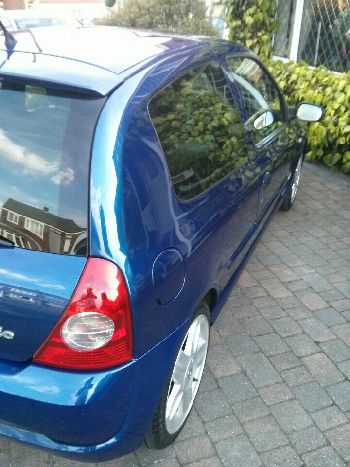

Oh and a couple of pictures from yesterday after a Z6 wipedown and a second layer of Glasur

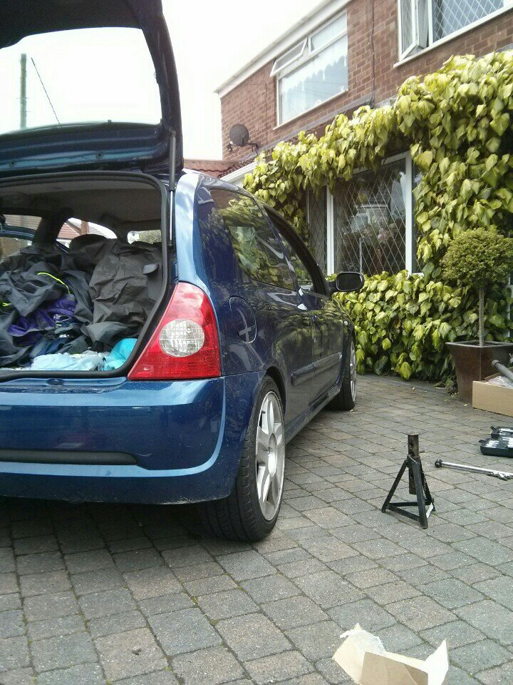

So bit of an update.

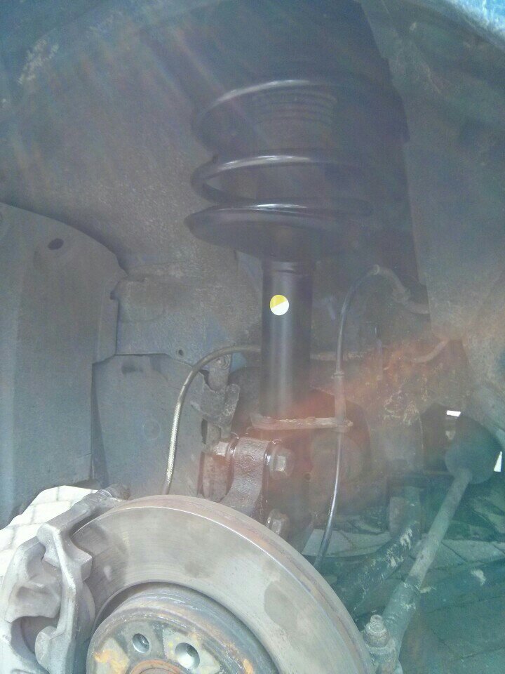

Finally managed to get my hands on a set of cooksports so I decided today to get everything fitted.

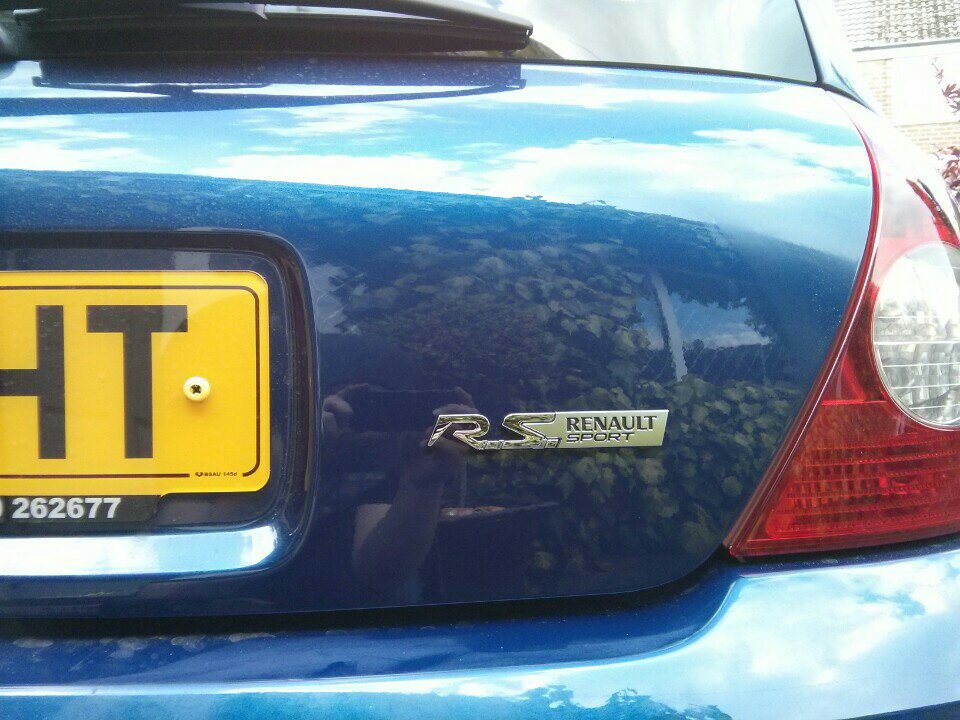

I had already fitted the 200 badge
Removed:
Cleaned up:
Fitted:
So got on with the springs, cup shocks, spacers and splitter.
Springs and shocks on:
Back on the ground with 25mm spacers:
And the rear with 15mm:
And the splitter:

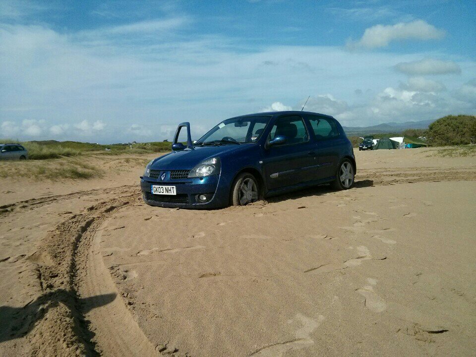

You'll have to excuse the dirt and camping stuff. I spent the weekend at shell island with some friends. I managed to get myself stuck on the beach amongst other things:
Luckily I didn't have the splitter or springs fitted!
