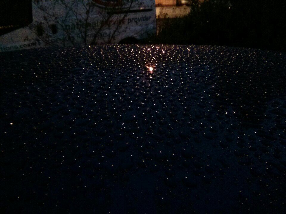

And anyone who says that sealant only sheets and doesn't bead well isn't doing it right
And that's only from a very light shower. After it's rained heavy it beads better than any wax I've used before, really tight and neat beads, the sides tend to sheet though which is fine by me.

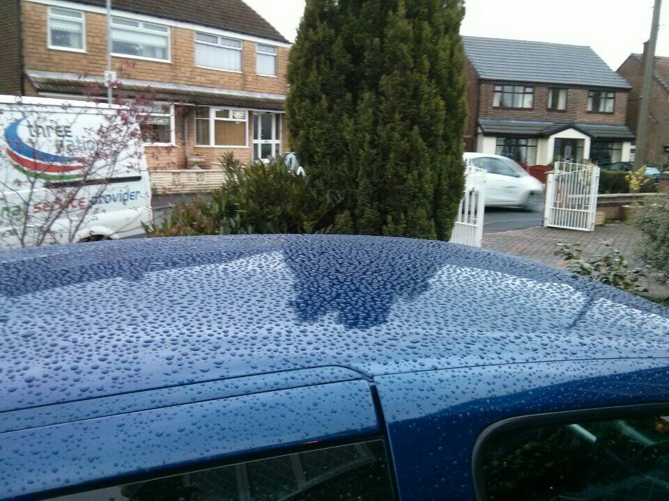

One more picture to show Werkstat Acrylic Jett at work now that it's rained properly.
That's been washed twice since applying (with washing up liquid once :/ ) and I only applied one layer. Love the stuff.
