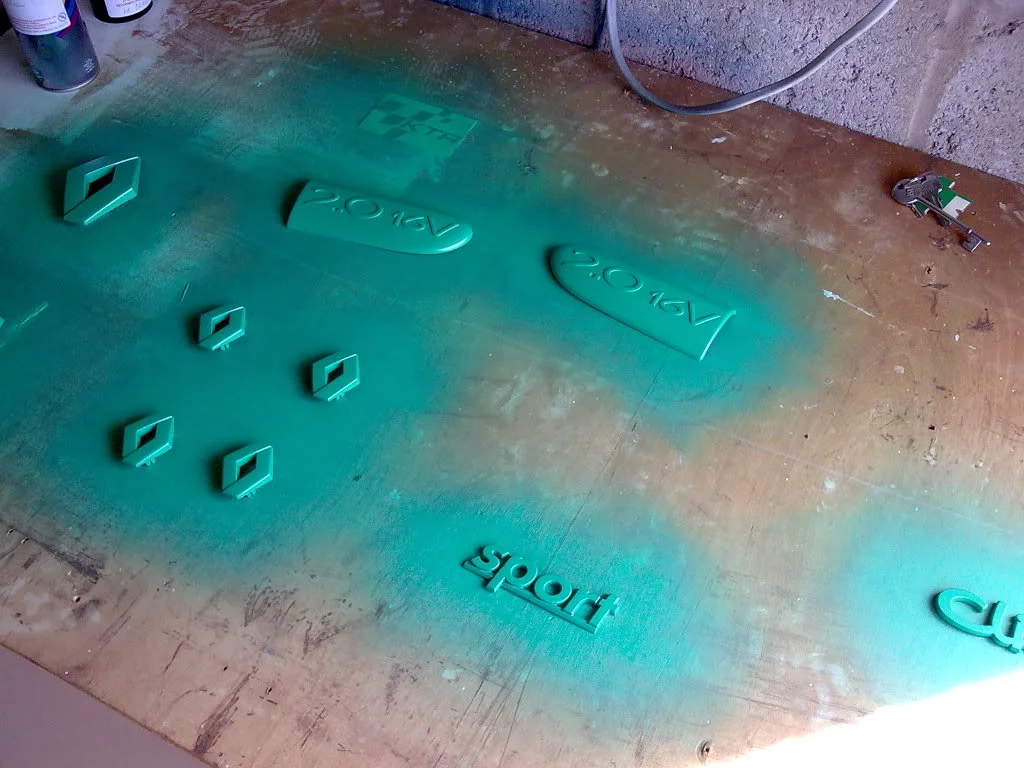

No pics as such, just a little update and I'm a grade A c**k :D. I snapped the 'RENAULT' badge when sanding off the old paint LOL. Stupid brittle crap plastic!
So, I have four choices.
1. New badge (fook that, though I love the new RS design)
2. Keep the 'SPORT' as is
3. Shift the 'SPORT' to underneith 'CLIO'
4. Just ditch both parts and only have 'CLIO'
Anyways, that's 3x coats of plastic primer done. Over night to dry, wet sand first thing tomorrow morning and on with the first coat of AG.

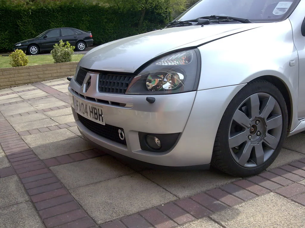

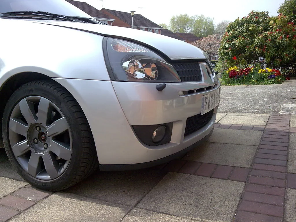

Anyways, little update, splitter fitted...

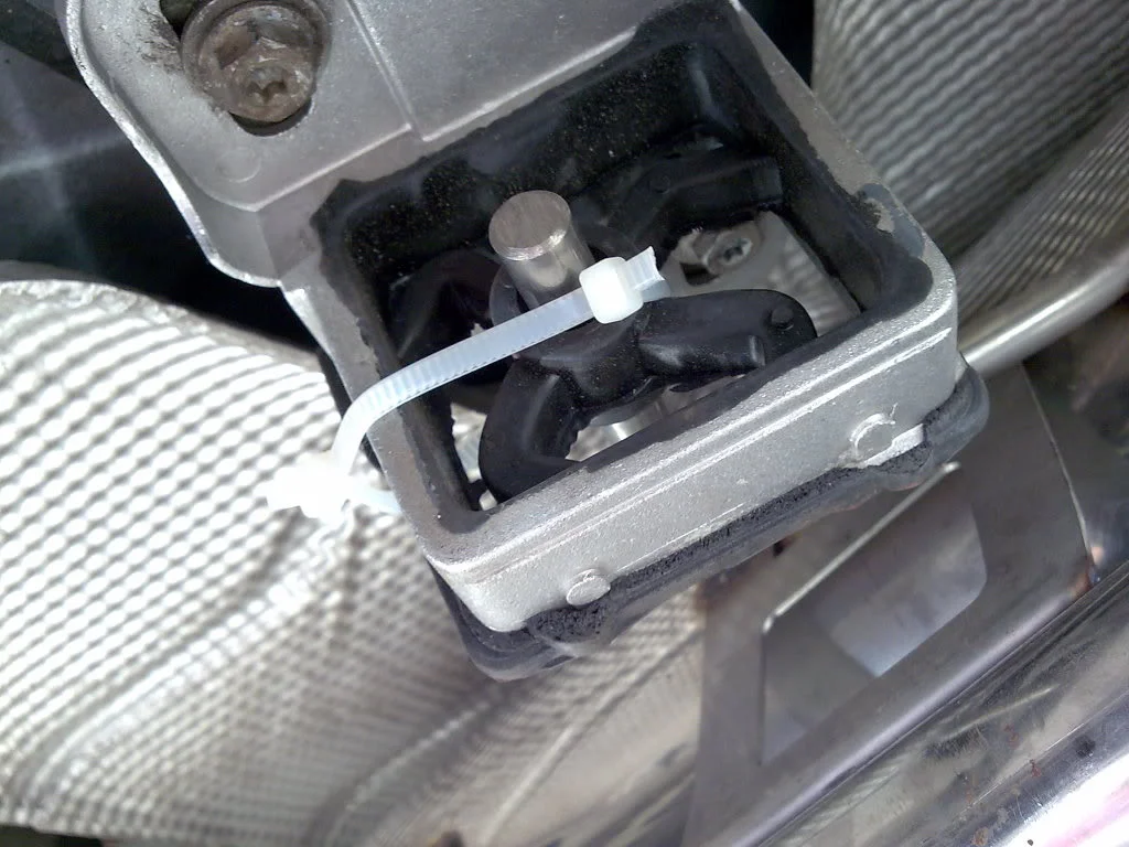

Exhuast wonk fixed, many thanks for the zip/cable tie trick...

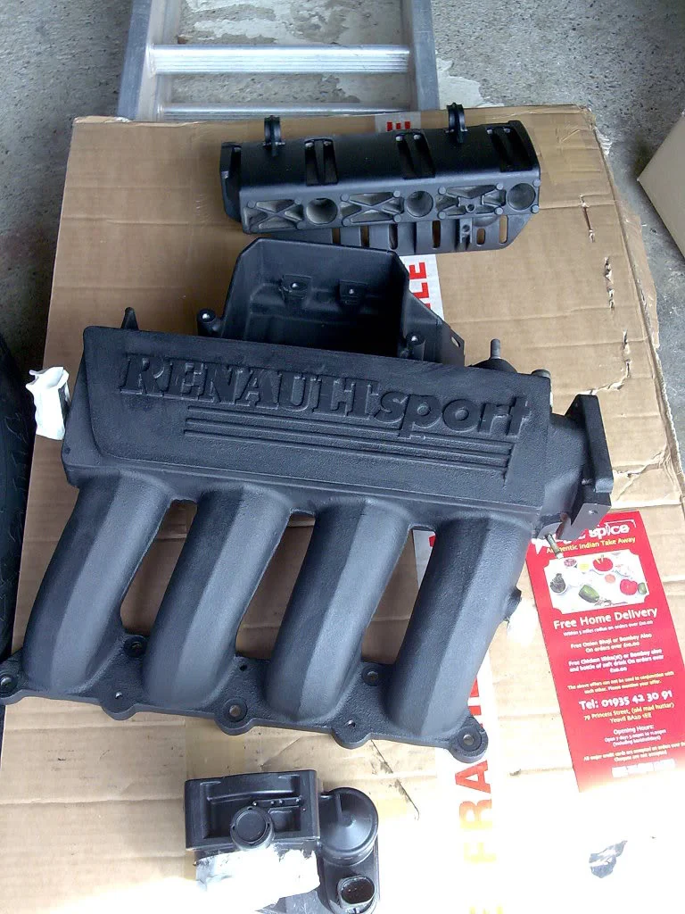

Engine bits painted, don't worry about the shoddy finish to the plenum. Only used the VHT as a 'primer'...

Yea Robbo's thread is where I yoinked the idea, but took a twist on it! I did try to bluetac out all the lettering to just spray the individual letters, but it was a right old mess!! So just sprayed the whole 'upper' upper part of the plenum. Should still look ok, but not what I wanted.

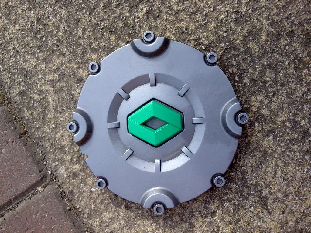

Few more teaser pics!
Plenum...
Front diamond...
Alloy centre caps...
Please excuse the roughness of the finish on the diamonds, they need to wetsanded and then lacquered. Then plenum though, that's it finished. So will be fitting that tomorrow when once the paint has fully dried.

Yep, pop the centre caps off. Then the diamonds are just held in by four 'push-clip' things. I turned a flat blade on it's side and used that to push the diamonds out.
Kinda similar to the rear boot diamond, but they aren't held in by that gluey-siliconey stuff.
