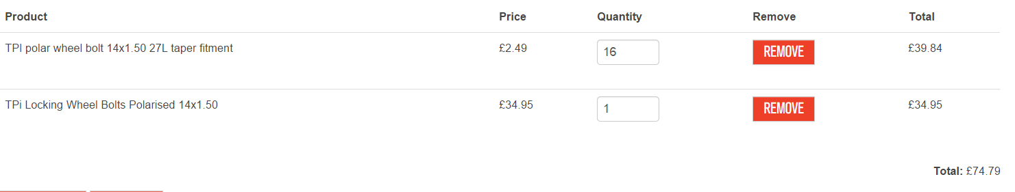

can only seem to find 17mm head, but they are 60 degree seat, and m14x1.5mm, with 27mm thread length... here
Normal Bolts
Locking Bolts ( they are 1mm longer? any reason? )
