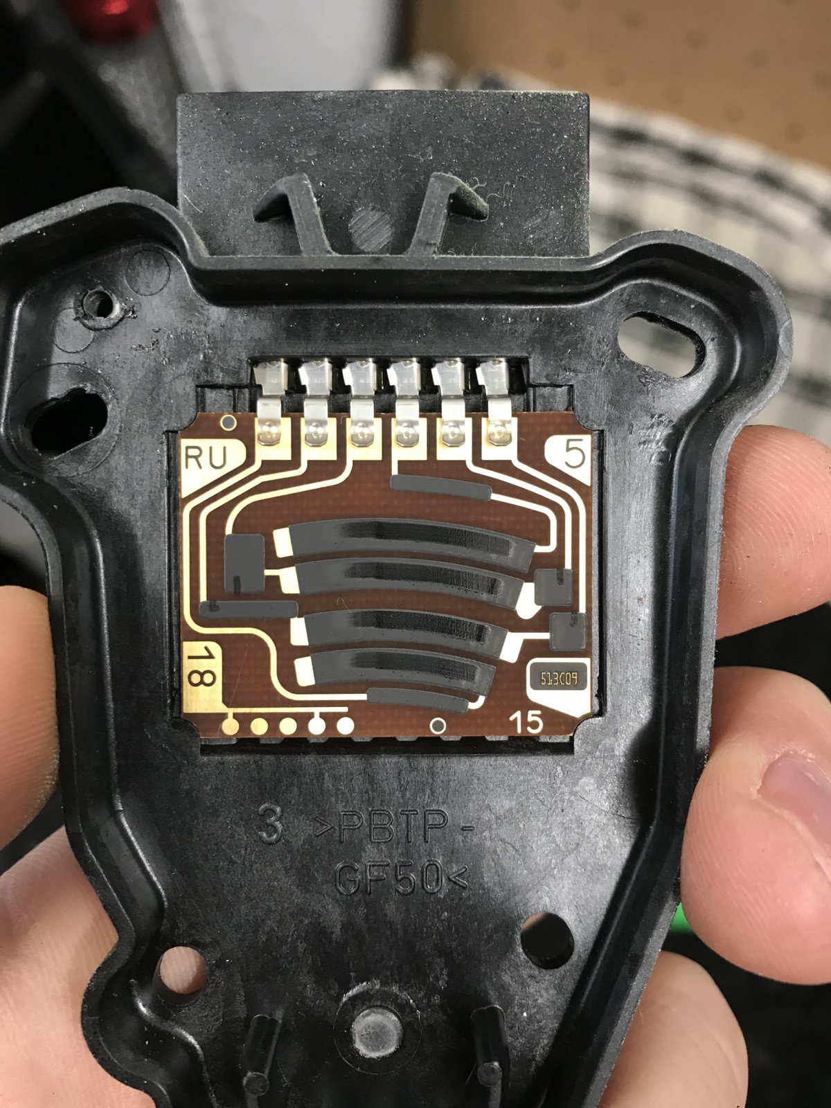

I have just adjusted the pins and there wasn't much adjusting they were pretty tight power i stripped the pedal down and this is what i have found do we think this could be the fault ? and can it be cleaned or is there nothing wrong with it ( i am not sure if it should have a larger clean span)
Many thanks
Carbon tracks could be worn doesn't look to bad in photo though
  Clio 220 PH2
roughly check where there contacts on other side would be touching it.
They may start there and only run that length

I agree you should normally see raised or even the carbon gone shown contact.
