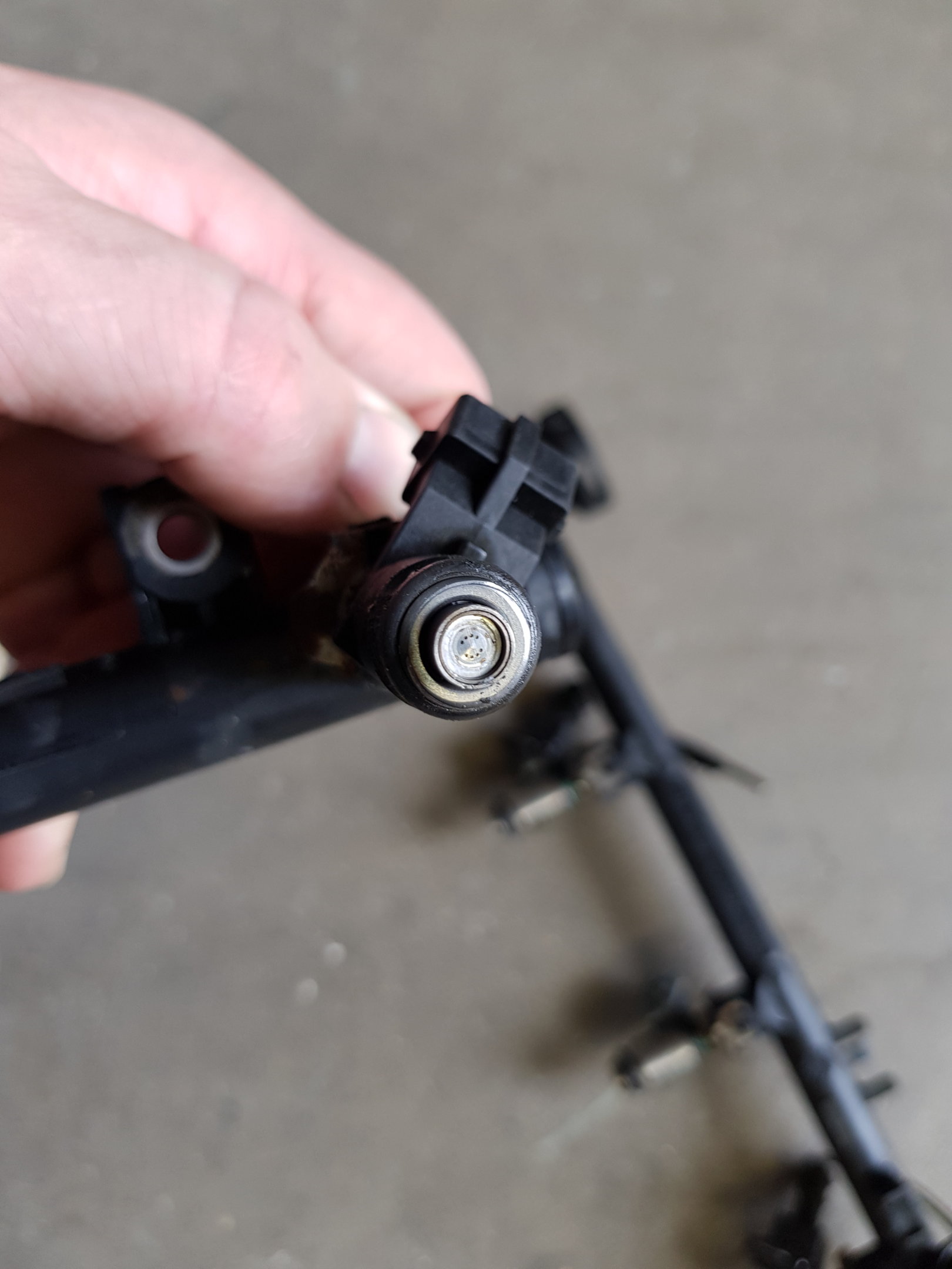

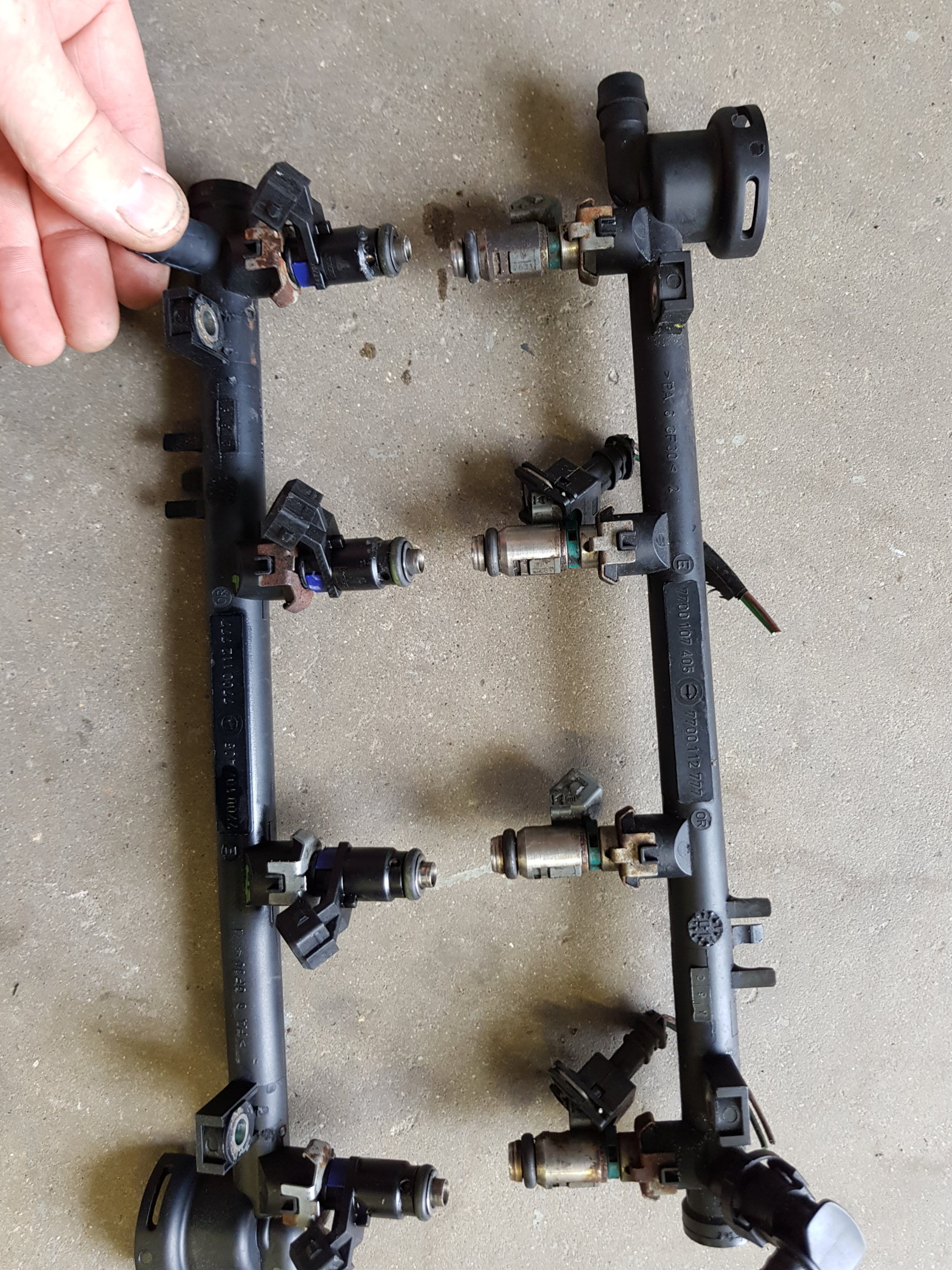

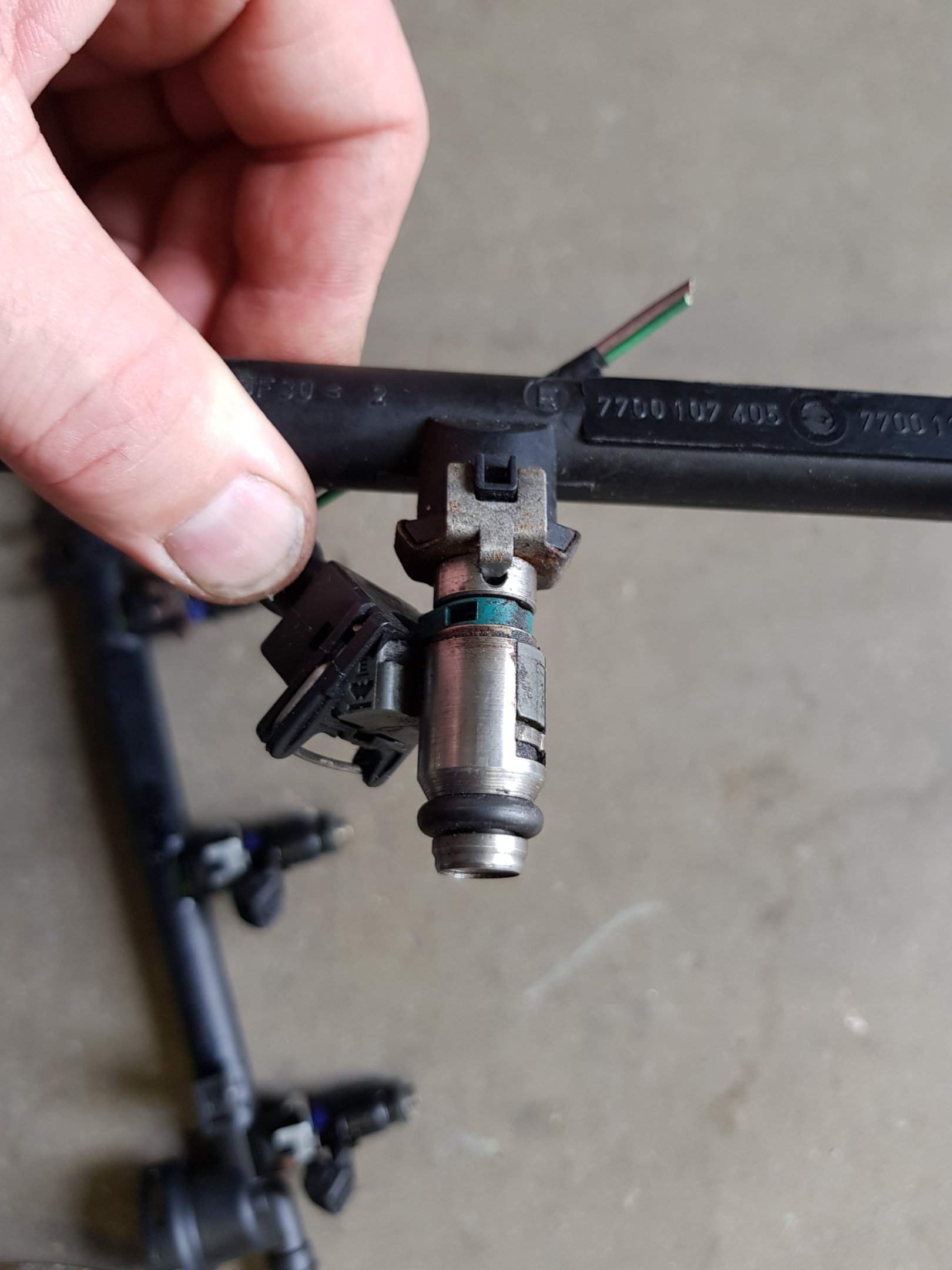

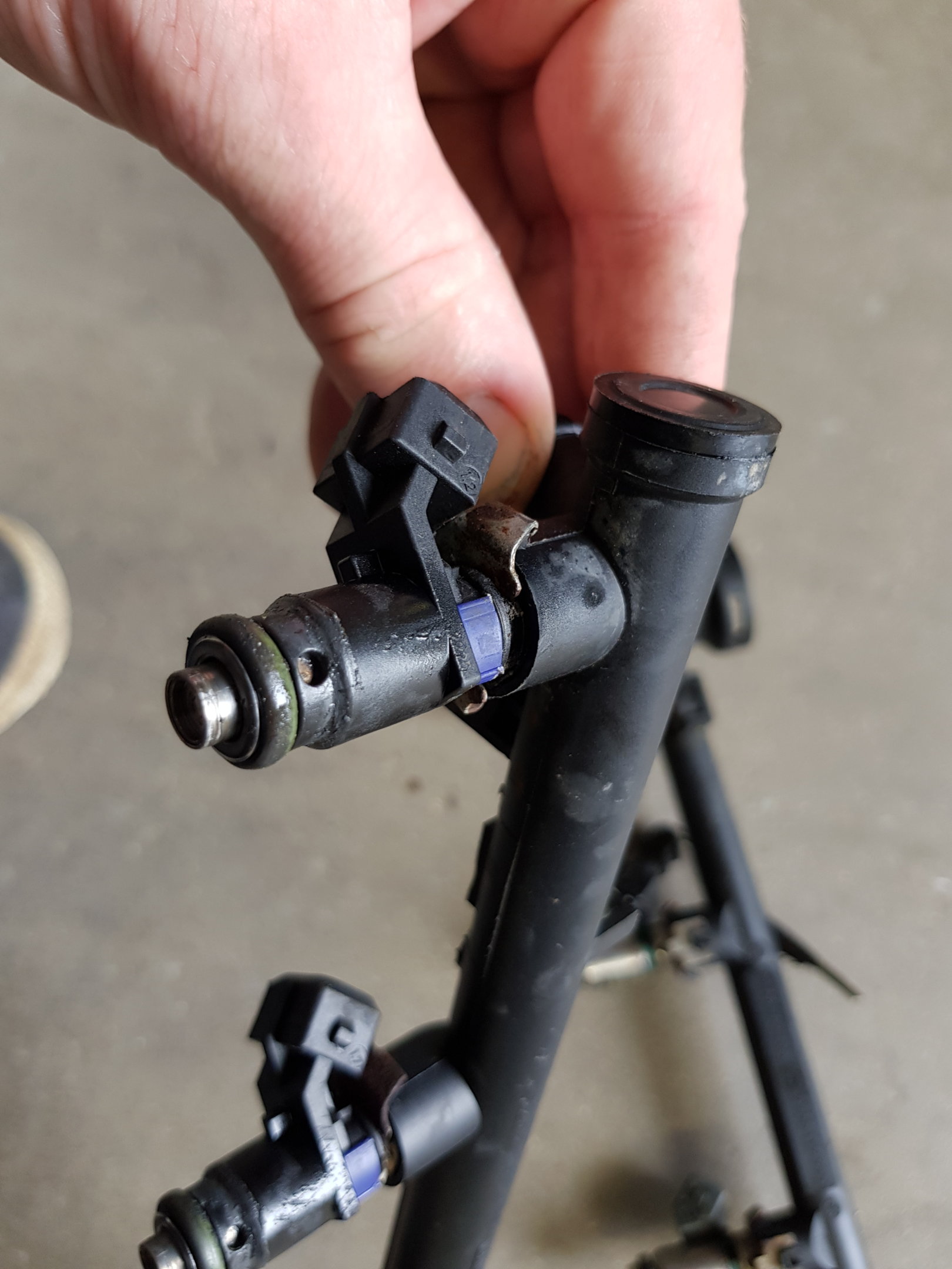

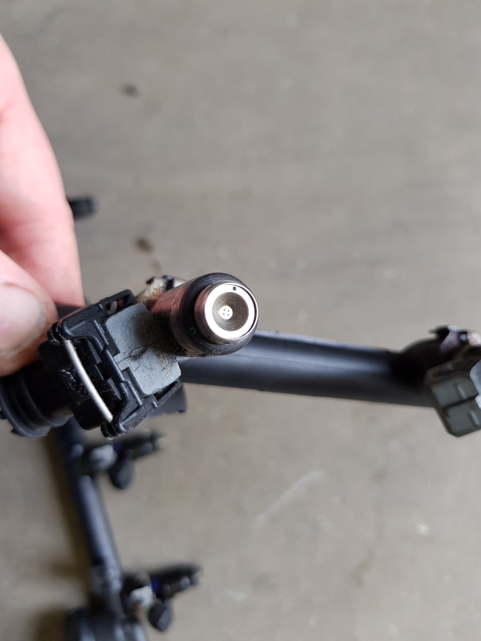

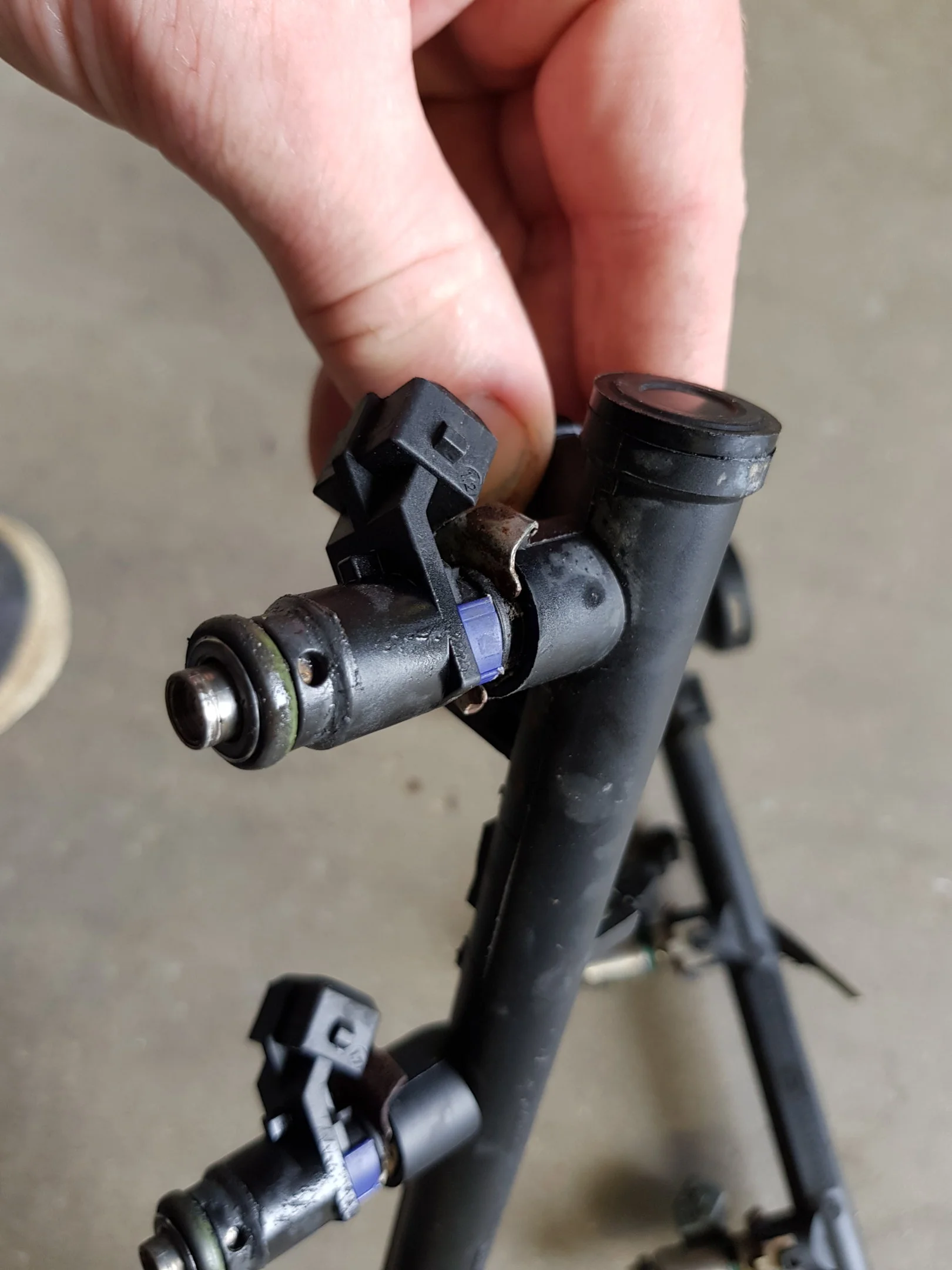

So running a bit lumpy, new plugs, coil and magnecor leads. Sounded like air leaking round the injectors so I took the out to check the O rings and they aren't the usual 042 injectors, are they megane ones ??????
I'm the pictures the black ones are the ones I have just removed from the car and the silver ones are some spares I had from a previous car.

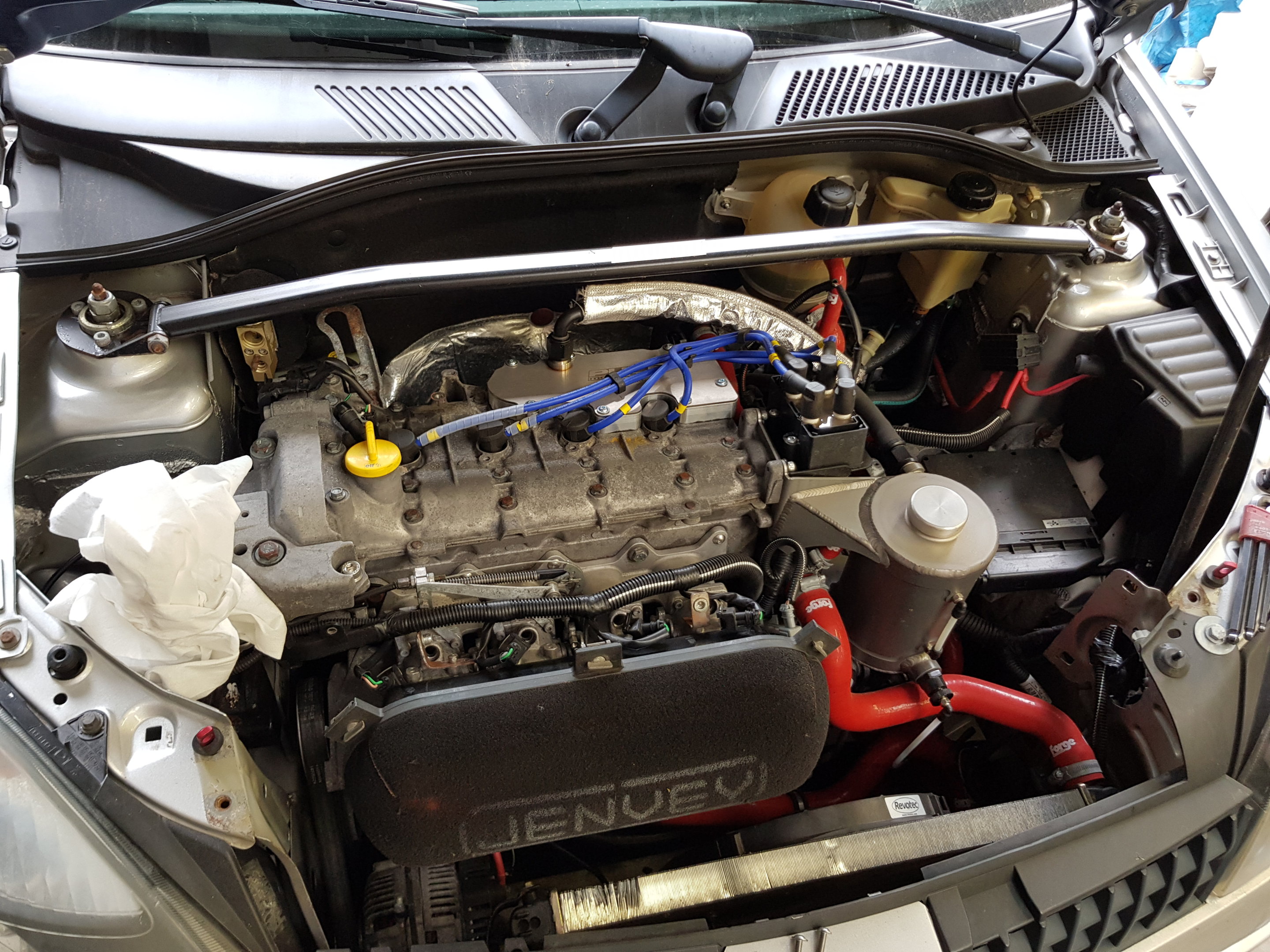

Do I need megane 225 ones for bodies? 48mm jenvey. Going to EFI in a couple of weeks so need to be right. Thanks guys for any help

I’m on ktec bodies..standard cams and high comp bottom end.. 201.5bhp 177ftlb on standard mk2 injectors.

Not sure until it goes to EFI. Jenvey 48mm bodies, standard cams, going to put it on group N timing before I go aswell.
Just trying To figure out if these injectors are 225 megane ones or just cheap one of eBay

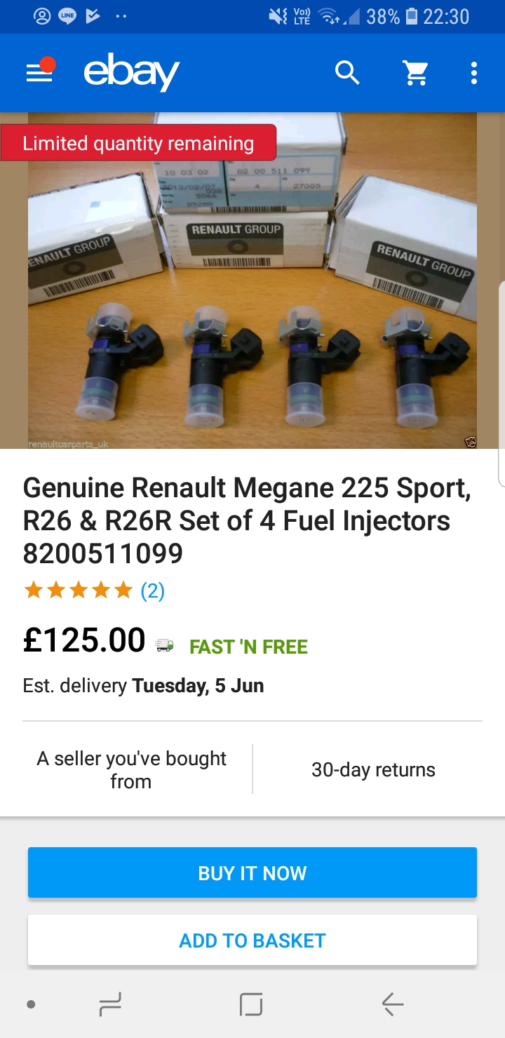

Was lead to believe that 225 injectors have a much better spray pattern but obviously well OTT for me!
1985michael182
Well atm these 225 ones are totally over fueling mine until it's mapped. Chris at EFI can tweek the raw data on them to make them right.
After some reading I've found out the standard injectors are 250cc and the r26 ones 390cc.
What CC are the 197 ones. If yours are at their limit with standard inlet on I don't think theyll work for me

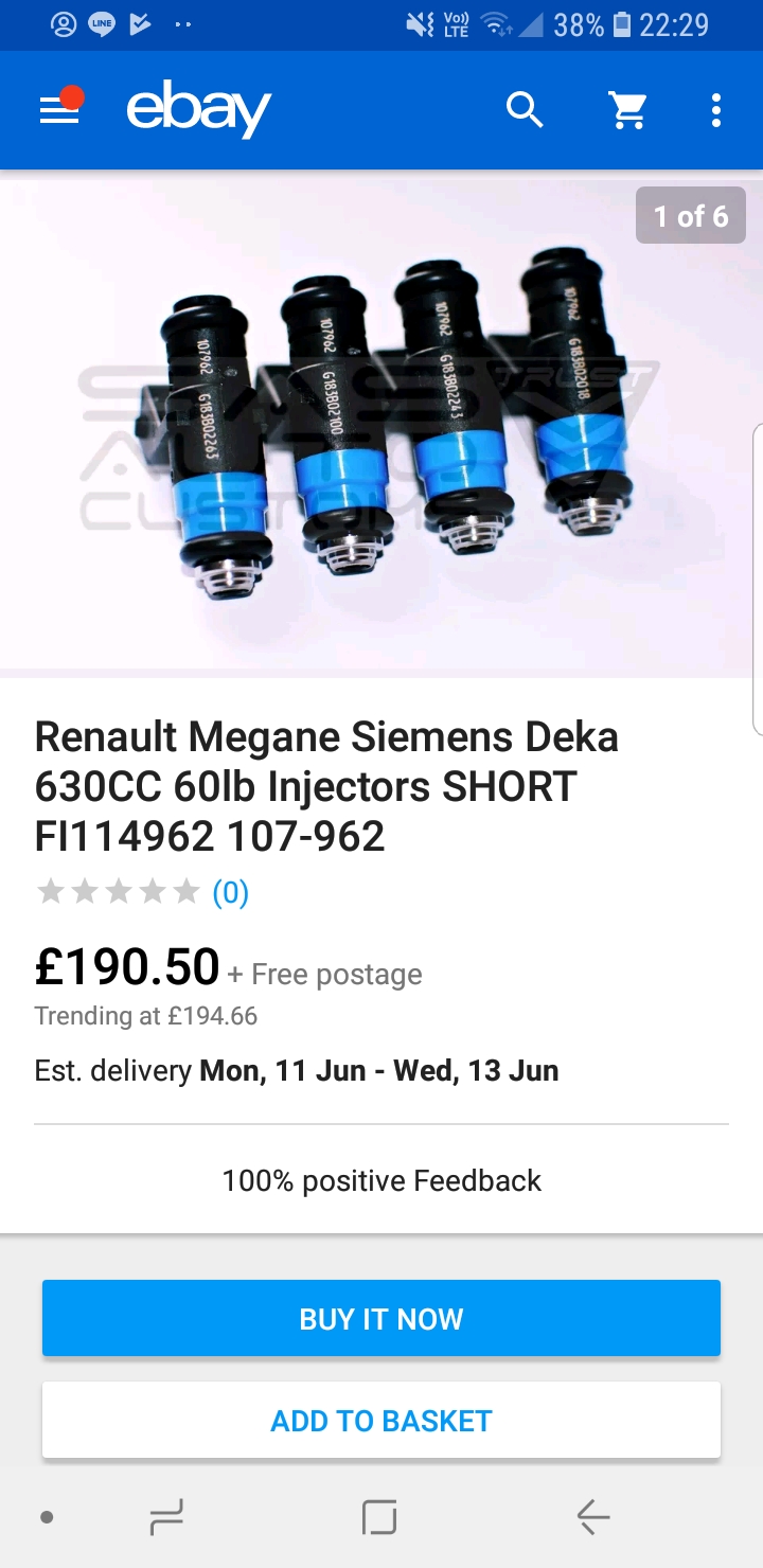

It might be worth giving Chris @ efi a shout see what he recommends. They definitely wont be 630cc’s it wont need them, look like the newer style 225/r26 stock injector.
