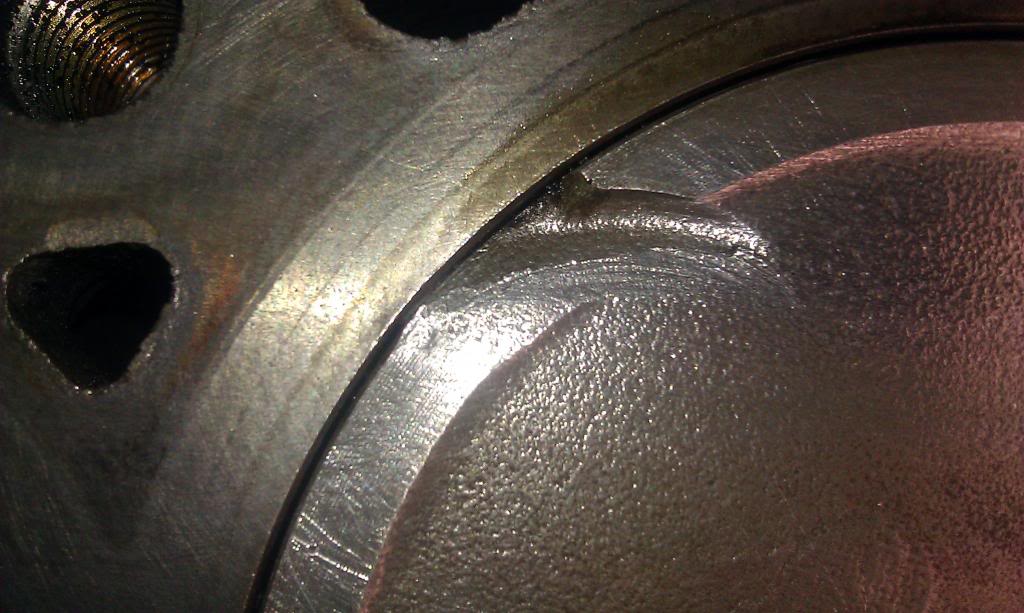

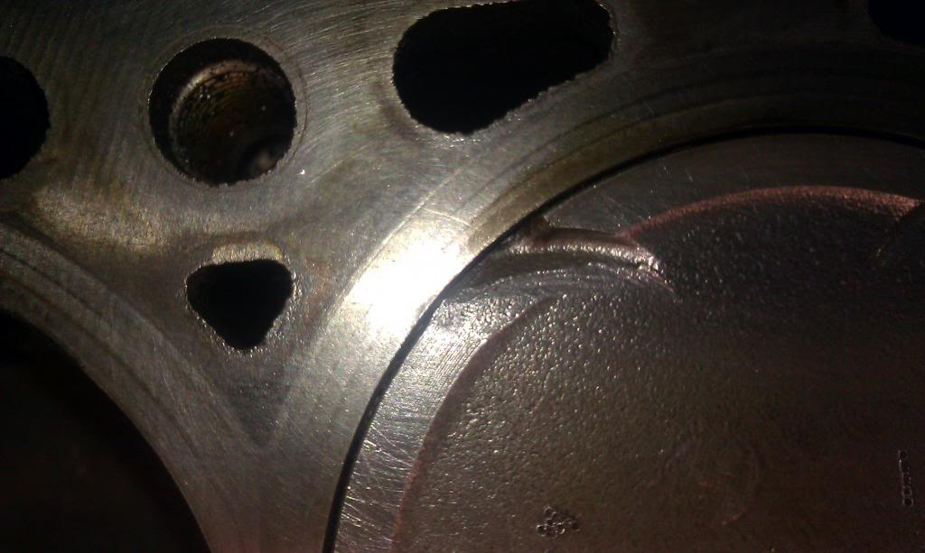

These pistons look pretty much done for , or ??
  RS RIP

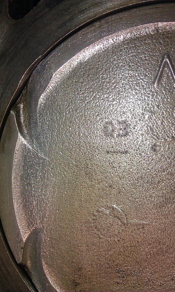

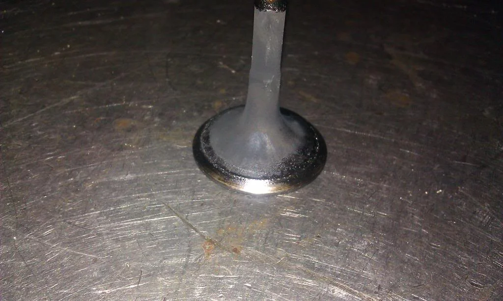

couple of hit valves, bent but not broken. How do these pistons look ? :( Want to know if these will still do the job ? One of the pics has a damaged cilinderwall...

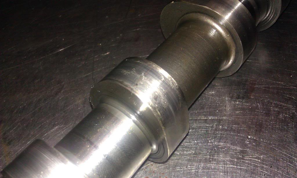

My C&B cams look f**ked too, valve took out a rocker arm (correct?) on its destructive way up and this must have damaged the cam... pretty expensive job it's going to be is my guess
So i'm looking at a head -refurb , do'nt have the funds for anything more i think. Ofcourse i'll be needing new cams too, if pistons are okay i'll be throwing in some Schricks. C&B do'nt make my profile anymore.
f**ked or ?

I'm no expert but I would say yes f**ked and the block looks a bit damaged too might have to be skimmed
  RS RIP
^^ go on , this is music to my ears ! Seriously, are you speaking out of experience ? It seems like the bottom part of the engine is fine , other than the marks. Am really scared about putting things together (total head refurb) and finding out later (too late) that a spot like this on a piston could be a "weak spot" or something of the like
Not to bad. If you want a set of pistons though Iv got some at work going dirt cheap :) unfortunately Iv just sold a stripped cleaned head that I was going to use for porting. TBH if it was me I'd re use them and just skim the head 10 thou. Or just use a stone and dress the damage and go again.
the damage looks minimal on the pistons, as long as the bores underneath are ok i would re use them
although may run the risk of being a crack you cant see with the eye in the pistons
may also be cheaper to buy a good second hand head, than refurb yours but that depends on how much damage

I'd not have an issue with most of that. Seen a lot worse. The small dink in the top of the bore should be ok if you make sure it's de-burred, and it's above the top ring sweep
^^^ this. Buy a second hand head all ready to go valve stem seals, springs, rockers cams etc and then strip and rebuild yours.
Or buy a complete engine and put it in. Then you have a spare bottom end and time to rebuild the head.

how bad/deep are the marks on the cams? i've just polished off light marks before without issue, luckily the valve train being on roller rockers you can get away with slight damage, as long as the cam is smooth it "should" be ok
Hey Fred, was about to ask you some questions on Schricks! The cams are dented or yeah some pretty serious markings on 'em. Because one of those roller rockers busted up and budged itself in there, literally broke a piece off the rocker ! :eek: The rest of the rockers all feel "rough" (on the rolling part) so nothing's re-usable..
