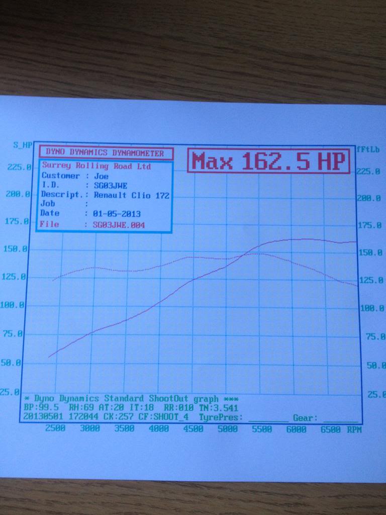

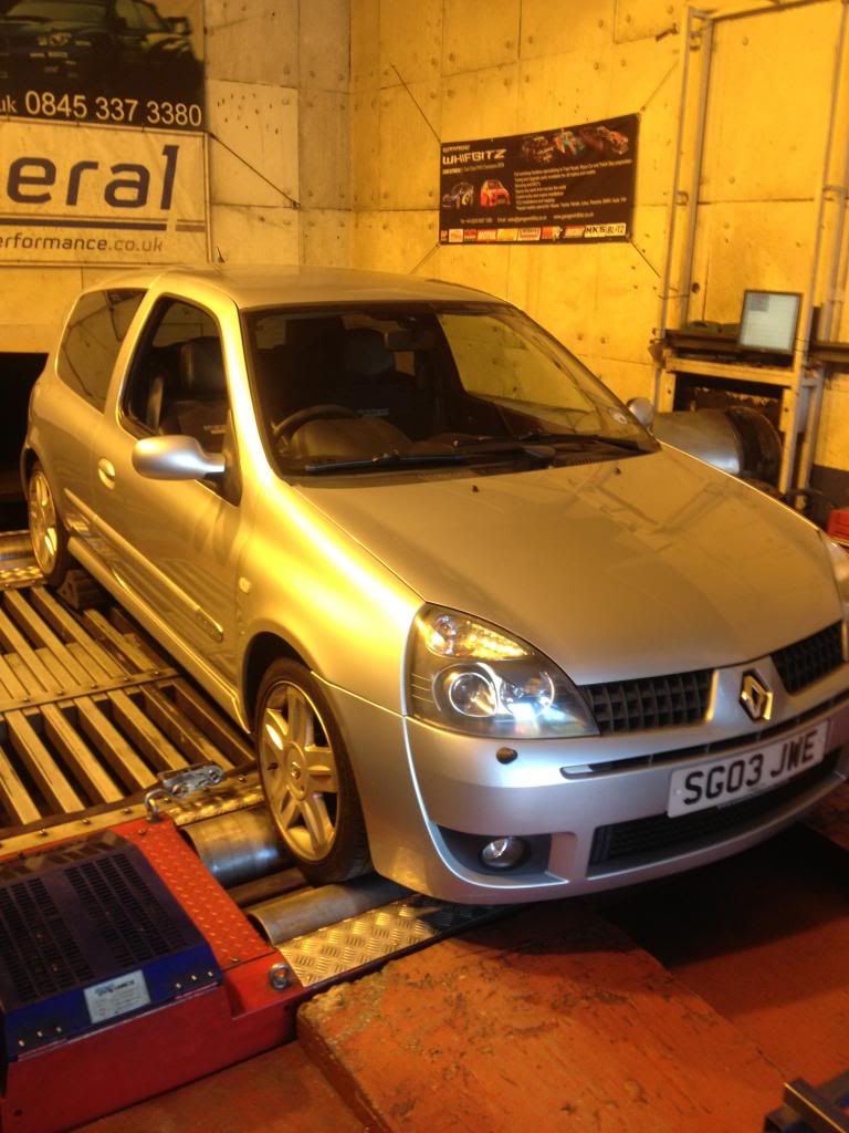

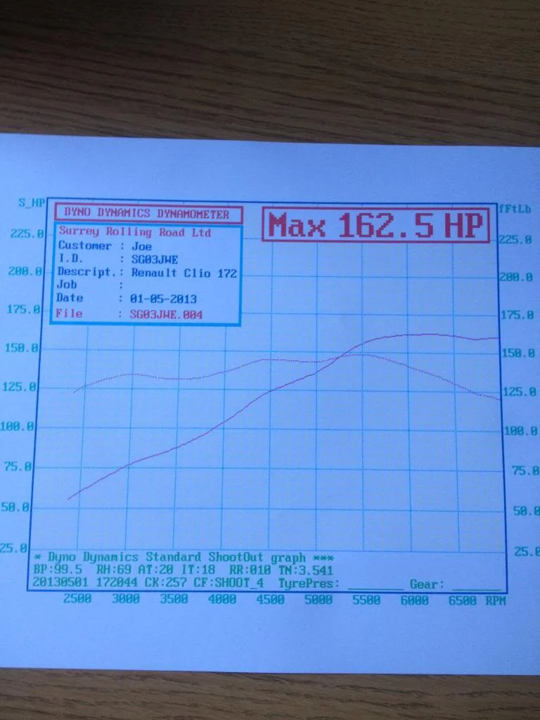

This evening I put it on the dyno to see what standard bhp it was running. At surry rolling road it gave 162.5bhp 149ft/lb. At the wheels was 134.3 and 123ft/lb. I was fairly happy with the result and the curve is very good.

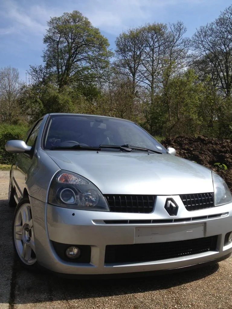

Ok fairly busy weekend completed carrying out a few jobs on the 172.

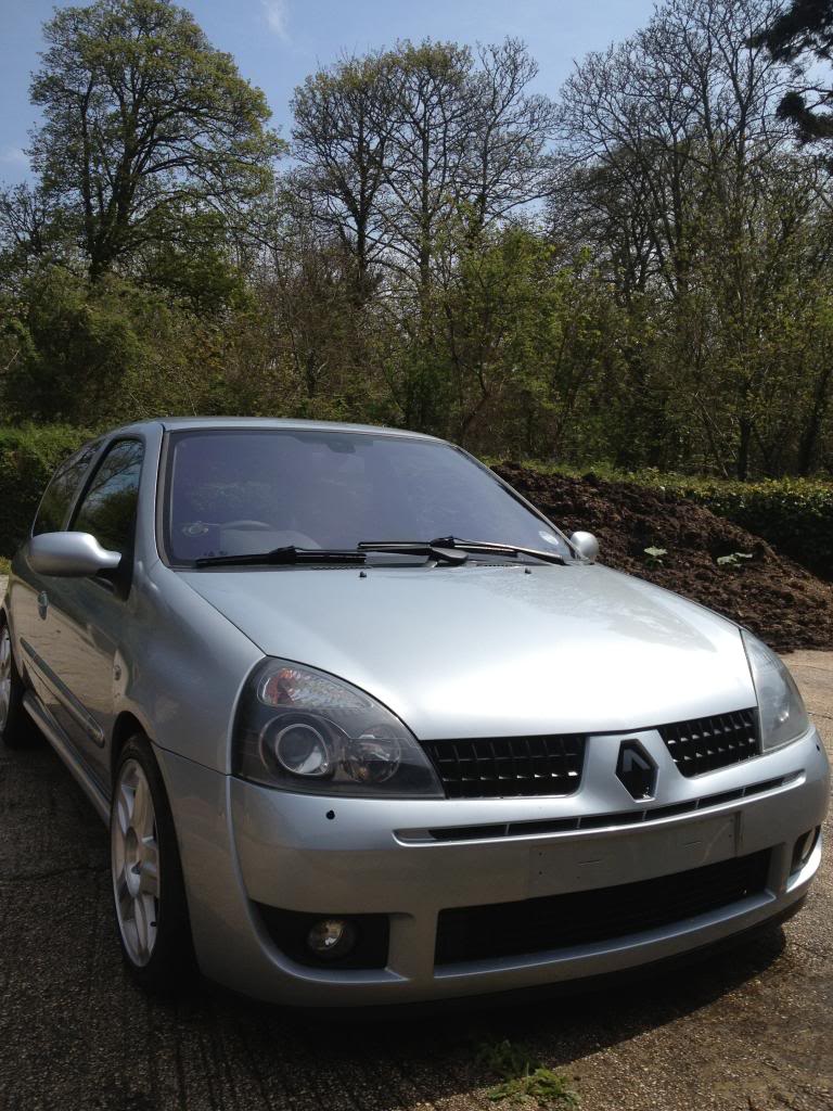

Here is a photo of the car last week at surrey rolling road.
And the dyno print out

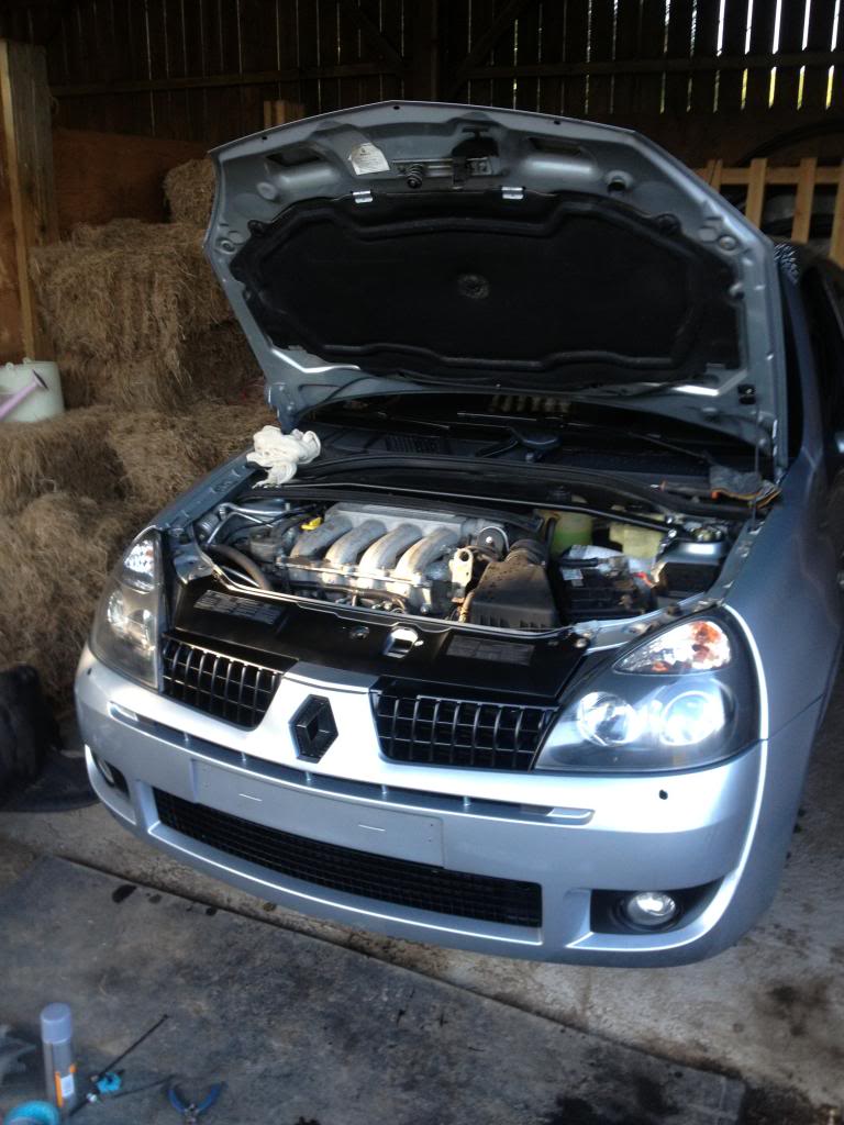

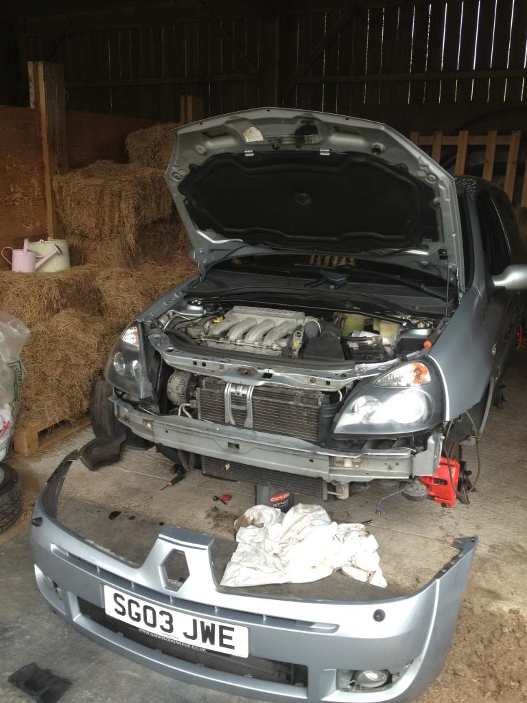

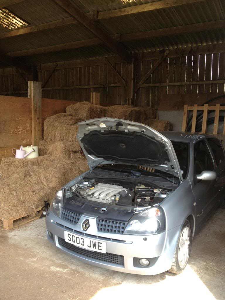

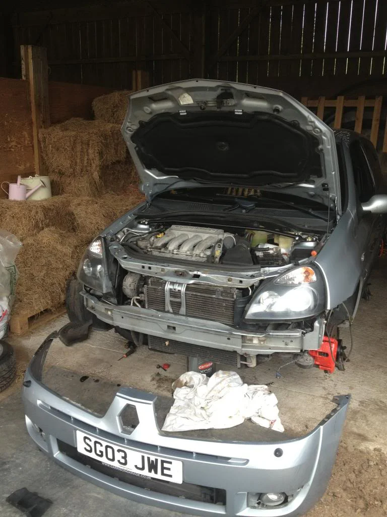

Easy. So drove down to Cornwall only to find no room in the garage :(
time to utilise the barn and carry out the work there! :)

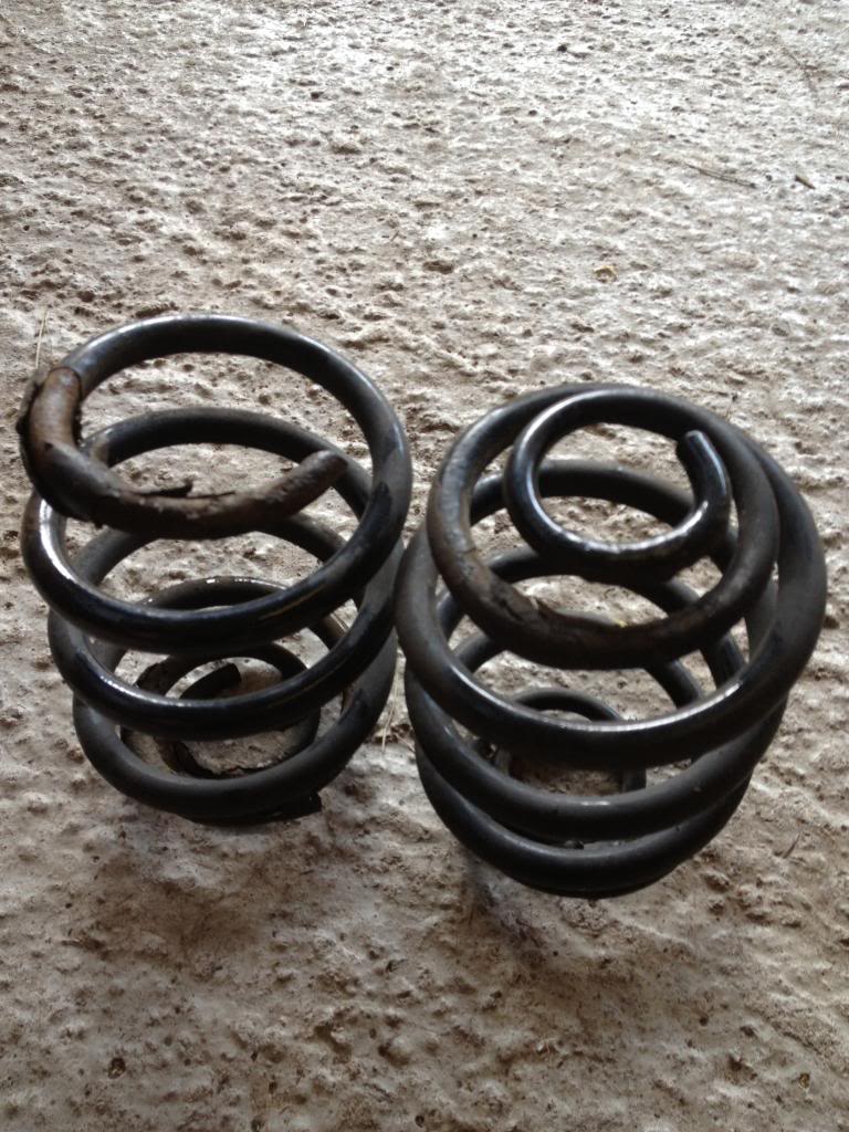

Rear Springs were shot
As well as top mounts and also the front dampers are a bit ropey. 0n the shopping list
Generally fitment of the top mounts and springs were pretty straight forward apart from a tight damper to hub bolt. 1/2" breaker bar sorted that :)
I then tackled the front end.

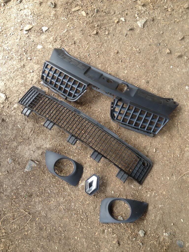

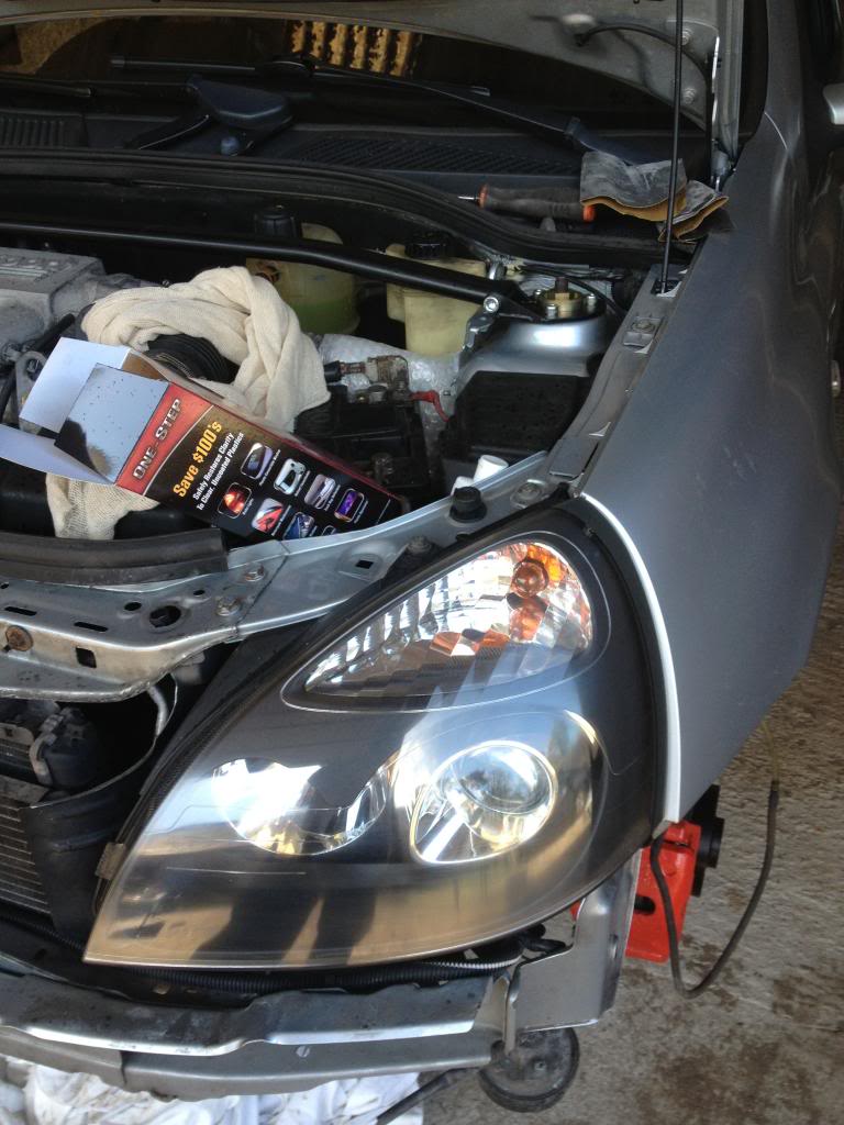

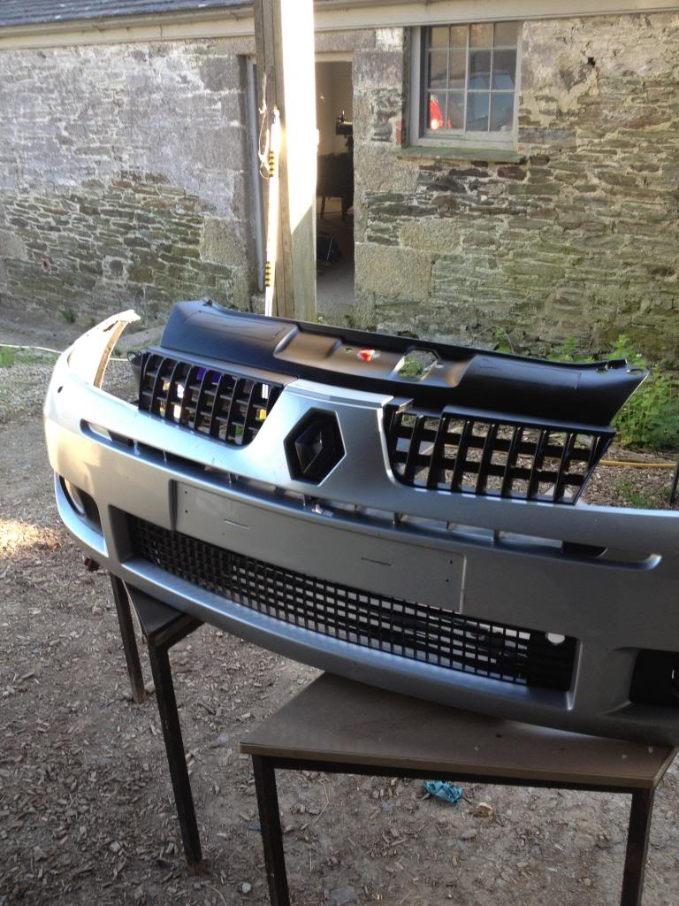

With the bumper off it gave easy access to removing acoustic valve. Fitting fabia splitter, cleaning lights and finding the cause of an operative headlight washer.
Headlights cleaned up but still scratches are visible. I went 600 grit then 1200 and finally 2500 before using mequires kit. Only spent 30mins each light so may need doing again.
Plastic trims removed ready for spraying.
Much better :)
A real improvement

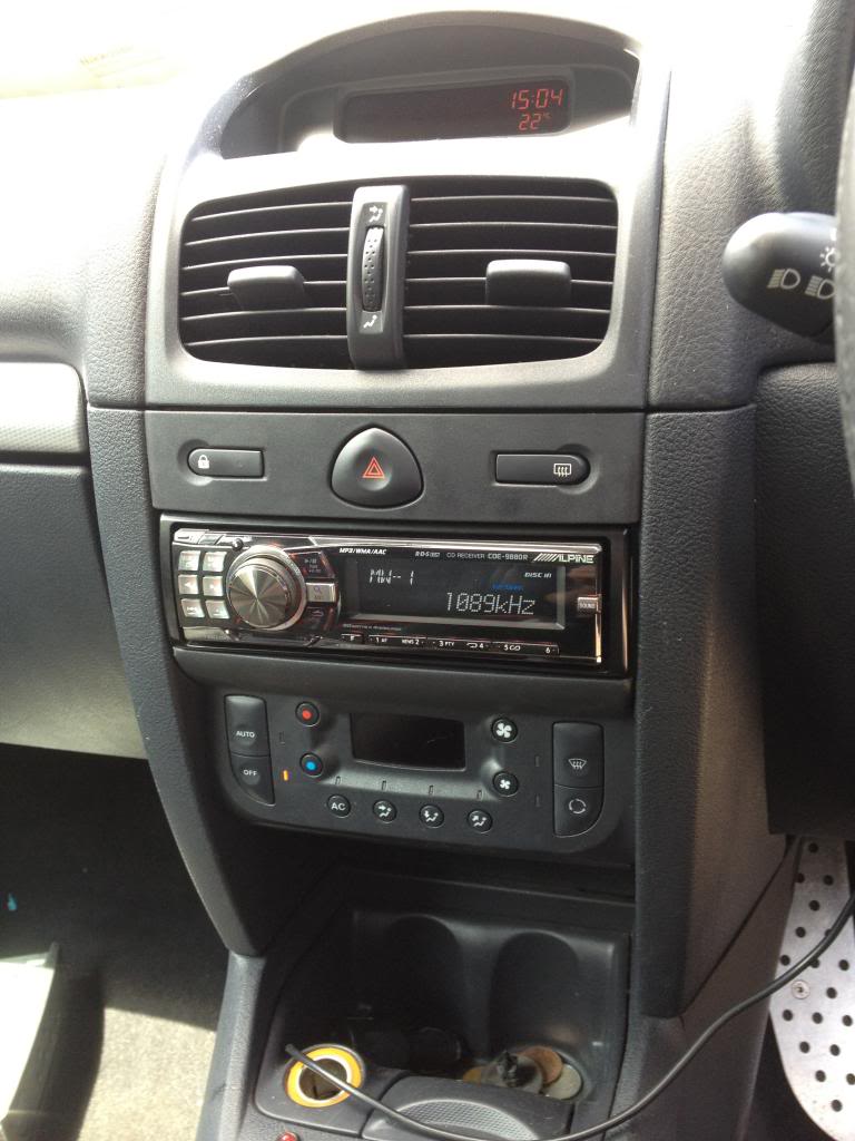

Went to the interior and removed seat washers and fitted stereo

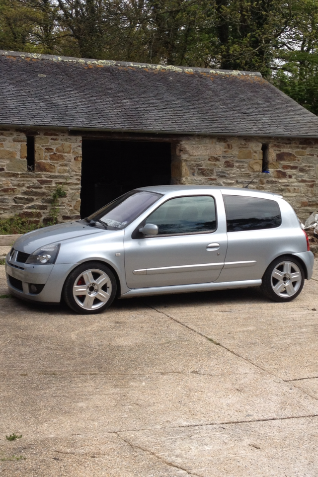

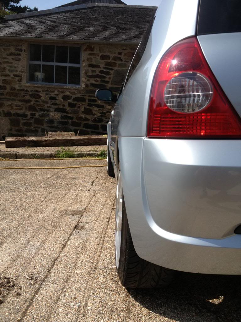

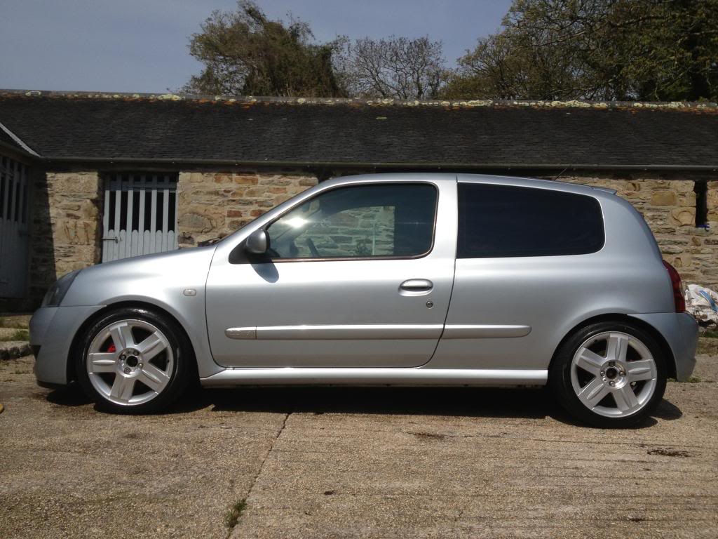

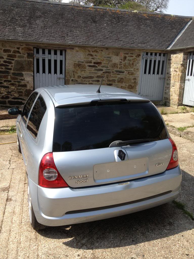

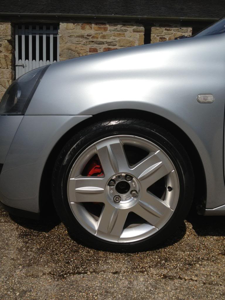

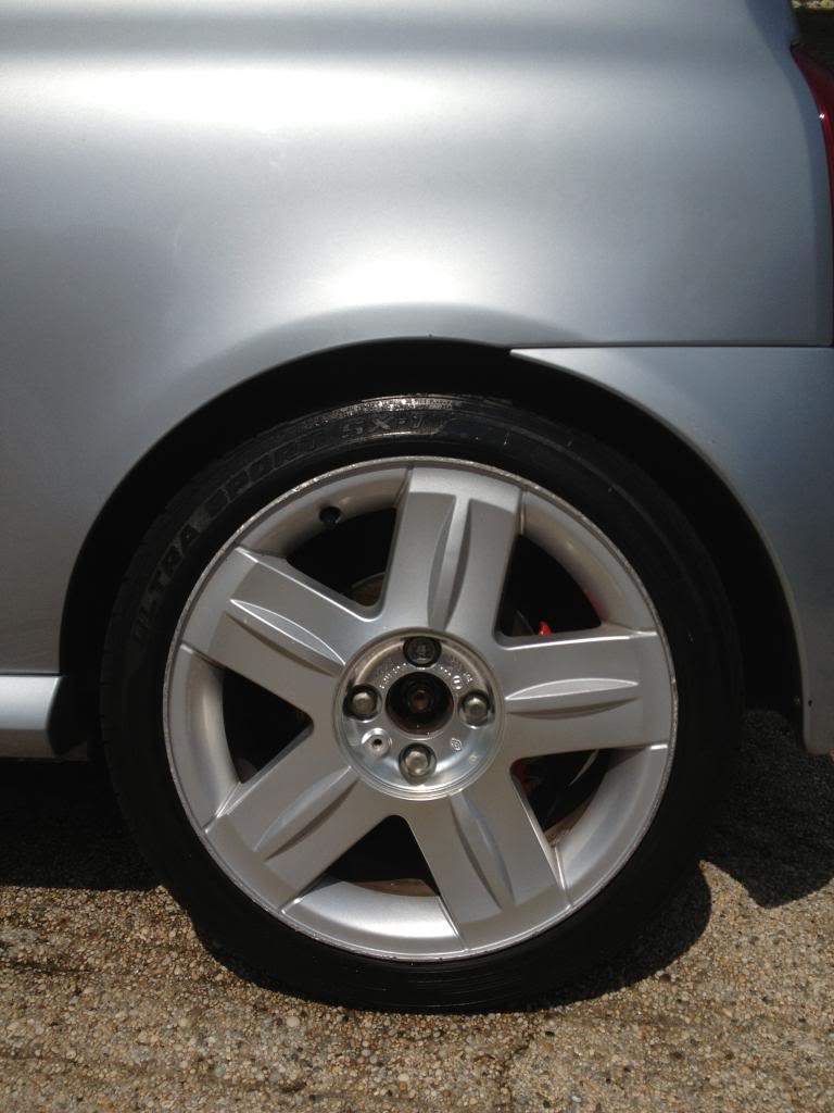

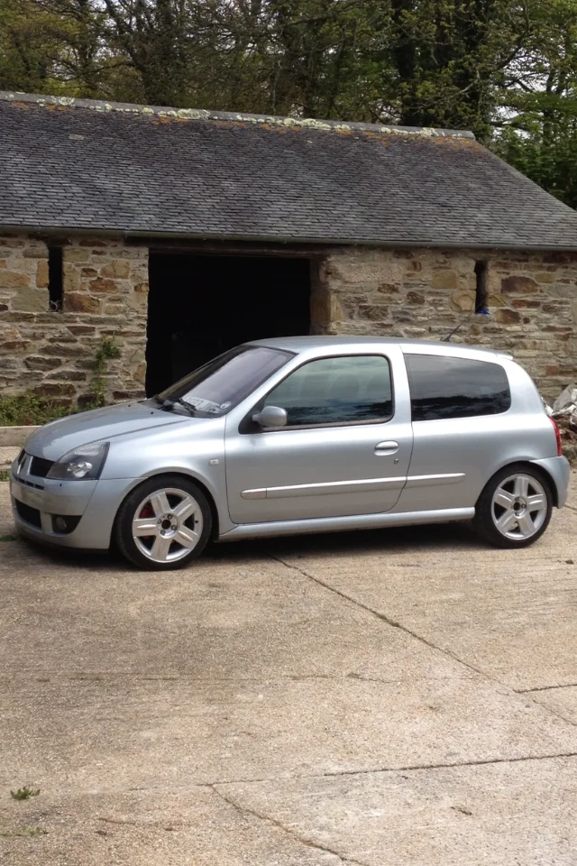

then gave it a clean and took some pics. Was very happy with the appearance apart from the rear badge in satin black. Ill either keep it and remove the clio and rs badges or revert to standard.
For anyone who is unsure of solid top mounts all I can say is do it. You wont regret it. Turn in is so precise and there is so much more feel it really is up there along with Rear ARB which I will be fitting next month! :)
Orginally I had opted for Eibach sportlines but then decided to go with Cooksport springs. I am very happy with the looks on car, price and service regarding delivery. From standard set up to solid top mount, front strut brace, springs 25mm front spacers and 15mm rear with -1 degree camber the car has become a different beast. It is a very firm ride. Almost like its on bumpstops but Id imagine on the track they will come into there own. The extra width regarding spacers has given benifits with looks, turn in and general confidence with handling. It has become slightly road camber sensitive and can sometimes 'wander' with road conditions. Im really looking forward to how it feels with rear ARB and new dampers on the track.

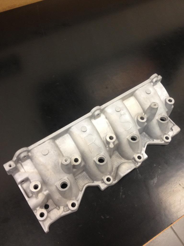

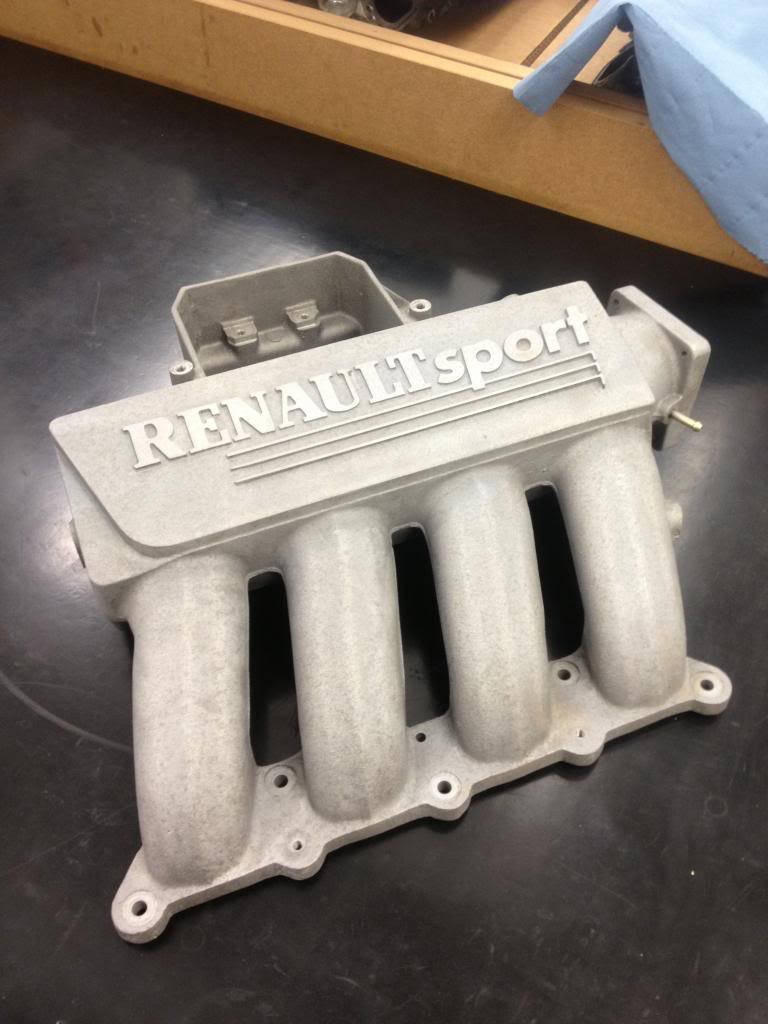

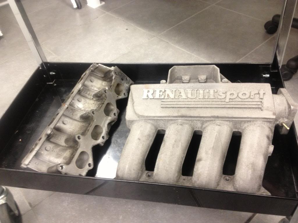

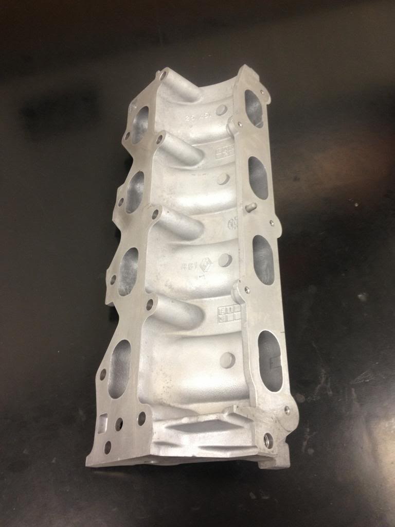

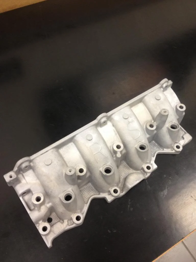

I have a set of manifolds to get port matched. Bought online. Pretty minging.
From RenPart:-
After I had them for an hour
Little bit better. They have now been sent for matching.
Engine wise Im thinking ARP bolts, matched inlets, decat and exhaust, filter and then RS Tuner map to increase RPM to 7800. Then rolling road to see gains.
