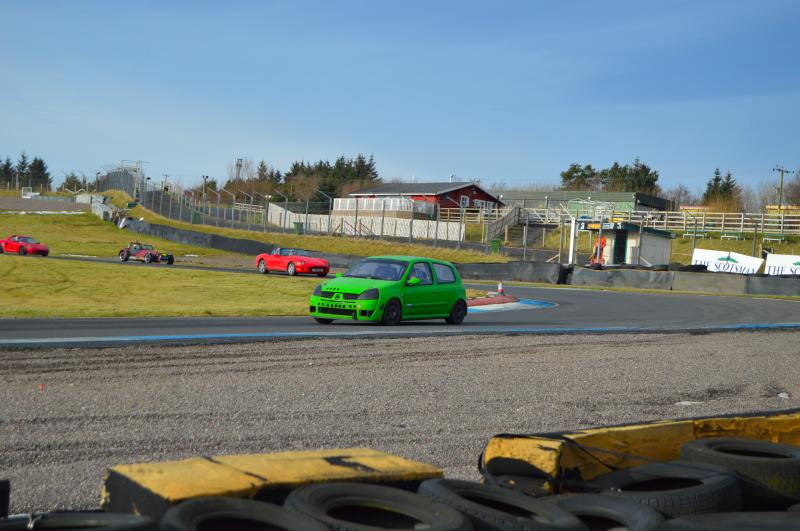

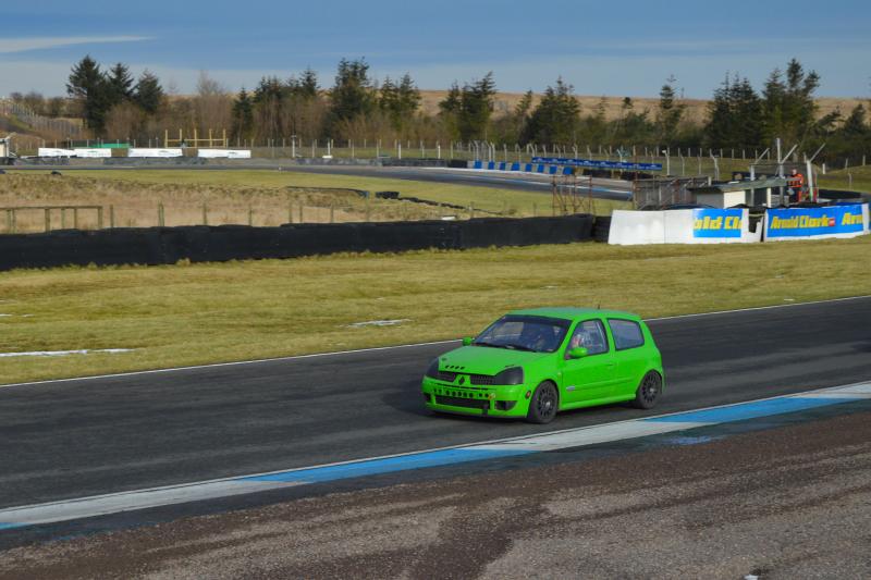

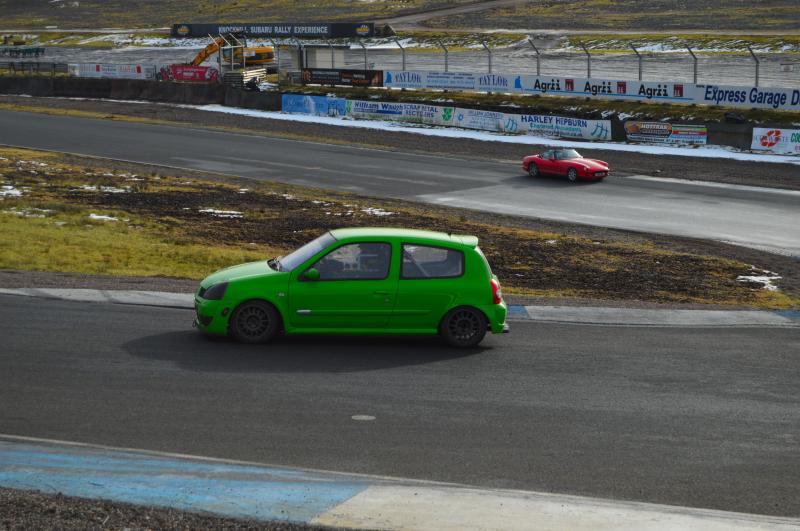

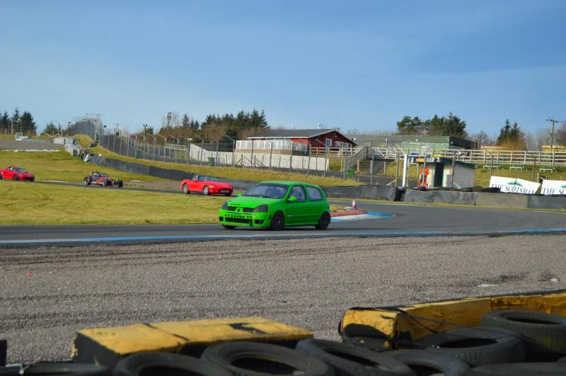

Thanks a lot :tongueout:
It had its first track outing last week in the new colour, have to say the gripper diff has made a massive difference to the car.
